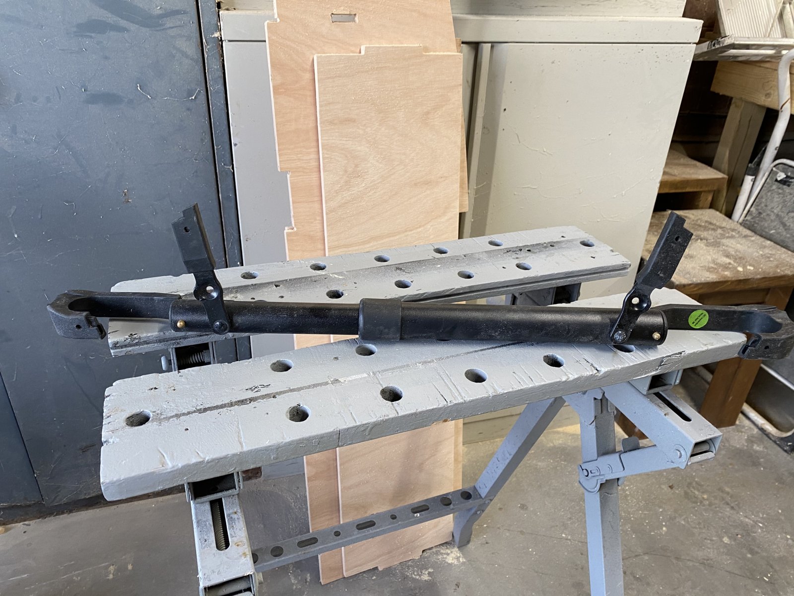

Hi
I gave these extending support bars which fit around the seat post and under the stem
It means the clamps can easily fit and they are designed so you don’t clamp to the carbon frame (which I have) and you can tighten as much as you like
They are from Halfords (UK)
Awesome. What r these called and I need them. I have an issue with the thule clamps on the bike. Can’t get them solid.

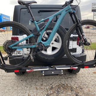

I just ordered the 1up - can hold 4 bikes (I went with 3) and they offer a swing out adapter for the whole rack and I added a ramp for the Bikes. Cry once but buy once was my theory.
Like the 1UP, only more expensive and less load capacity.:) I am not a brand ambassador, I just really like the rack.

Hi

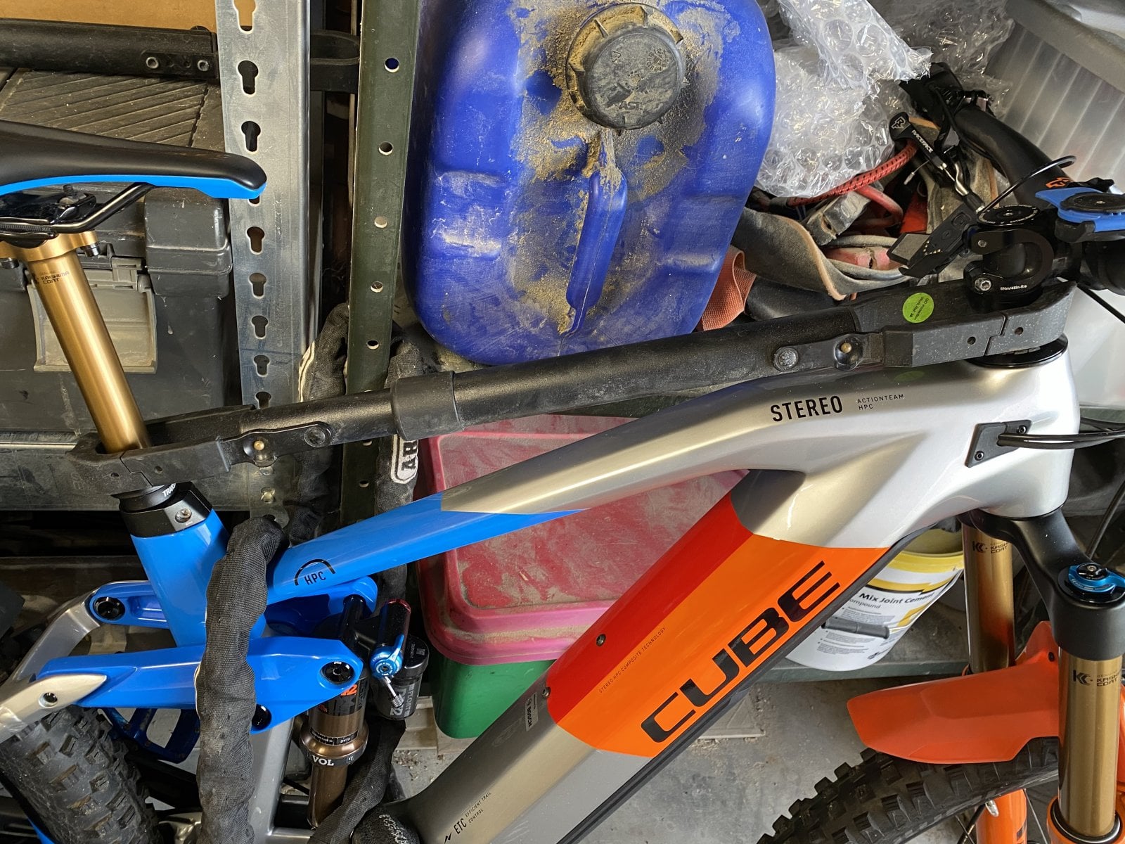

thats genuis, would you have a pic of it on the vehicle so i can see it ? i have a carrier and the bars dont fit the cube downtube similar issue to yours i guess rack is for more traditional straight top bar, dont get me wrong ive started looking at transporter vans but the bar would be cheaper hahaha
I don’t have a picture on the vehicle unfortunatley

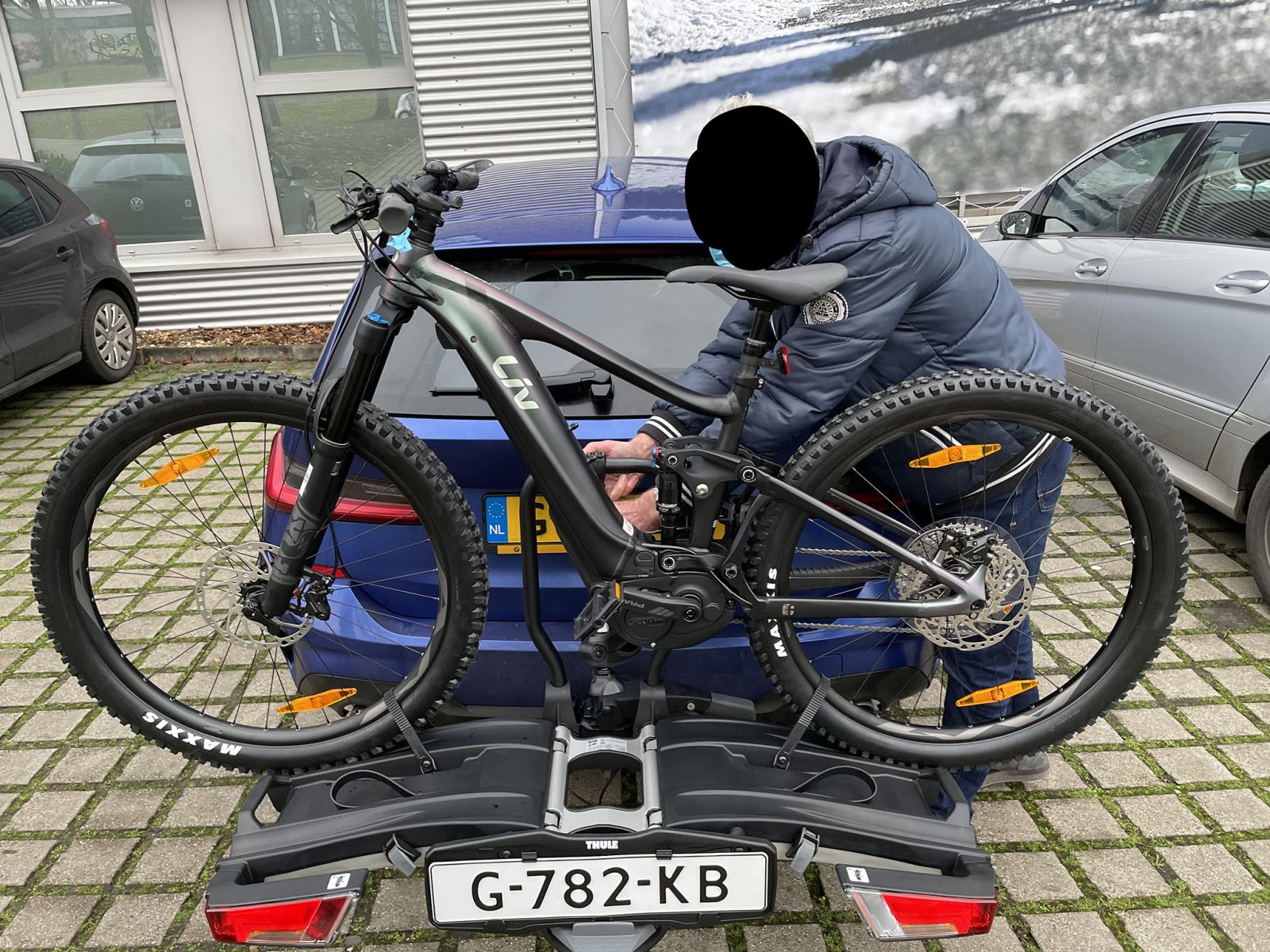

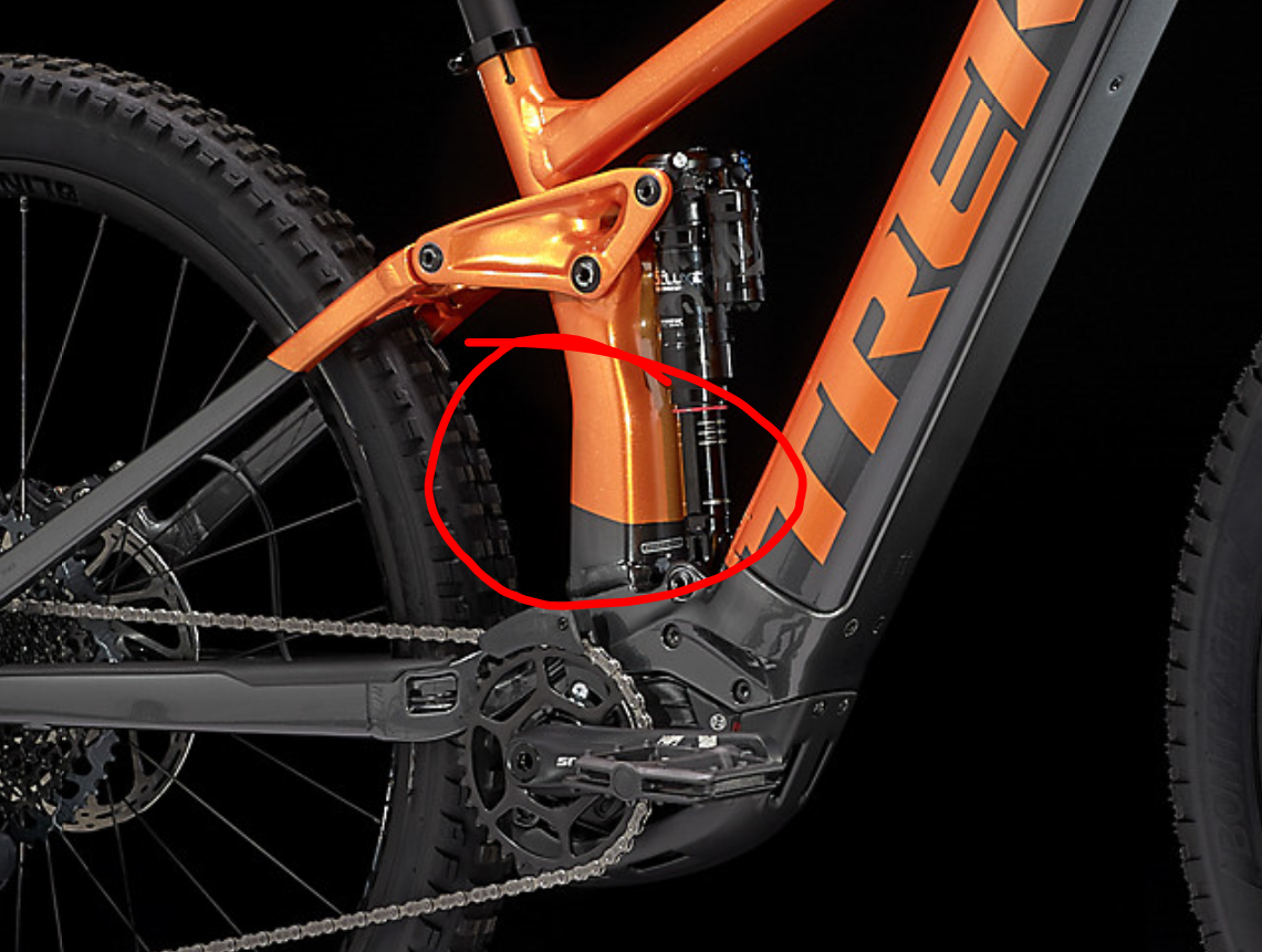

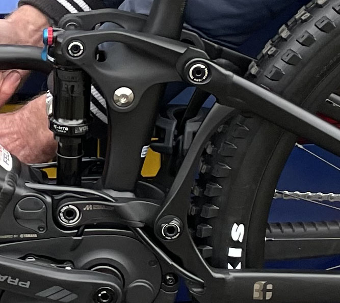

Have an Thule Easyfold XT2 (933) specially purchased for the eBikes a week ago. Picked up my Trek Rail 9 and my girlfriends Liv Intrigue X E+ 2 today in Germany and had some trouble getting them on the bike rack. Forgot to make good pictures but the frame is to thick for the stick clamps. Used the “suspension” link on the Liv and the “seat” part of the Trek to fixed the bikes to the rack.
It worked pretty good but I’m not to happy with this solution. Would be much nicer if the bike is fixated on much higher to make it more stable.
Someone got some experience with different clamps for the Thule carrier?
