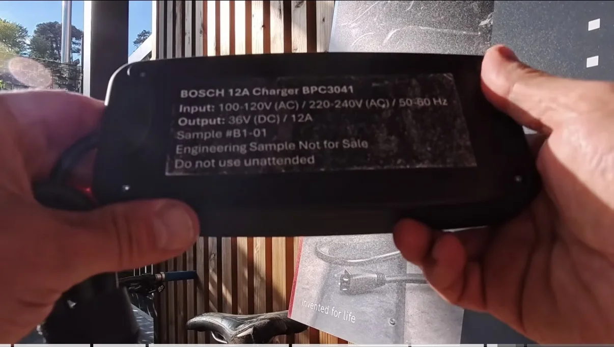

Alex the reviewer all Avinox owners love shows up to new 12 Amp Bosch charger.
Give me charging time for all batteries.
Fair enough, and good to have that confirmed with image evidence — so Bosch 12A is real, not just rumour.
