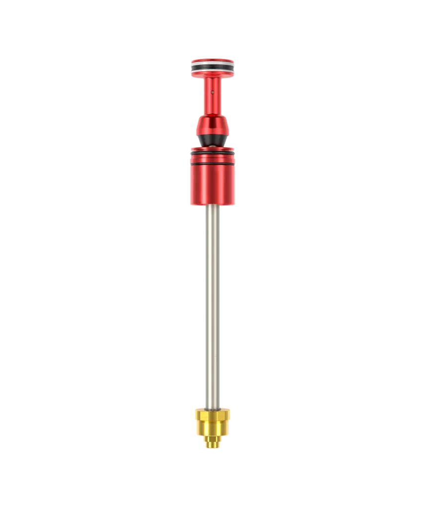

I'm going to try the latest DebonAir+ W/ButterCups air spring, seems like the best of all worlds... just released a few weeks ago.
DebonAir+ - FS-UPK-DBP-A1 - RockShox
