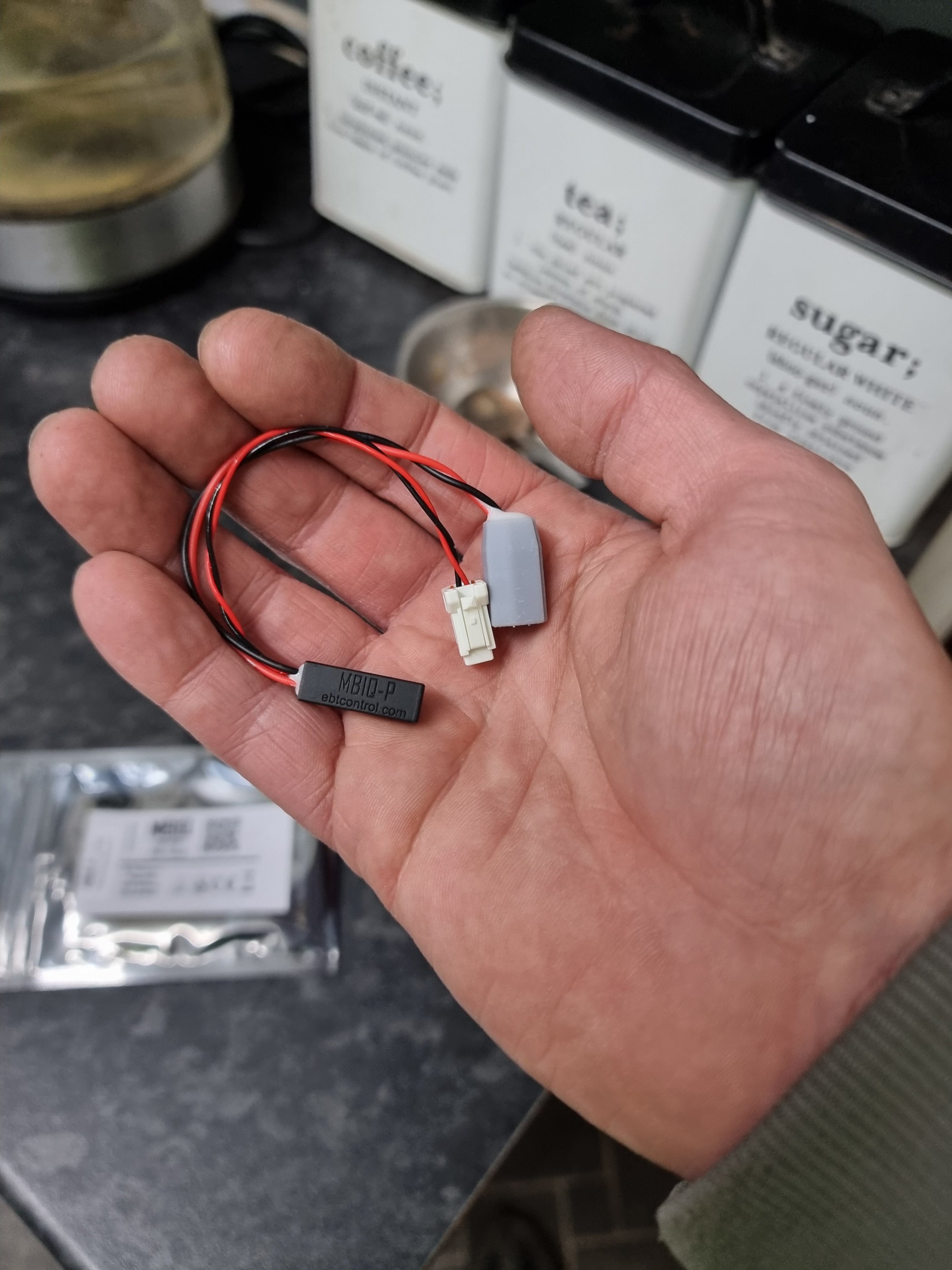

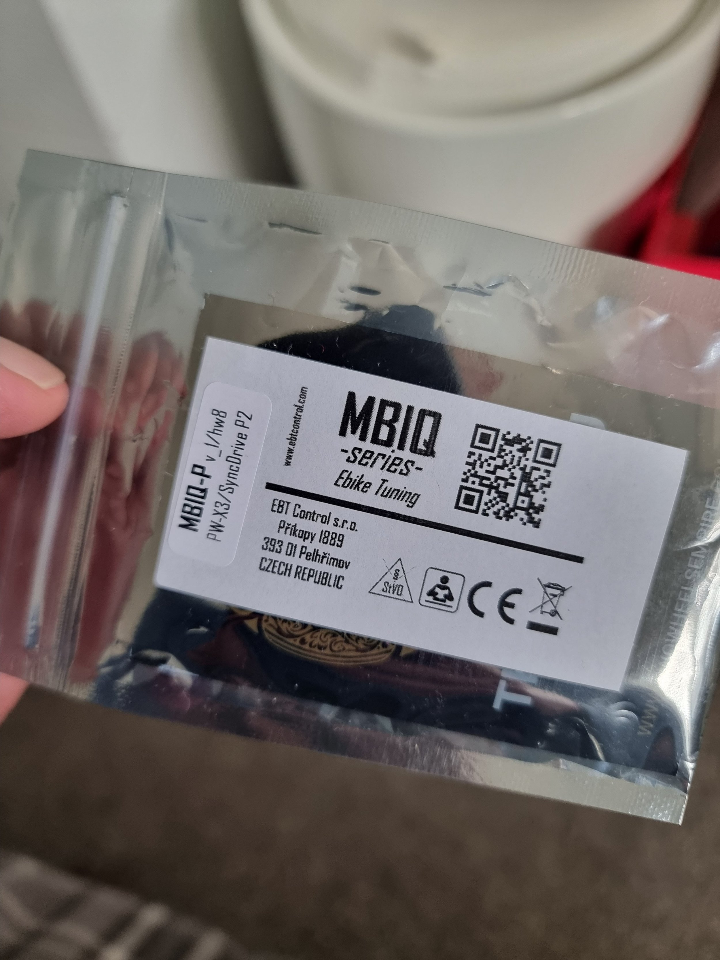

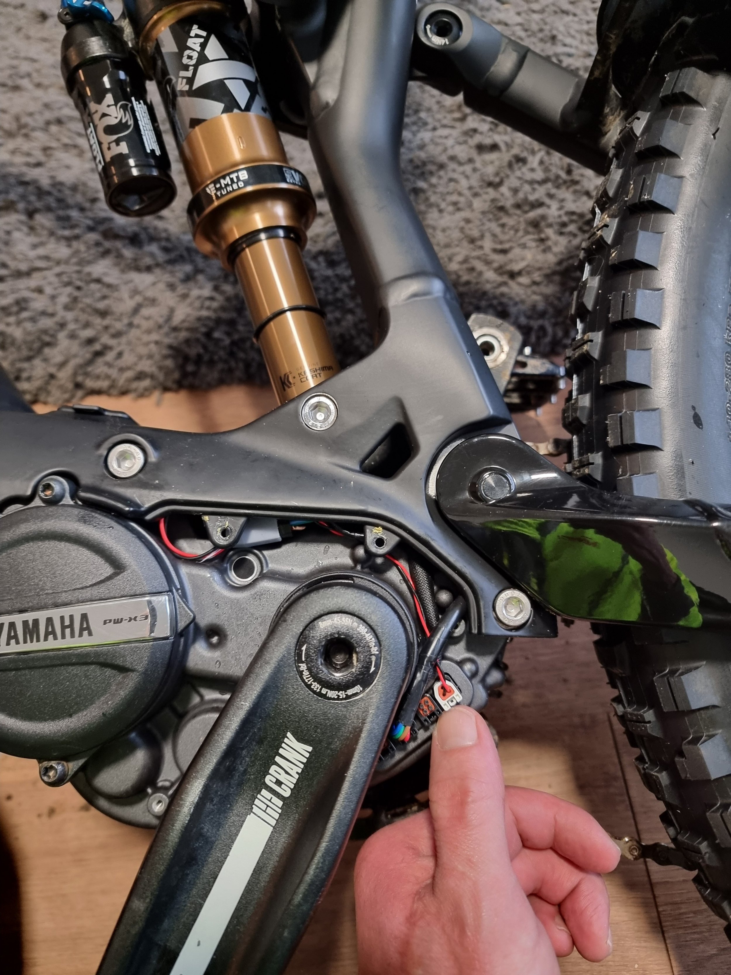

I've chipped mine with MBIQ-P chip, works perfectly with interface X display.
Only takes 10 minutes to fit or remove, tiny little thing.
Transforms the bike once chipped, amazing bike and motor.

Fitted the MBIQ today, 10 mins lol (your pics helped was no instructions with it)
works a treat..
Thanks again Deacon for your post pal, it saved me a headache of what to do next..
