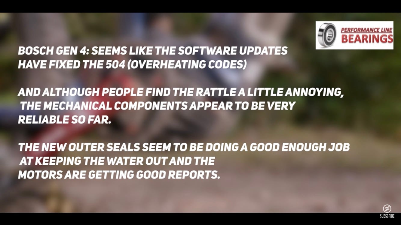

504 is an overheating error isn’t it ?
I don’t see how tuning will affect temperature of the internals as the output is not changed as far as torque and peak watts are concerned just the speed limit is lifted.
All the error codes are in the manual (can find it online). ?
504 Manipulation of the speed sensor de-tected. Check the position of the spoke magnet and adjust it if re-quired. Check for signs of manipulation (tuning). The assistance of the drive is reduced.
