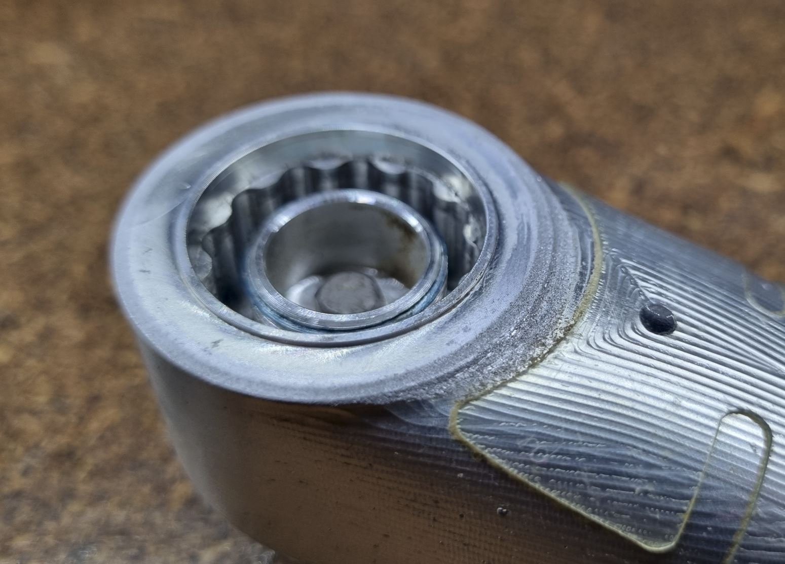

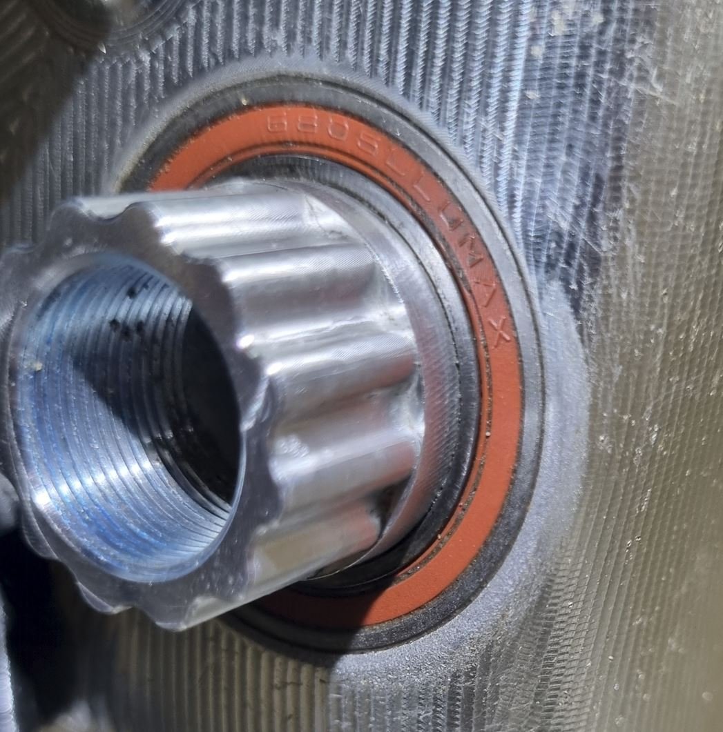

Well I got the links off the swing arms and gave everything a good clean up. There was some abrasion on the surface of one quarter of each of the rear links, as well as on the mating surface of the frame. When the bike's upright, it's the upper portion of the links where sand/dirt can sit and become wedged between it and the frame. Some pics below.
After putting it all back together, the creak remained! So I pulled out the dropper and post clamp, cleaned up both and reinstalled (no grease) - creak gone! So it was simply the seat post again, good one @Paul Mac. It was worth cleaning out that buildup on the swinglinks though.
