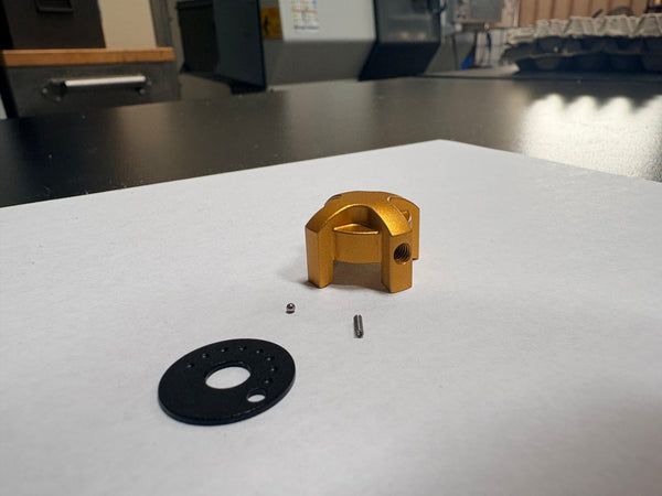

Fluid Focus out of California makes a replacement knob with detents.
