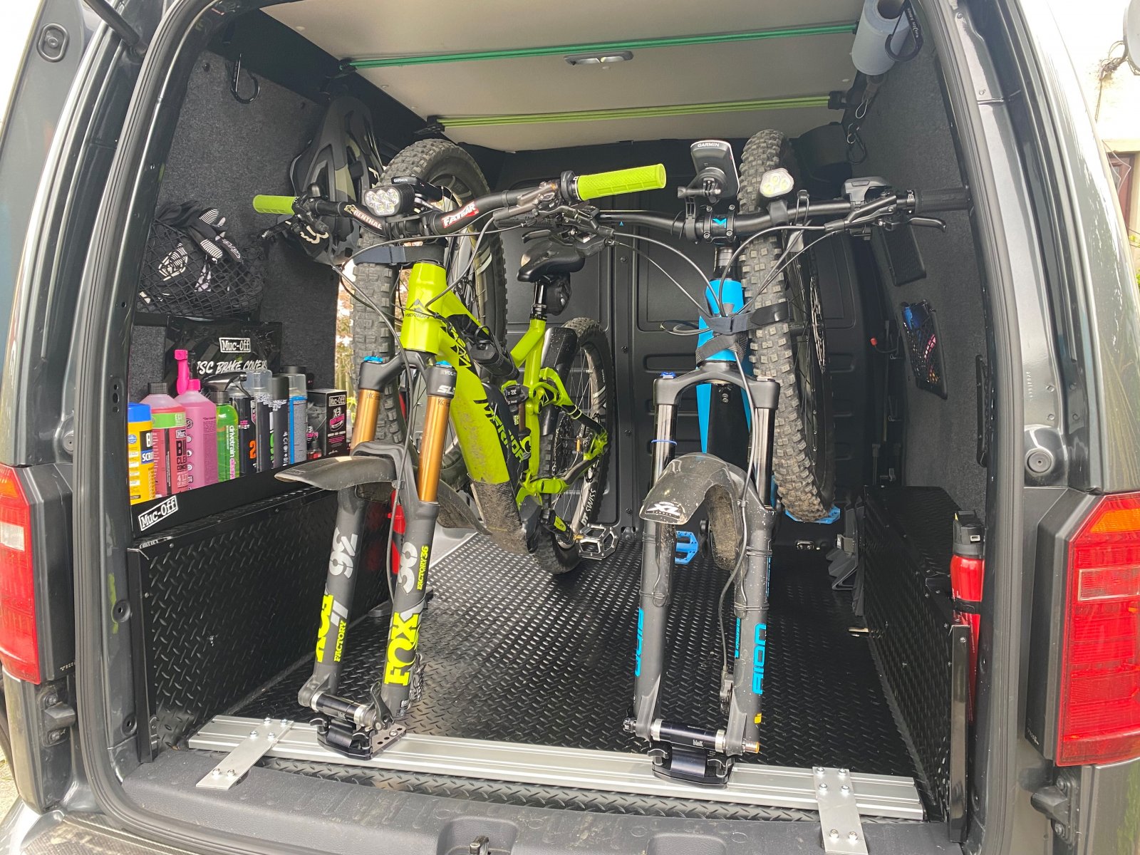

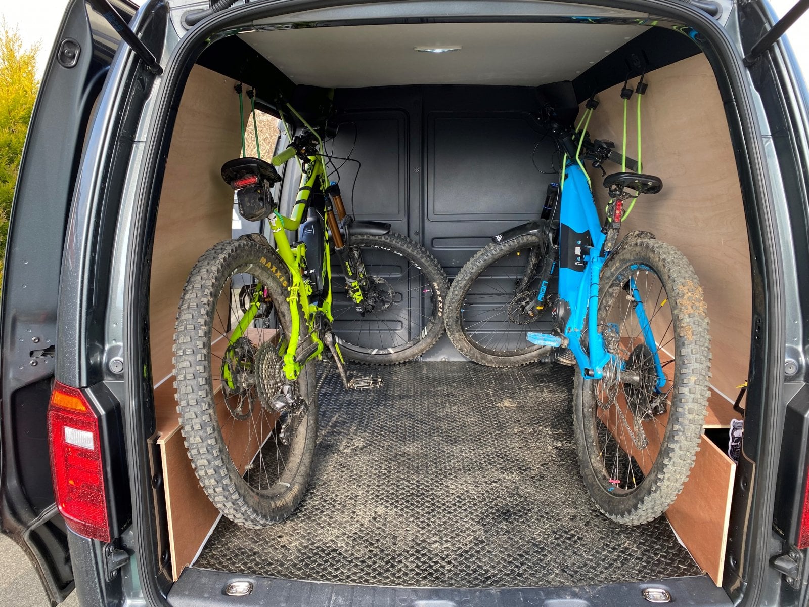

I just bought a 2018 Petrol VW Caddy SWB a couple of months ago.
I was able to get two ebikes (a large Merida 160 900e & a medium Cube Stereo 140) in the back without taken the front wheels off. I just used bungee cords to secure the bikes to the top of the plywood.
However I found the larger bike was damaging the fibreboard roof lining, due to the height & angle of the handlebars.
So I got a couple of fork mounts instead, I much prefer this for transporting the two bikes its much more secure.

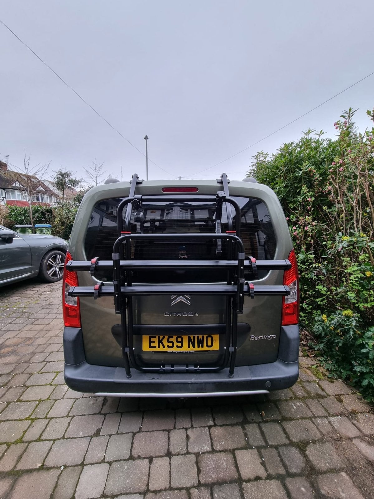

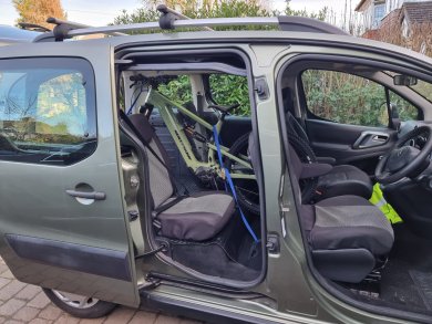

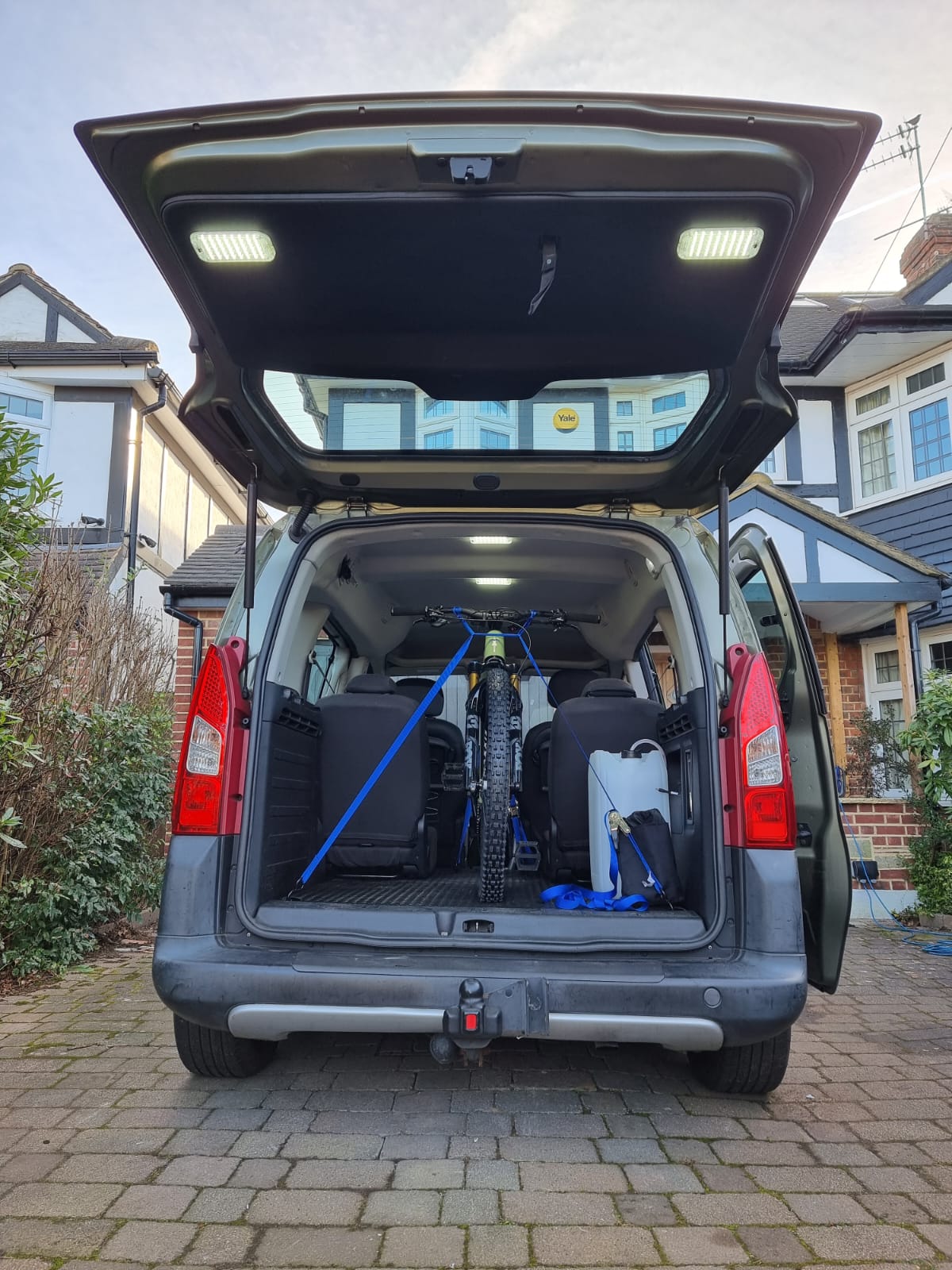

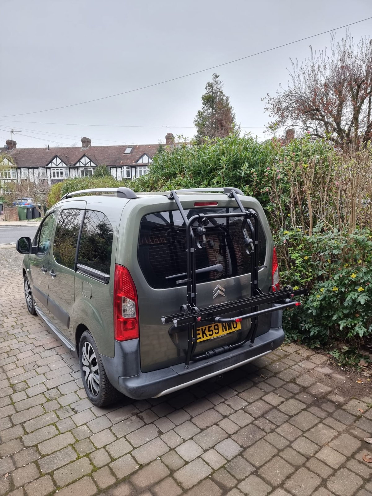

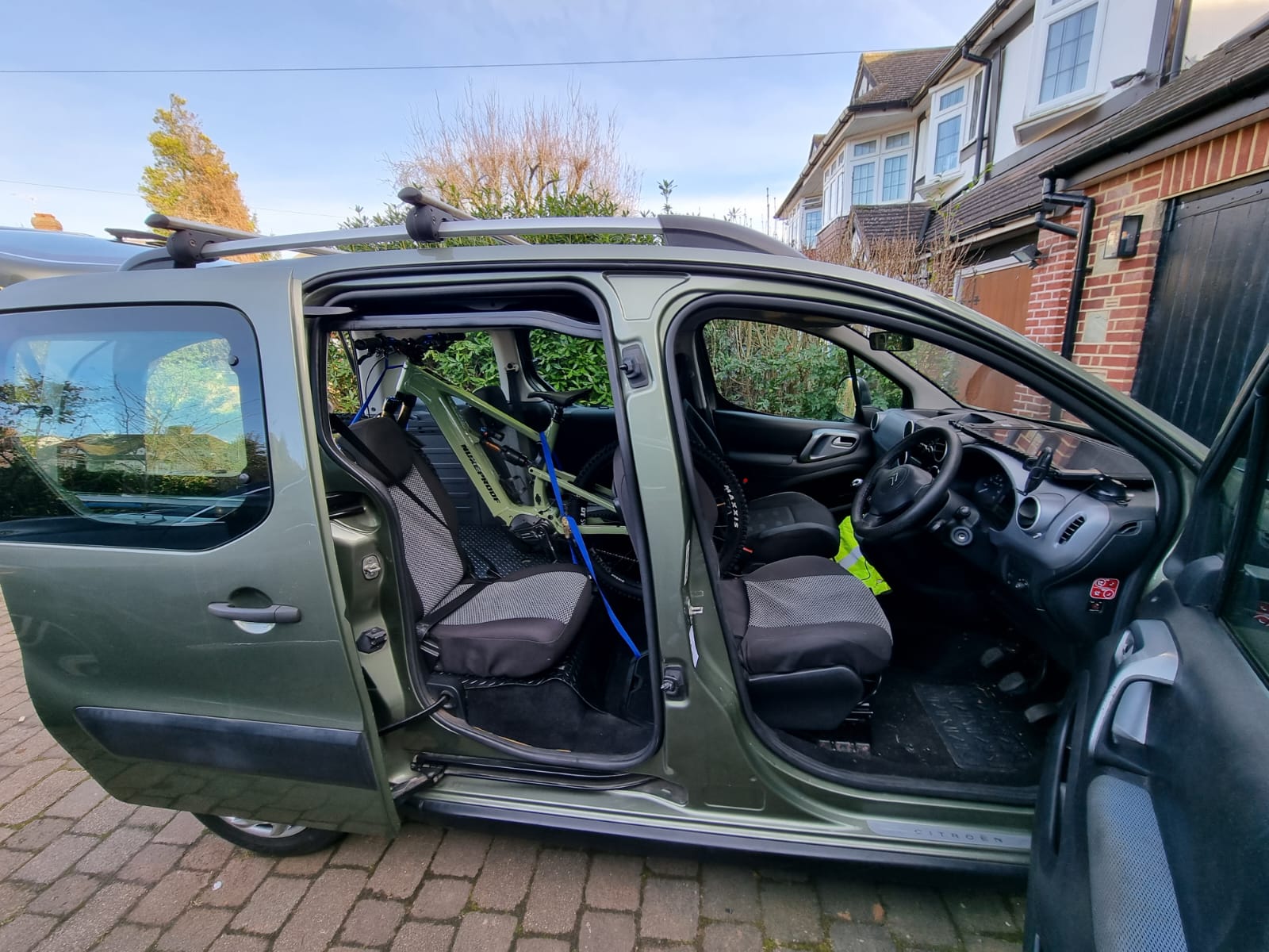

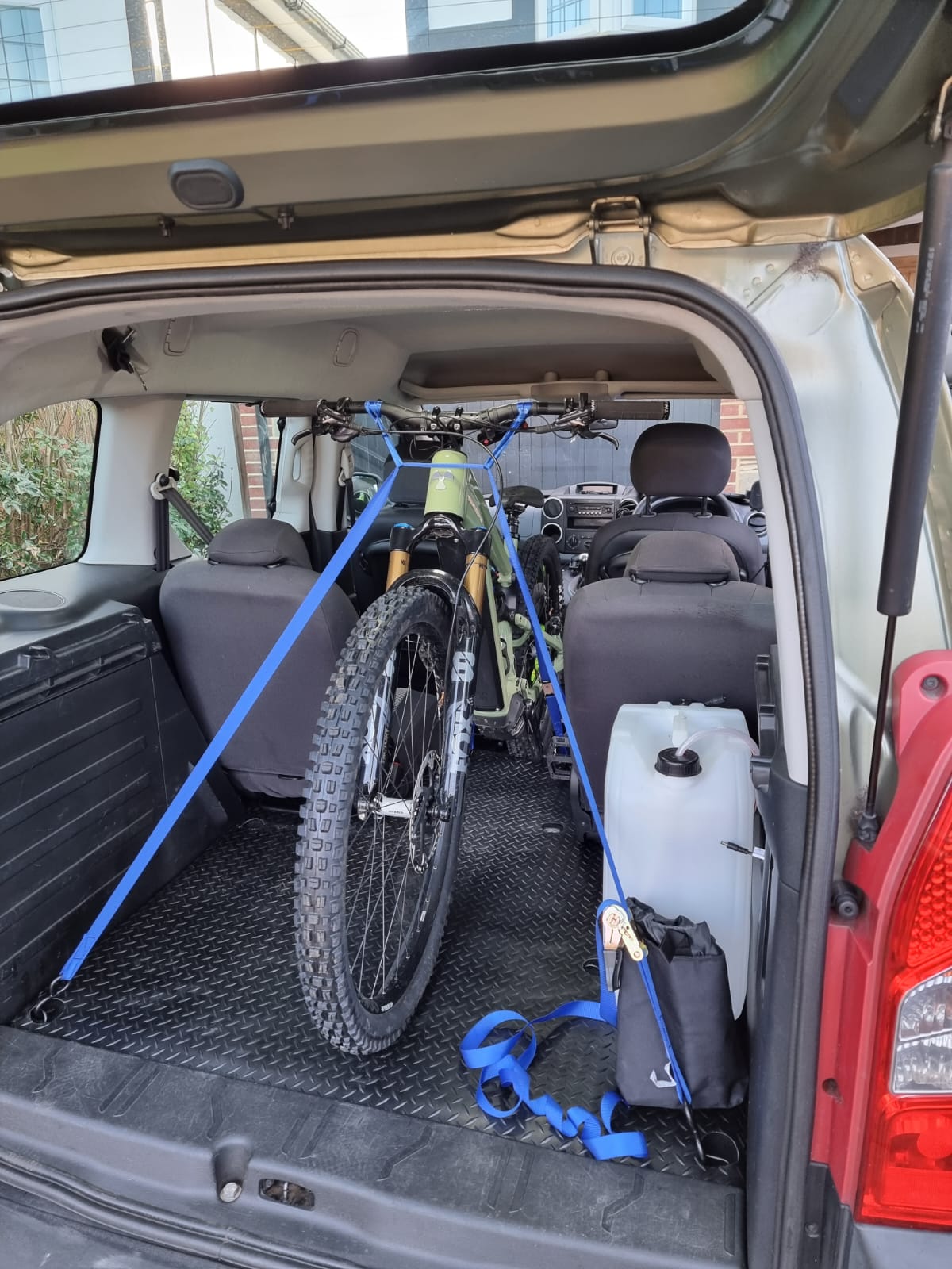

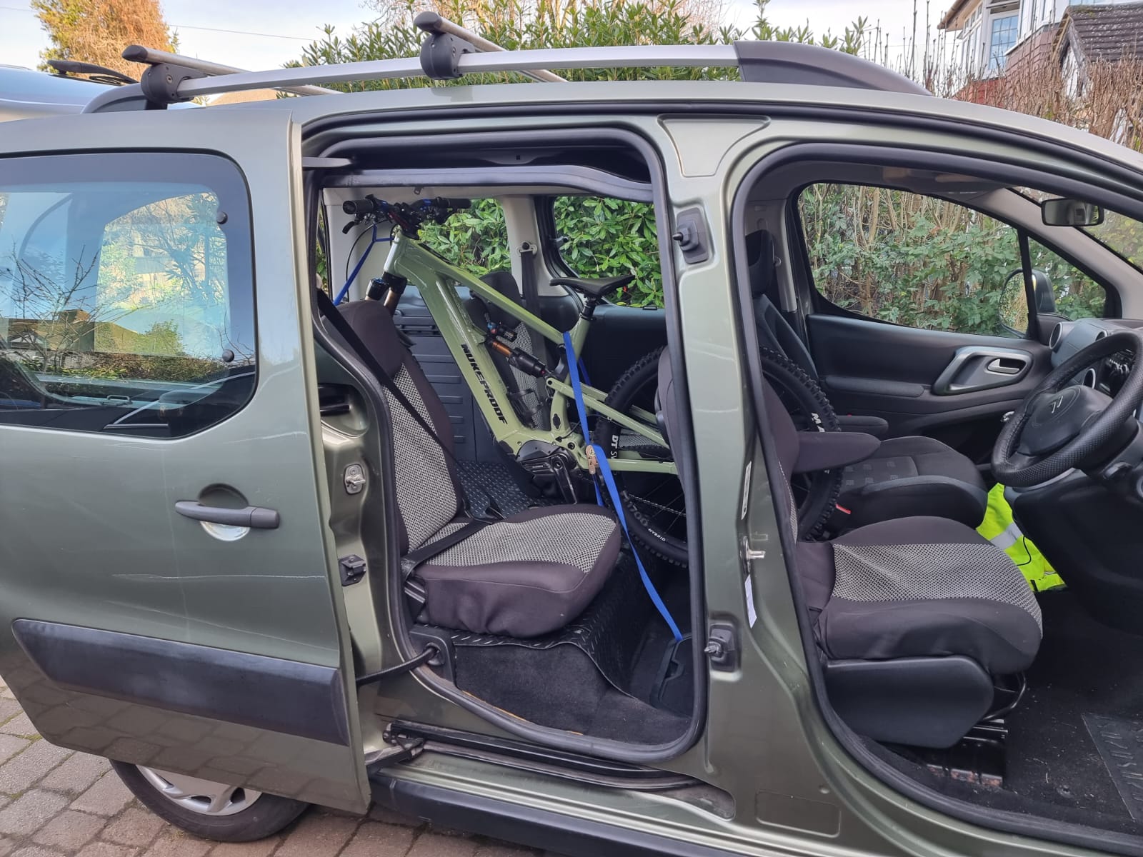

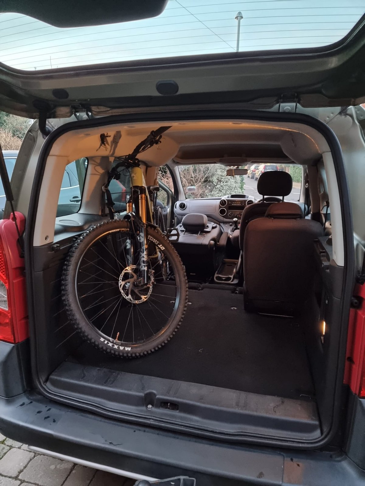

Just thought I would drop in and show my Berlingo XTR. I drove my self nuts worrying if a bike would fit a berlingo/partner mpv so I figured I'd share. I didn't want a van for a few reasons I wanted seats for the kids, faster speeds, cheaper insurance, ability to blend in, while small enough to get down country lanes with out white knuckles.
My Large megawatt 29/27 rolls straight in plenty of space for 4 people (You can fit in 2 bikes last photo, slide the front seat forward and take out one of the side seats your friend sitting behind the driver). I've added 4 extra LED lights switched to a permanent 12v two inside roof and two on the tail gate to help loading/washing. I also made my own rubber mat but it has a real strong smell (already been outside for 3 weeks) if stays strong it'll have to go. The jerry can is a home-made 12v jet washer. Window tint is ready to go in but I figured I'd take photos now while you can still see inside.

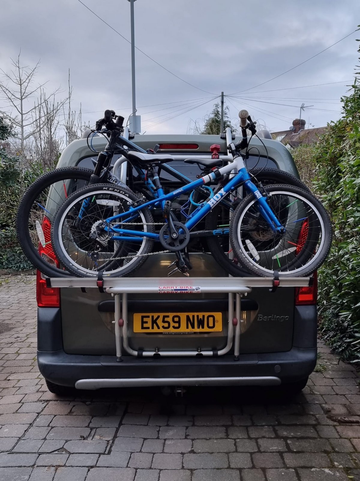

I plan on adding a T4 Fiamma bike boot rack which requires a bit of modification for the kids bikes. Its nice in the fact it can stay on 24/7, doesn't stop access to the rear of the van and the kids bikes just go right on. Like this guy has done;

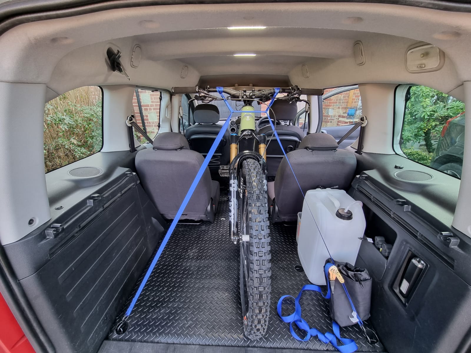

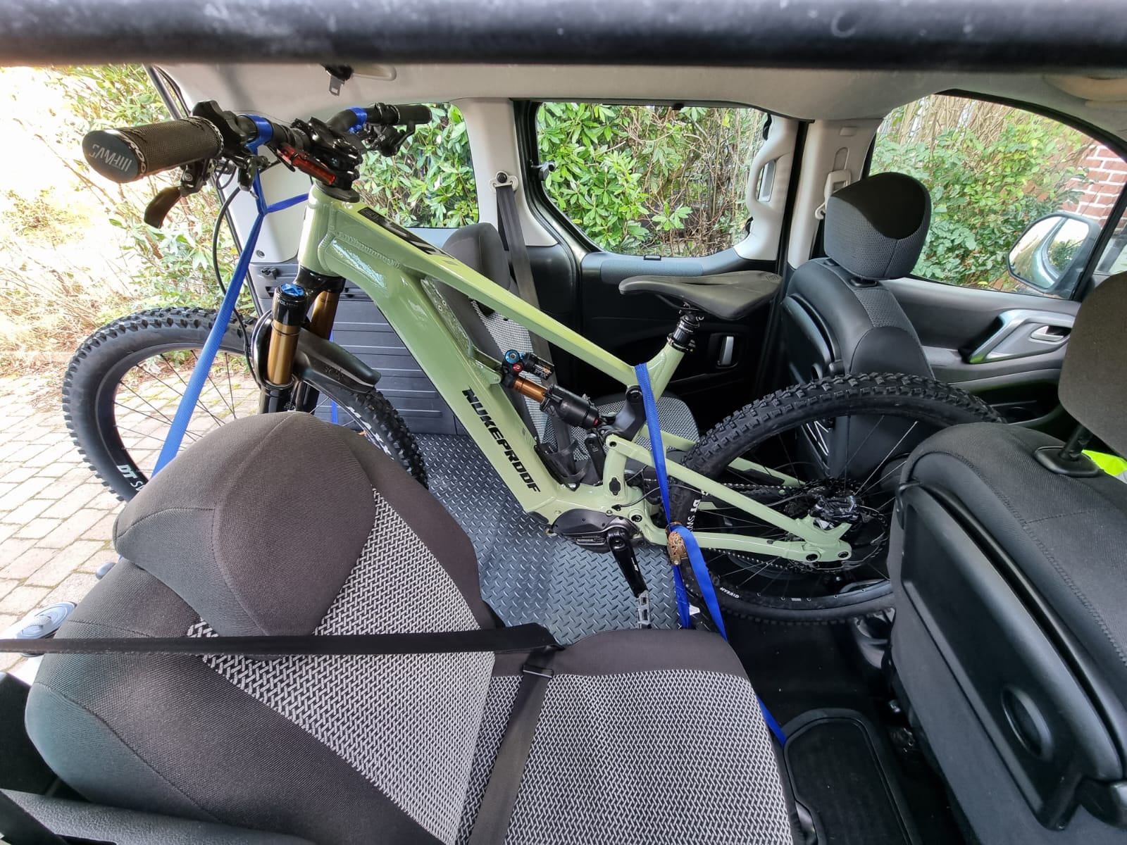

I use a Peugeot Rifter (long wheelbase version) as my daily drive.
It's a 7 seater, but you can completely remove the two, 3rd row rear seats, and fold flat the 3 remaining seats which then provides a huge area for biking trips away.
It is possible for 2 bikes to fit upright without removing any wheels.
I have a full sized rear liner fitted (Rhino covers) which is waterproof and wipe clean so mud is not a problem .

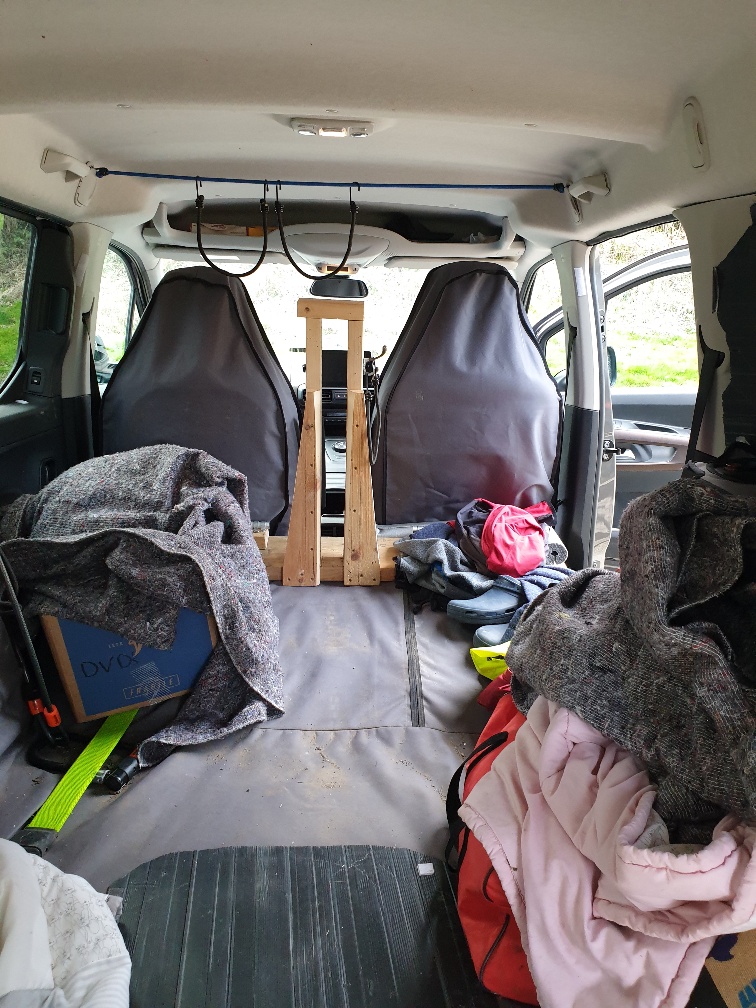

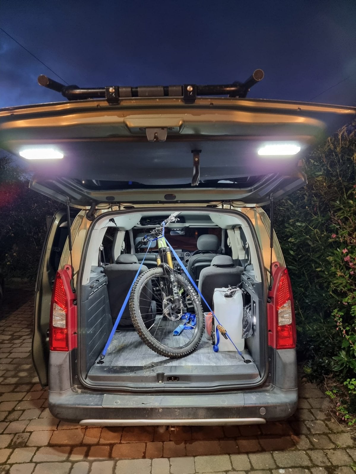

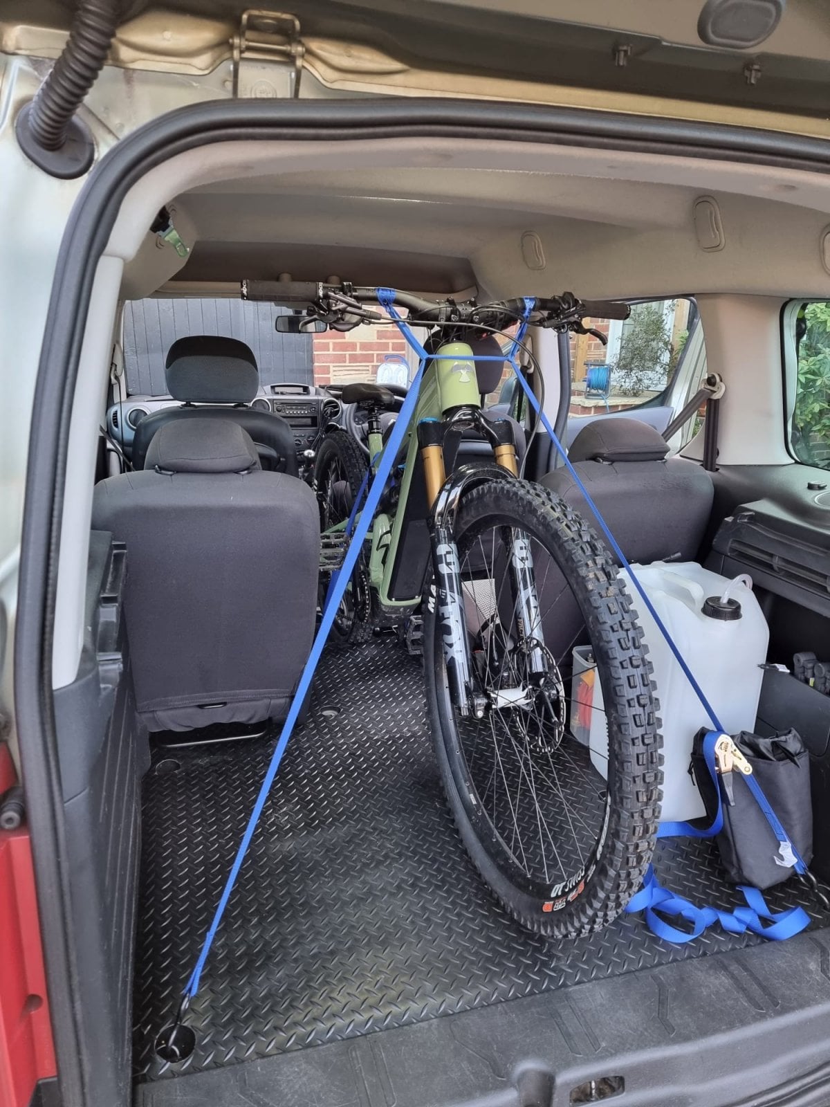

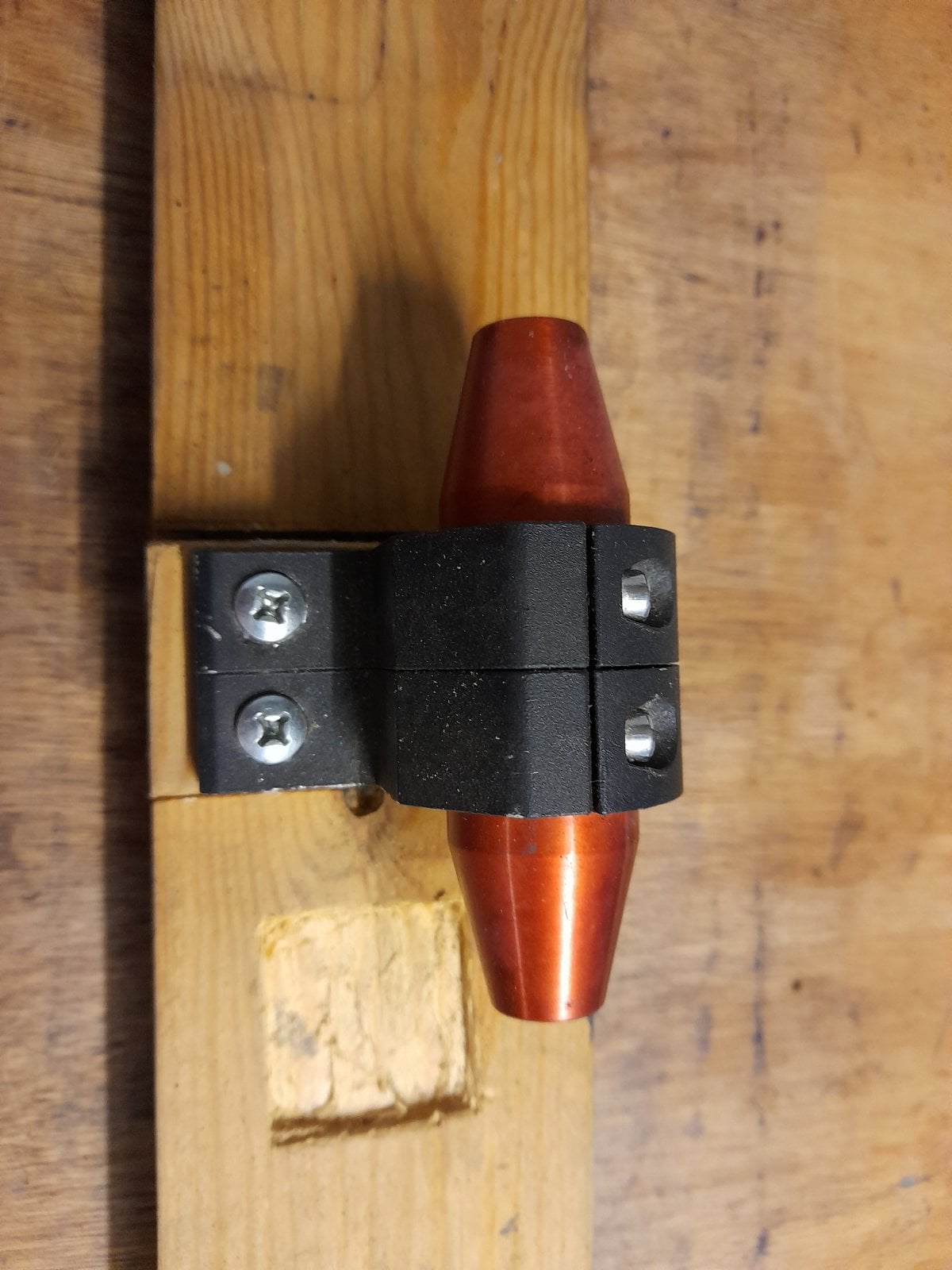

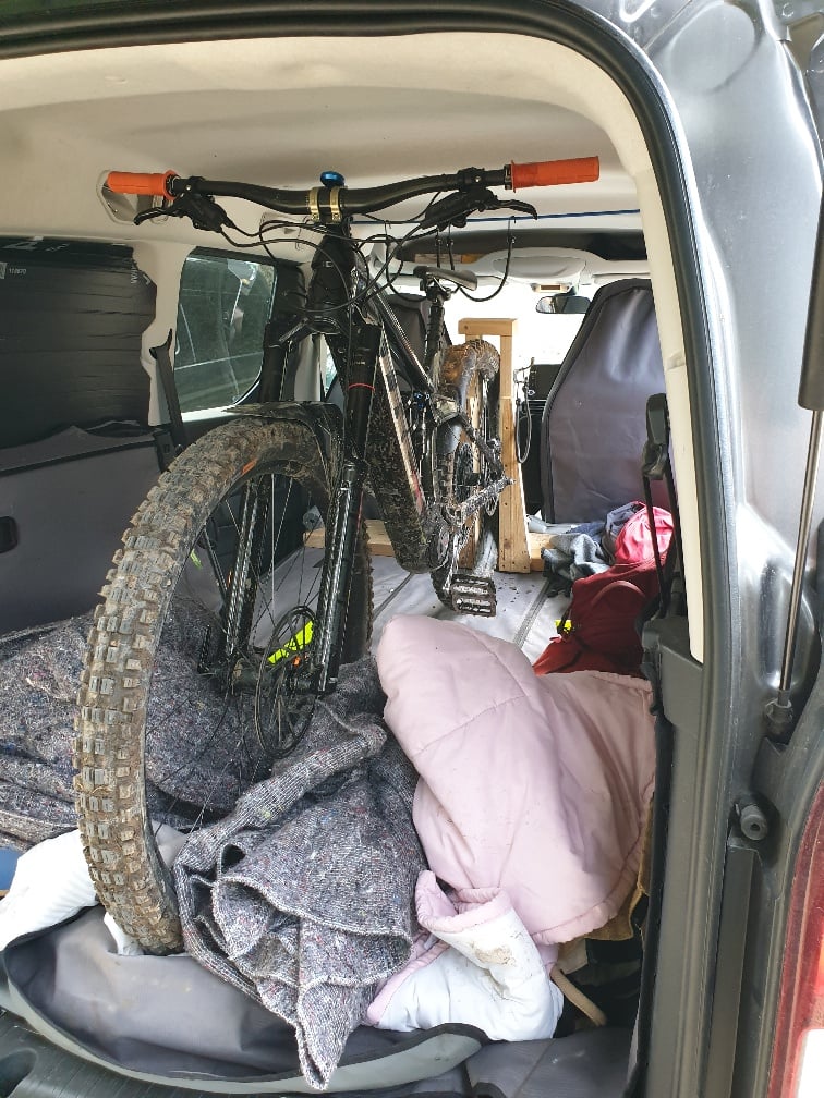

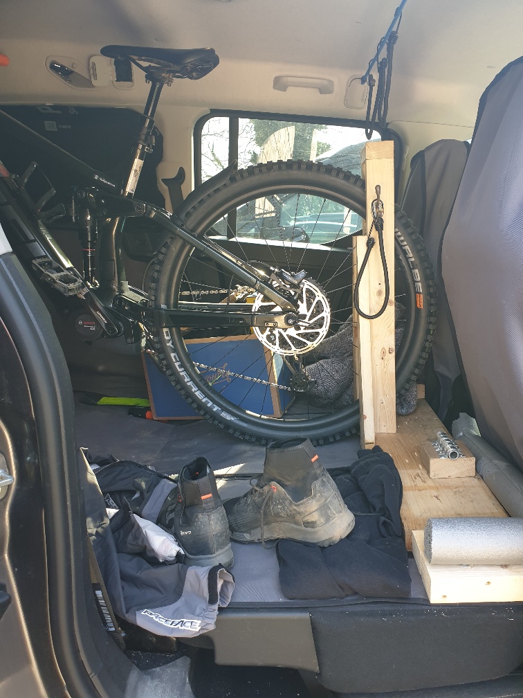

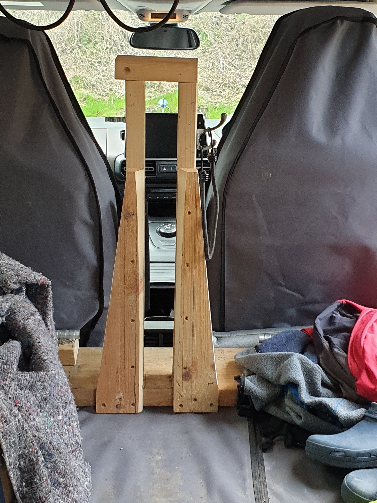

I've recently cobbled some wood together to make a bike storage rack.
It's a prototype, work in progress bodge and so far works well. I'm using square type U-bolts and the existing seat restraints to secure it to the floor, seems to work well and is also a quick way of removing the rack should the need arise.
The rack has 3 positions, the centre one is for a day trips where I leave the front wheel on the bike and insert the rear wheel into a support which keeps it very stable. I'm using a bungy cord at the moment but will probably locate/use a velcro strap at some stage.
The 2 outer positions are for 2 bikes for longer trips away/overnight and require removing the front wheels and using the fork dropouts to attach to the rack with the wheel axle bolts.
Apologies for the tip inside the back of the van, but I think it looks kind of homely, cosy and comfortable!😀😉

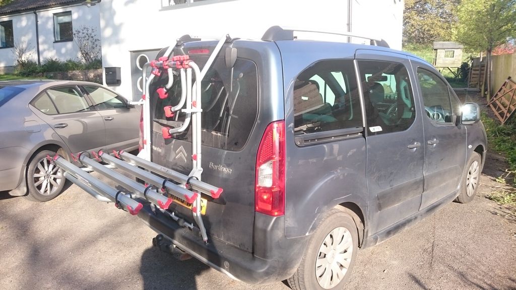

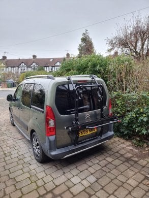

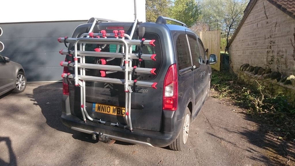

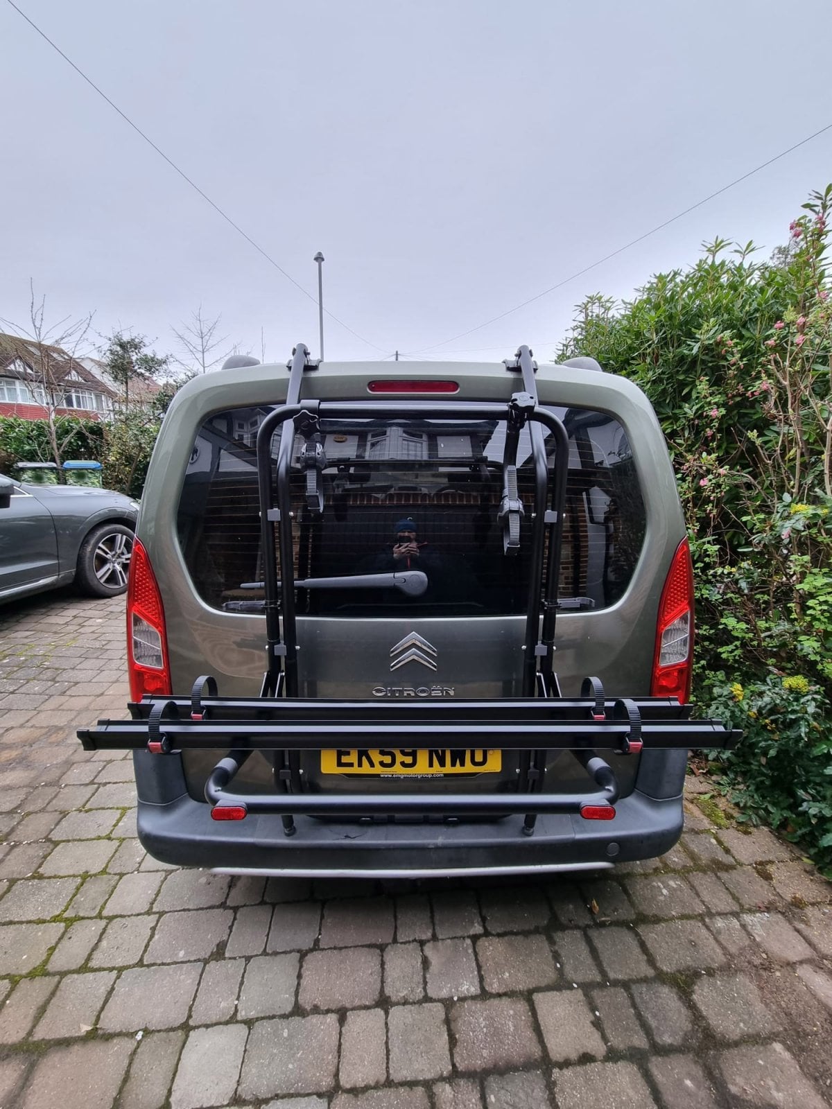

I finished up my 2nd hand Fiamma T4 rack, I wasn't happy with the silver/faded red stood out,
So (very much to the wifes dismay) I resprayed it black and 3D printed most of the plastic parts in black plus made a few new bits like the reflector mounts. The rack is for the kids bikes but could probably take 1 ebike (65kg system weight less -9kg for the rack itself) which is handy. Worth noting you'll need to upgrade the gas struts (oem+9kg) just call SGS and they'll supply you with some. I need to make up some mountable lights as the wheels do cover the brakes/indicators. Also limo tinted.

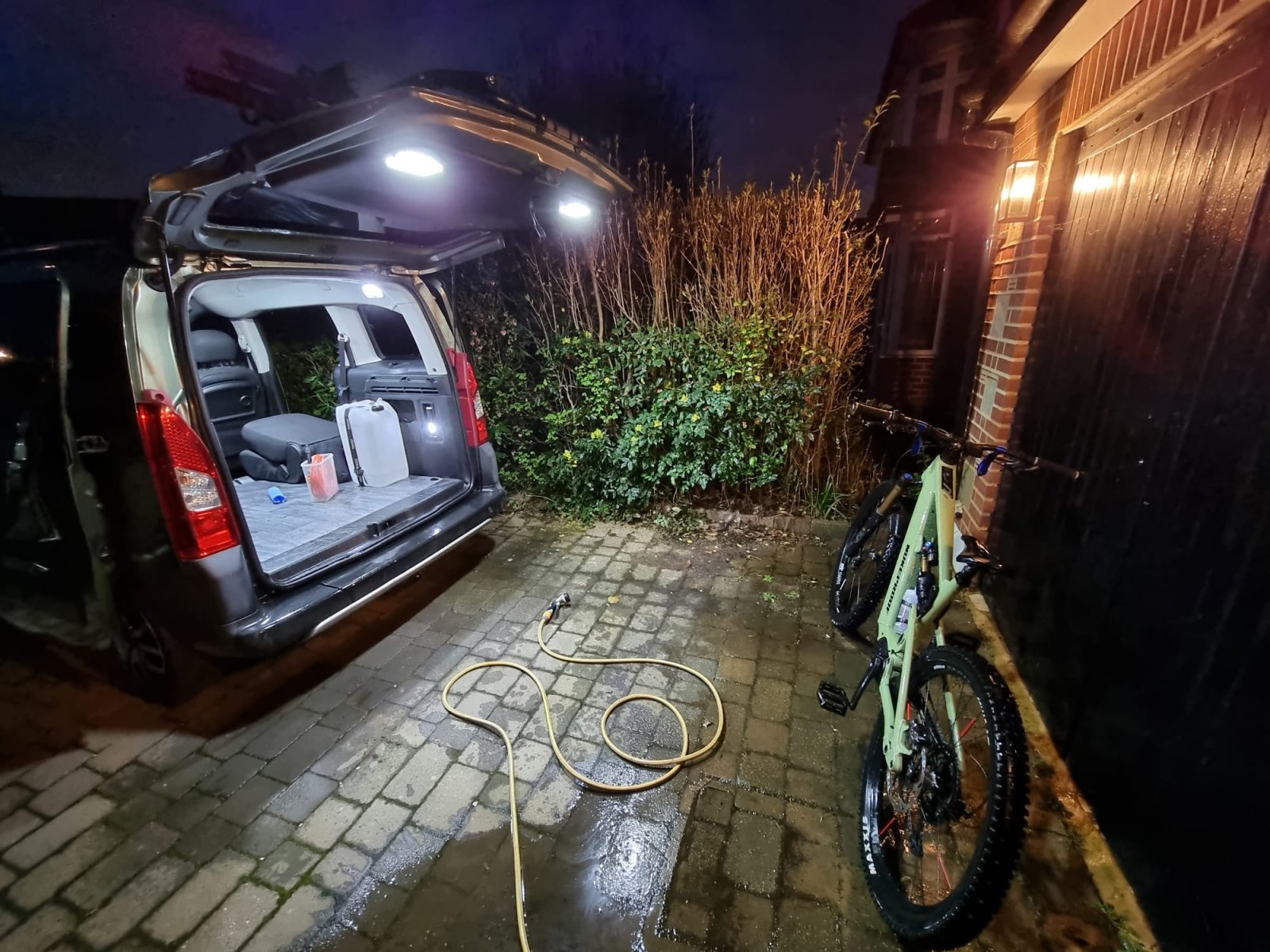

The 12v washer worked a treat today not really a jet wash more a garden hose which is perfect for me and the bike! I took 2 wheels on Large mullet ebikes plus a passenger today in comfort. The ratchet straps are going in the bin they were awkward to use, I just knew I was going to get pinched and sure enough one took a good chunk out my thumbnail, replacing with cambuckle lashes.
the extra cargo lights really worked out well for after dark returns

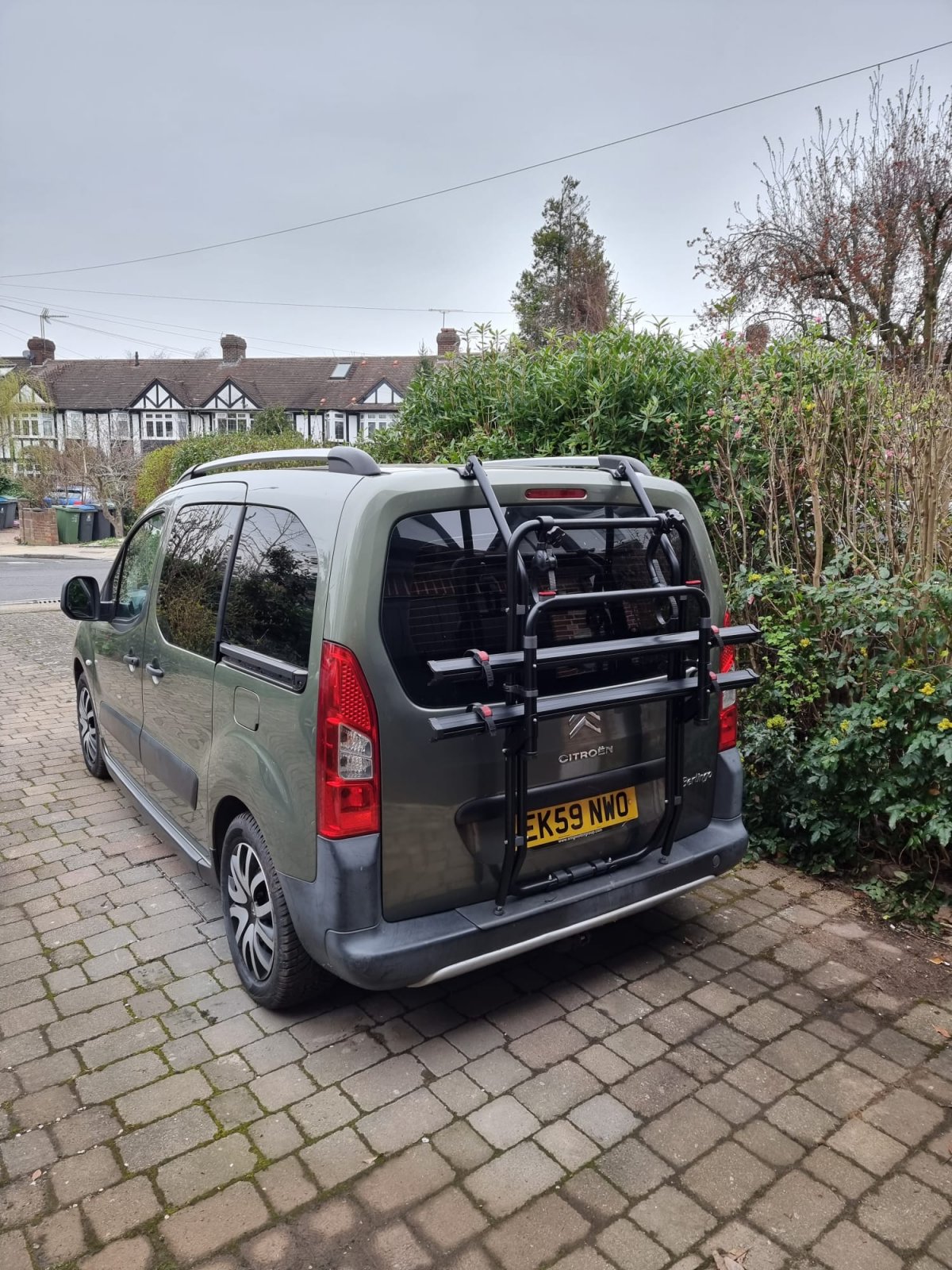

👍 I like those cargo lights! Where did you find them please?
Which circuit did you splice into? Thanks 😊
I used these www.amazon.co.uk/gp/product/B09KTSP15F
I tapped into the permanent live for the tow bar electrics which was in the rear of the car. I made a post about it on the berlingo forum;

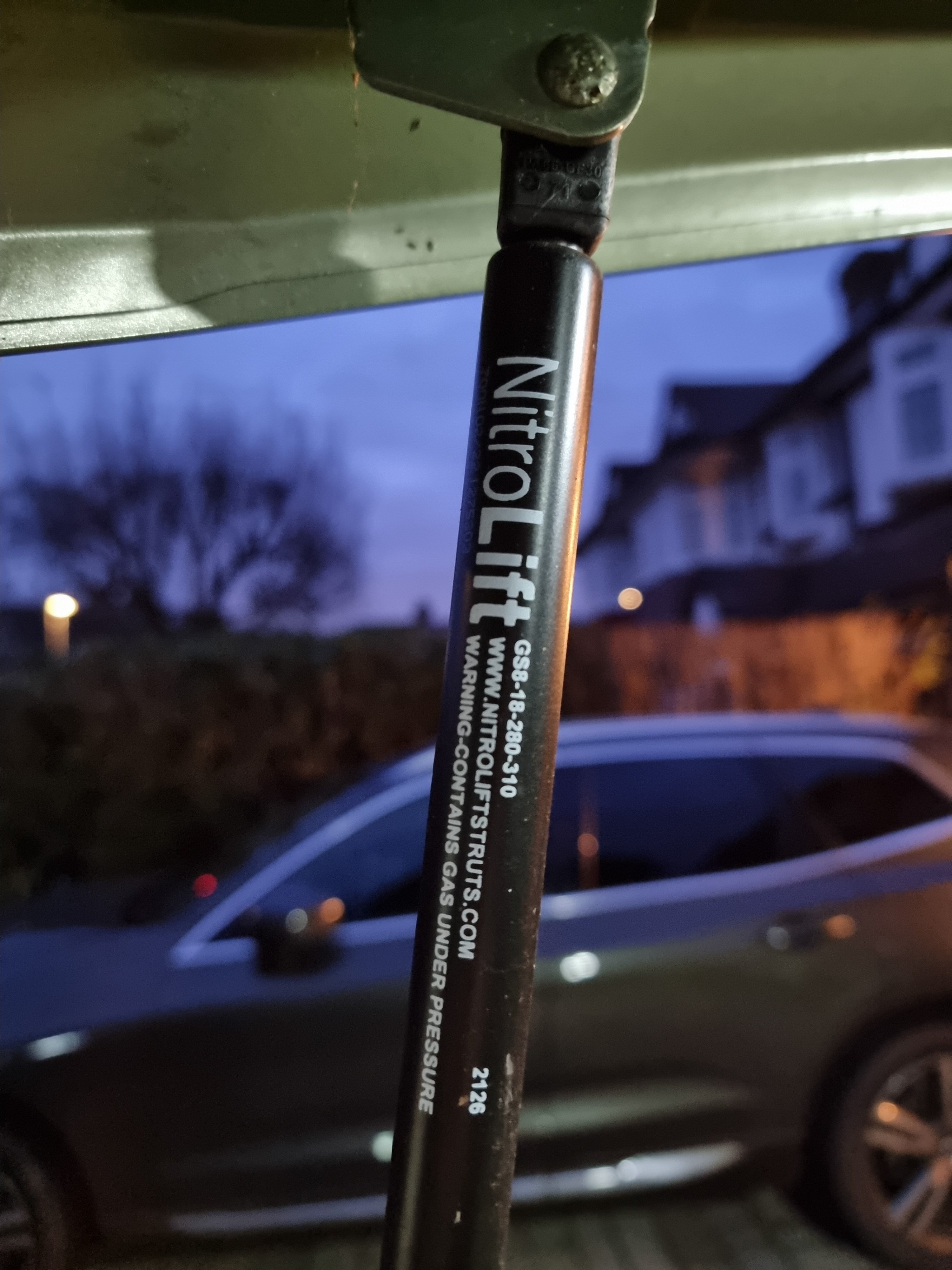

Hi, I'm about to do the act same thing with a second hand fiamma rack, I contacted SGS about the struts and they've asked if you know what NM force struts you ordered? Also, having trouble downloading the files for the 3d printing end caps etc if you can help in any way?....cheers
