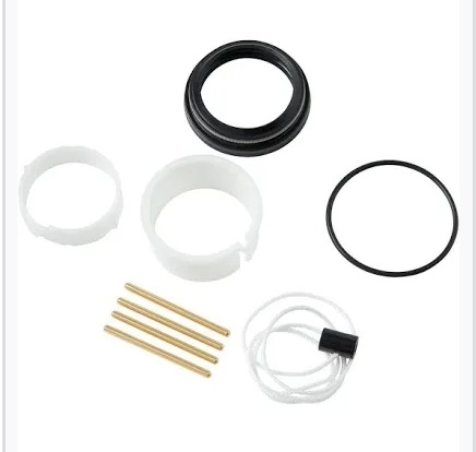

I started to dissemble it recently to give it a grease and noticed there was a bit of white string connecting the top mechanism to the bottom of the post, which then promptly snapped where it was frayed.
I thought the previous owner must have bodged it but no! The service kit does actually include a new piece of string 🤣

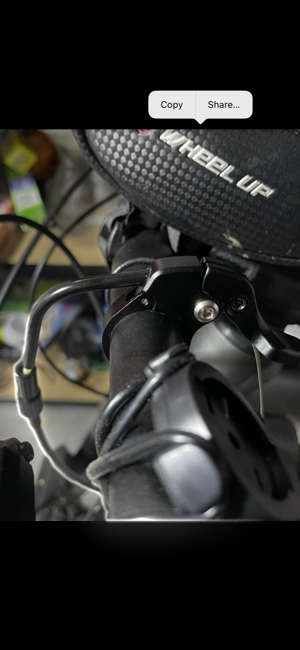

Fitted my dropper for the most part this evening but stuck at the last hurdle - the instruction manual has the side on lever but I have the vertical lever like pictured above.
The final steps aren’t in the manual,but looks like I’ve done the same as in the picture above . I have routed the wire into the handle, then back on itself through the tiny cylinder with the hole in it.
It then appears I need to tighten the grub screw but I cant, it won’t budge….. obviously as it has a cable through it. I’m confused.
With the cable ran through the hole in the cylinder, you want to hold one side of the cylinder with a 3mm hex and then screw the other side with a 2.5mm. I usually have the wife hold the 3mm so I can pull tension on the cable with one hand and tighten the 2.5mm with the other hand.
Legend - that makes total sense thank you !

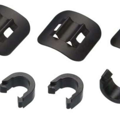

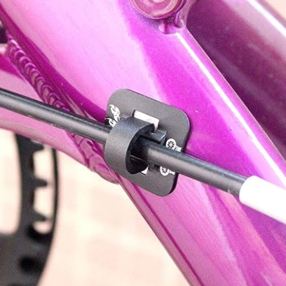

You can also get these for when you're running externally. I used some a few years ago on an external dropper cable to replace my zip ties round the frame.

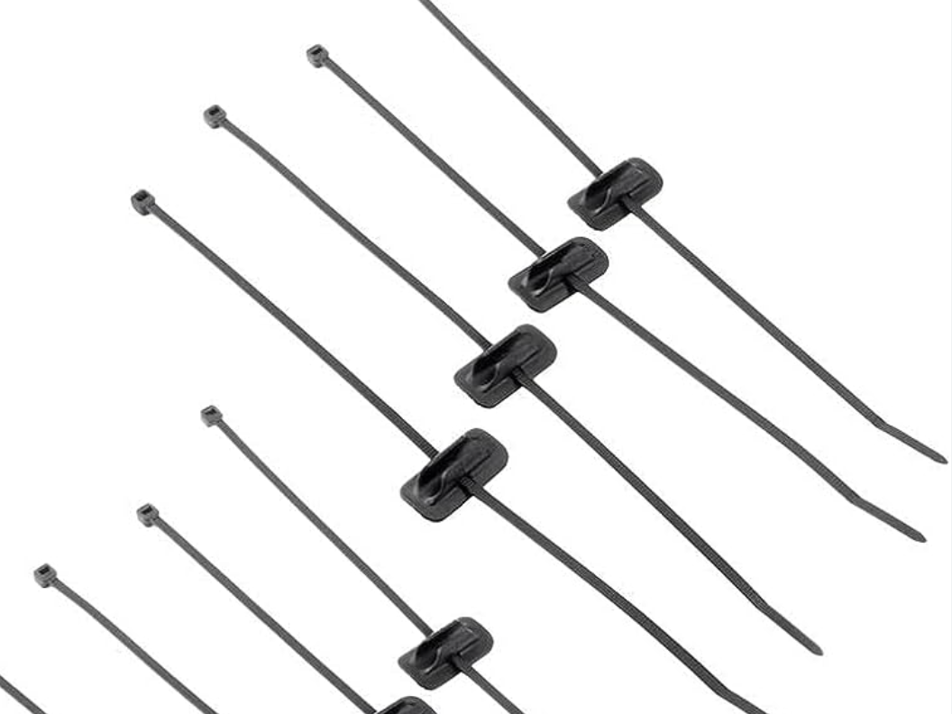

There's also this type, though you can also run a small zip tie though the ones above if you prefer :
Jus search amazon/internet/ebay for hydraulic hose adhesive cable guide - and various mixes of those :)
