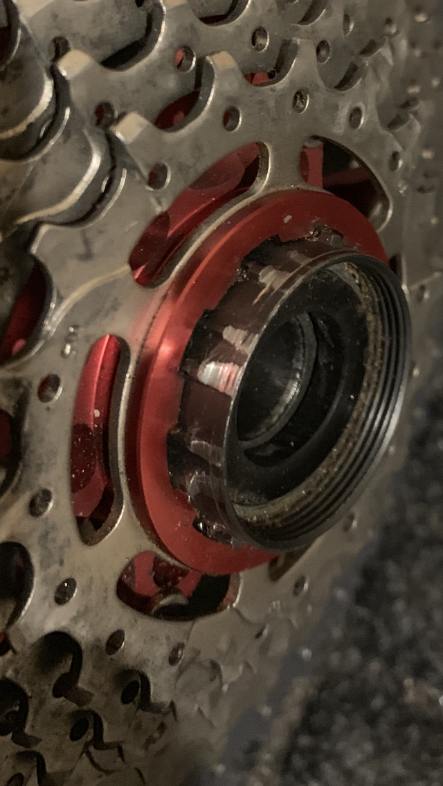

Maybe check yhe freehub type. You need a better freehub for ebiking, steel is better than aluminium? More power means the cassette digs into the aluminium?
This is quite true. When I bought my 2018 levo I also bought a specialized traverse SL 29 wheel set with an aluminum free hub and the individual cassette gears have gouged divots out of the aluminum free hub where are each individual gear in the cassette engages the grooves of the free hub. Sure enough the free hub body on the OEM rear wheel is steel when I put a magnet on it. Since then I have filed down all of the gouges and the free hub still works but I am being a lot more careful with shifting under load.
I totally agree with this one. Alloy bodys suck in general, on ebikes I need steel. That's the main advantage of getting an ebike specific wheelset, or rear wheel, they're usually steel bodied.

It's just a fact that steel sprockets dig into Alu freehub bodies whether fitted to a regular bike or an Ebike. There's no real difference in how badly it happens on Ebikes. However It does happen more easily and gouge deeper if the cassette lock ring isn't done up tightly enough though.
Every single Alu freehub body I've ever owned (lots) has had sprocket gouging marks.

Sure, they suck on both. I lived with it to keep weight down, I'm not doing that with an emtb!

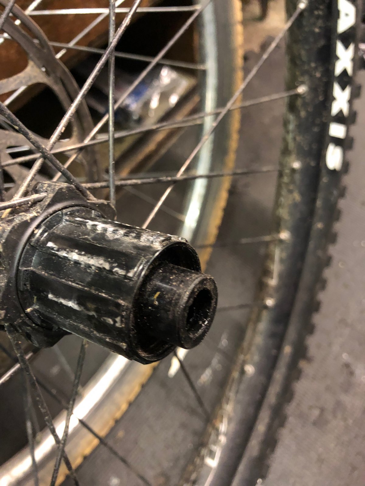

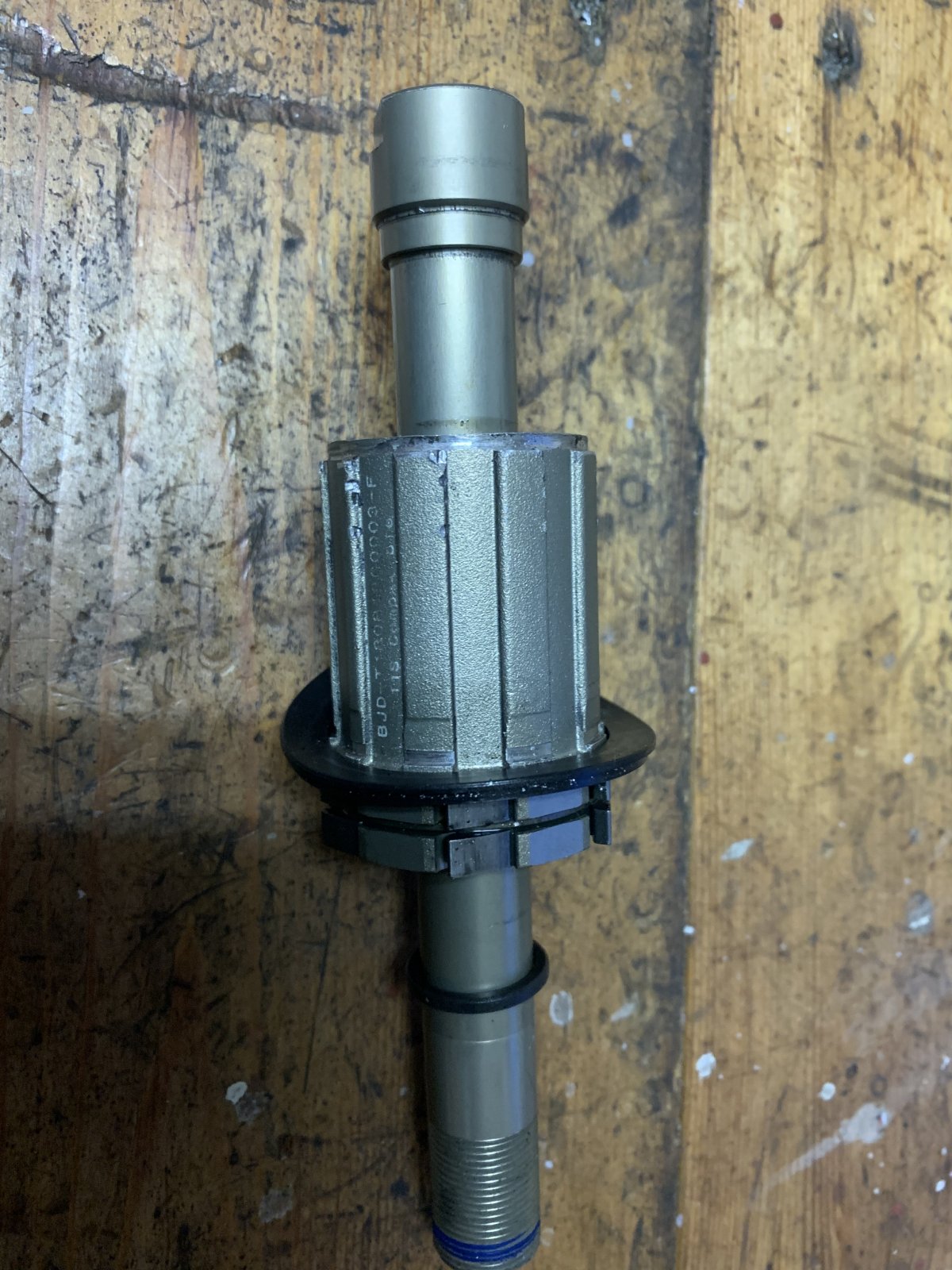

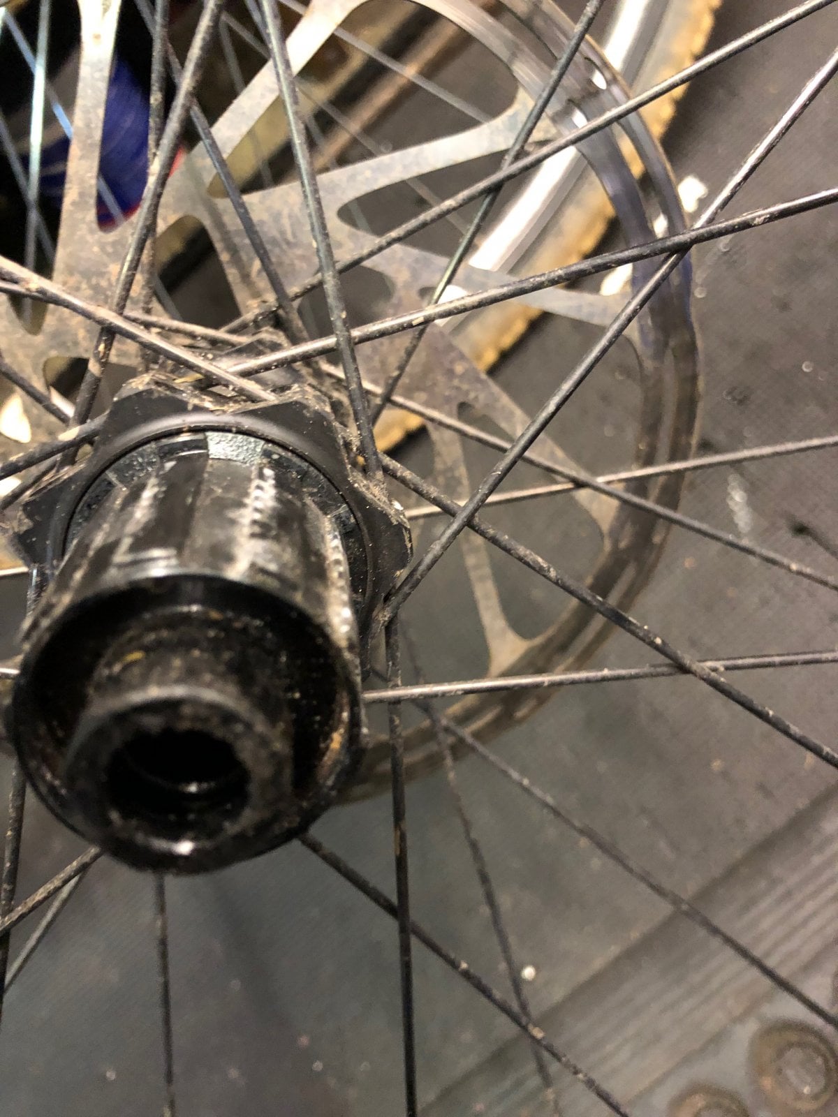

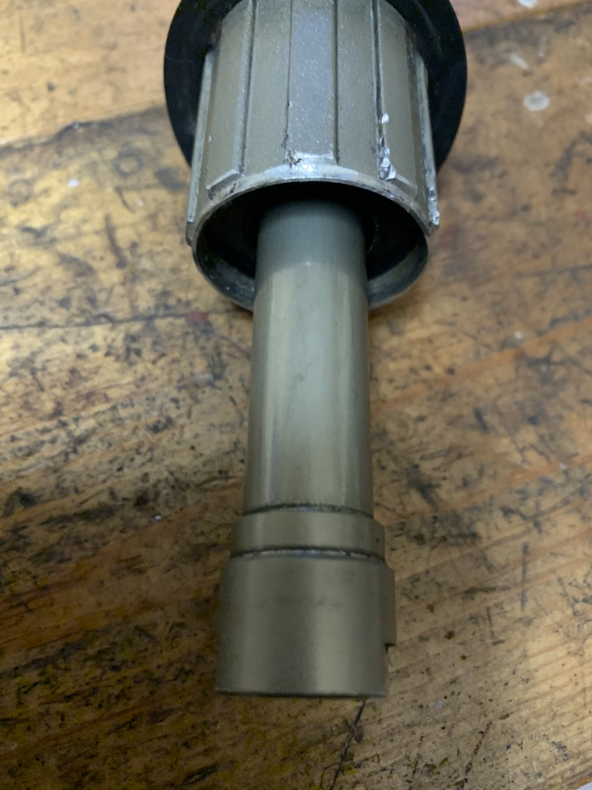

As for alum free hubs. I have had the 11th sprocket strip the freehub several times now on ebike and before taking apart check to see if the lock nut was torqued to spec and it was.
I have also found that using a thick high psi grease on freehub before assembly increases the life considerably as it dampens the blow to the hub splines. As u can see that freehub doesn’t have a lot of miles on it look at condition off cassette teeth

I tend to agree about that EMTB gimmick and then up the prize 30%. However I have found that especially rear hubs live a hard life on an EMTB as the extra power from a motor sure put extra strength on stuff.
This is the freewheel/axle from a Novatec D412 hub and by no means super high tech but considered a strong hub, on my Levo it lasted less than 100 km before the freewheel looked like this and the axle bend so much that the rear cassette was wobbling in a way that gave continuous ghost shifting in all gears.
Karsten
I have no experience with those but the axle shouldn’t bend after 100km regardless of the bike. Many ebikes are coming with cheap Shimano hubs and they last longer than that one.

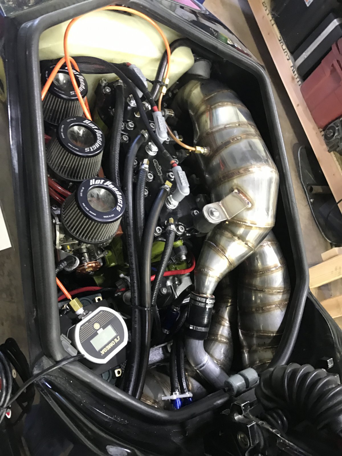

I build things like this
That’s 643whp. Unridable above 390to420whp.
And the ski is 278hp.
That’s my moto test track in my front yard
