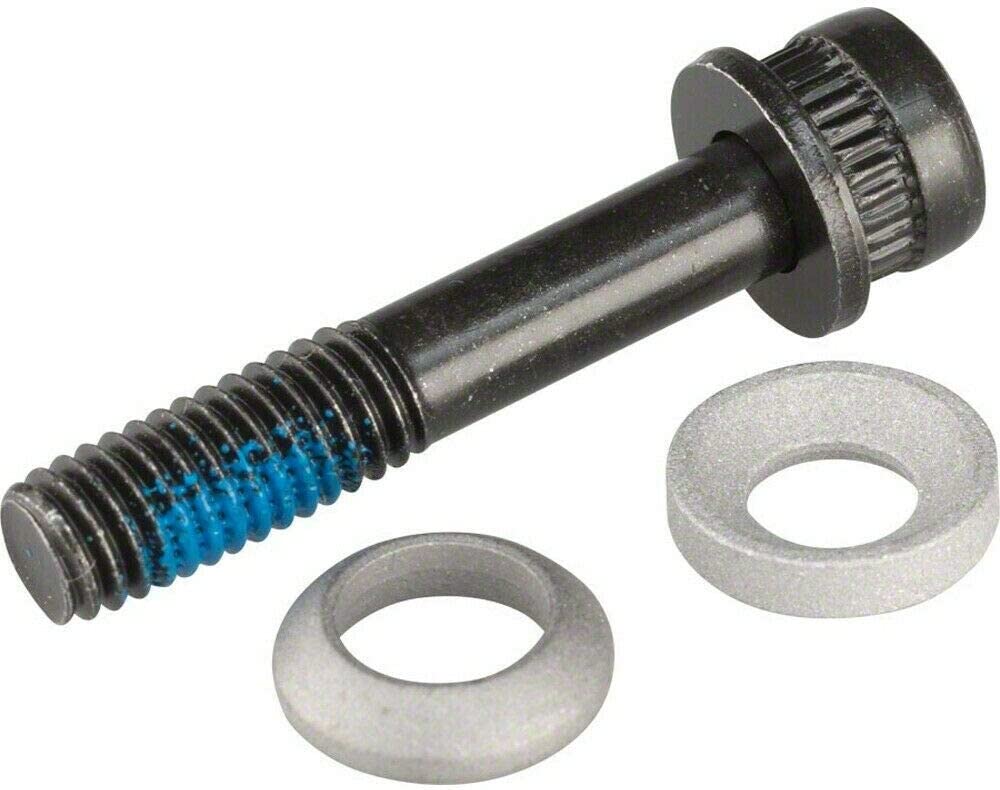

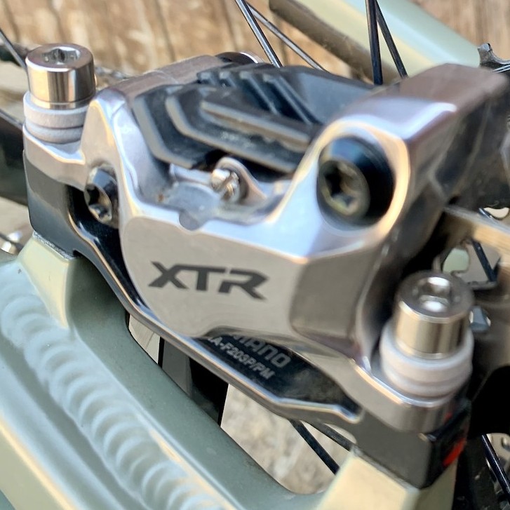

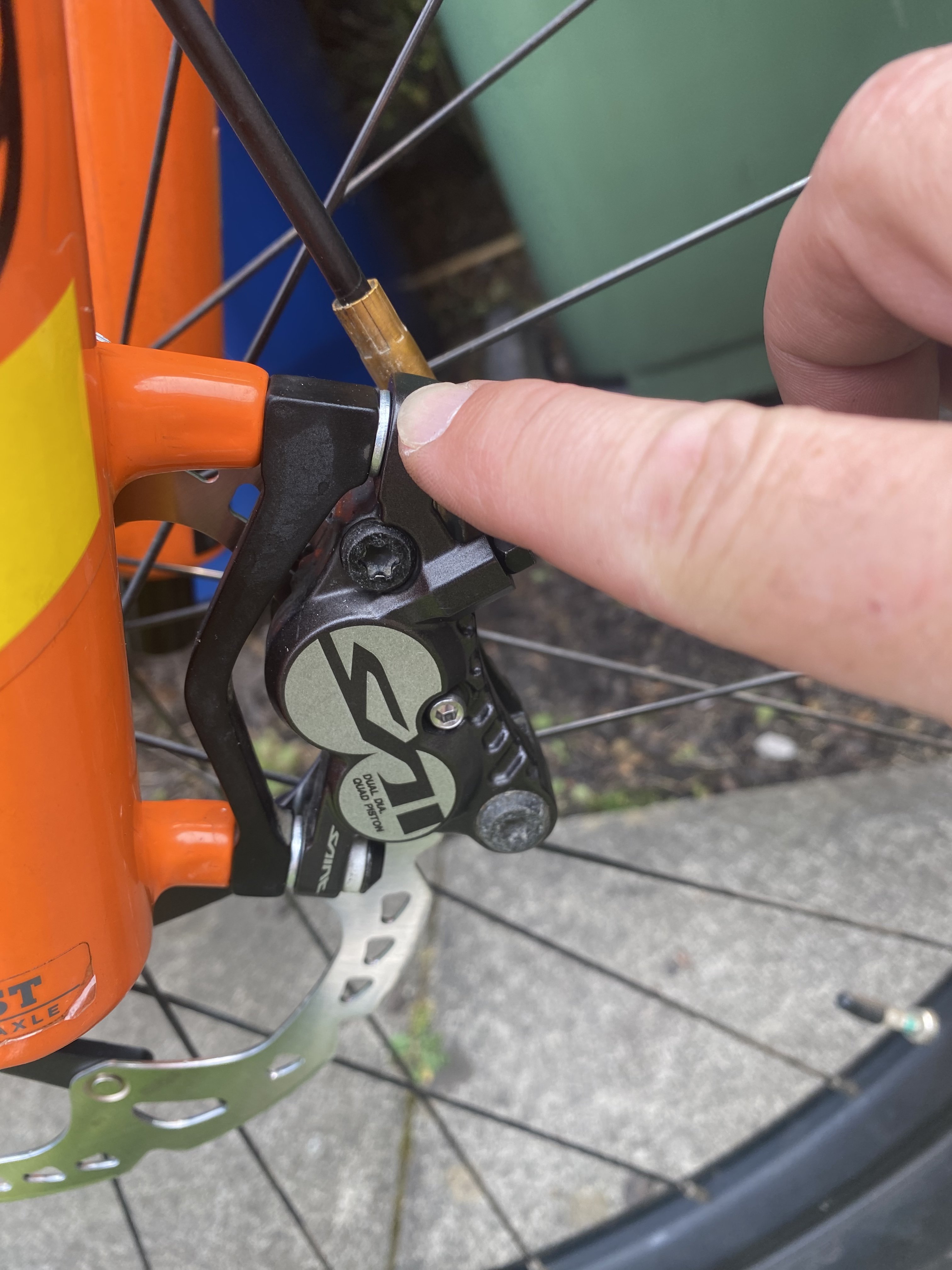

These old bolts need to be replaced. You basically just need new M6 bolts in the correct length with their ajustement washers, also known as cup & cone washers. Don't forget the latter. They go under the bold head, and not between the frame and the post mount or the postmount and the caliper. Should look like this (example):
Right thanks, for that
Full service next week so I’ll look into where to buy the bolts from👍

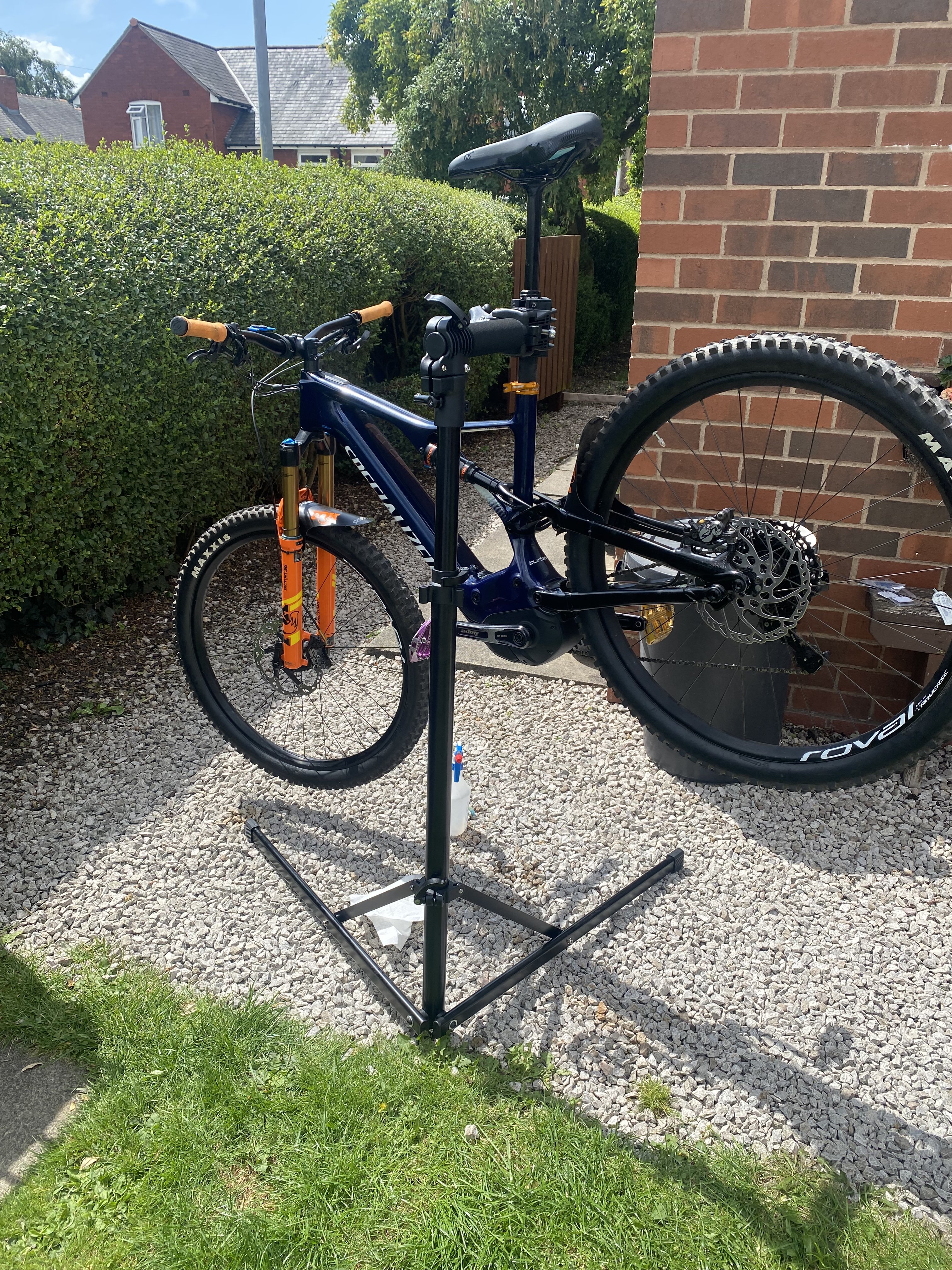

Bikes had a good service, looks much better. Headstock , wheel bearings and fork service yet to do, by local bike man, then it’s ready to go!!
He’s done a great job👍

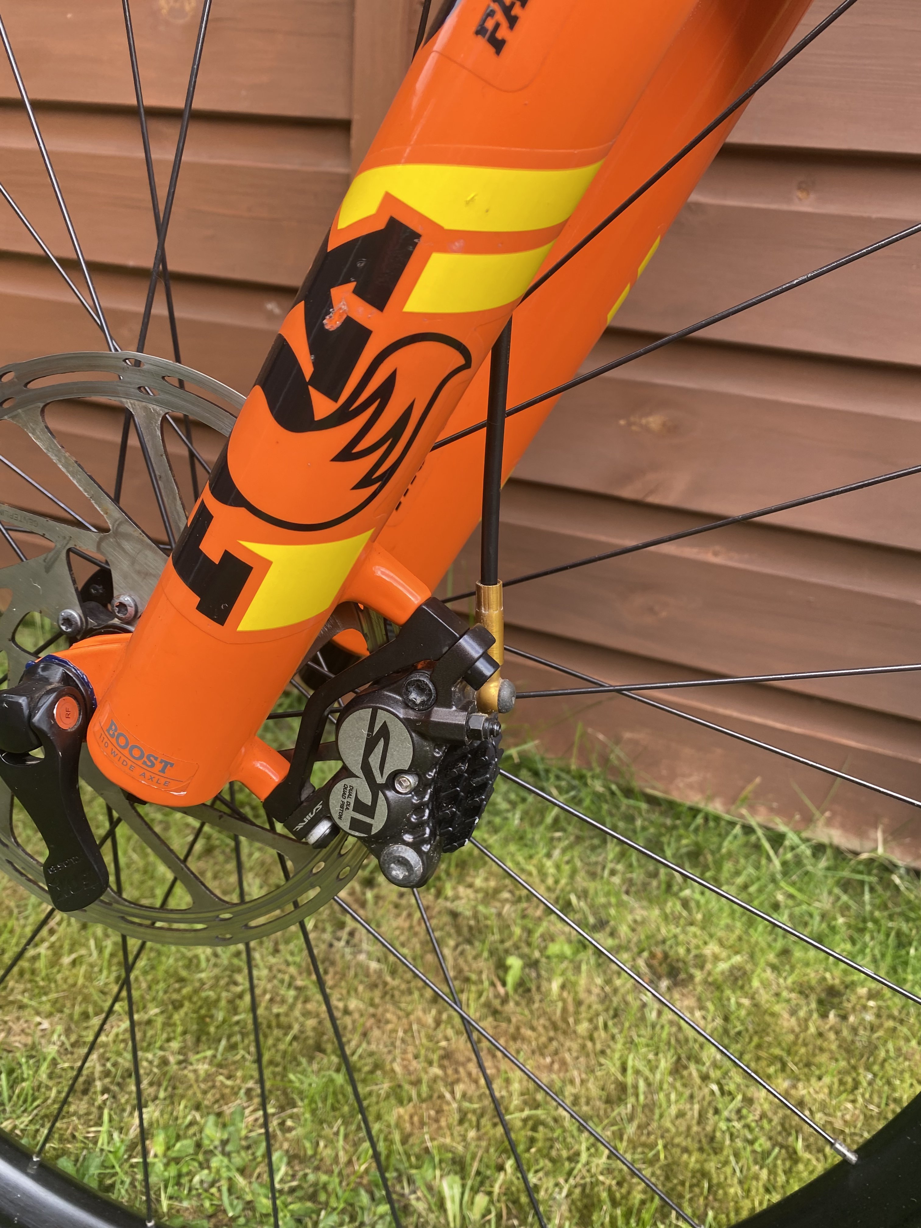

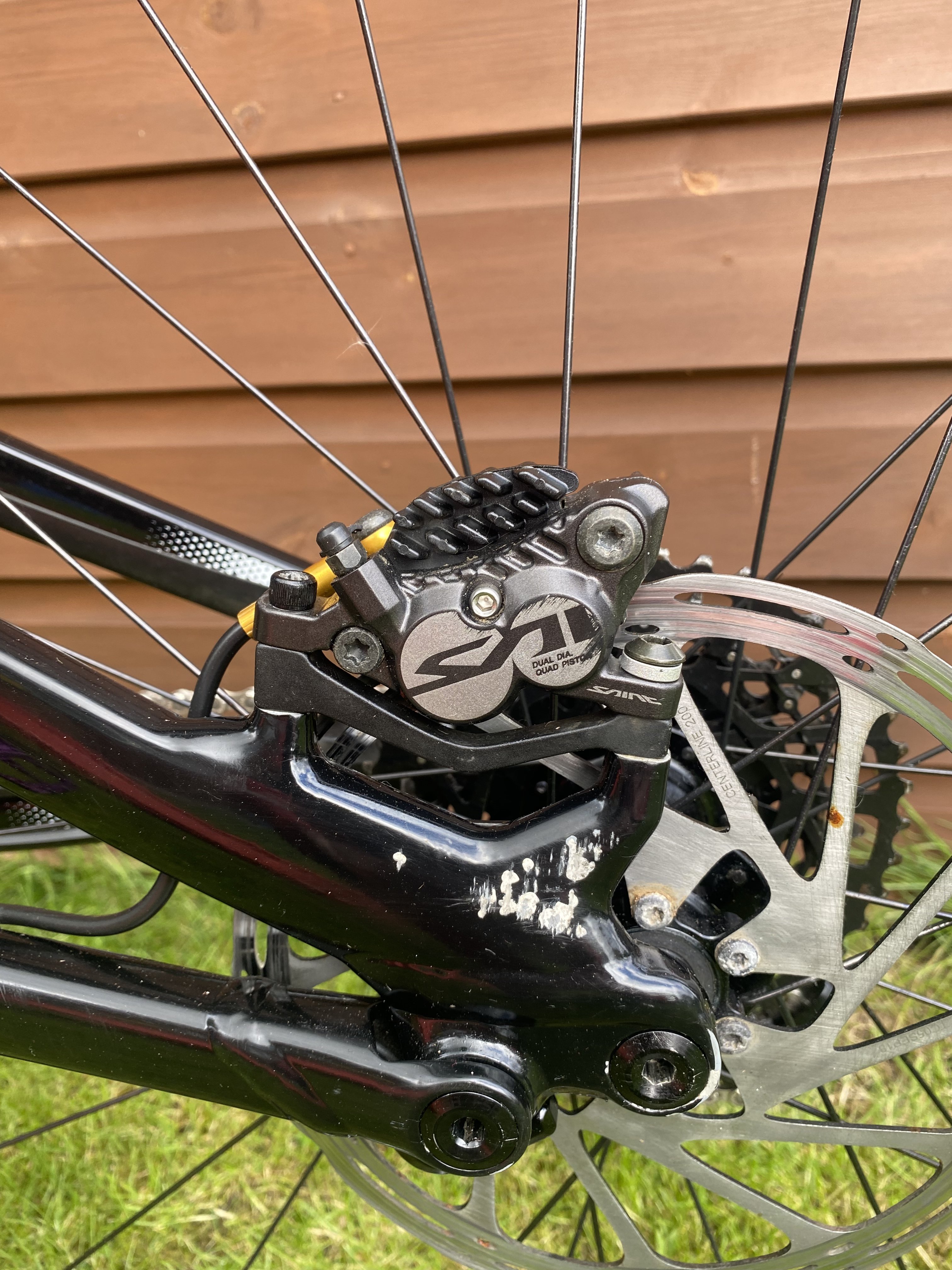

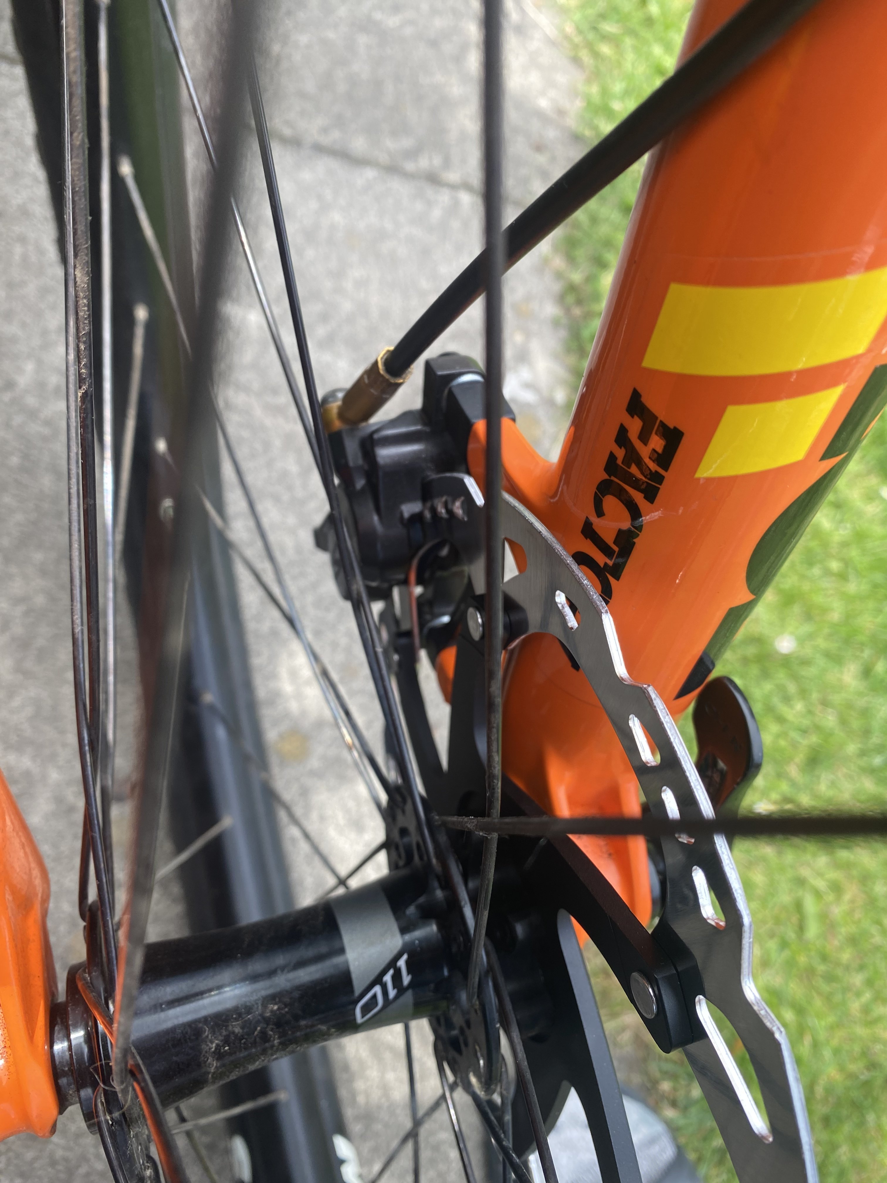

If you see above posts, the PO fitted saint brakes and they looked odd, with loads of washers.
So the brakes were making a horrible squeaking noise so I decided to change pads and rotors. Once new parts were fitted the front wheel wouldn’t turn and the rear caught slightly, and thought it was because the parts were new at first, but I noticed the disk was catching the actual caliper, so I had the use a washer as a spacer , this solved the problem and the wheels turn fine.
Hope this helps someone sometime😁👍
5E585569-FD71-4813-8F53-D2F4B38DE96C.jpeg 9B049B88-69DD-4456-BADF-FE6D8A44FBEF.jpeg 4DFB6616-B762-4F6A-9FC7-11783708A637.jpeg 782927DA-4E23-48D9-AB23-4236064B6098.jpeg
Are they shimano 203mm disks when the mounts are for 200mm perhaps?
Bike looks great BTW. It's cleaned up really well - almost looks new!
Yes they are 203’s, that’s what they had in at evans or it was 180’s , the tech said they use the ones given🤷‍♂️.
The washer seems to work ok though.

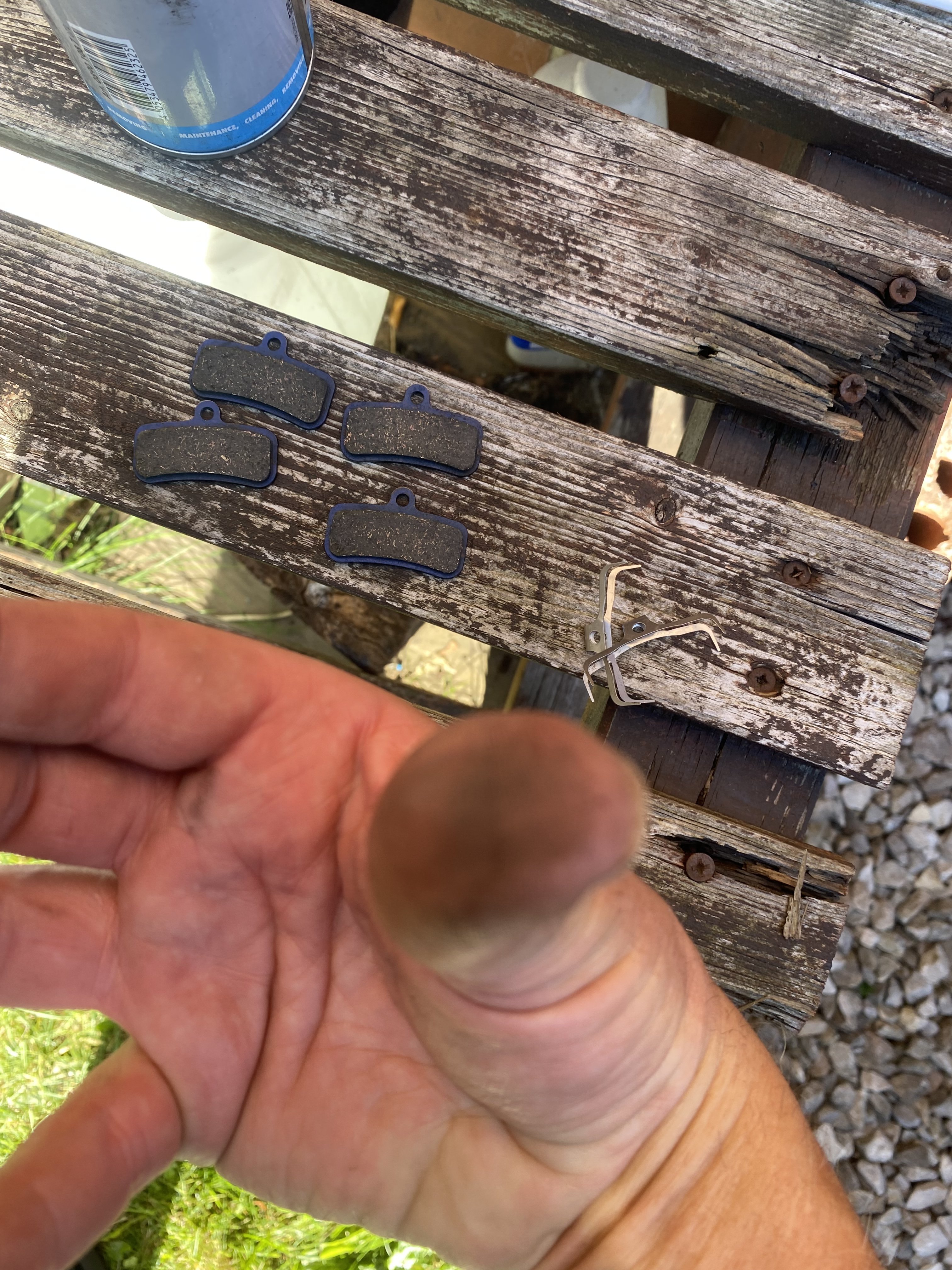

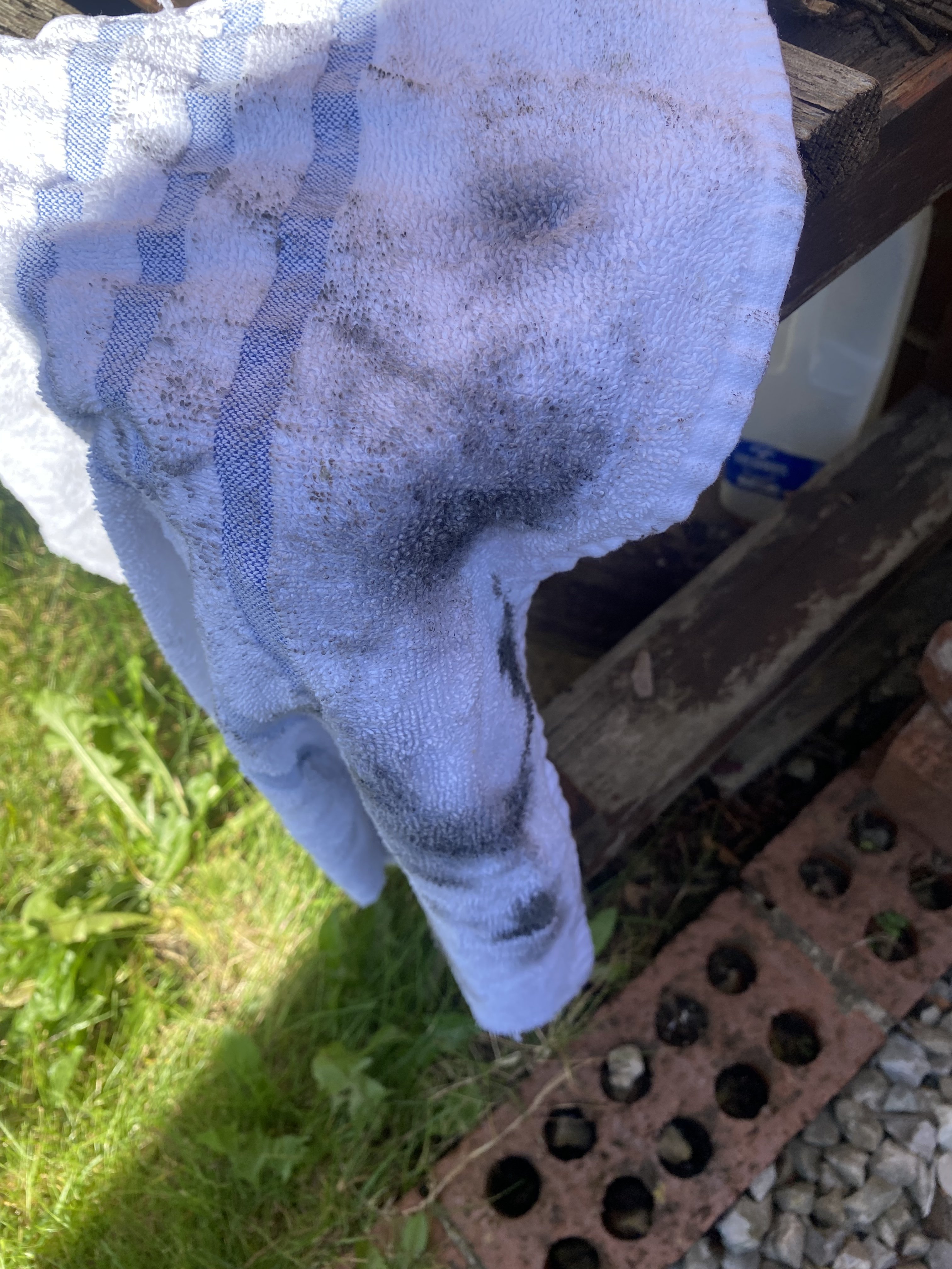

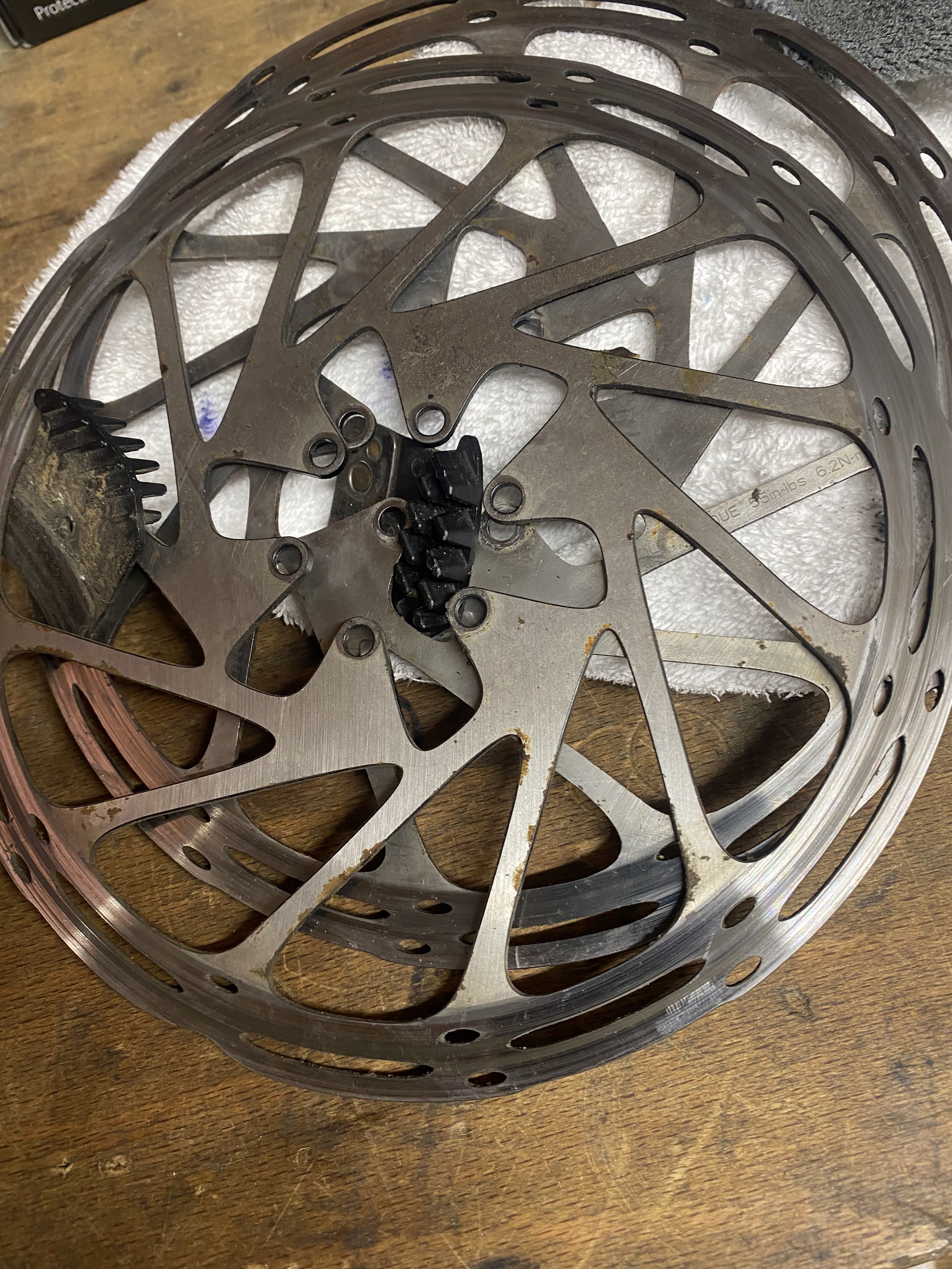

So I took the pads out and cleaned disks and pads with isopropyl, then sandpaper.They were black with carbon
I then put it back together the tried them again, just a little ride down the street, first few times it was ok , but when applied a bit harder they started to squeak again, so I brought it back and back off with the pads , black crap on again, so I just cleaned the whole lot calipers etc…., then did disks again with isopropyl. I’ll get some new pads . The pistons seem to work ok, CD95CE5F-848B-4B67-8394-C00B429EDCC8.jpegC4818CFA-F5B1-4905-B861-044B24A4F0E0.jpeg
One other thing to check. Take a look at your rotors and see if they are marked "resin pads only". Make sure if so that the pads used are indeed resin rather than sintered.
So checked the disks, and there is nothing wrote on them regarding pads, so am I right in saying any will do?
BL 820 B is the saints pads needed, which ones are preferred to go on?, resin or sintered?
Thanks
Thanks
your existing pads suggest your brakes are deore XT so the pads are D02S for metallic( sintered) or Do3S for resin. Metallic are best for harder riding, resin is quieter and easier to bed in but best for less extreme riding. ( BL M820 B is a brake lever)
