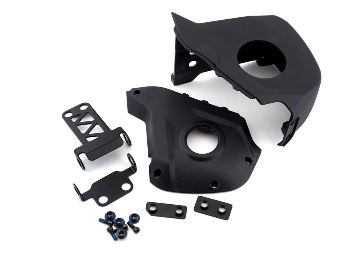

Updated Cover kit Part # for 2019 Levo
muzzman1
Feb 11, 2019
152
140
Los Angeles CA
I picked up my Levo in the beginning of Feb, unfortunately it did not have the updated cover. I contacted Specialized support and they got back to me with the part number for the new housing. S194200013. They asked me to contact my local retailer (which I did) and the retailer was happy to order it under warranty for me. Once it's in they will install if for me.

So I got a call back from my local service store, and he let me know that the new cover it NOT covered under warranty, and " it is also recommended that the motor mount be changed" as well since they would have to pull the motor out to replace the cover. The parts and labor are about $200.
My question to all of you is, does all of this really matter? In my case after each ride a bunch of junk gets in there and I just get as much out as I can. I suspect very little is getting past the sponge that is in place.
Stephen
Jan 10, 2019
34
52
Mallorca , Spain
Just a comment regarding the need to extract the motor in order to replace the covers . Thats not correct . I changed them myself , was no problem and no need to touch the motor .
Paul Mac
Jul 9, 2018
992
1,045
Uk
No, I don't think it is worth changing if you have to pay for it.
I have had the cover changed on mine under warranty.
Apart from the extra bolt holding on the side cover there is no difference, the new cover still has the massive hole in the rear of it, which is where most of the debris gets in anyway.

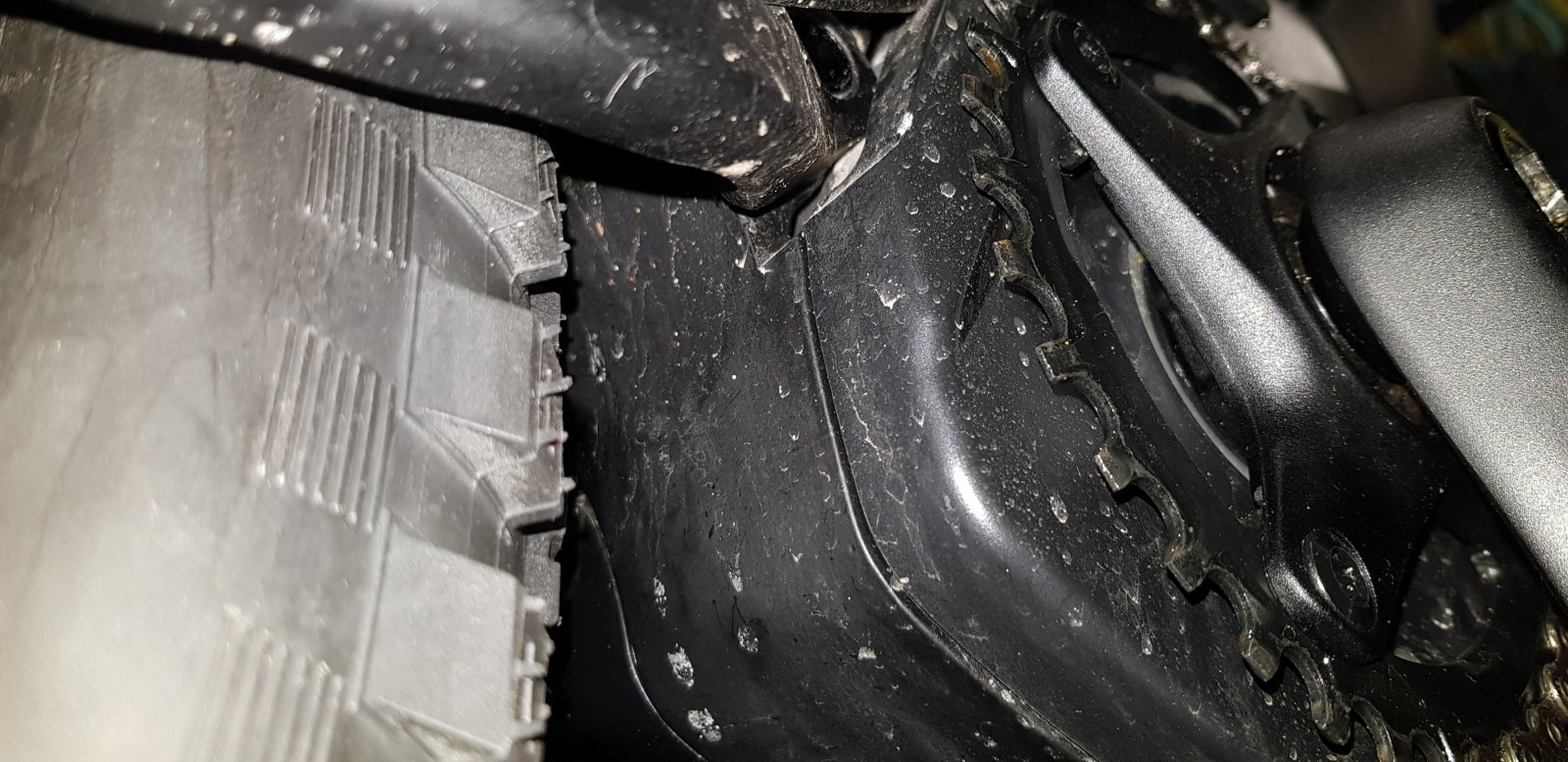

Leethal1
Dec 4, 2018
37
20
SoCal
My cover has large gaps along the mating surface.. closes well with duct tape but that is not a great fix.. if the 4 screw cover fixes it, should be a warranty.

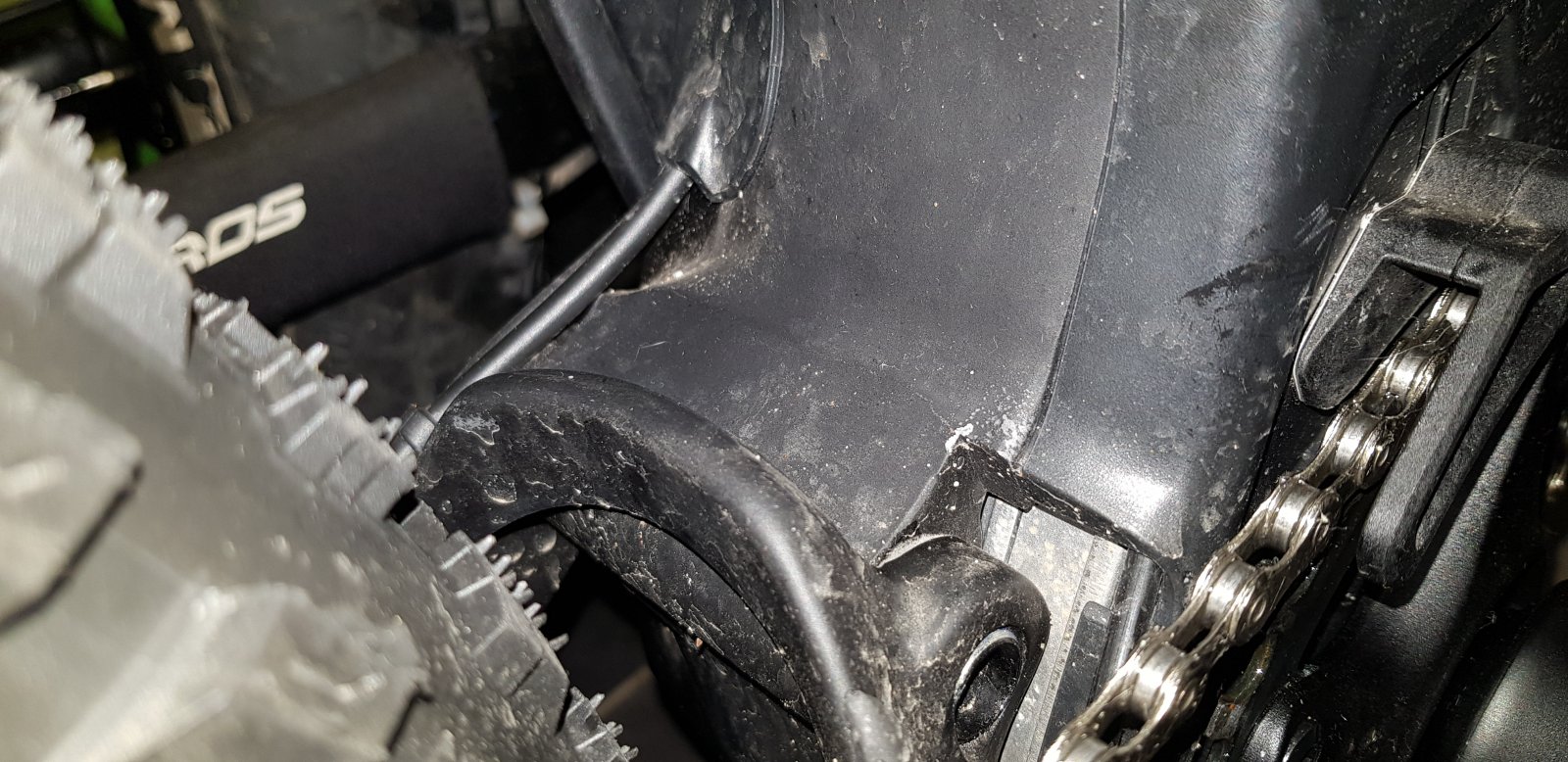

Xeretic
Feb 11, 2019
91
40
Russia
Hi folks. I'm not sure if I do need to install some kind of cover/fender to avoid mud getting inside engine cover. Can you tell by the photo if I should be concerned about protecting that area?
Rocket Roche
Nov 21, 2018
36
59
Hertfordshire
Hi folks. I'm not sure if I do need to install some kind of cover/fender to avoid mud getting inside engine cover. Can you tell by the photo if I should be concerned about protecting that area? View attachment 11724
I push a small piece of cloth into that hole to stop the mud building up on my second motor due to the mud cake that built up behind the plastic casing? Also the crank arms wouldn't spin freely when pushed backwards apparently due to water getting into the crank bearings? was told not to direct water around that area when cleaning :unsure:
