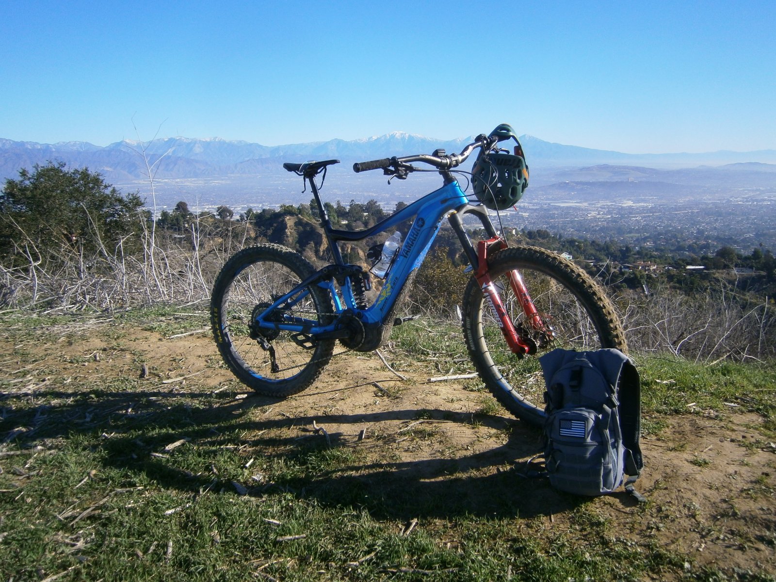

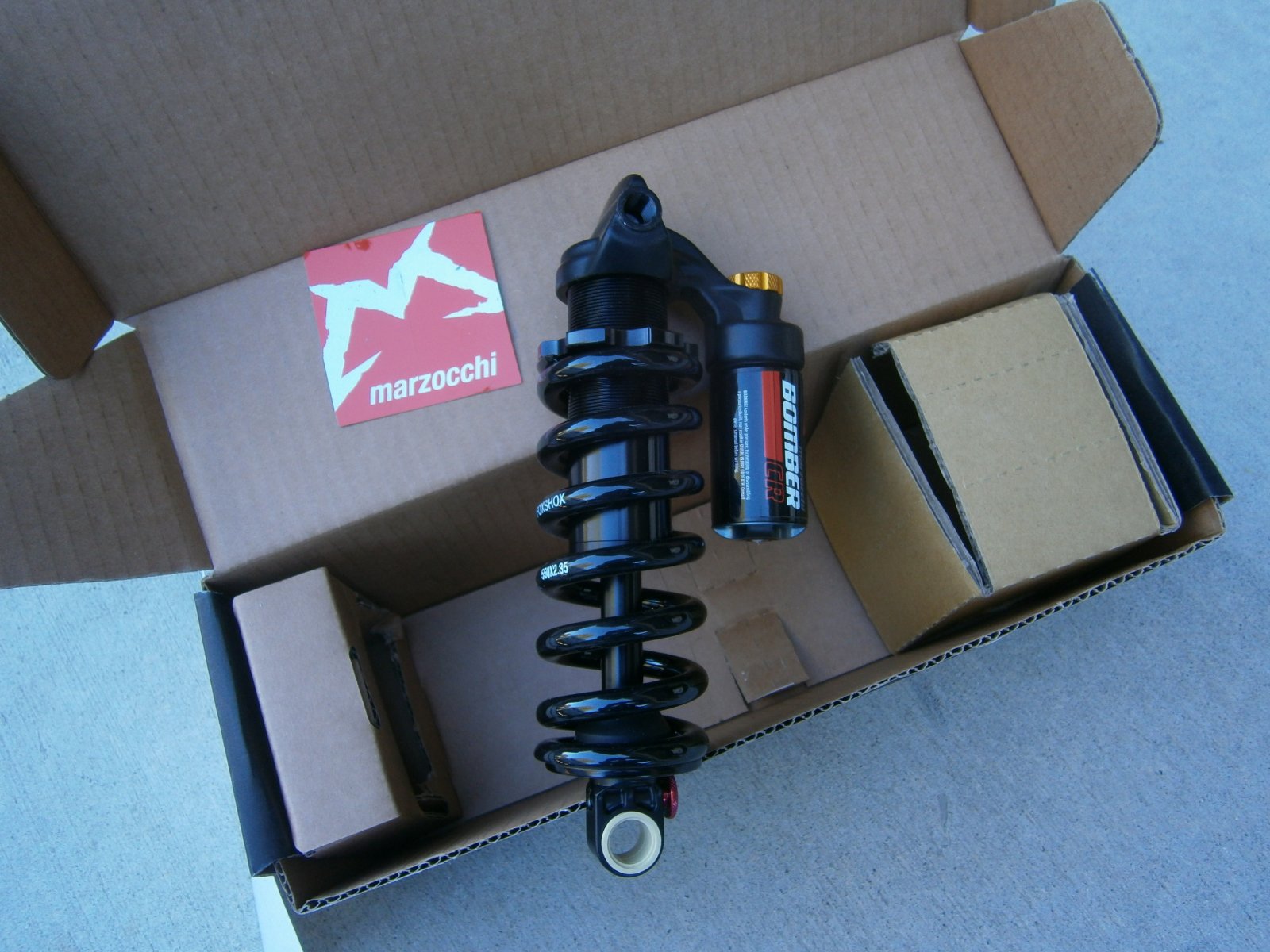

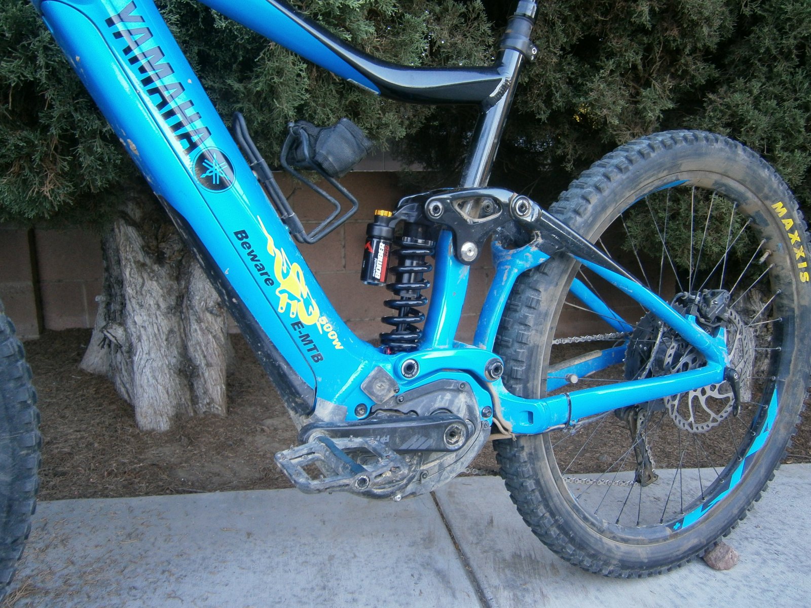

Hey Gents. Been months since ive been active on the boards. My apologies. Been riding regularly for sure! Have had my eye on the Bomber for months & finally got one & just did the install.
Install details:
  1. You will need the 185x52.5 Trunnion style for the 2019 Trance
  2. The factory mounting hardware works so no need to order any fasteners
  3. The lower composite bush that comes w/the Bomber must be removed so the lower through axle can be installed
  4. Make sure you get the proper spring rate. I have a 550lb Fox installed but will be switching it out for a 500lb as my riding weight is approx 167lbs
Any questions, let me know. Cheers, Joe

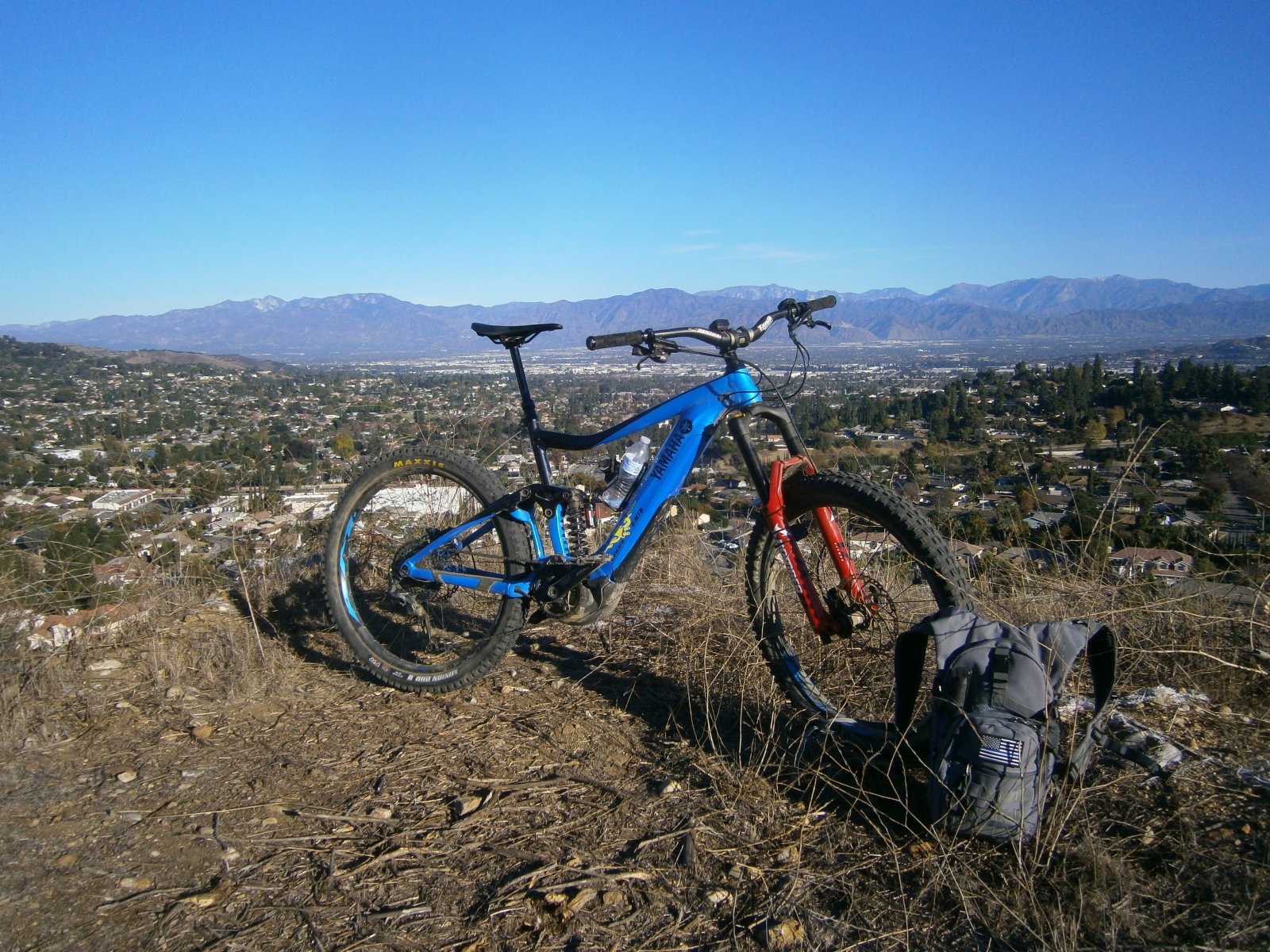

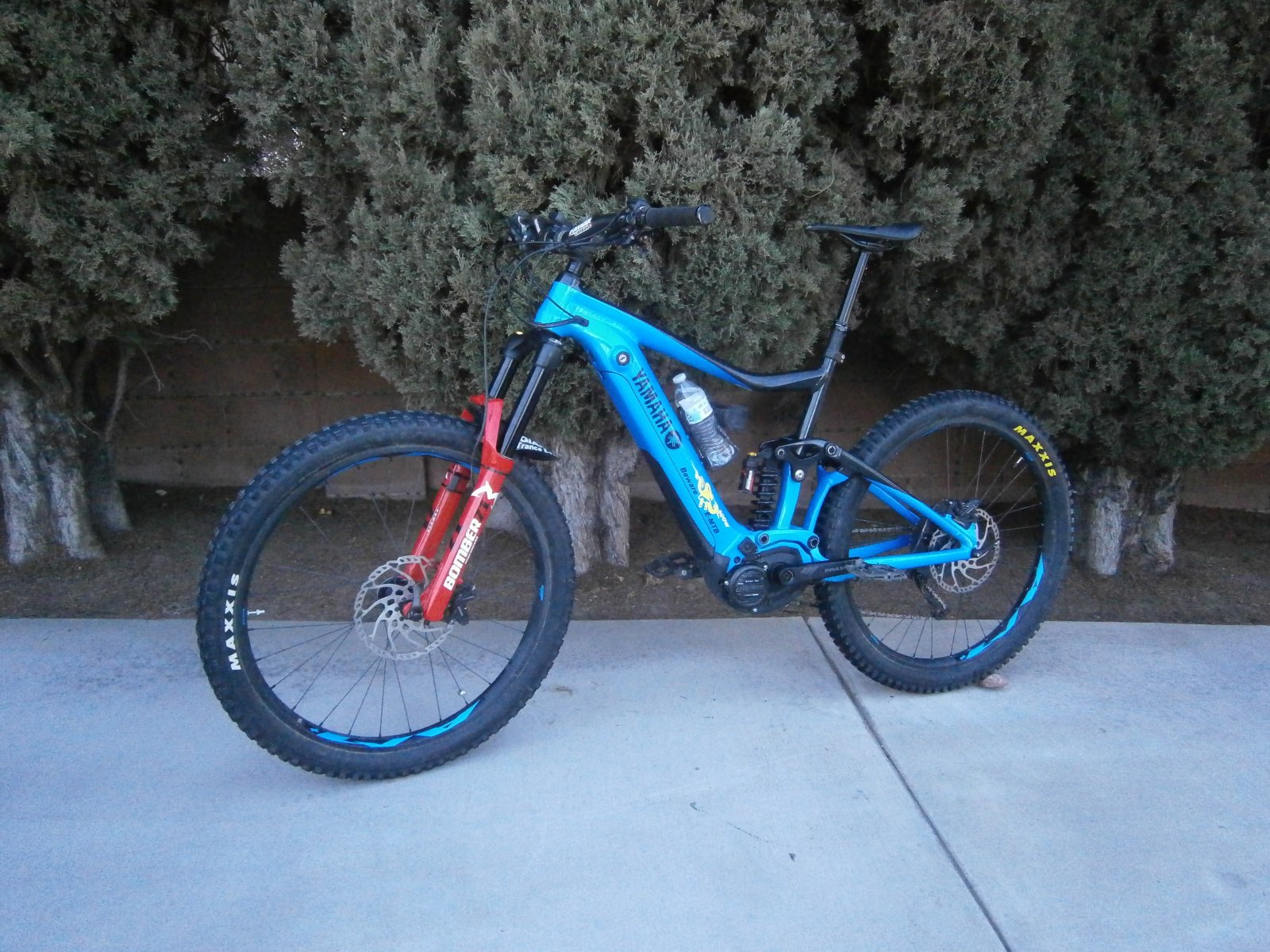

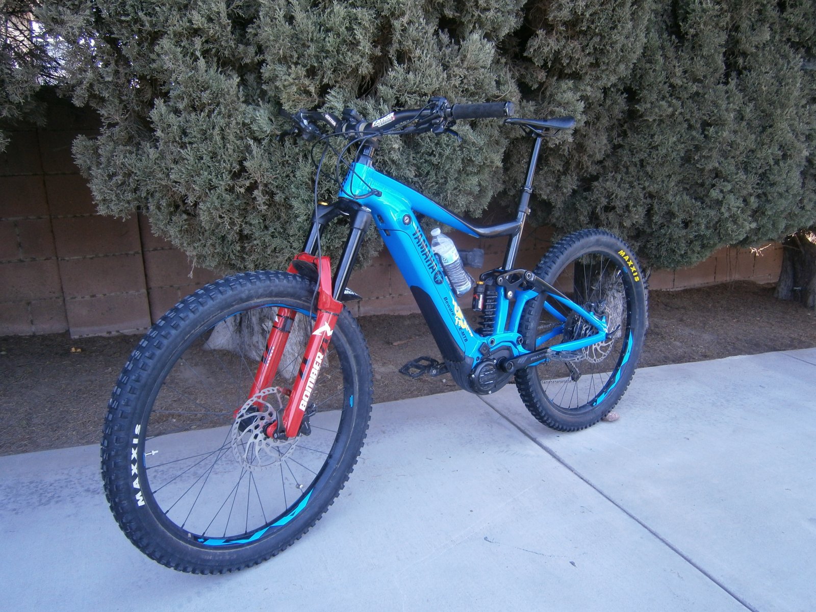

Update 12/24/2020:
Ordered & installed the Marzocchi Bomber Z1 Coil Fork (170mm). Install went well w/no issues. Wow, a positive difference having a full coil suspension front & rear

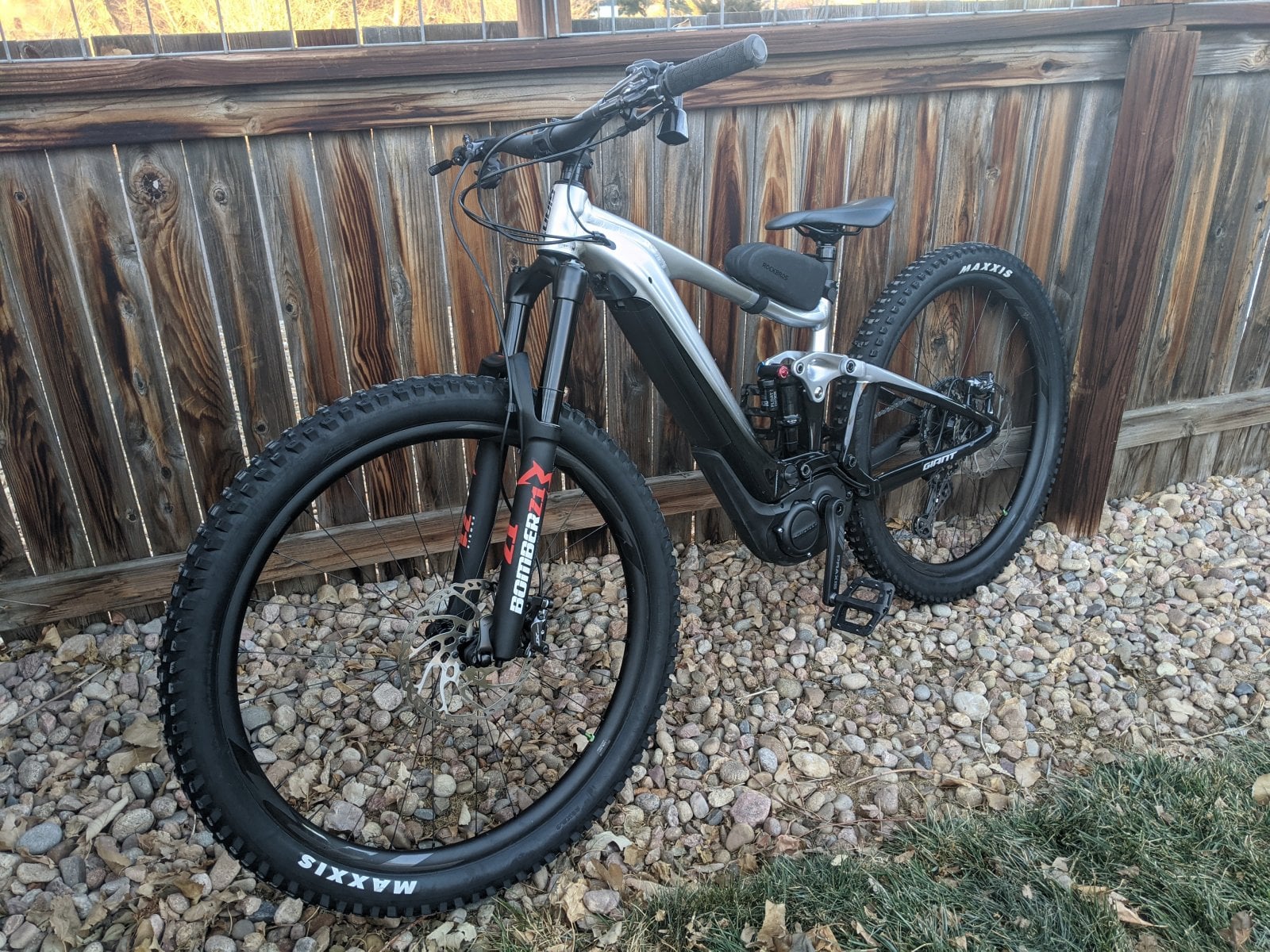

I have the z1 coil on my 21 trance x....and really like it. On the new bike at least on the small frame the shock won't fit without the reservoir hitting the frame. They made just enough difference in shock angle for the 29" and the new STA that it no longer fits any shock with an extended reservoir. (At least anything much longer than what's on the dpx2)

I have 2 springs (500 & 550) & currently running the 500x2.35. The height of the spring measures approx 120mm
