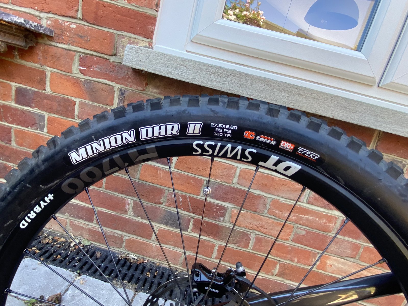

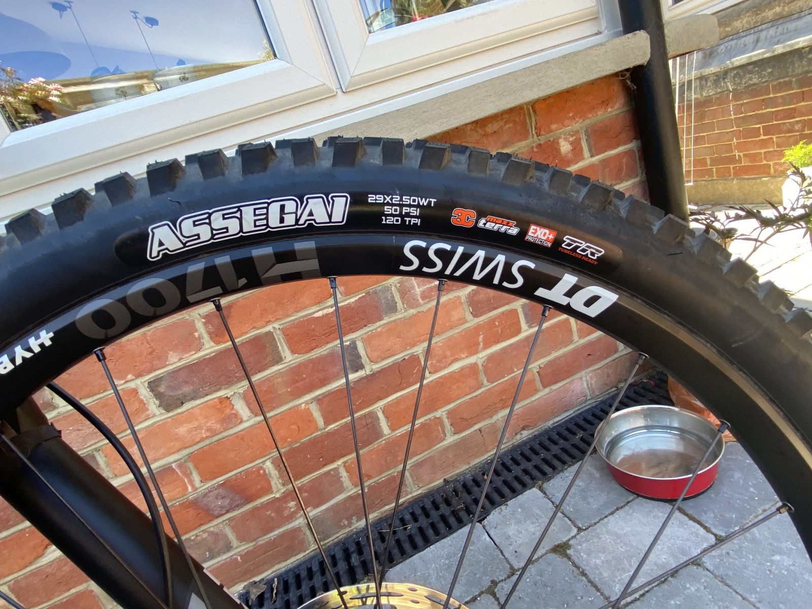

Just fitted a tubeless kit and wondering what PSI people are running. It’s been so dry (South UK) recently the trail surface is covered in stones and gravell marbles, but the rain is coming. I’d like to know how low or high you run your tyres. Thanks for your time in advance.

I had a quick scan and ??. If I’m ok to put somewhere between 14 and 20 psi in them I’m good with that. I ride a mullet and the rear is wider than the front so I’ll gauge it as I go. Appreciate the pointer to the post, as you point out there’s lots of views out there. .

I’m unsure what your referring to but these are the tyres

I’m a dropping 89 kilos. A couple of years ago I was racing Enduro and for most forest events most would have 11 to 14 psi in the rear. They were much heavier tyres but speeds and landings etc were greater to. But I agree with you it’s surprising how low these tyres can be run. I’m going at 20 in the rear and 16 in the front right now and it feels fine on the hard ground right now. You might spot me sitting in the verge on those bends near your place, spectator only though !
