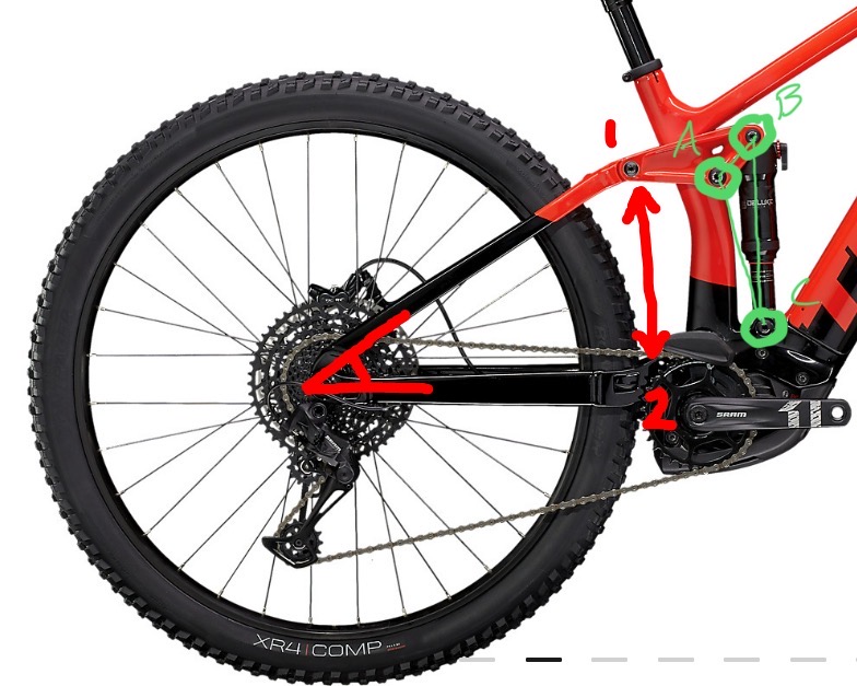

Along with the change of seatstay length, the angle between the seatstay and chainstay changes (by the pivot next to the rear wheel axle). This means points 1 and 2 below are closer to eachother, and that forces the upper link to rotate anti-clockwise slightly. You can see how this dim and angle changes through the travel in the vid I posted above

Nobody's angry, but I think we're all finding the process of debating with you slightly baffling. It's like arguing with a five year old, except the five year old might get it.
You have cause and effect all backwards. The shock length has not changed. The shock does not care about the length of the seatstay. it doesn't magically get shorter because the seatstay has got longer.
The three points that matter here are marked up using your diagram.
AB and AC are a fixed distance apart. BC is the shock, the shock is the same length as before. Therefore the angle of the linkage is the same as before. Anything that goes on in the rear triangle doesn't affect the triangle ABC at all. Unless you change the stroke of the shock when fully extended, or compress the shock, ABC is utterly unaffected.
(Edited to change chain stay to seat stay because while it wasn't wrong that the shock doesn't care about the chain stay length, it's not terribly relevant)
