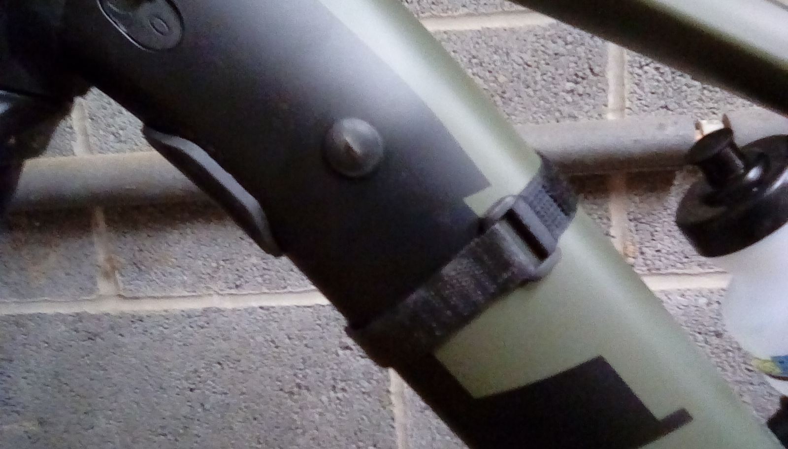

Just a quick tip/hack for a little extra protection around the key entry point on the frame. I've used a 16mm electrical blanking grommet and cut a slit for key access. It should minimise water ingress out on the trail in this area.

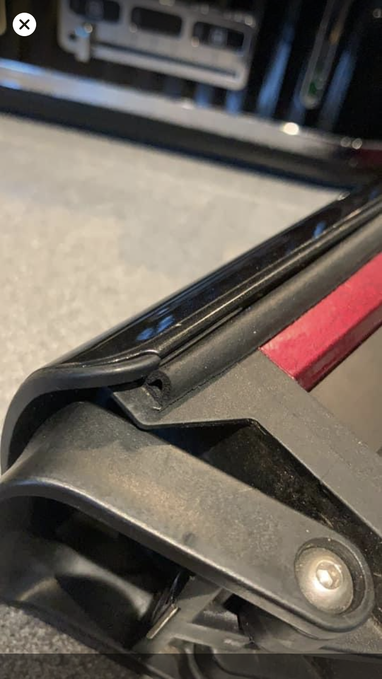

I have indeed, you can improve this buy using some P section draft excluder to help seal the gap. See pic
A few have done this ( me included) and it works well.
thanks again...looks great...
presumably its available from DIY shops...is there a specific size i should get??
only a few quid for about a mile of the stuff.
That picture is my battery on worktop in my kitchen ... How did it end up on here :)
Sorry @Davidwylie , I remember you posted it to me on facebook Trek group. It's a brilliant and simple thing to do for added protection. I did it myself, bought the stuff off ebay, but I was replying to the post at work, I only had your pic to explain \ show how to do it. I hope you don't mind
Nah of course I dont mind, its good to share the neat ideas around, when I seen it I just thought "oh someones done the same thing as me" then it was, "hang on, thats my toaster, thats my battery" :) I think it something all Rail owners should do, even when I hose the bike down, nothing gets in the battery compartment.
It really is a simple thing to do, same with the electrical blanking grommet on this thread, costs pretty much nothing but does the job!
