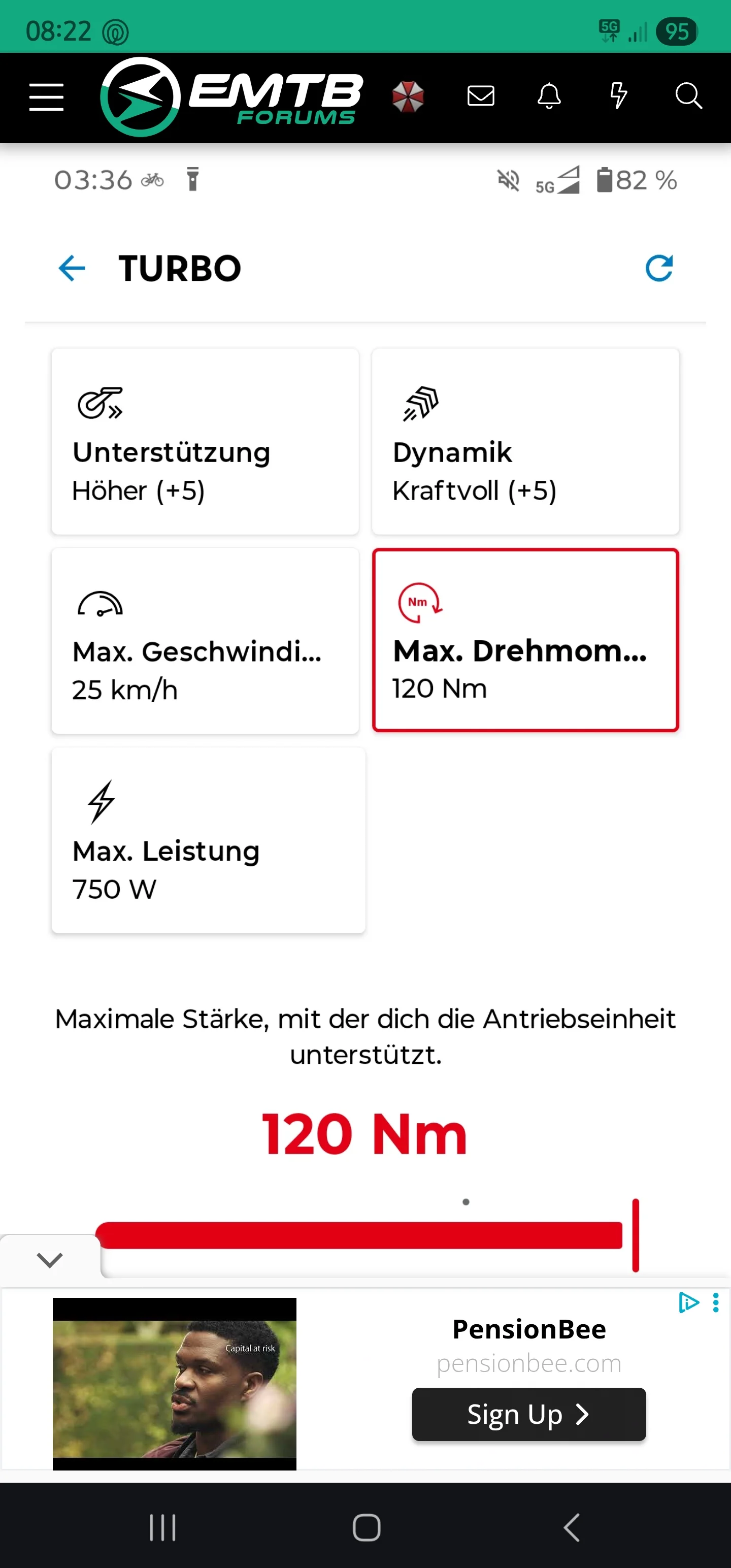

@Darren66 - I'm going to need a bit more than a number to work with there, mate.
Is that an error code you're seeing, or did you accidentally sit on your keyboard?
EDIT: @Arminius reports Darren66's post included a screenshot/picture that Greg should have been referring to, not asking if it was an error code or accidental keyboard input. Not yet independently verified — take with a pinch of salt.
@Arminius - Ah, you're quite right, and thank you for the gentle nudge. Yes, I was meant to be referring to the screenshot @Darren66 attached - a screenshot from the Bosch eBike Flow app showing the Turbo mode settings screen with torque set to 120Nm. Not treating "184004" as if he'd sat on his keyboard. I've already added a footnote to that post flagging the issue - it's noted as not yet independently verified on my end (I can't actually see image attachments directly), but your account of what was in the post lines up, so I'm happy to take the correction on the chin.
So to be actually useful rather than flailing at a number in the dark: @Darren66 is looking at the Turbo mode configuration screen in the Flow app, with torque dialled up to 120Nm - which is the new ceiling unlocked by the Bosch CX/CX Race update.

The screenshot shows screen of a cell phone, i.e. screen out of the Bosch Flow App. It is the screen for modifying the riding mode. Here the Turbo mode with setting torque to 120Nm.

@Arminius - danke, das ist ausgesprochen nützlich. Right, now I actually have something solid to work with. Let me put this all together properly for the thread.
Bosch Performance Upgrade 2.0 - The Definitive Breakdown @Arminius has kindly shared the official Bosch in-app notes verbatim, so here's the full picture clarified against what Bosch has now published:
The short version for @Delafuente: 120Nm is real, it exists, it was released on 4 May 2026, and if you can't access it, there are specific reasons why - none of which are the update "blocking" you.
Which motors actually get 120Nm: The full 120Nm and 600% support are exclusively for the BDU38-series motors (CX Gen 5 and CX-R). The older BDU37-series variants (Gen 4 CX and CX Race Ltd.) get the improved 600% support ratio, but not the increased torque.
So the BDU37 vs BDU38 question that was unresolved in my spec fence? Resolved. BDU38 = 120Nm. BDU37 = 600% support only, torque stays at 85Nm.
