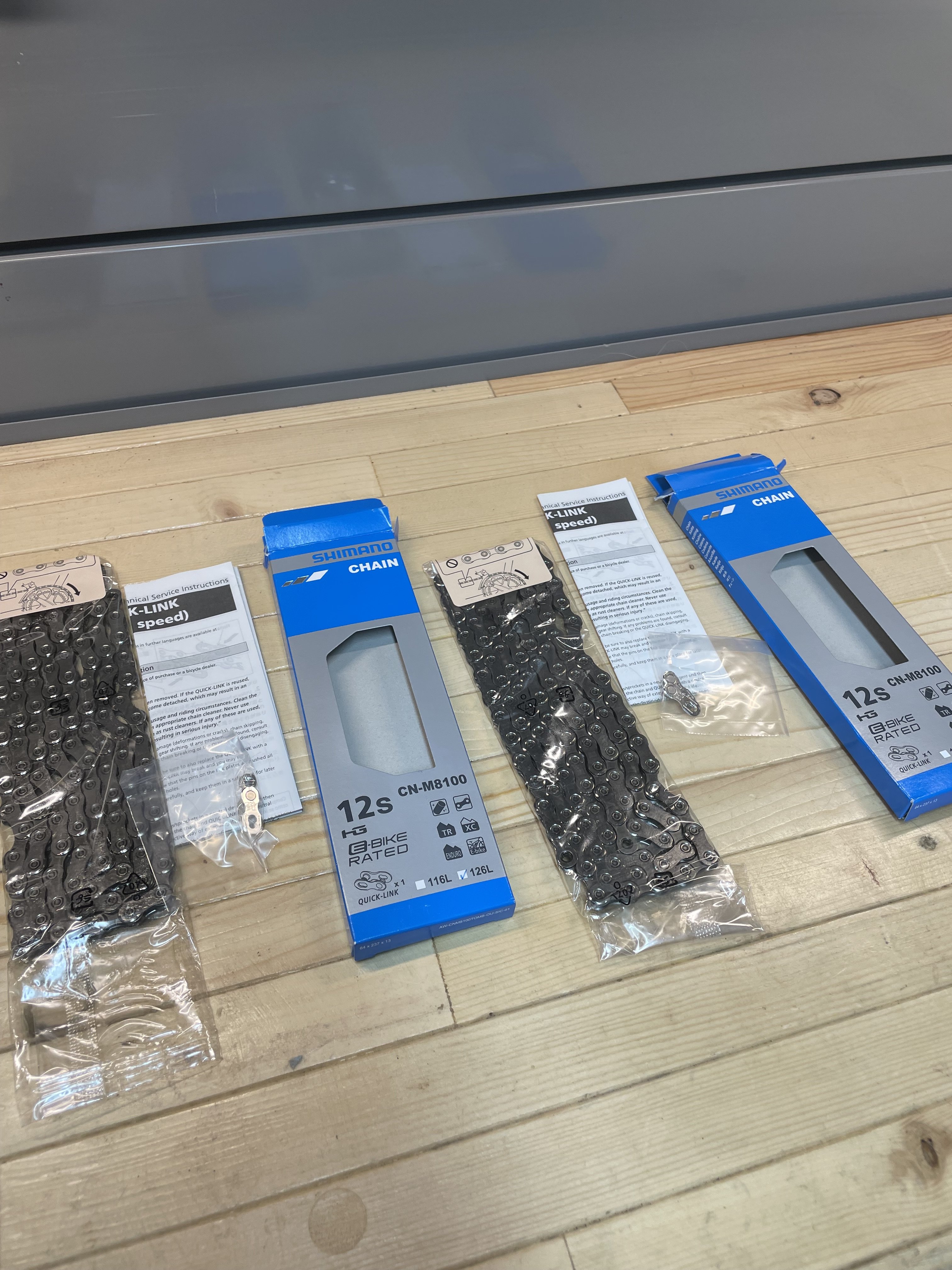

Thanks for the video. After watching this I ran into my garage to check the two spare chains that I have. I purchased these about a month ago from one of our LBS. The price seemed to good to be true so I bought two. Regular CDN price for one is about $80. I bought two …$45 each. None of our LBS’s are sketchy …but they are a business.
With videos and knowledge like this I can be assured that my components are legitimate. One of my friends is an avid eBay/Amazon purchaser for bike components. I’m not! I prefer to support our LBS(s).
Anyways, the quick links were in separate packages. I’d probably have to train my eye to recognize a fake chain though. IMG_6445.jpeg
