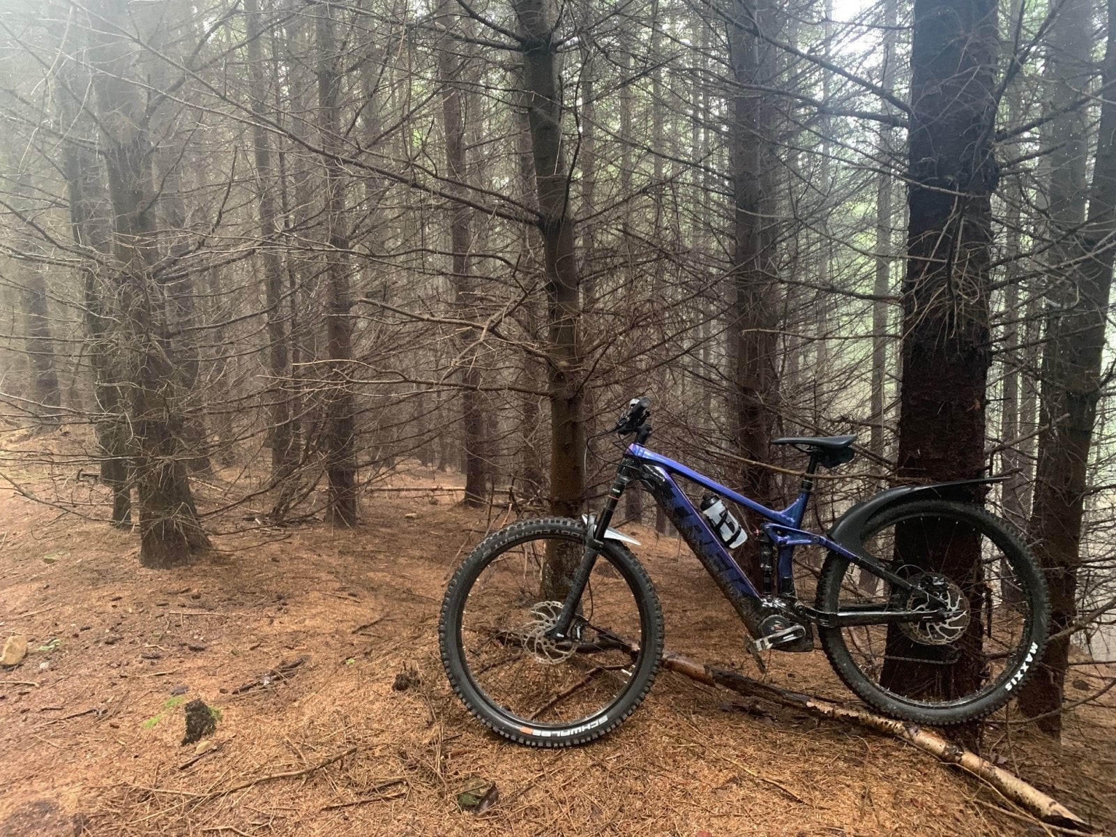

2500 miles and it looks like this;
:LOL:

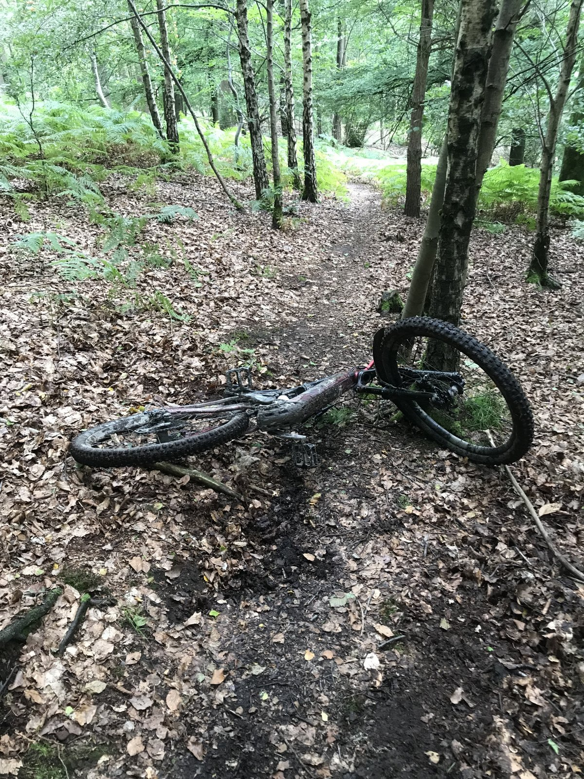

It's contagious!
If we were Levo owners we'd have started a class action suit by now.
It's contagious!
