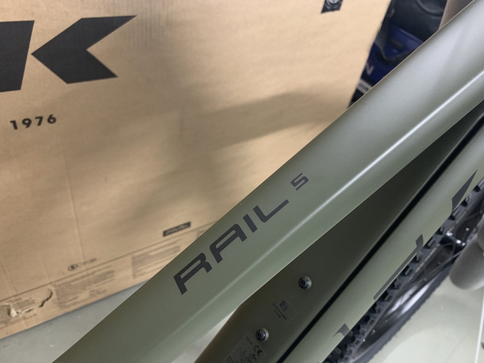

Hi Guys,
I'd like to ask you for an advice. I'm going to order Mac Ride seat for my 2020/2021 Trek Rail 5 and I need to know:
1. If E-Bike WIDE adapter is enough or I need to order EXTRA WIDE due to down tube dimension.
2. If I can mount back the stock stem on Standard Mac Ride Mounting Bracket Spacer (no the stock Trek Knock Block headset spacer).
Thank you very much in advance.

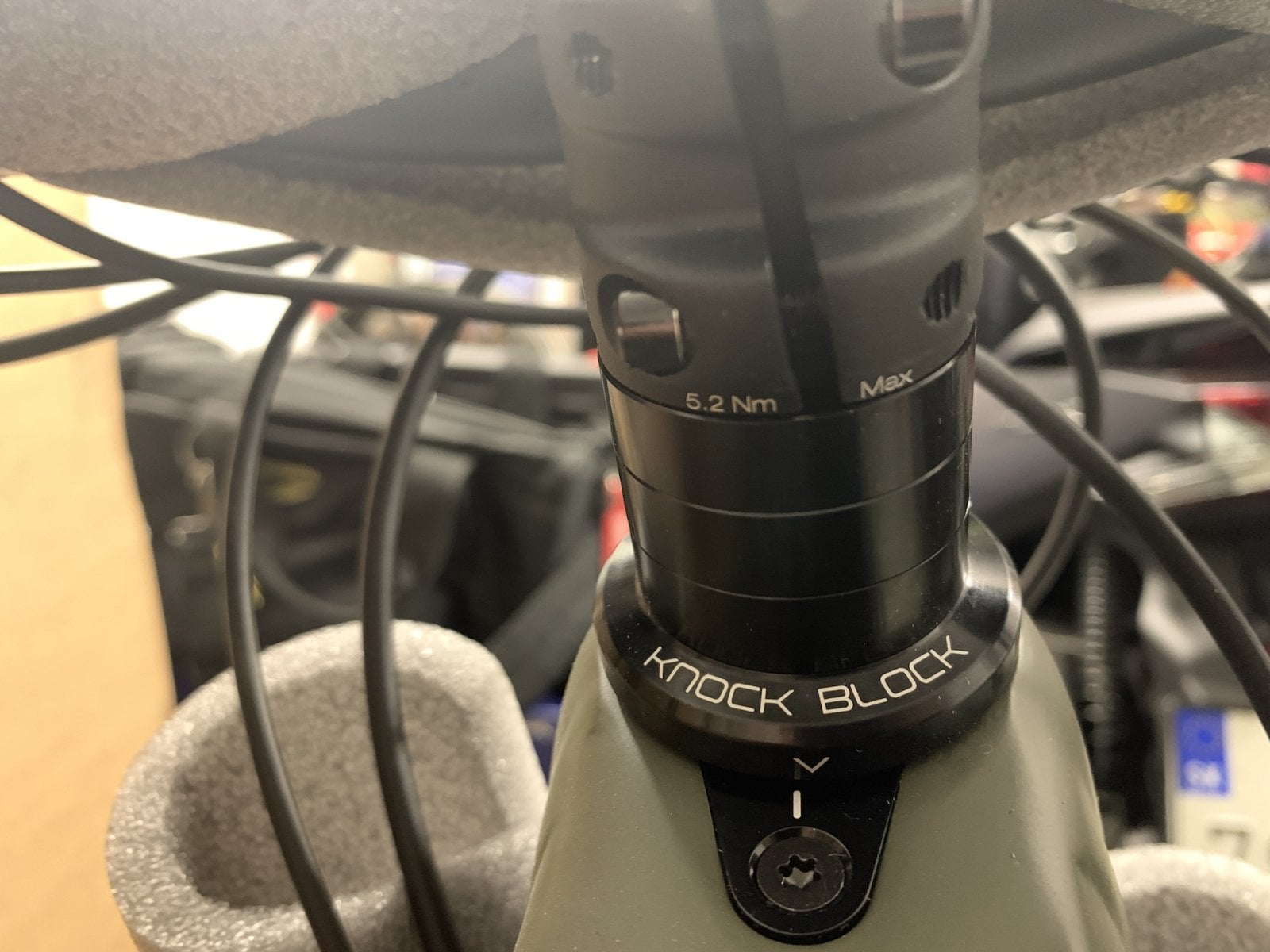

And another question - how did you integrate the macride spacer with the knock block system? The knock block spacers got those "interfaces" that keeps them in position relative to each other.
The ebike wide fits great, no need for the extra wide. You will need the knockbock adapter from Mac ride in order to install the Mac ride adapter ring.
Hi, thanks for the answer! In the mean time i figured it out myself and ordered the two parts - wide kit and knock block adapter.
