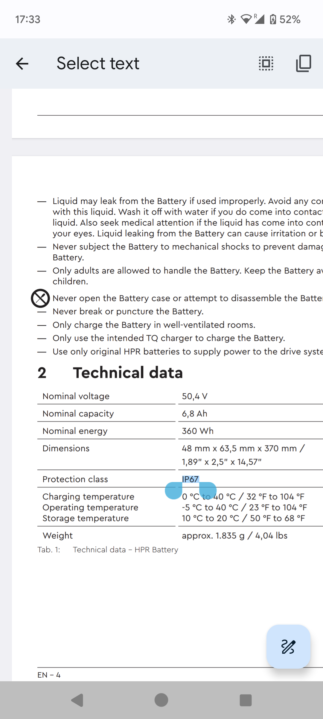

For those with a full-size spare battery, 2 questions:
1. Is the battery (body & connector) waterproof rated? If I carry it in the EVOC backpack and get rained on, will it be an issue? We sometimes have flash thunderstorms that roll through.
2. If the connector is not waterproof, I was thinking of using a snug rubber end cap to cover it but I'm also concerned about the battery's body being susceptible to water.
The battery itself is water resistant,so I wouldn't worry about it . The manual says it's ip67 rated.

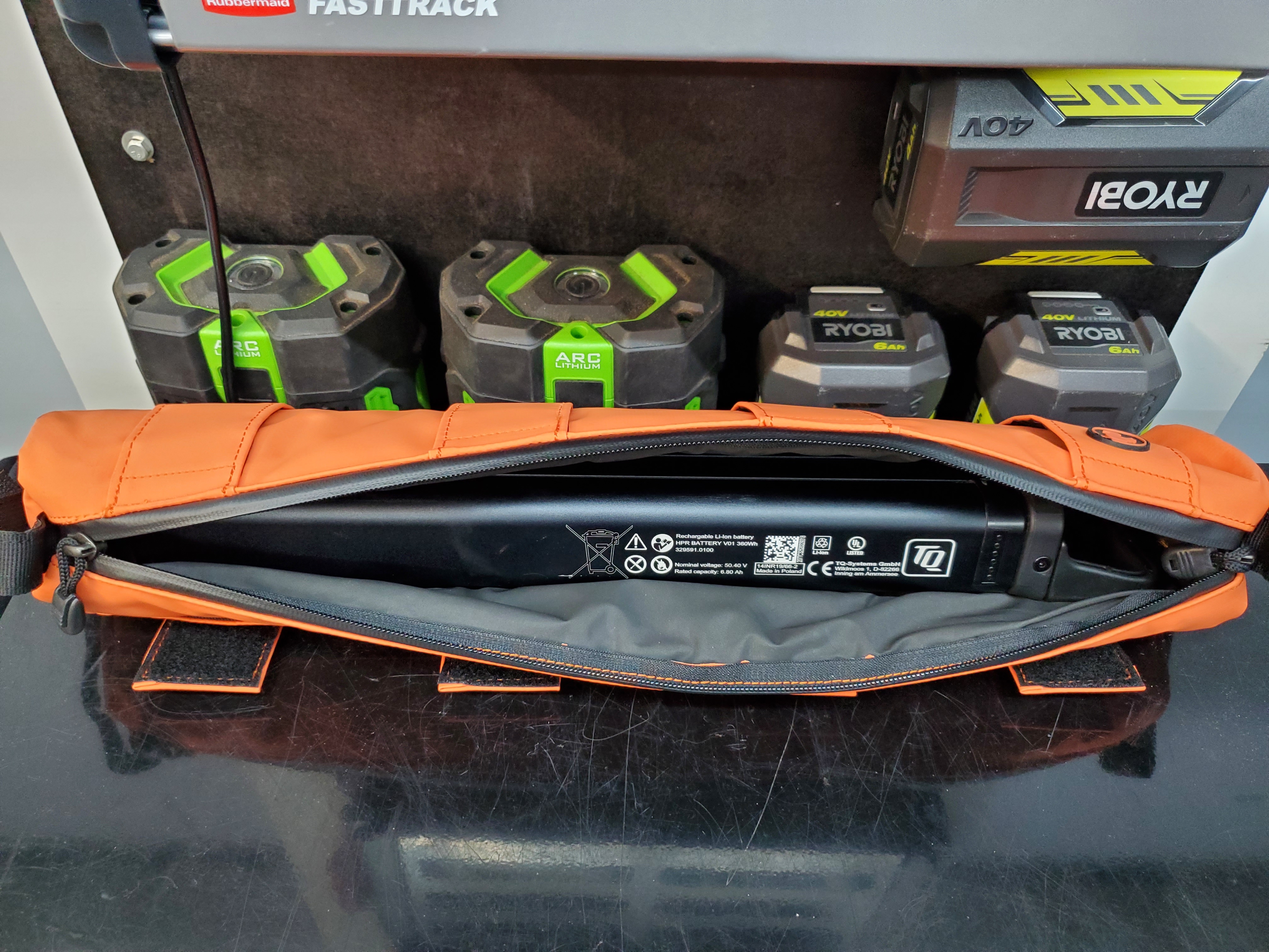

For those with a full size battery (not range extender), I've found the perfect carrying case for it; even better than the battery case included with EVOC e-ride packs.
It's originally designed to carry 4 beer cans, which equate to the length of the TQ battery. It has waterproof zippers, insulated/padded, and has lots of configurable straps on every side. It's also very well made.
I think it's a pretty good price for what it is.
