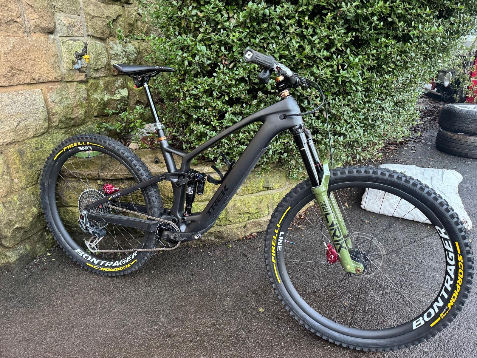

Very nice. Is that the wireless Transmission drivetrain. Kind of regretting not going that route, even though my XT setup is performing just fine. I just like bells and whistles.
It’s wireless everything. It’s a mate of a relation who is the mechanic on a downhill factory team and this was one of the riders training bikes. No expense spared on kit, but it probably hasn’t had an easy life! It’s currently under a Hardline rider for a while.
