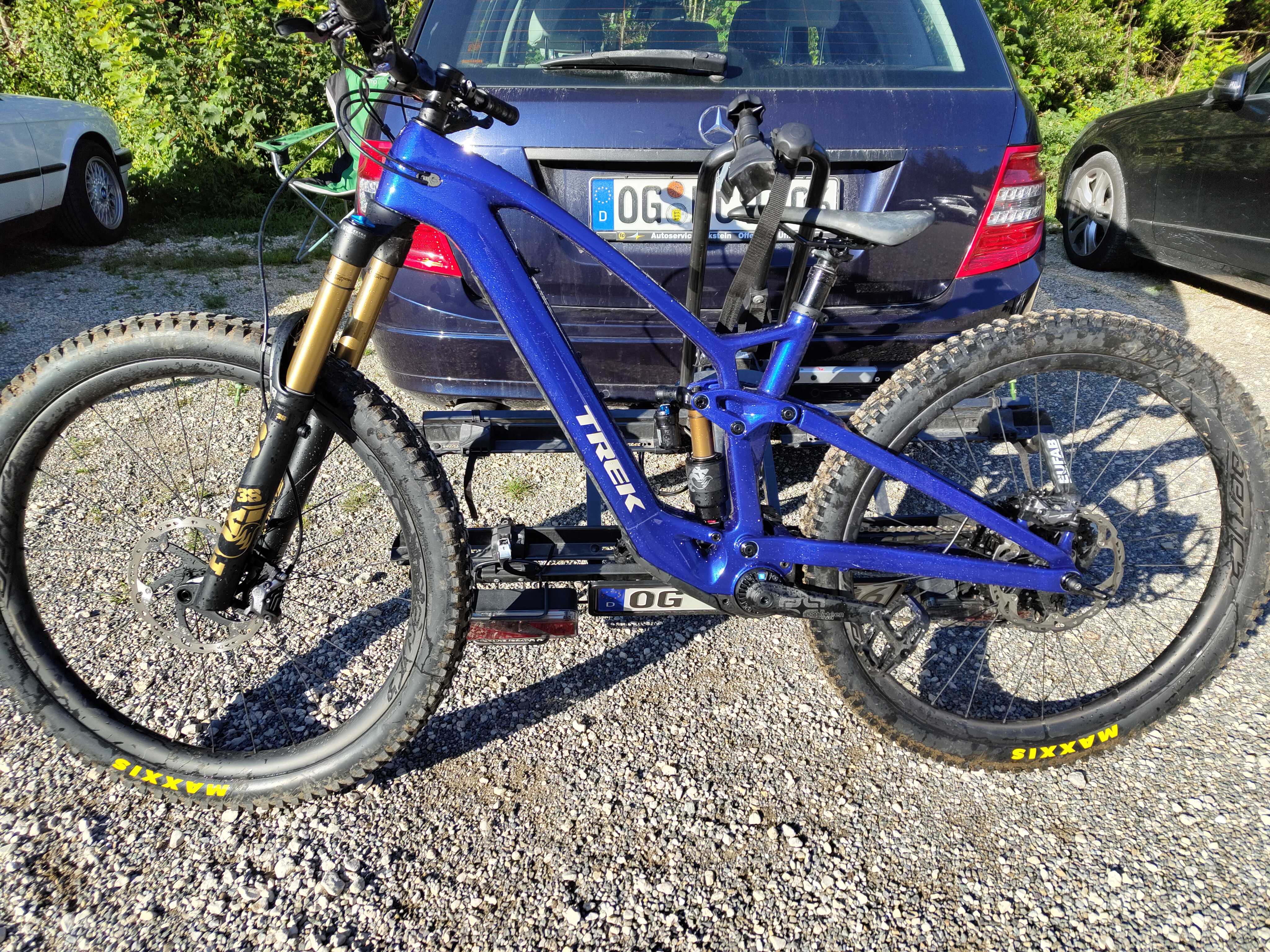

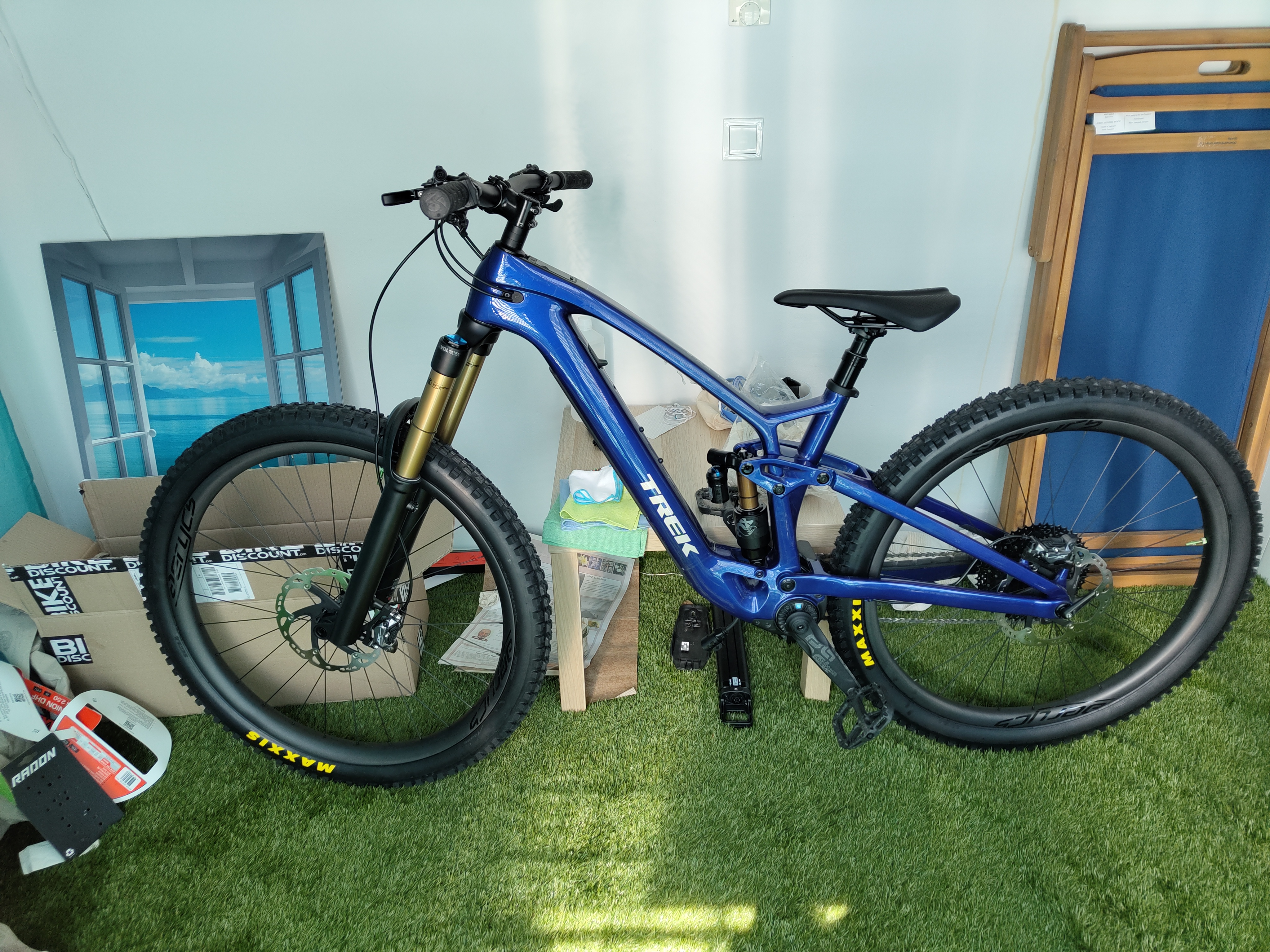

Hey everyone,
just want to share my EXE 9.5 ("Big Blue Bike") for everyone interested (pls ingnore the mess in the background)
Frame: 9.5 Size M
Fork: Fox 38 Factory Kashima 170mm (added Costom Decals)
Shock: Fox X2 Factory 205x65 (so 152mm rear travel) (FlipChip in high and no clearance issue)
Breaks: XT 8120 4 Postion on 200mm Rotors
Rims: Aerycs E-MTB 29" Carbon
Tyre: MAXXIS DHF 2.5 (front) MAXXIS DHR 2.4 (rear)
Inserts: Cushore (front and rear)
Pedals: One Up Comp
Drivetrain, Cranks, Dopper, Bar, Grips are still stock. Drivetrain will be replaced one its worn down. Sattle some time this winter
And for everyone wondering:
Weight: 19,6 kg (with battery)
I use this as my only bike and do go into bikeparks about 1x or 2x per month (without battery). Therefore i wanted the heavy tires and inserts as well as the heavier piggy back shock. Could easily shave around 1 kg with lighter components there.
I absoluty LOVE the bike. Coming from a 2013 Canyon Torque with 26" wheels and short reach this is a ridiculous upgrade!

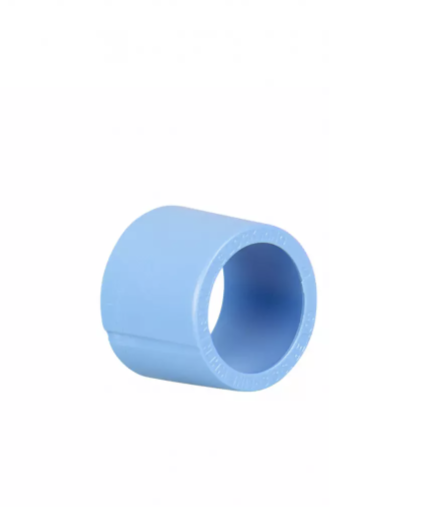

Does anyone in the UK have the little sleeve as per image below that's used for fitting the chainring locking that they would be willing to lend me?
I accidentally binned mine when I got the bike,but now I need to change the chainring.
Please pm me if you'd be willing to post it to me, I'd need it for a few days then would post it straight back, can pay for postage or donate to charity etc.
Looks like it comes with the lock ring. My dealer gave me one when I asked about it.

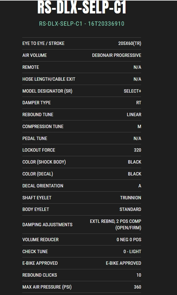

I'm buying the x5 (base alloy) and transferring all the bling from the Levo (Zeb's, T Transmission, AXS dropper, his/wheels etc). the only think I can't swap over is the shock. the base model comes with the lowest spec shock, so wondering what to upgrade it to?
My 9.5 came with the lowest spec shock, rockshox deluxe select+, it's actually pretty decent. I did end up upgrading it to a super deluxe ultimate,but to be honest upgrading it wasn't worth it, the standard shock is actually pretty good.
Everything else on the bike I upgraded and it was worthwhile,but the shock did not need the upgrade - in hindsight.

its an x fusion pro 2 rear shock, think I would be happier with a RS super Deluxe
Ah right, I thought it would be the same shock as the 9.5. In which case ,I dunno, give it a try and see. The carbon models come stock with the rockshox deluxe/super deluxe range,but people have fitted fox X2 etc.
The frame only has about 17% progression so you don't want any shock that has a linear ish spring curve
do we know the tune of the RS deluxe shocks for this frame?
