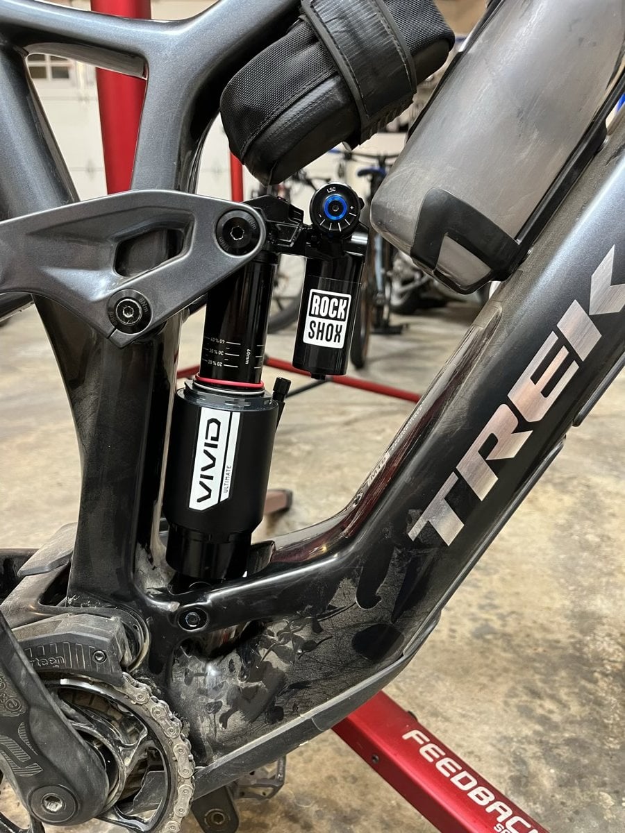

I tried a Mara Pro. I had a Mara on the Ripley too, and it was very nice. The stupid long piggy back on the pro hits the downtime, so no go.
I was going to try a coil, but when I saw the Vivid, I though, Hmm.

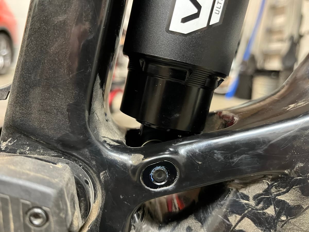

It fits on my Large. Barely. At full compression, the lower air can is within 1mm of contacting the frame. I went to the trouble of making a wood lower spacer to install the shock to see if it fit, before I committed to the install.
First ride will be tomorrow. Fingers crossed I get the tunability that the Float X did not have.
View attachment 123384 View attachment 123385 View attachment 123387
Thanks so much for the reply with install pics. It sure is tight! But hey it's in. Let us know if there where any contact issues in real world riding. Can you get at the rebound knob ok? My understanding is the suspension is relatively linear hence the progressive air can on the Super Deluxe air shocks like on my 9.8XT. What do you weigh> Because it seems crazy that you are only getting partial travel with that sag and no tokens, maybe the shock is defective?

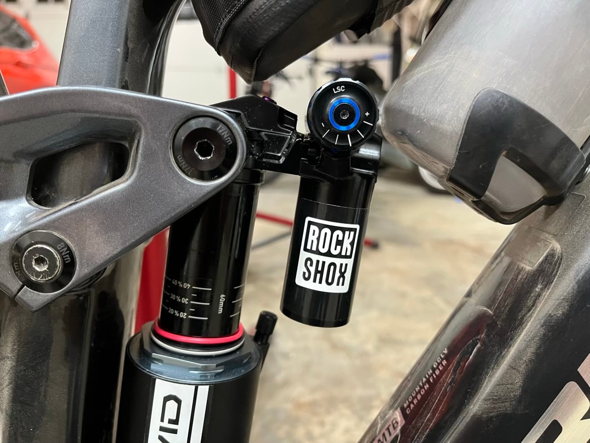

I got a ride in yesterday and it works well. No frame interference issues. It comes with 1 token installed. I weigh 205 so I set the air to that and got just about 30% sag. I started with -5 rebound, +1 LSC, 0 HSC and 0 HBO.
After ¼ mile I stopped and added 1 to rebound. I can just barely move the rebound, as it's pretty stiff, but I can access it from below. Thank goodness for that opening.
Another ¼ mike and I added one more click of rebound. Now at -3.
I rode the rest if the ride this way. I may add one more click but it is very close to being good and balanced with the front.
The trails I rode was mostly tech/slow single track with a few flowy trails and several road sections. No jumps or high speed chunk. No issue with pedal strikes and the bike climbed well, so I am confident the shock was riding reasonably high in the travel.
I used about 80% of the travel on this ride, which Is similar to what I would get with my Ripley. I will likely go to a rougher trail system on Tuesday. If that nets me 90%, I will consider this a fix. The Float X only every maxed out at 70% there. I also have one token I can play with. I would be curious to see how it feels in the most linear mode and how the hydraulic bottom out works.

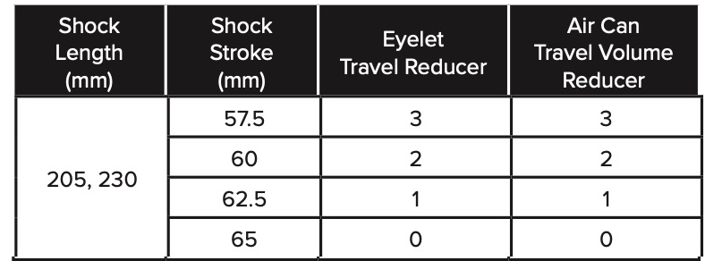

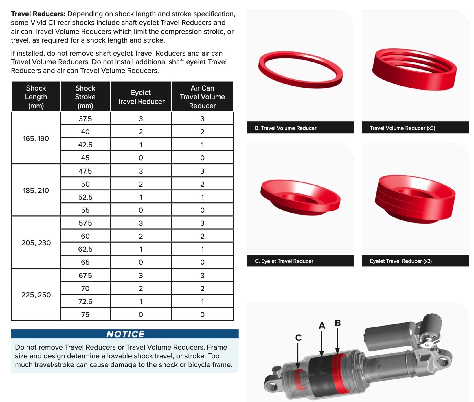

Great feedback, did you go with stock shock stroke? 205 x 60mm?
Yes. It seems this model is adjustable from 205-230 and 57.5-65 stroke.

Glad it worked and nice to know. Re reaching a rebound adjuster at the lower end of the shock. Running a hazzard (with progressive coil). Cheap 3mm hex key, dremel, and a dab of gorilla glue let me make a way to quickly adjust rebound a click or two without having to pull the shock. Highly, highly recommended if you have a similar shock. Just make sure there is tons of clearance at bottom out.
If anyone is ever parting out a large carbon frame, let me know. I’d like to pick up a large front triangle. I’m not at all dissatisfied with my medium. But, I could have gone with a large. I’d like to try a large with a really short stem.
I was able to adjust it with the stock knob while on the bike. Not super easy, but not like I need to change this a lot. All the other controls are readily accessible.
Just watch what parts are needed if you ever decide to change the stroke, because with the Super Deluxe Airs with the non adjustable HBO you need to swap out the damper body (with the pressed in HBO needle) because this part is sensitive to the stroke if it's going to kick in at 20% travel remaining. Added bonus of swapping the damper body is your sag marking remain correct. Not sure with the adjustable HBO, which is a different mechanism but would be good to clarify prior to any changes in stroke.
Appears that stroke adjustment is the same as volume. Just a different type of spacer.

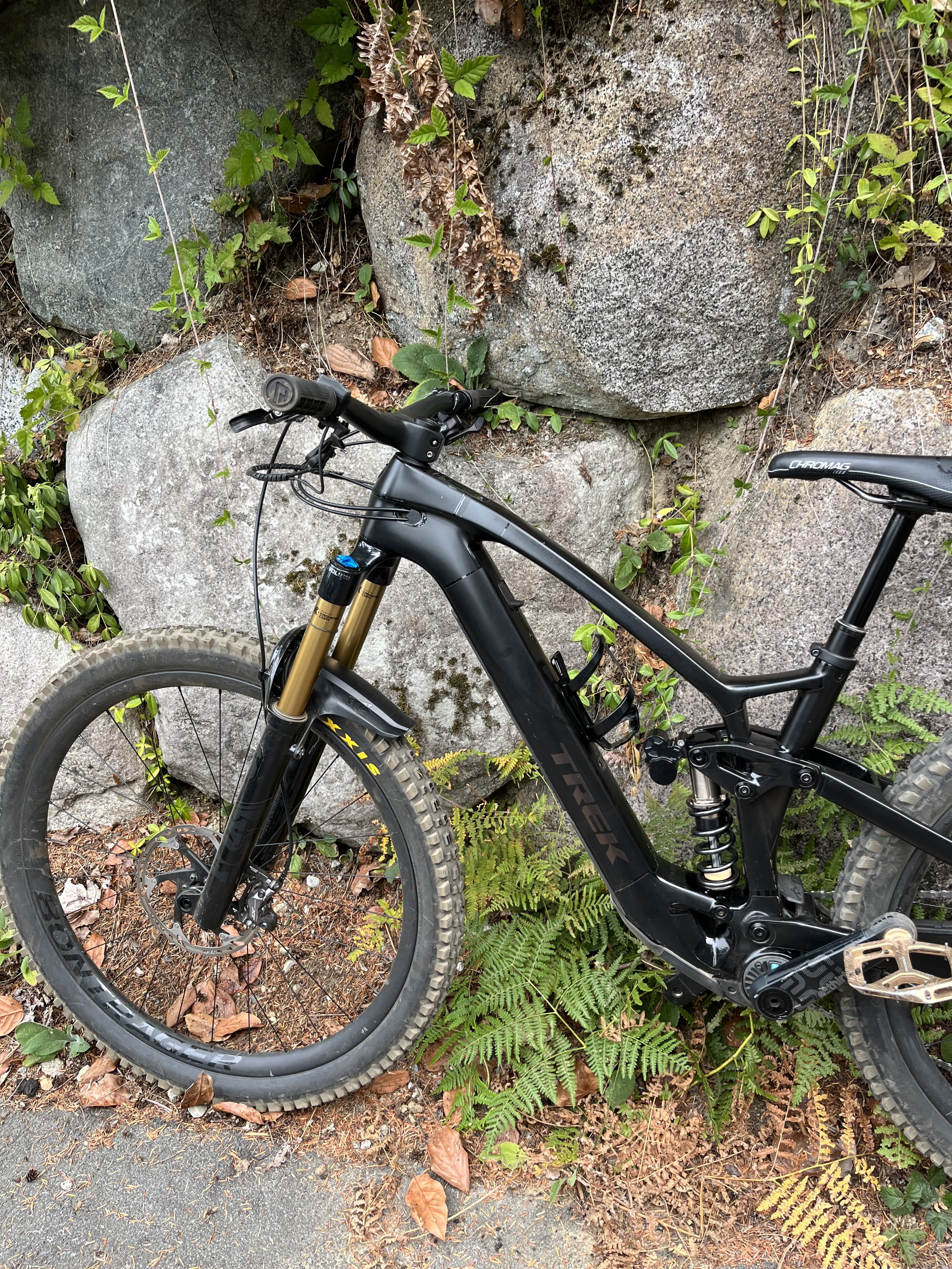

So, the only thing I’m not happy with my 9.7 is, pretty much anytime I’m going down hill, I seem to be all over the trail. Especially down hill turns, and it seems that I oversteer at the exit of corners. I was running the compression adjuster on the right leg open. I am now running it, partially closed at the 3 o’clock position and that seems to help a lot. But, the problem is still there. I’m going to up the pressure by five psi in the fork and see if that helps. I am running softer than recommended pressures. I’ve never had that problem with a mountain bike before. And I am a fairly competent rider. I am an ex pro open class MXer and I’ve been riding mounting bikes for a long time. Any ideas to help this problem, besides learning how to ride? 🤣 Thanks!
I would buy another bike and see if the same issues are still present, you can never have too many bikes
...Oversteer at the exit of corners
That sounds like power delivery. Maybe experiment with a lower power setting or adjust the tune to be less responsive.
The other things I would check are rear tire pressure and how firm the rear shock is setup.

I have other bikes, and I don’t have that problem with them.

No, I didn’t adjust the rear shock. I’ve adjusted the front fork compression on the right side of the fork from fully open to about 2/3 closed at the 3:00 position and that’s helped. Most people are running lower pressures on the Fox suspension. What I did is, instead of putting 175 pounds in the Trek app, I put in 160 pounds and I’m using those suggested pressure settings. That way, my front to rear balance should be close. It seems to really smooth out the bumps with those pressures and I’m typically using 90% of my travel. Im thinking upping the pressure on the fork will help.

That’s a good idea. I chould turn the power off and see what happens. And slow the pedal response and see if that helps. I’m on Maxxis Recons front and rear, tubless with 20 psi in the front and 22 psi in the rear. I guess I could try 22 psi up front and see what happens. It seems to me like I just need to get some weight off the front end in those situations. And, that’s why I’m running the comp on the fork at 3:00. I can feel it helps keep the front end up and even smooths out the small to medium bumps. I have no problems with any uphill turns. Uphill switchbacks are butter.
Ya, rekons are not amazing for traction. They are fast though and those pressures look optimal. I am running a kryptotal rear and I feel a squirm accelerating out of corners but I like it!
I did have the front tire slip out from under me on one hard packed flat corner. But other than that they’ve been fine. I had the same problem with the OEM tires.

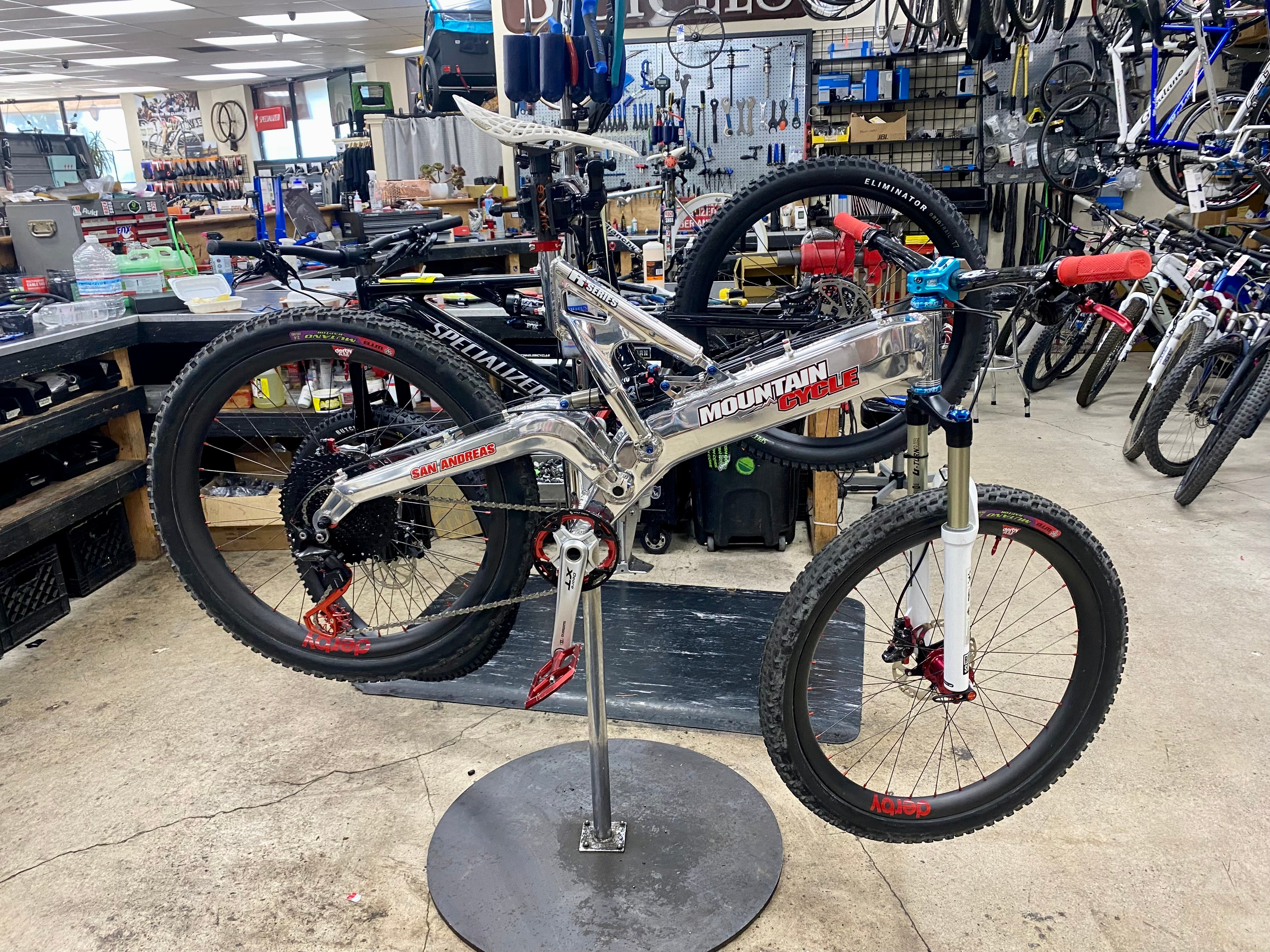

is one of them a san andreas? i worked there in the 90s and learned to build bikes there
