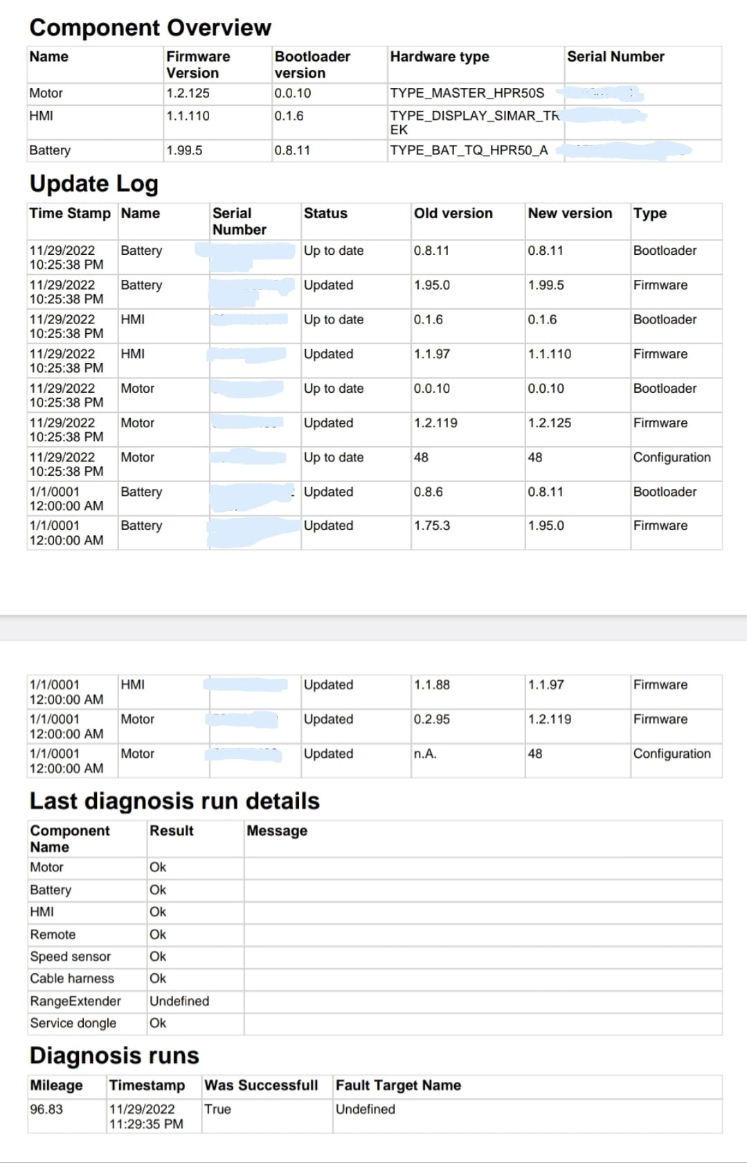

i had my fuel EXe 9.8XT in the shop to get the dropper post replaced as it stopped working. While they had the bike they ran a software update which resolved one of the issues I had on my bike. In Boost mode, the power would come on but then suddenly drop off even at constant rider input power. That is now fixed and it is so much better. I recommend that those of you who maybe had a similar issue, ask for Trek to run a firmware update.
it did however not fix the motor rattle noise at low motor power which TQ said they would have a fix for at the end of 2022. Maybe Roman from TQ can provide an update on that issue. thanks.
I'm posting this as some of you may be interested in the service report that was generated when I had the firmware updated. As you can see there are multiple components which are updated in the process (motor, display, battery)
Also there appears to be a diagnostic test of the different components. In my case there were no faults reported.
You can request a copy of the service report when they do an update. Useful info to have for future reference. It's too bad that you can't pull up some of this info on the app or display.

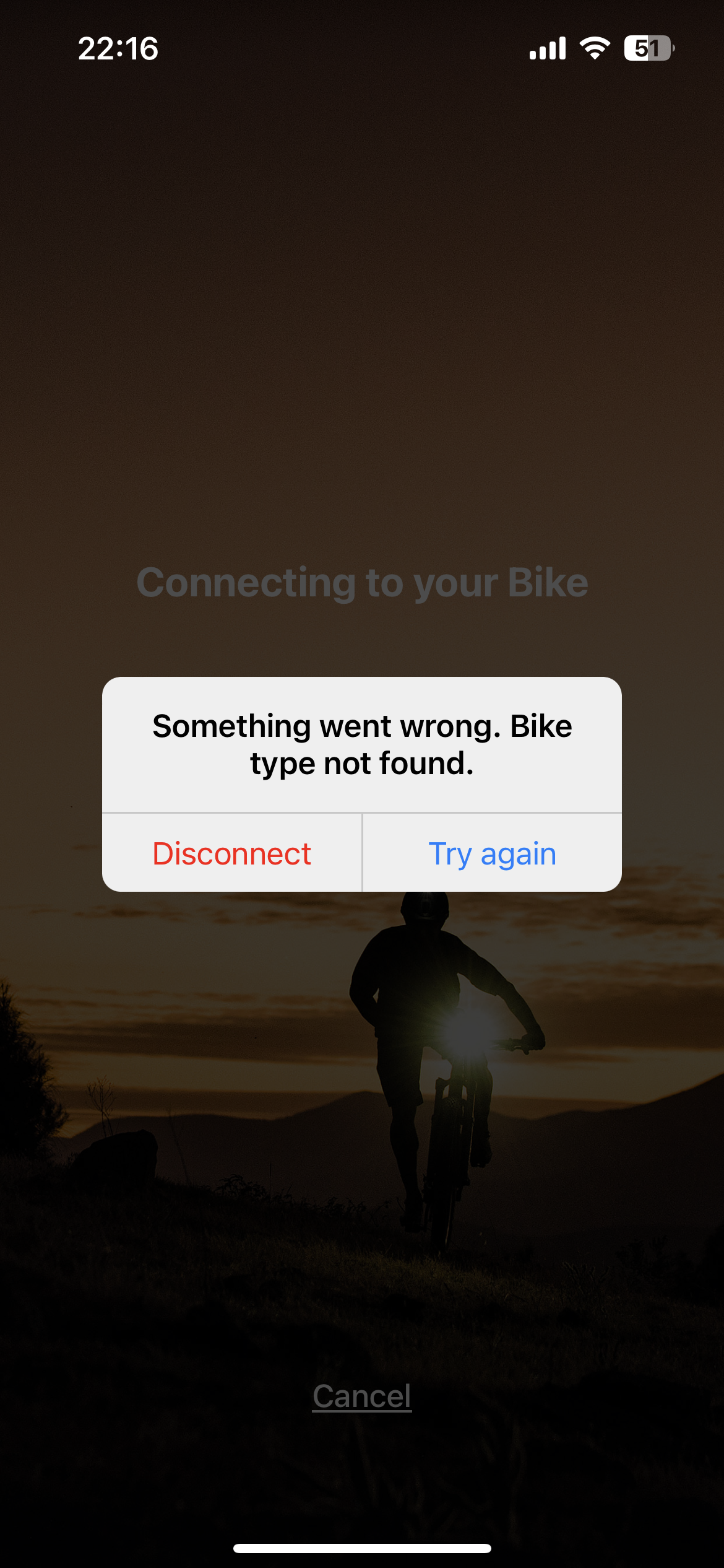

Newbie here, got a Fuel exe 9.8 xt.
Brought bike home and tried to link the app to the bike. In these process I am getting a weird message from the app "Something went wrong. Bike type not found", and couldn't connect to the bike.
These is the first fuel ex-e that my LBS sold, so they don't know much about these problem. Could some one help me link bike and app, or point me to the right direction? I willing to connect and setup the motor configuration to get the most from these rig.
Thanks in advance!
Luiz Andre.
I had same issue first setting up mine. When pairing bike to phone, bluetooth on phone of course and watch for quick code (think 5 digits) that pops up on LED screen for like only 5-10 seconds then disappears following and have to re-do the pairing if don’t plug that code from bike to prompt on phone. My teenage son had to help his tech challenged dad with this

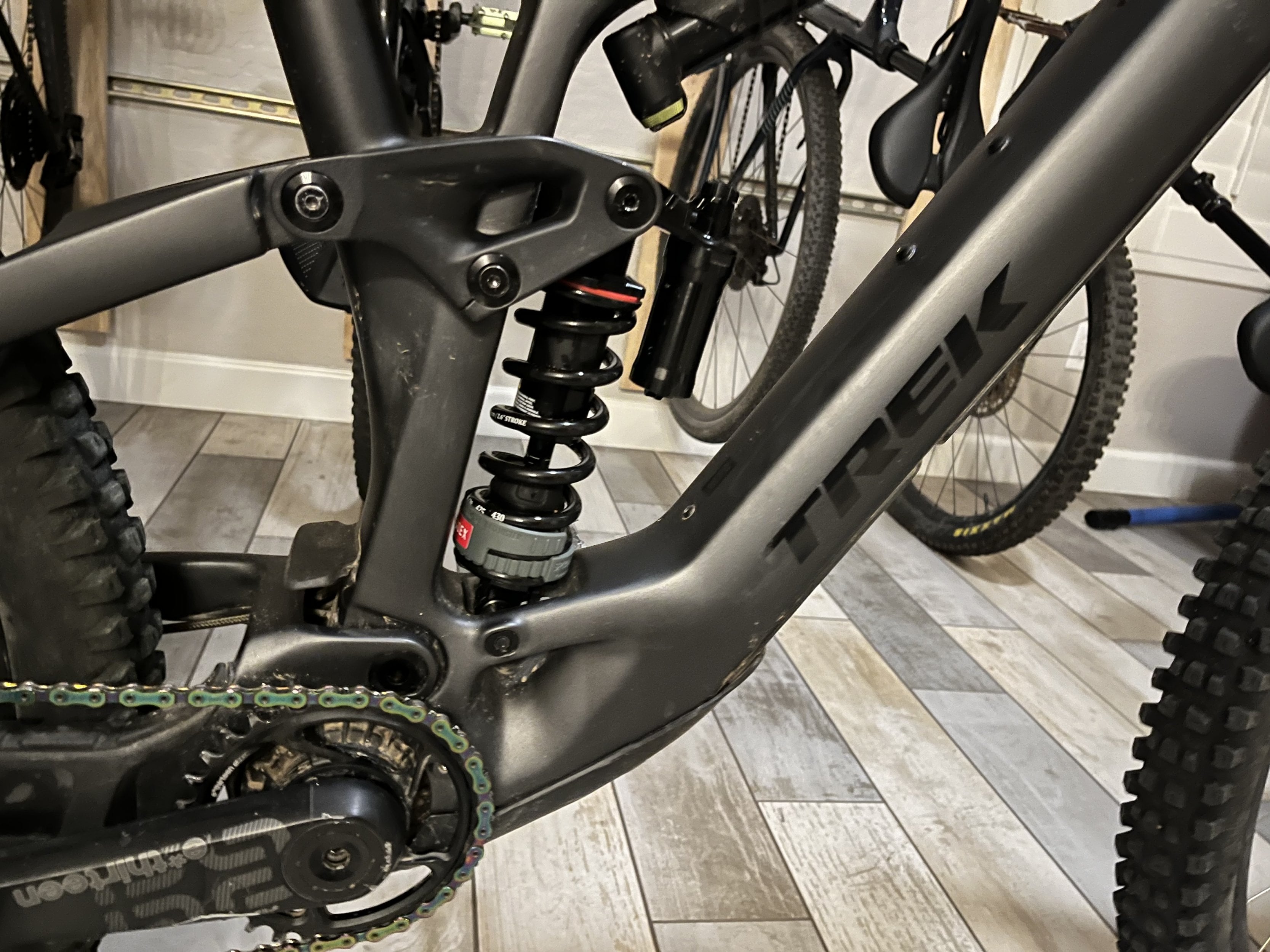

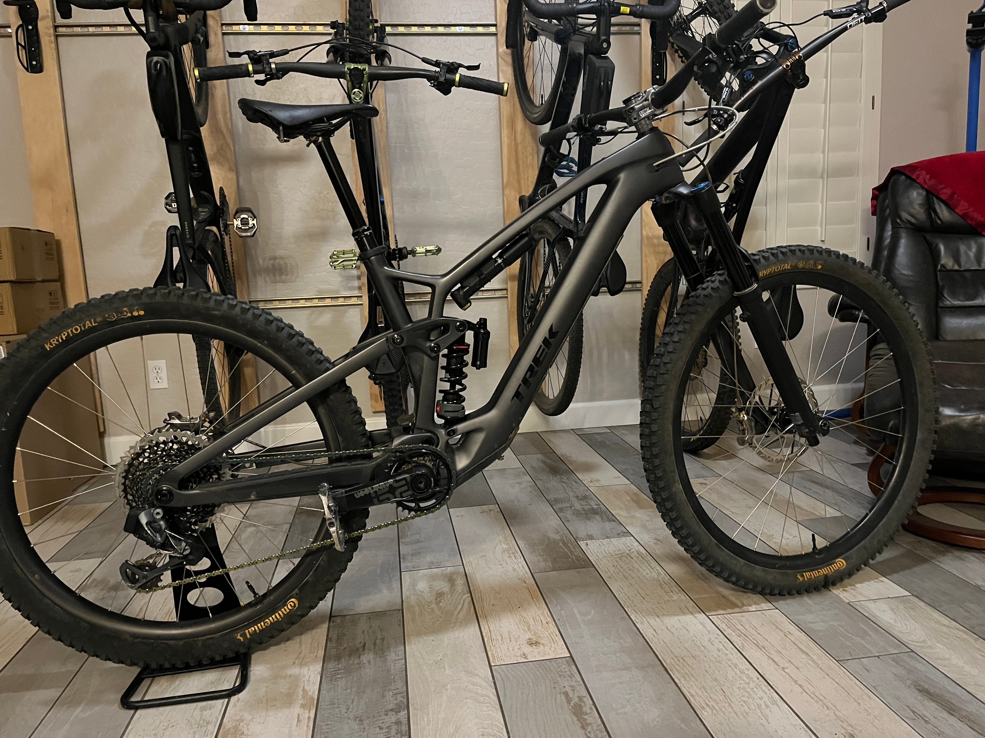

Rockshox Super Deluxe Coil with Vorsprung Tractive Tune and MRP Progressive Coil.
The traction and compliance is just insane, and works great for all types of terrain and riding (note: I don't do bike parks /big jumps though). Its just perfect on this bike. Couldn't be happier.
Paired with PUSH ACS3 Coil Converted Fox 36 Grip2 VVC fork the bike is completely glued to the ground yet super plush.

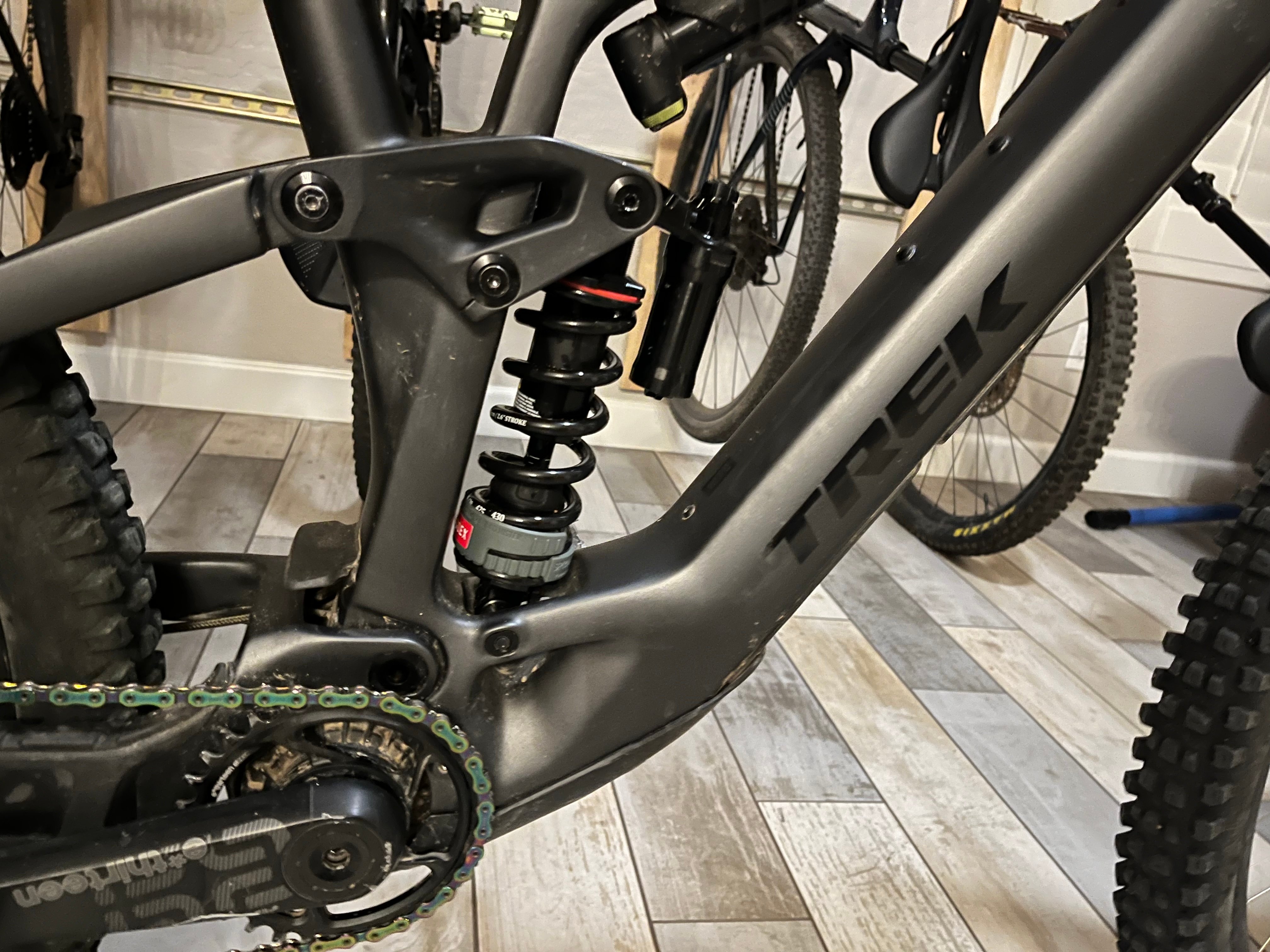

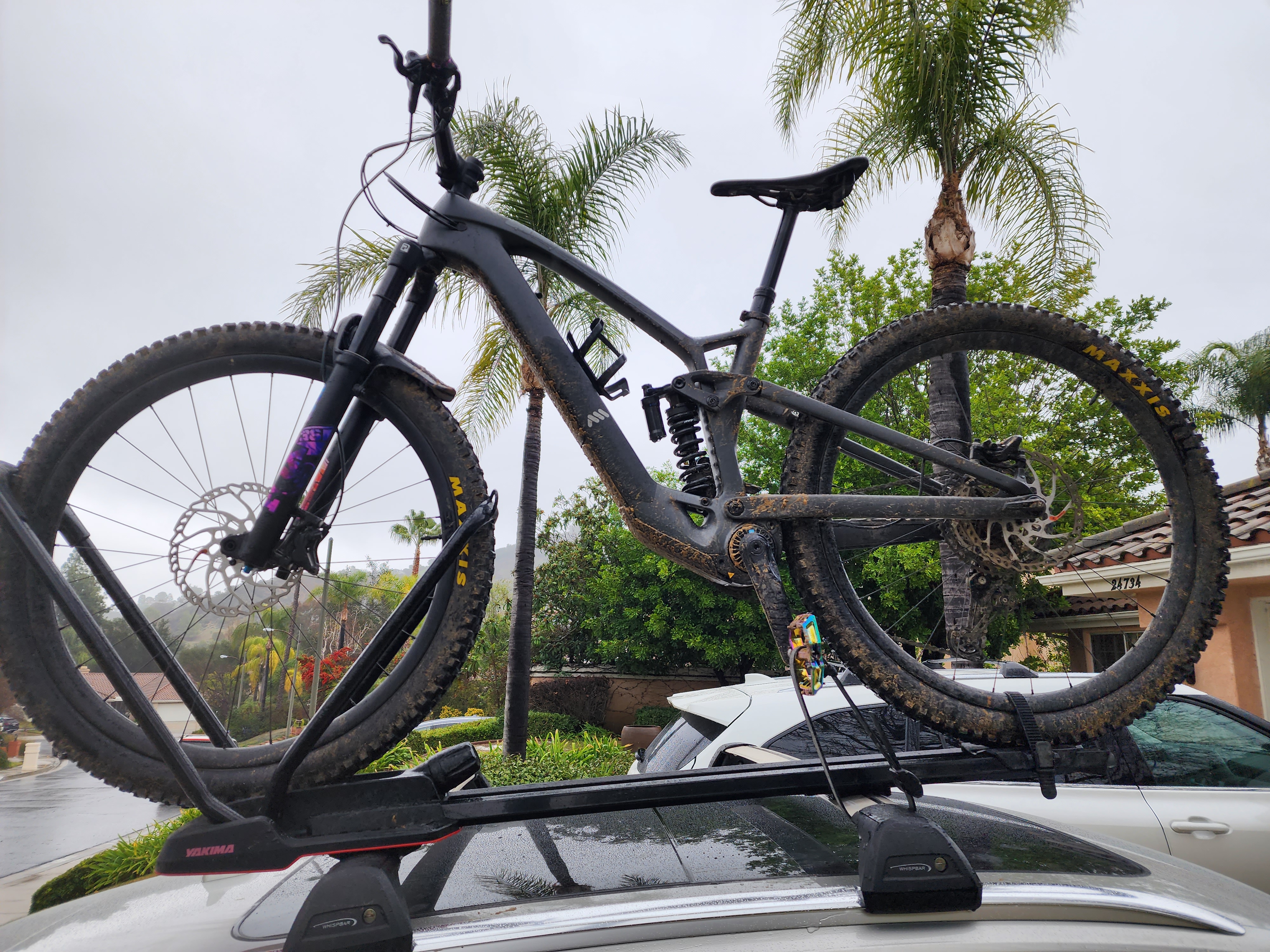

Just picked up and installed my Rockshox Super Deluxe shock with a Sprindex coil. I’ll go for my first ride with this setup tomorrow View attachment 104029
Looks like an awesome setup. What year is the shock? I heard there is a new 2023 version with some neat new features. Once you get the sprindex dialed may be worth experimenting with a progressive spring as well. Looking forward to your thoughts.
I am glad to see you speak so highly of your RS Super Deluxe Ultimate with a progressive coil. Just installed the same shock with a progressive coil and gonna take it fora spin today.
I guess I didn’t pay attention to the year. I’ll have to check in a bit.
