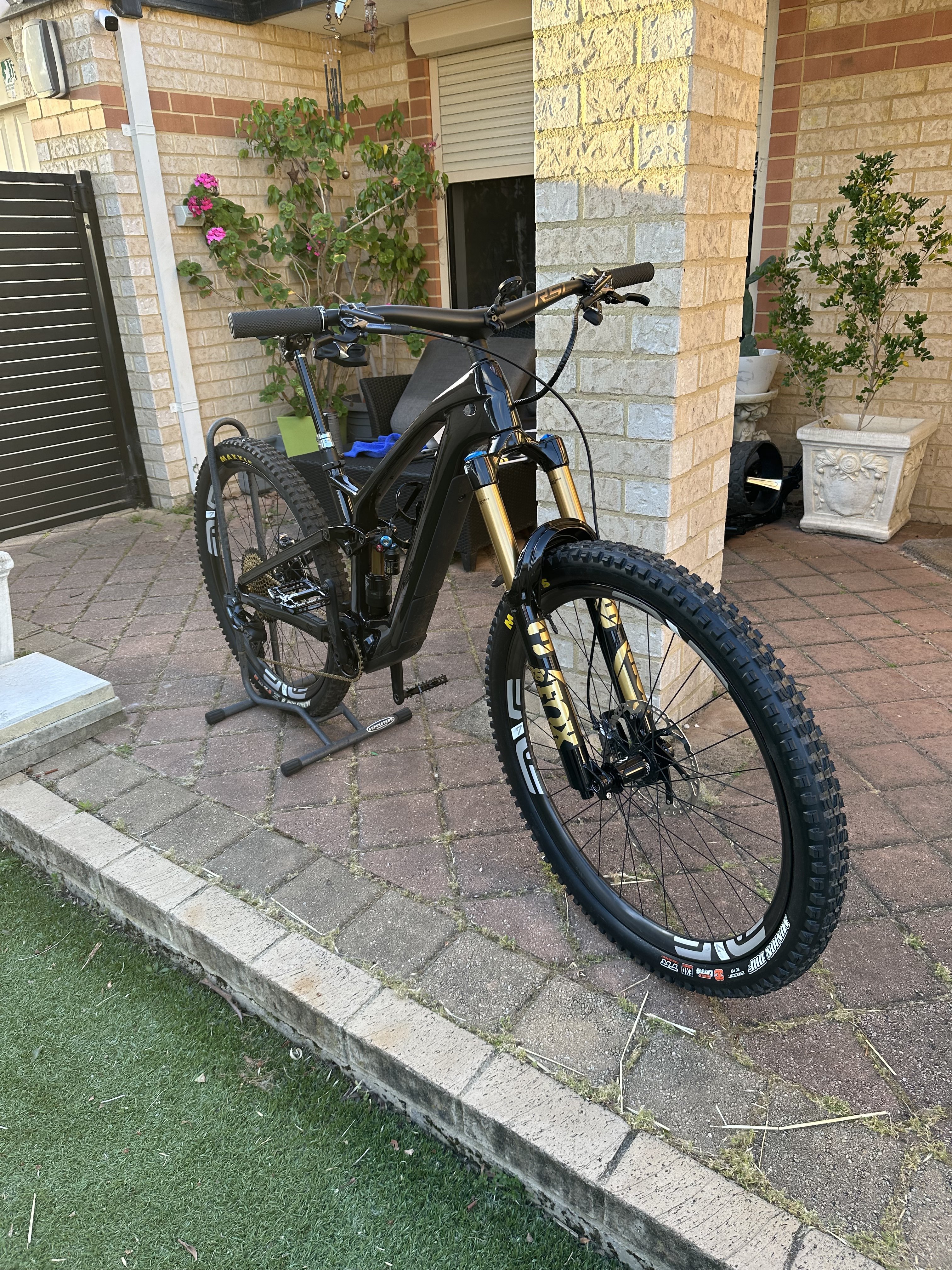

I have a 9.5 turning up next week, I'm going to swap some parts over with some better stuff I have lying around,but I expect the weight will still come in around 19.5 to 20kg.
Will be standard 9.5 spec except for the following
-fox 38 factory fork and RRP mudguard - heavier than stock
-maxxis assegai exo + on front- heavier than stock
-maxxis dhr ii DD on the rear - heavier than stock
-raceface turbine r stem-lighter than stock
-raceface next r carbon bars -lighter than stock
-sram axs mech-about the same as stock
Will replace the (enormously heavy) cassette with a lighter one (xt or e13 probably)when it has worn out in a few months time
May replace the shock witha float x2 I have spare, if I don't like it, but this will be heavier than stock.
May replace the brakes with magura mt7,but will give the stock brakes a fair go first.
All this should make the bike perform better than stock,but prob no lighter,and will cost nothing because I have all these parts already. Will sell off some of the stock parts and get a bit of money back

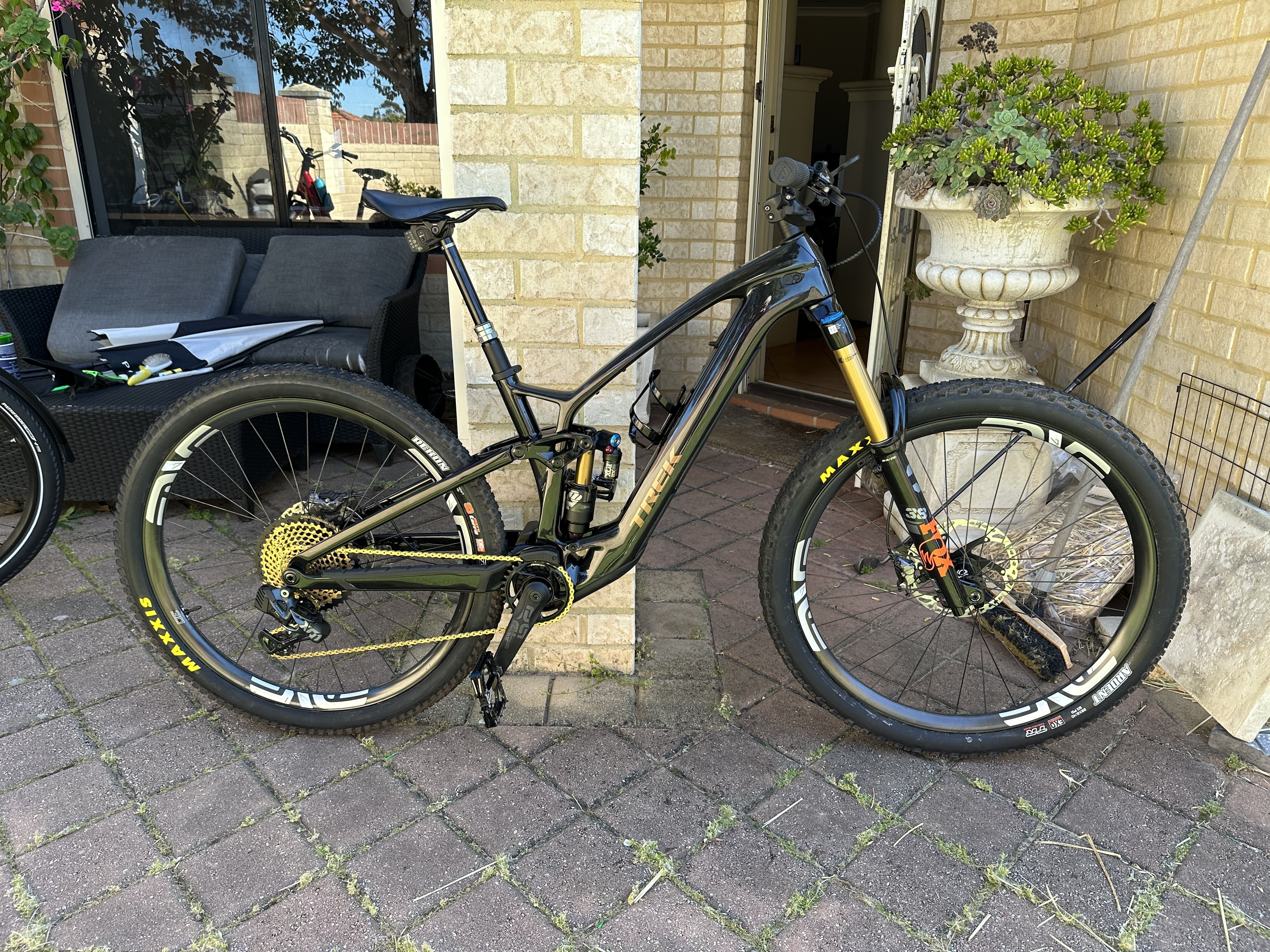

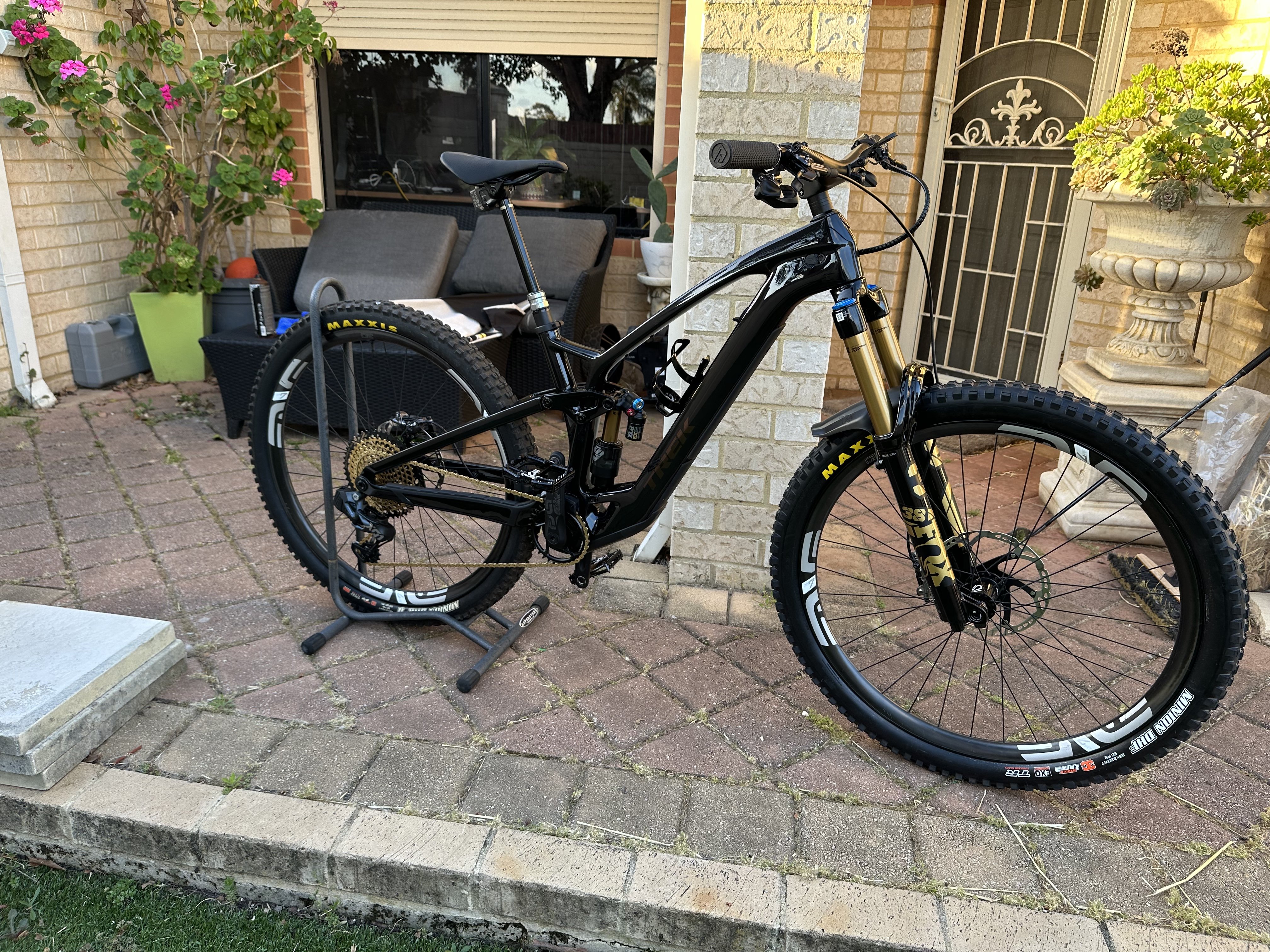

Finished my build fitted a 160 air shaft and gold Fox decals on the forks, really like this bike it does everything really well.
Below are pictures with the 170 travel (red fox decal) and updated with 160 air shaft (gold fox decal)

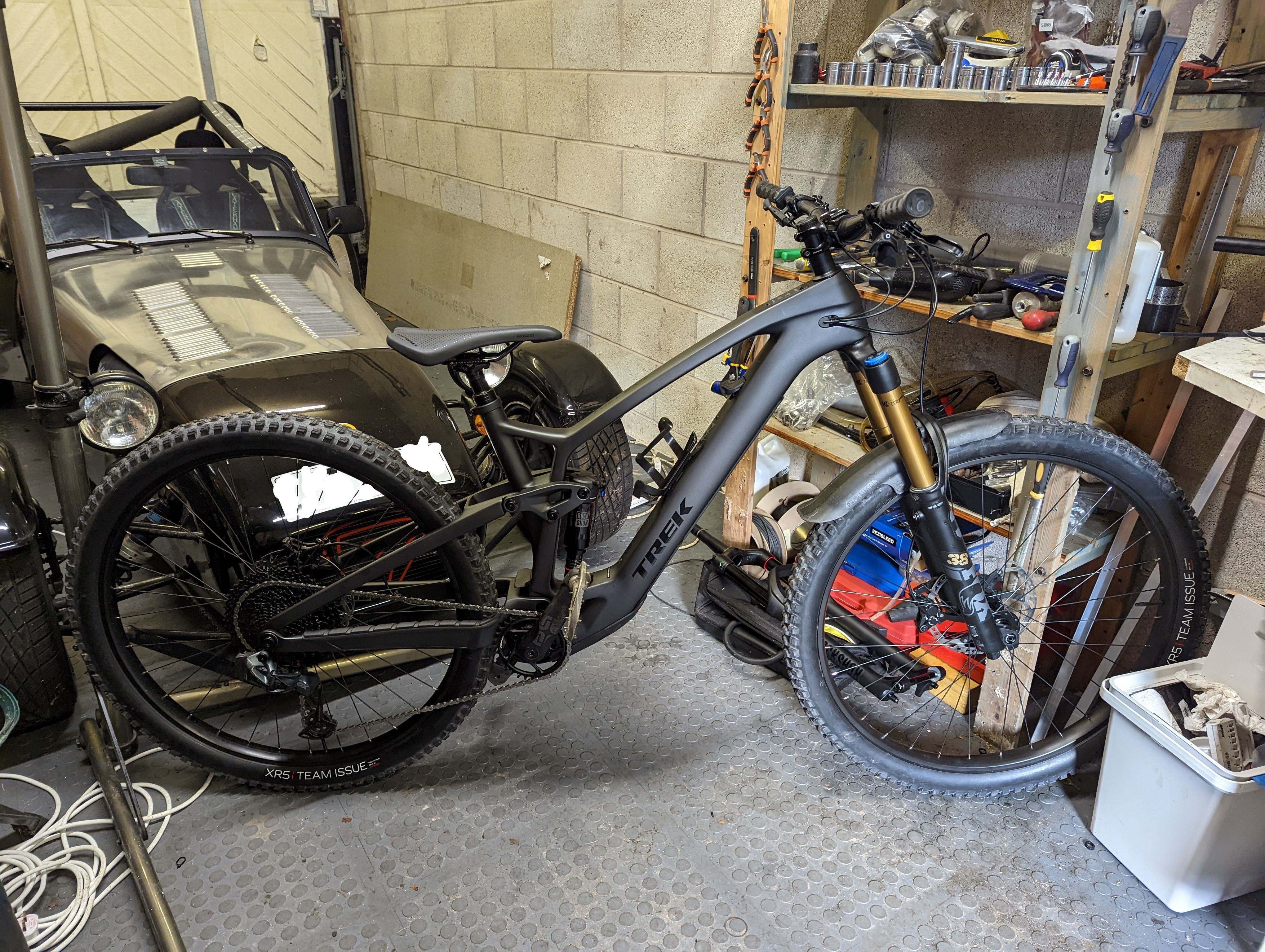

My size large 9.5 just arrived, stock without pedals it weighs a couple of grams over 20kg.
Interestingly, it came with the shimano deore 4 pot brakes, I was expecting tektro 4 pots, so thats a pleasant surprise. And it also came with a shimano xt derailuer, when the spec sheet says it should come with a deore derailluer.
Anyway, it will stay stock except for
-fox 38 fork
- raceface next r bars
-raceface turbine stem
- sram axs gears
- maxxis assegai exo + & maxxis dhri doubledown tyres
I'll wear the cassette out and replace with something a lot lighter, I may swap the wheels for my dt swiss hx 1501 set.
edit: heres a quick pic with the forks ,bars, and mech fitted, apologies for the scruffy garage
Waiting for the same black 9.5, also had a Caterham 7 for 15 years (sadly now sold). Brilliant car :)
I've owned the car for 20 years now,it doesn't get much use these days, too much traffic, too many speed cameras etc.
