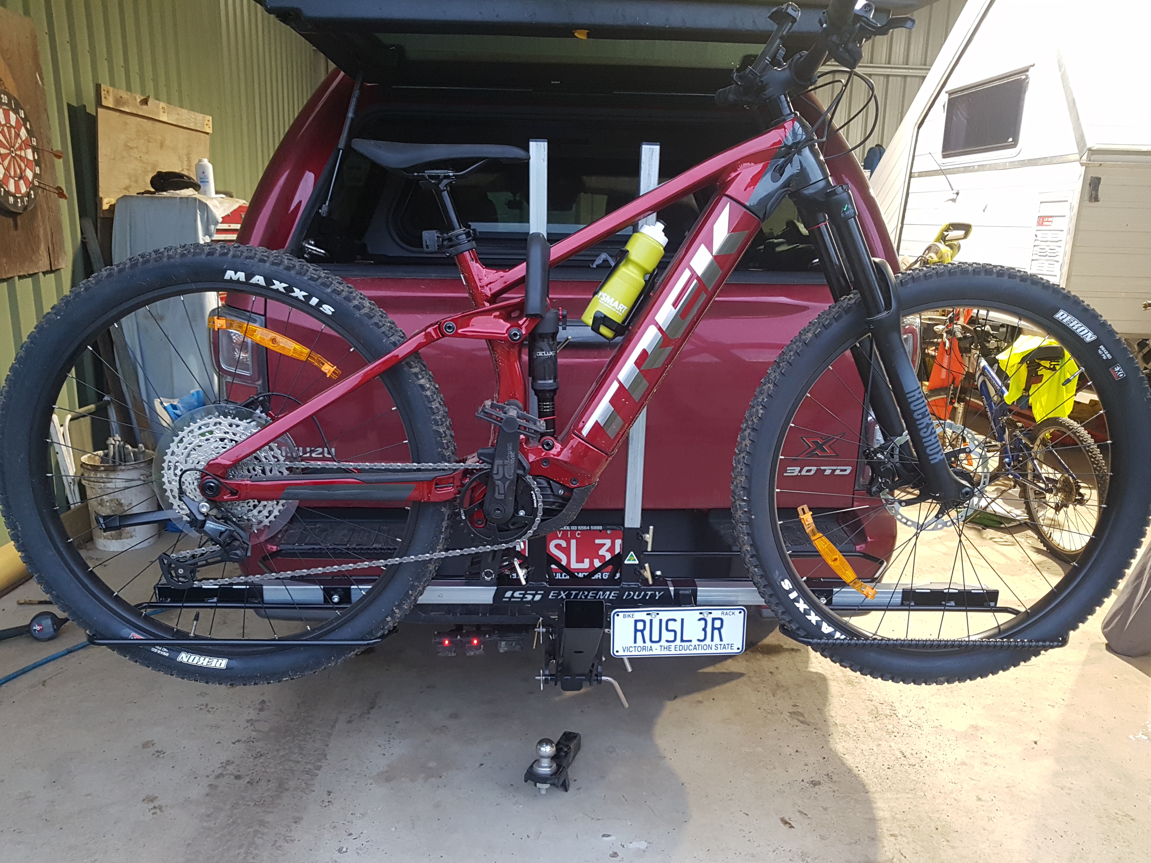

This is an Australian made carrier rated for up to 4 elec bikes, it can also be transfered to my caravan

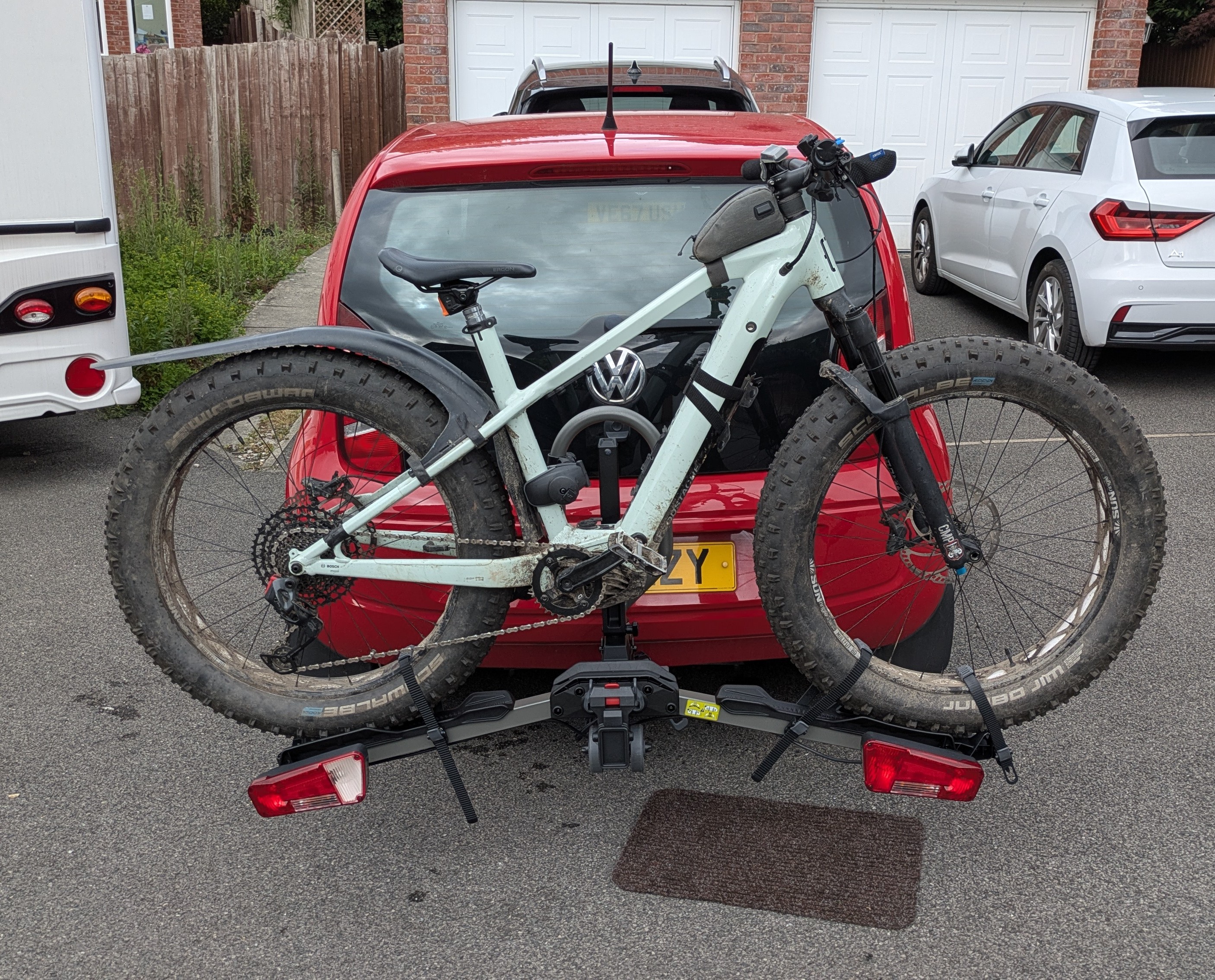

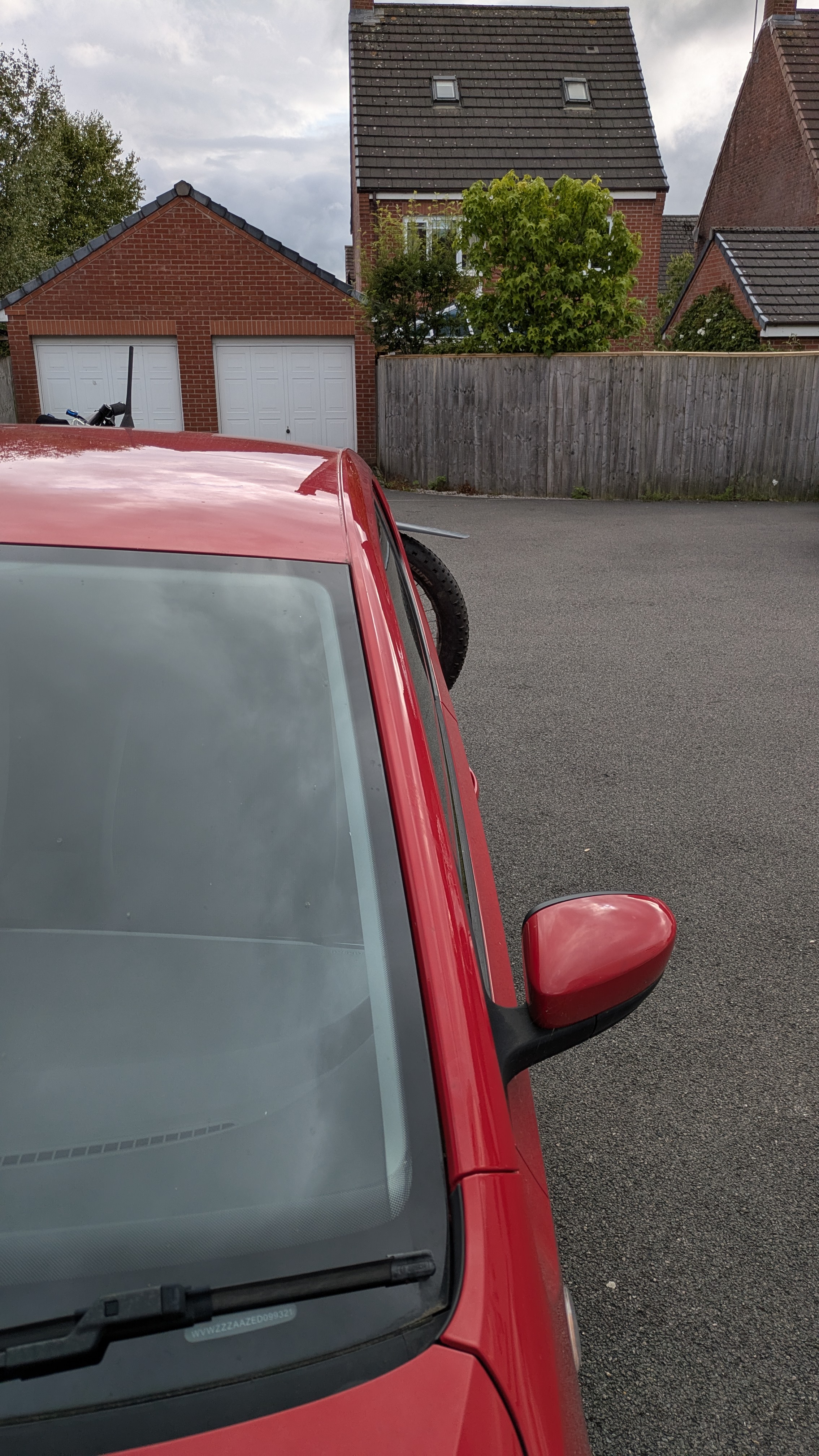

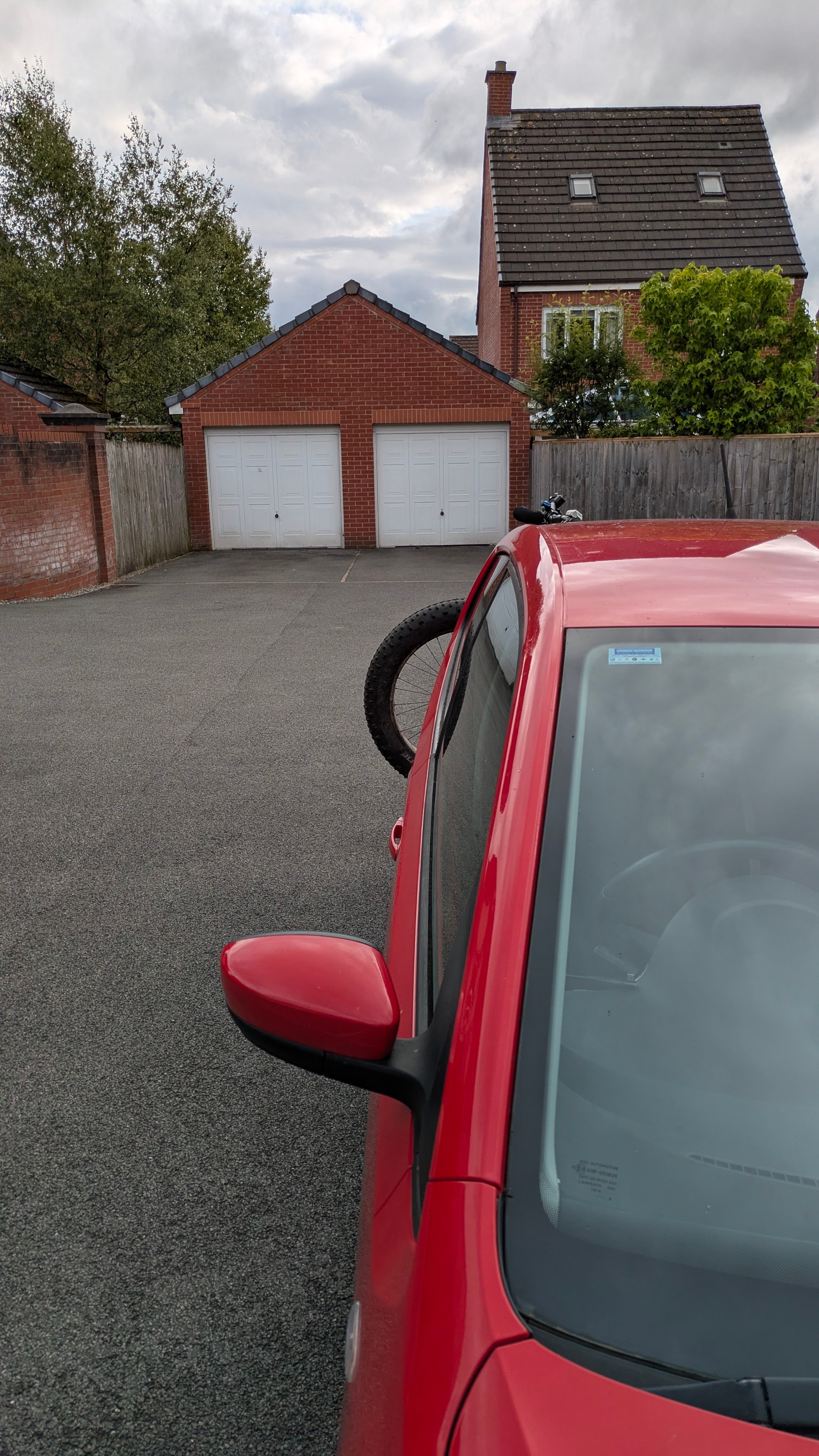

Ok, the bar is on, only issue that was quickly resolved with a hacksaw and file was that the Brinks towball had two small lugs on it to stop you attaching a normal towball receiver to it, but since my Buzzrack does have a normal receiver, they had to go ...🙄
Notice the vitally important doormat, to avoid grazed or muddy knees when fixing the towball on. 😁
And yes I know I forgot to attach the rear number plate....
Looks almost like you fitted a side mounted car rack to the bike?! 😂😁👍
View attachment 162526View attachment 162527View attachment 162528
I had one of these towballs with the lugs fitted at the dealers, it’s called a “non towing tow ball”, go figure. It’s because the car, which is a hybrid, was not “homologated” for towing. Fortunately the hitch had open sides so fitted ok.
