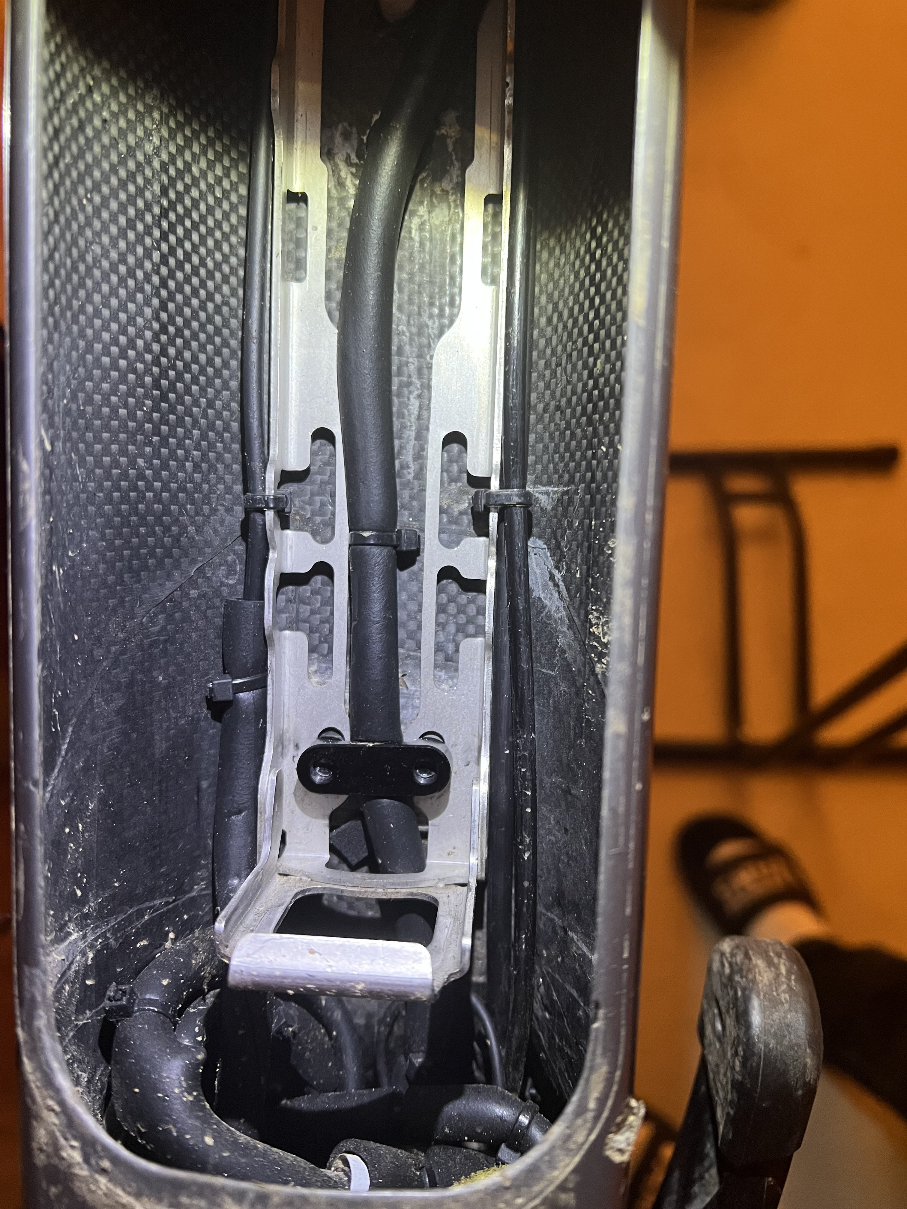

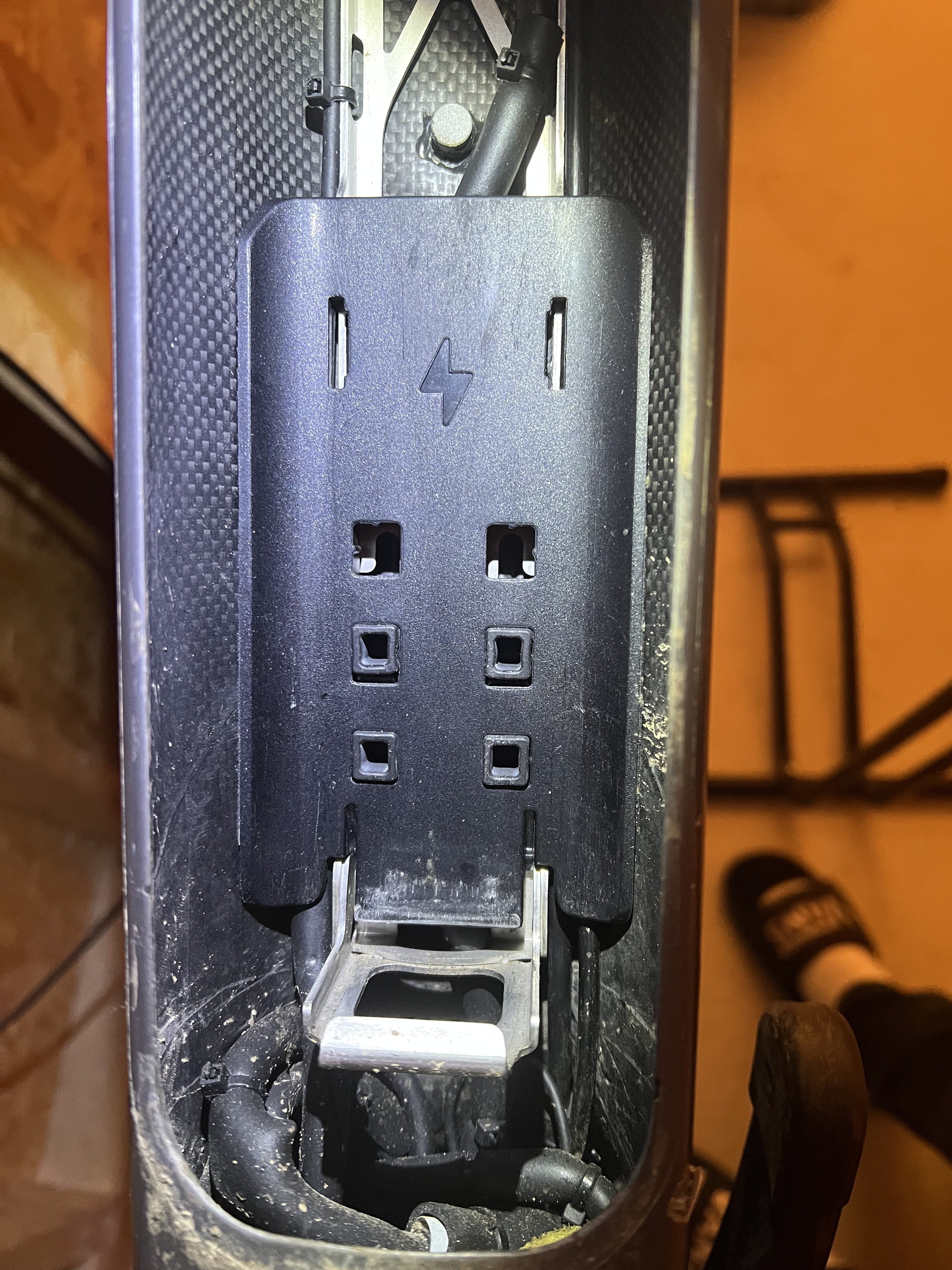

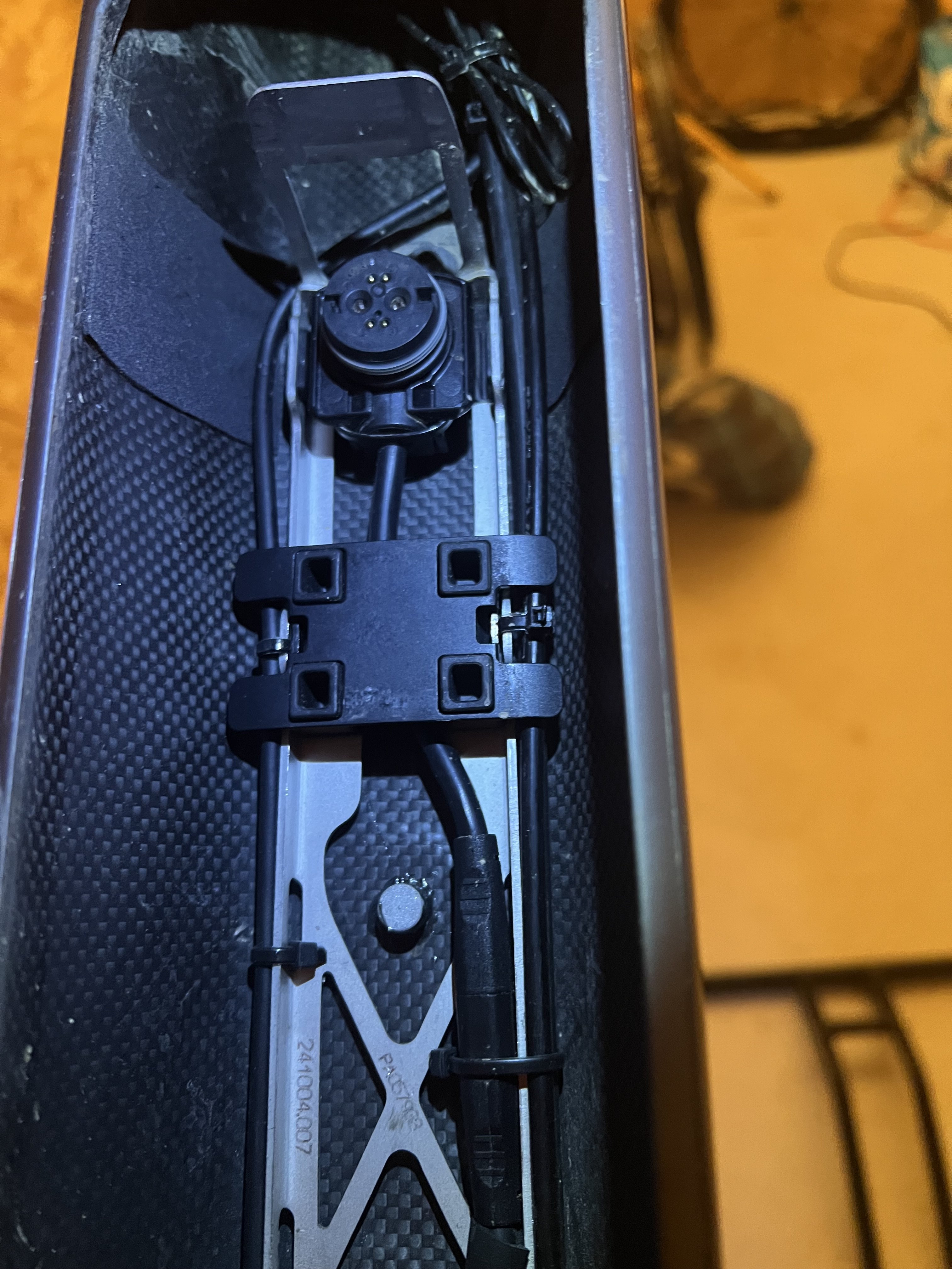

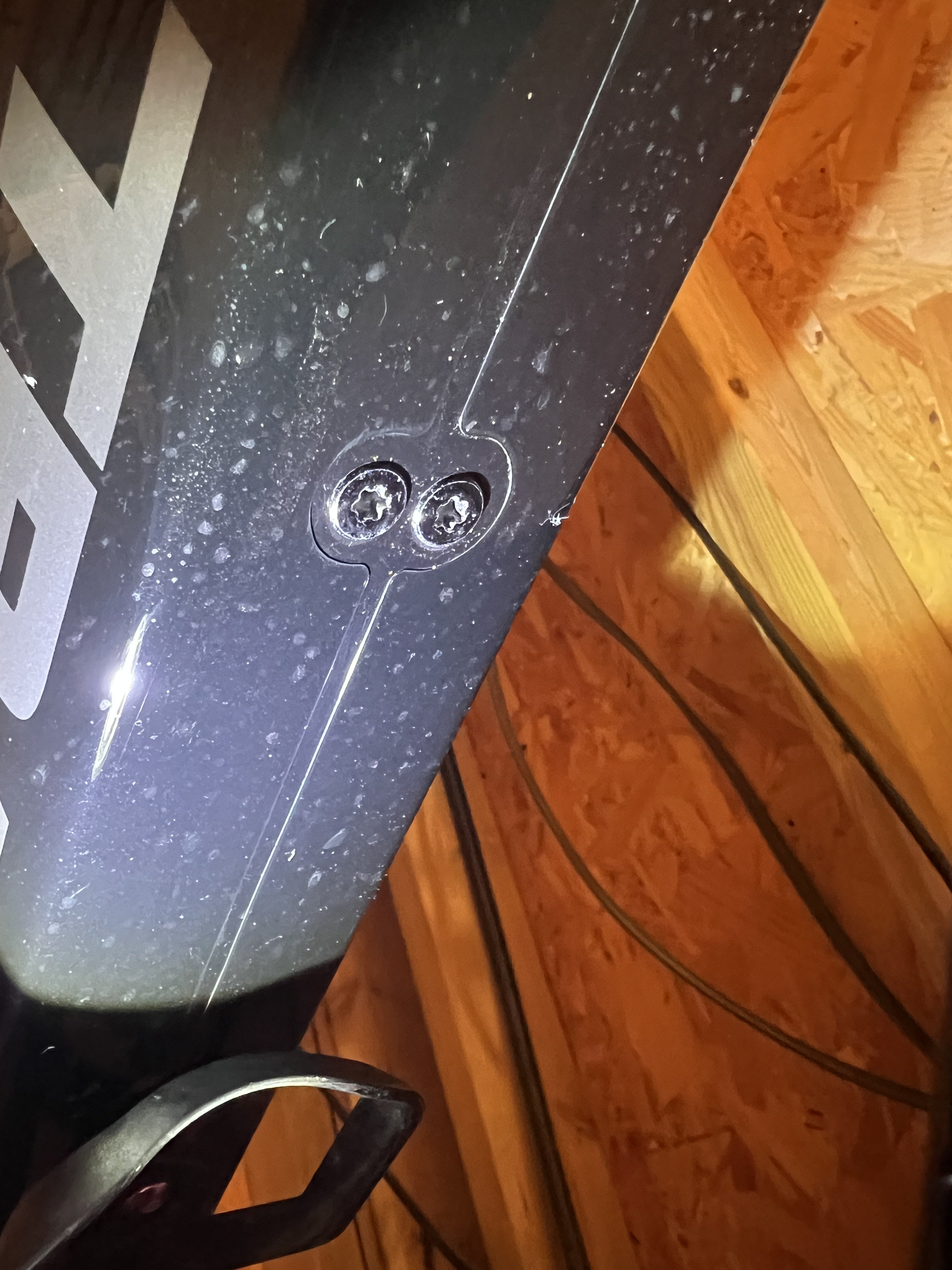

Hey guys! I need help please. I have a bare frame transition relay with no internal mounting hardware for the battery. I’m looking for a picture(s) of inside the down tube with the battery removed. Transition is not being very helpful I’m selling me parts. I have sourced a bunch of different pieces but it super helpful if I had a picture or 10 😉 of inside! Any help is greatly appreciated!
I’ve got a Relay. Have you got none of the parts at all?

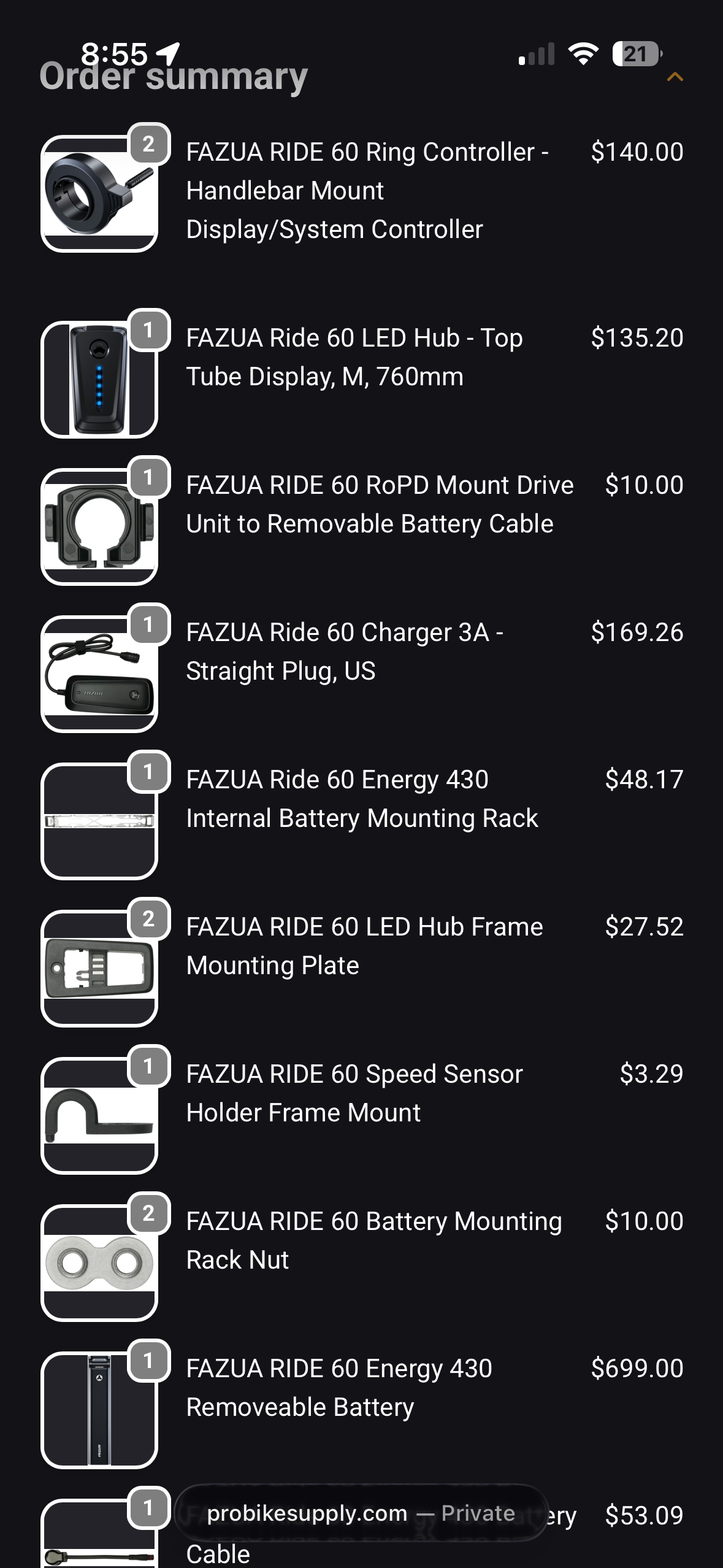

Came with a motor! Battery is ordered and on the way but everything else is gone. I’ve put together a parts list to order from fazua but mostly just guessing.
Stick your parts list up and I’ll have a check when I get a mi ute and add some pics.

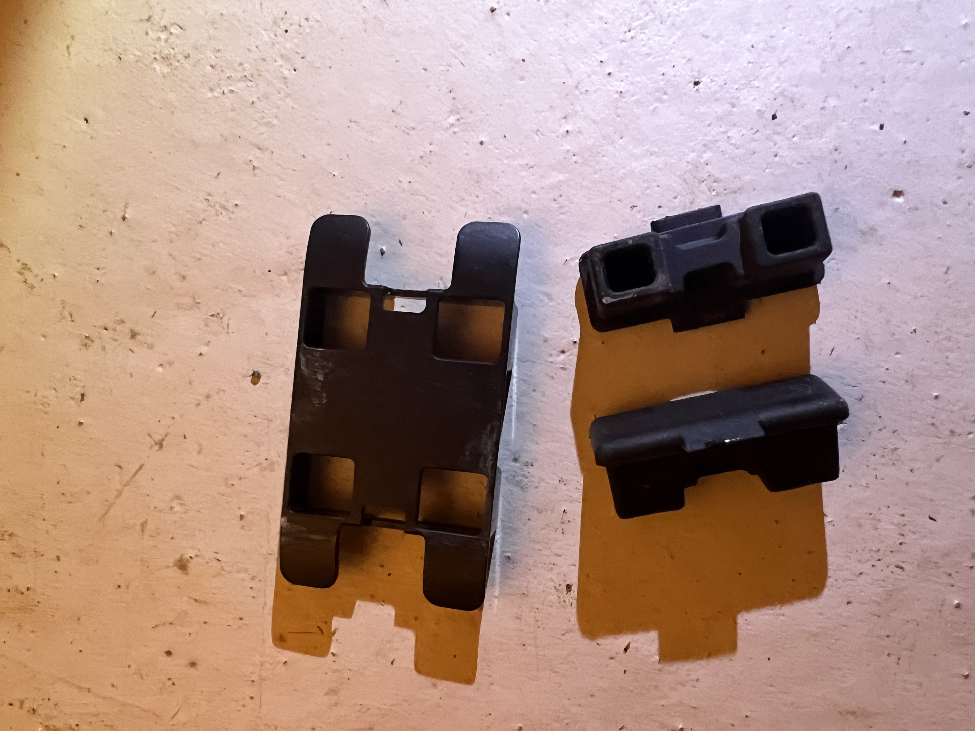

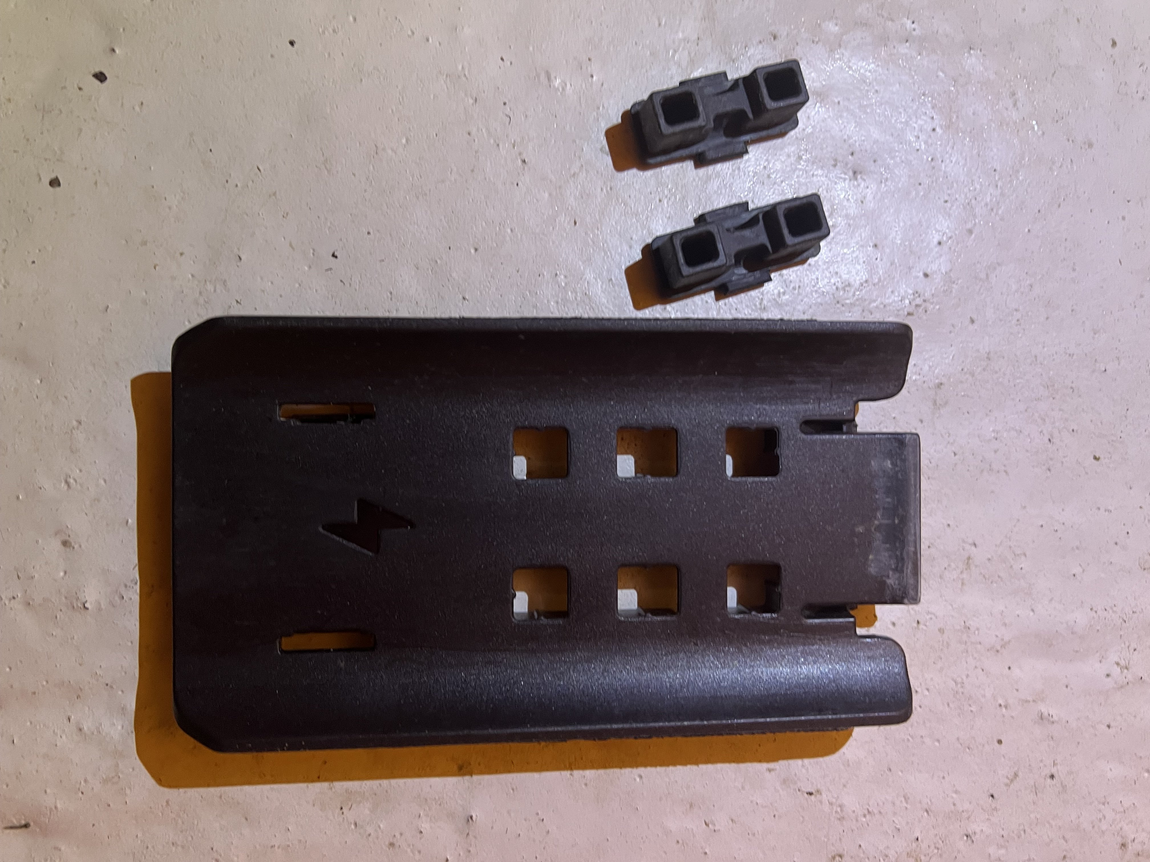

I think you’re missing the lower battery spacer FAZ-AS-62A106000A
The rubber damper thingy’s you need 4
The speed sensor cable can be a large if it saves you any money.
Also there’s now a 480wh battery and a new ring controller.
