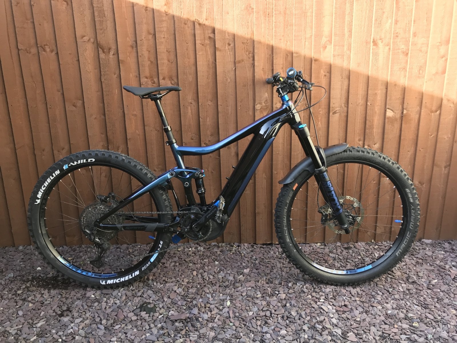

Ewild on the rear all year round. The Ewild front, whilst mighty in the wet, lost a touch of composure for me in the dry, so the Minion DHF is back on until it gets soggy again. Tyres, done.
