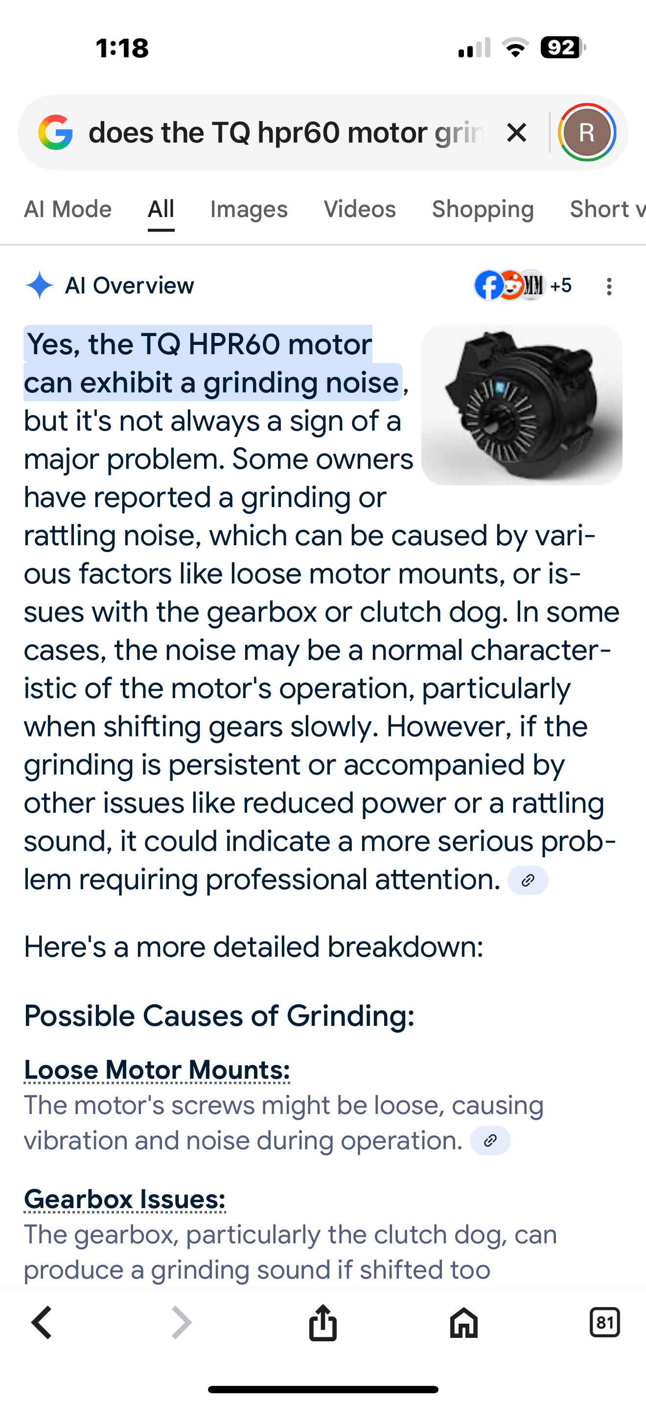

Do newer HPR 50s still have this grinding noise?
And what is about the new HPR 60?
Quote from a article review article about the new 60 motor. ( I can't find anything mentioning whether the new motor has the same grind as the old 50 )
