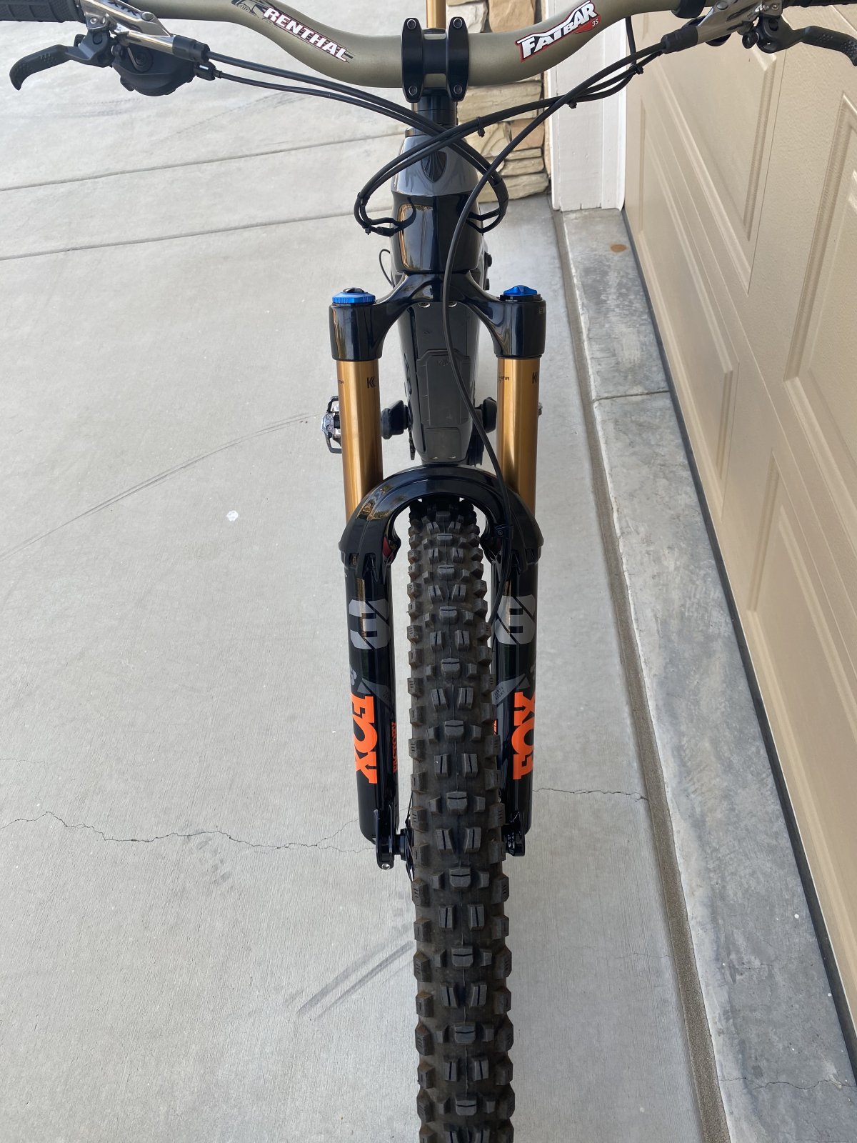

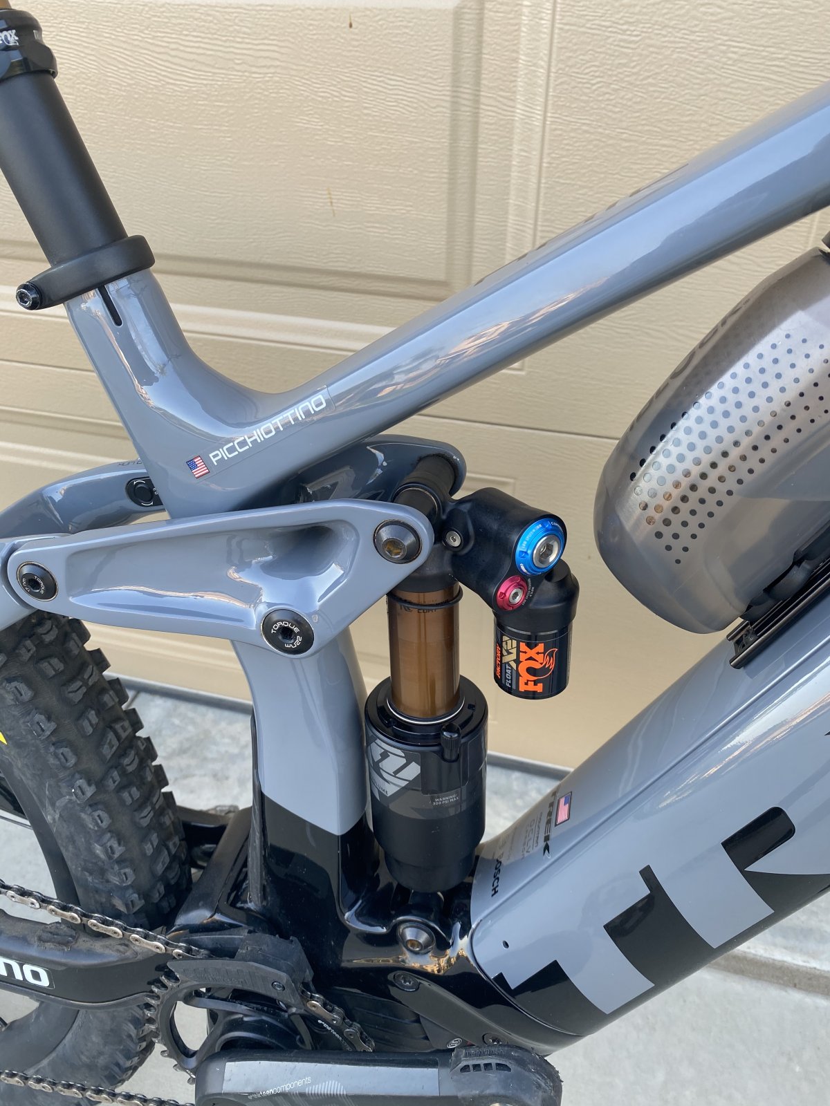

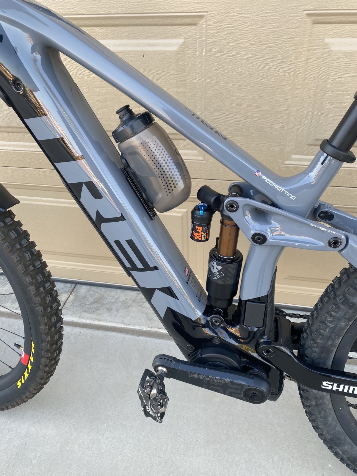

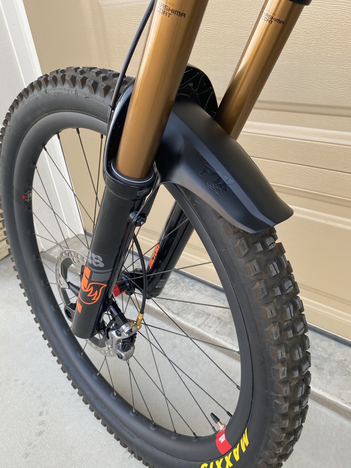

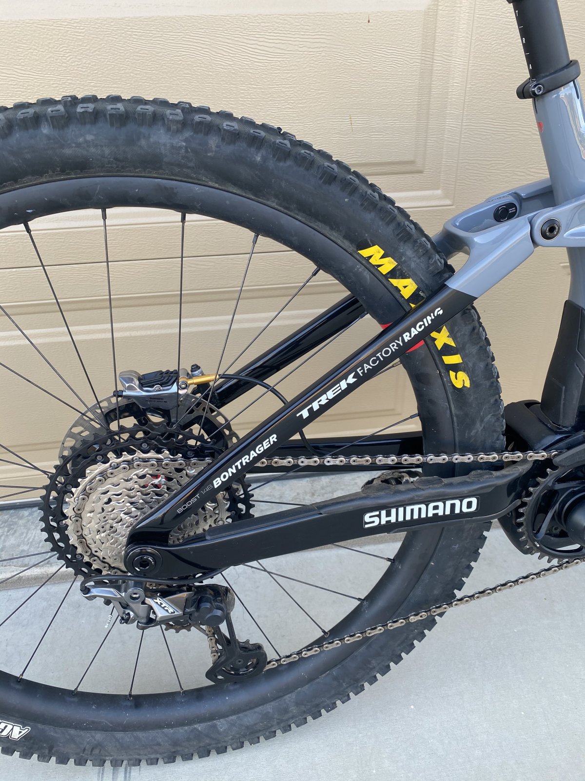

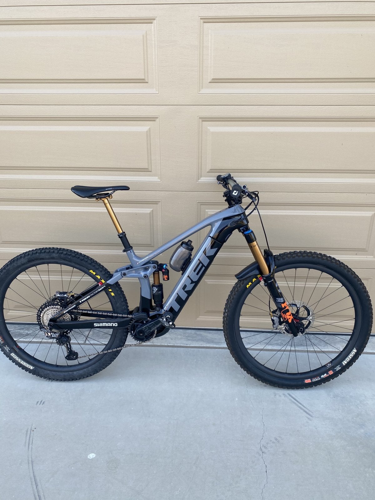

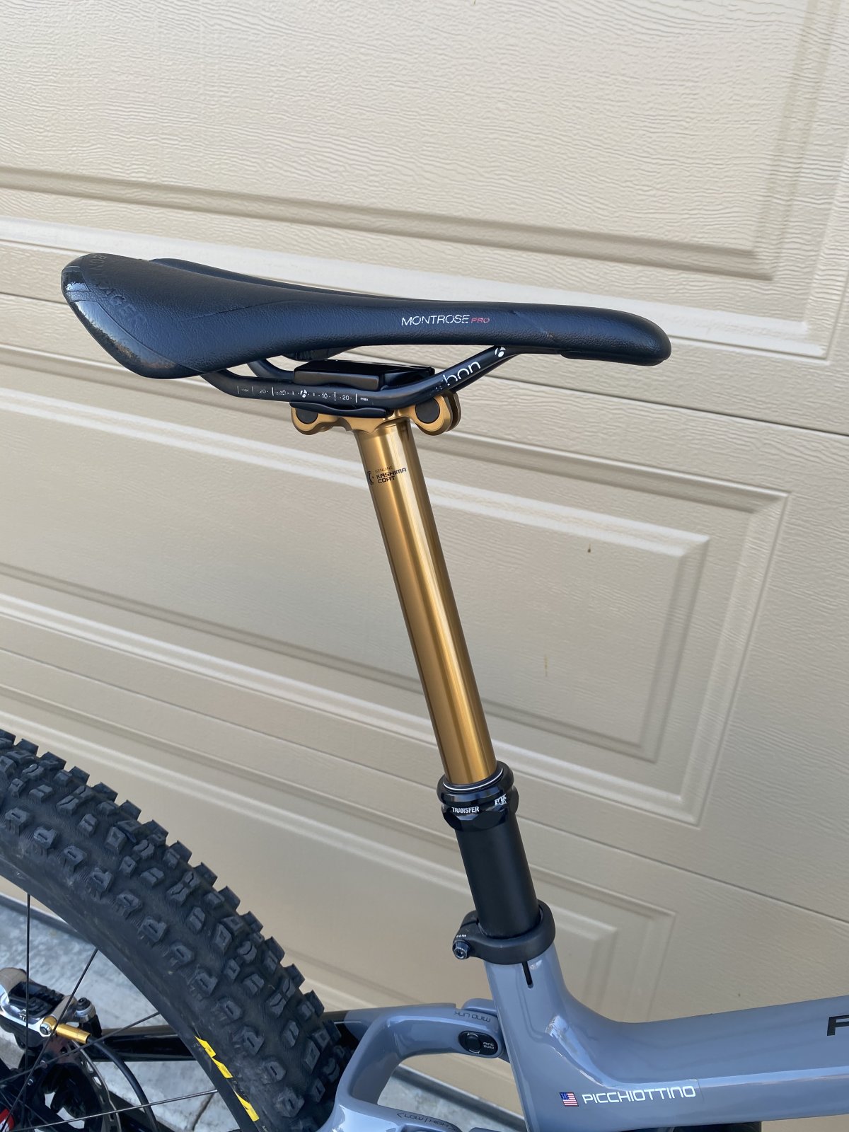

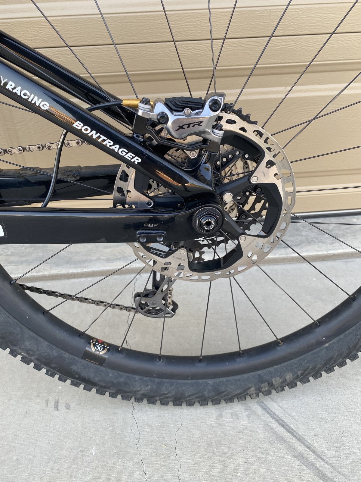

Been riding Trek e bikes for past 4 years and the new rail is a game changer especially with fox Shimano and Maxxis
Hello @Tpicch! I'm really curious to know the size of your frame, as well as the stroke option for the shock. I have a Medium 9.7 coming soon and have been looking out for when the 2021 Float X2 will be available again in the 230 x 57.5 spec. There's availability of the 230 x 60mm at the moment and I'm wondering if I can swoop it now, knowing that it'll fit my frame when it arrives later. Thanks for any info you can provide!

It’s super easy to reduce the shock to 57.5 all it is is a shim you can get them from Fox 60 mill might work just make sure you let all the air out cycle it so I don’t get the frame
