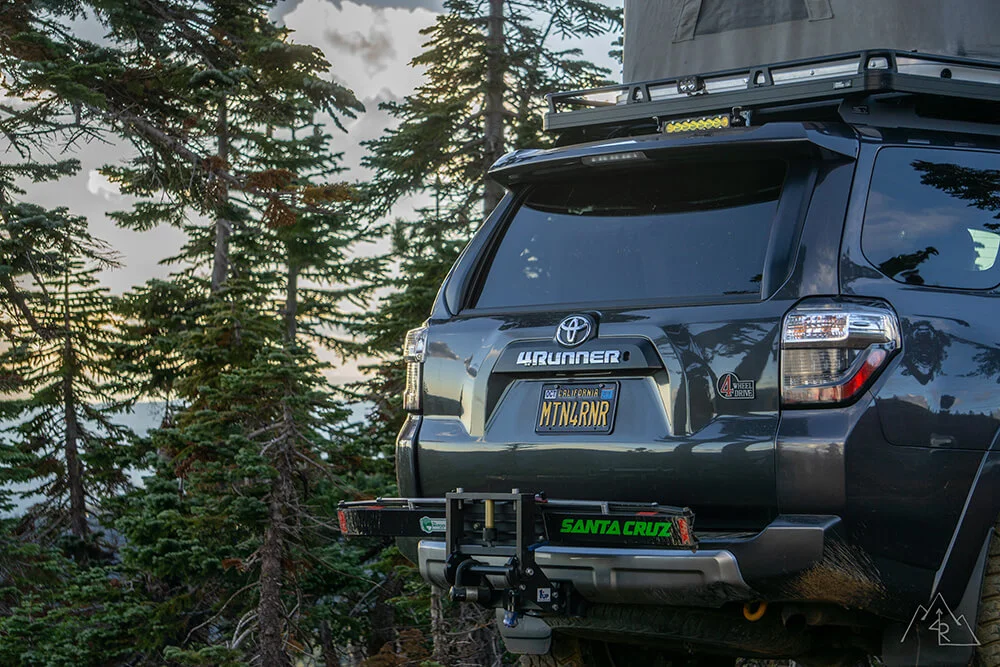

I don't know what their availability is in Europe, but I'm the States the go-to rack is 1UP. All metal construction, all parts available separately, they only touch the tires if the bikes, expandable up to 4 bikes, and loads of available options. After owning one, I would never use anything else.
Agree 100% with this. An aircraft quality rack that is rust and corrosion proof, and fully modular from 1 to 4 bikes. I often go myself and in the 1 bike configuration it's so small you can leave it on permanently, doesn't interfere with backup cameras, liftgates, license plate, etc. It's trivial to add one or two extenders to carry more bikes, or you can buy an inexpensive adapter that makes the extender a stand-alone unit so you can carry one bike each on two cars and so on.
EDIT: replied before reading subsequent posts about EU regulations. There are license plate holders that make it easy to move the plate between car and rack, it comes with reflectors and doesn't block turn signals or brake lights, but not sure how compliant it would be otherwise.

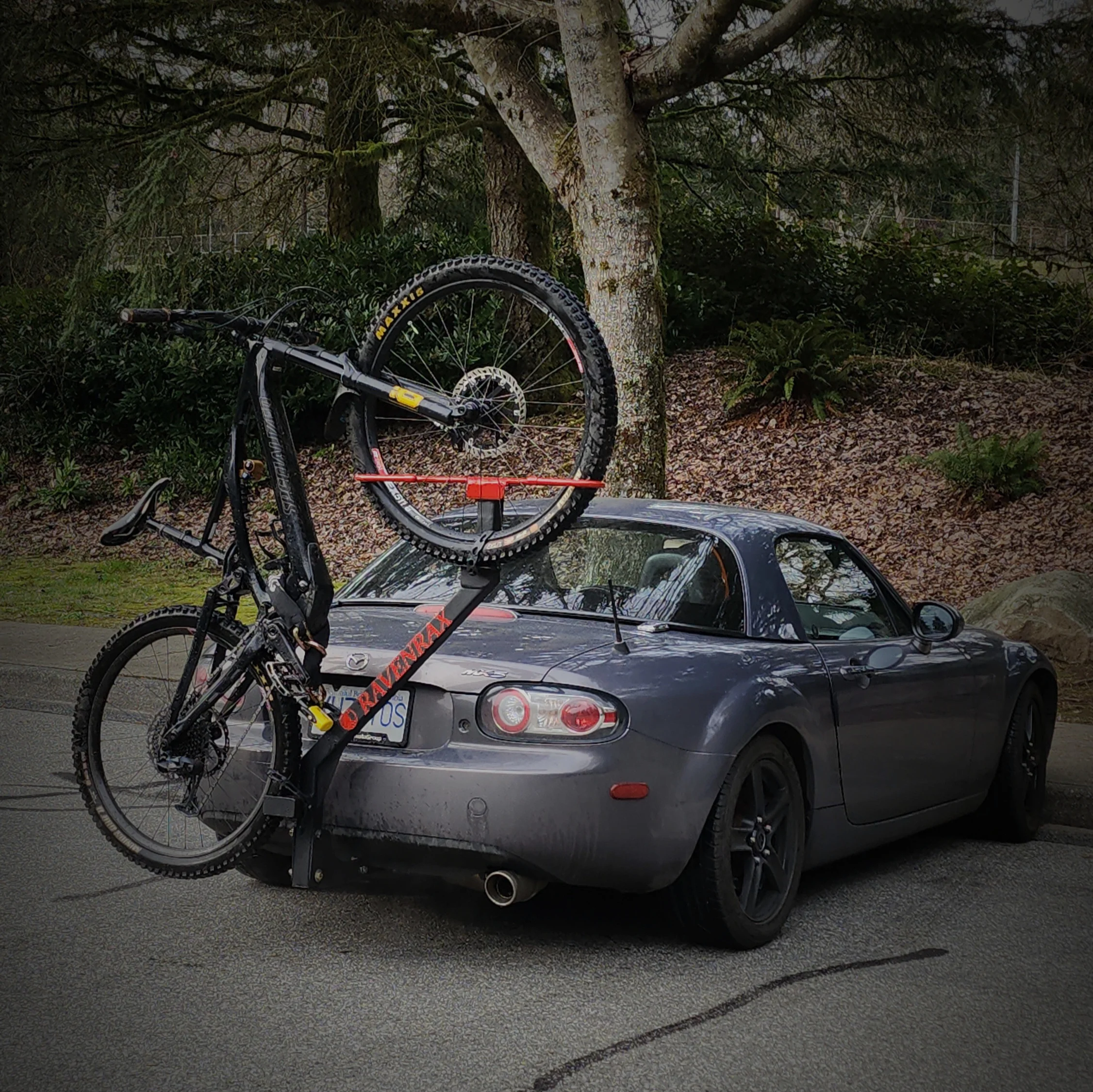

Best rack I have ever used. Holds the bike well, not to heavy, rotates down for easy trunk access and it has enough space for all my riding Bros too! (Pic edited to clean up back ground debris).
One up, only rack I'll use now.
Securely holds bikes, only touches tires, can handle ebike weight np.
Folds and tilts so suv back doors work...
A little pricey but about the best.

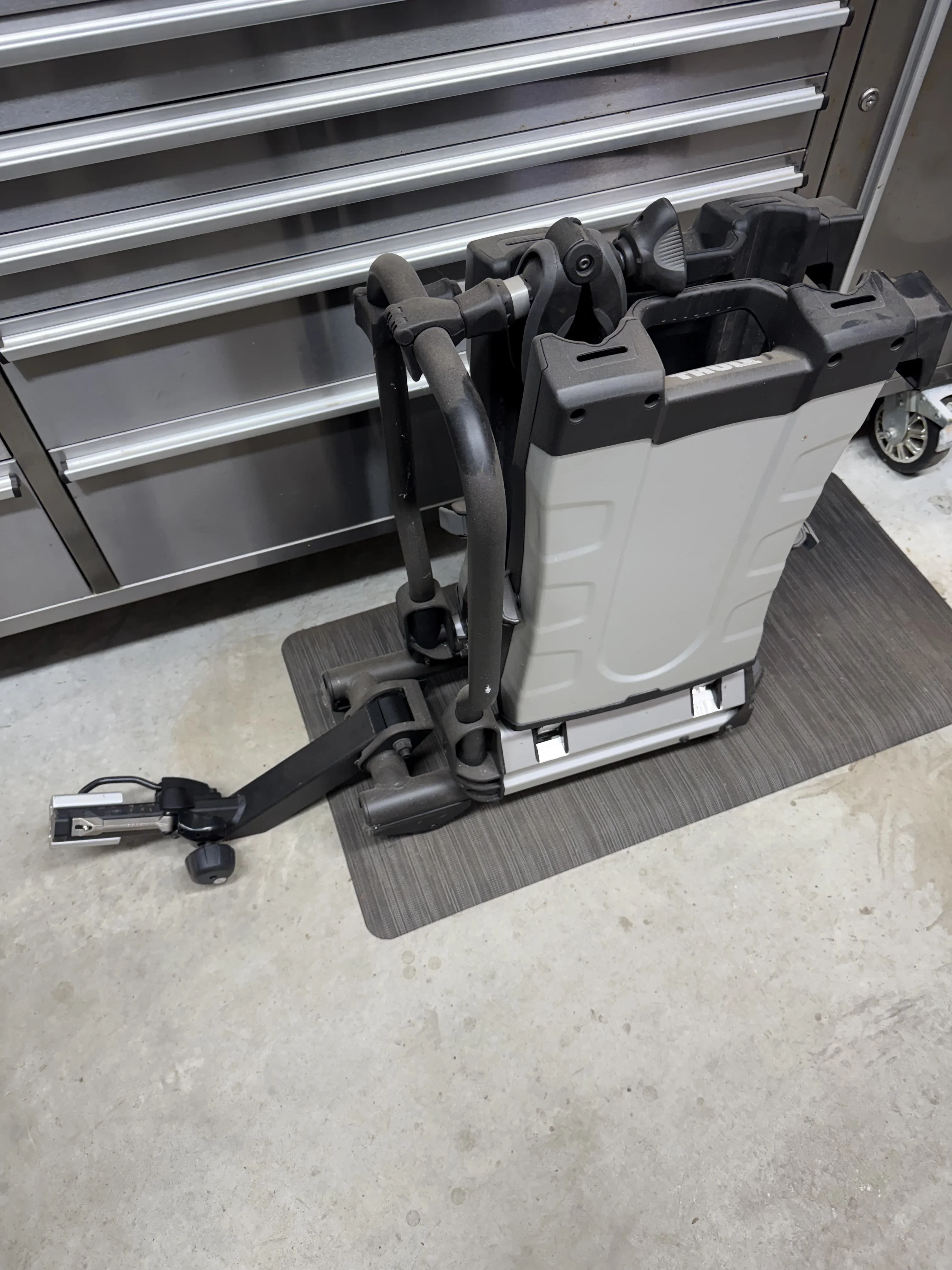

I suppose if I was needing a bike rack on a regular basis I could use an easier, or larger rack than the Thule Easy Fold.

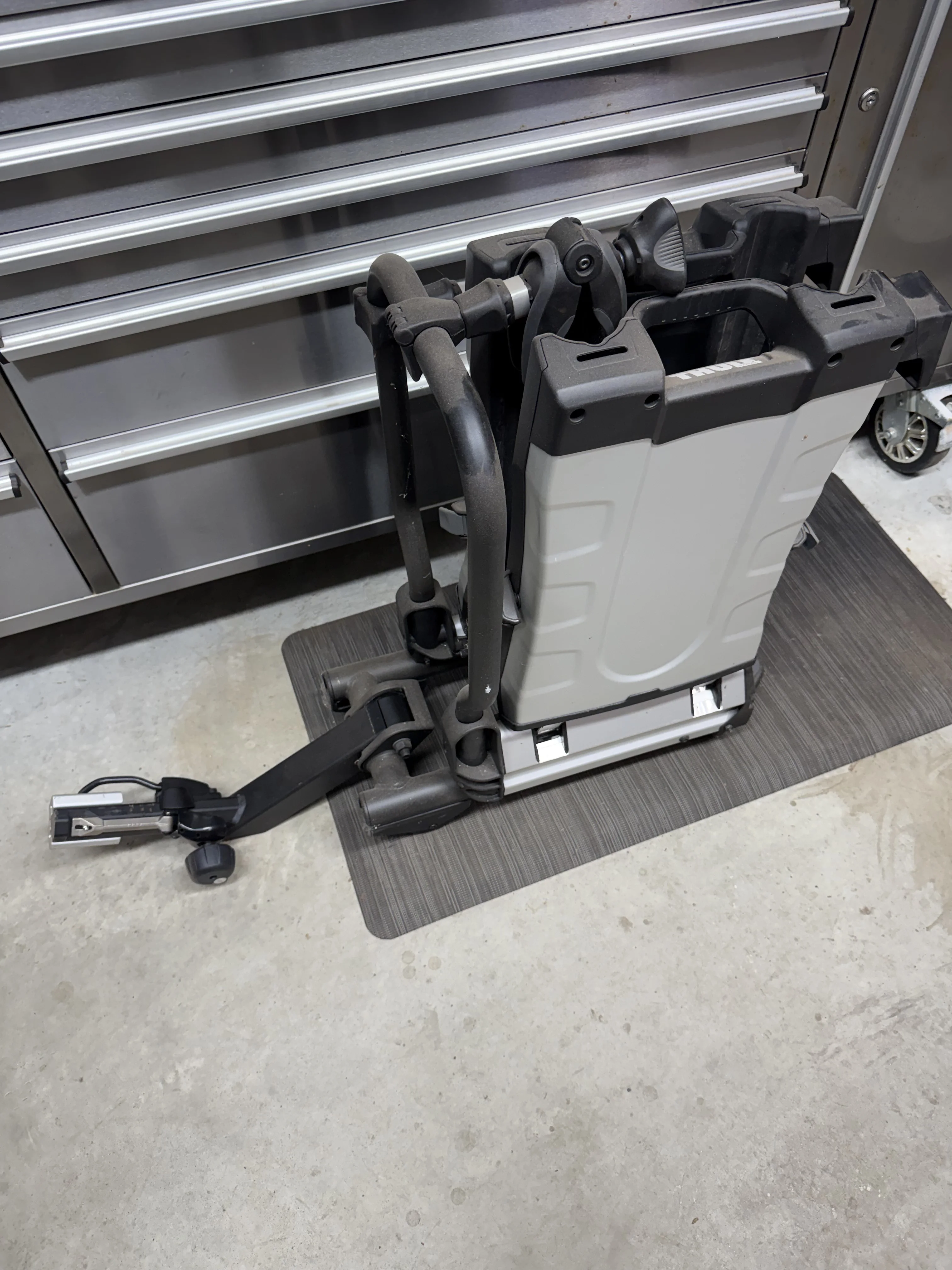

The Thule Easy Fold takes more time to setup …but it does fold up nicely and can fit in the boot/trunk. A typical rack needs more space for storage when not needed. I’ve installed a few “fake 2” receivers” in some bike caves/ garages. However you need the wall space or a suitable area for that.
I roll the Thule Easy Fold under my bench…out of sight …and ready to use 4x a year.

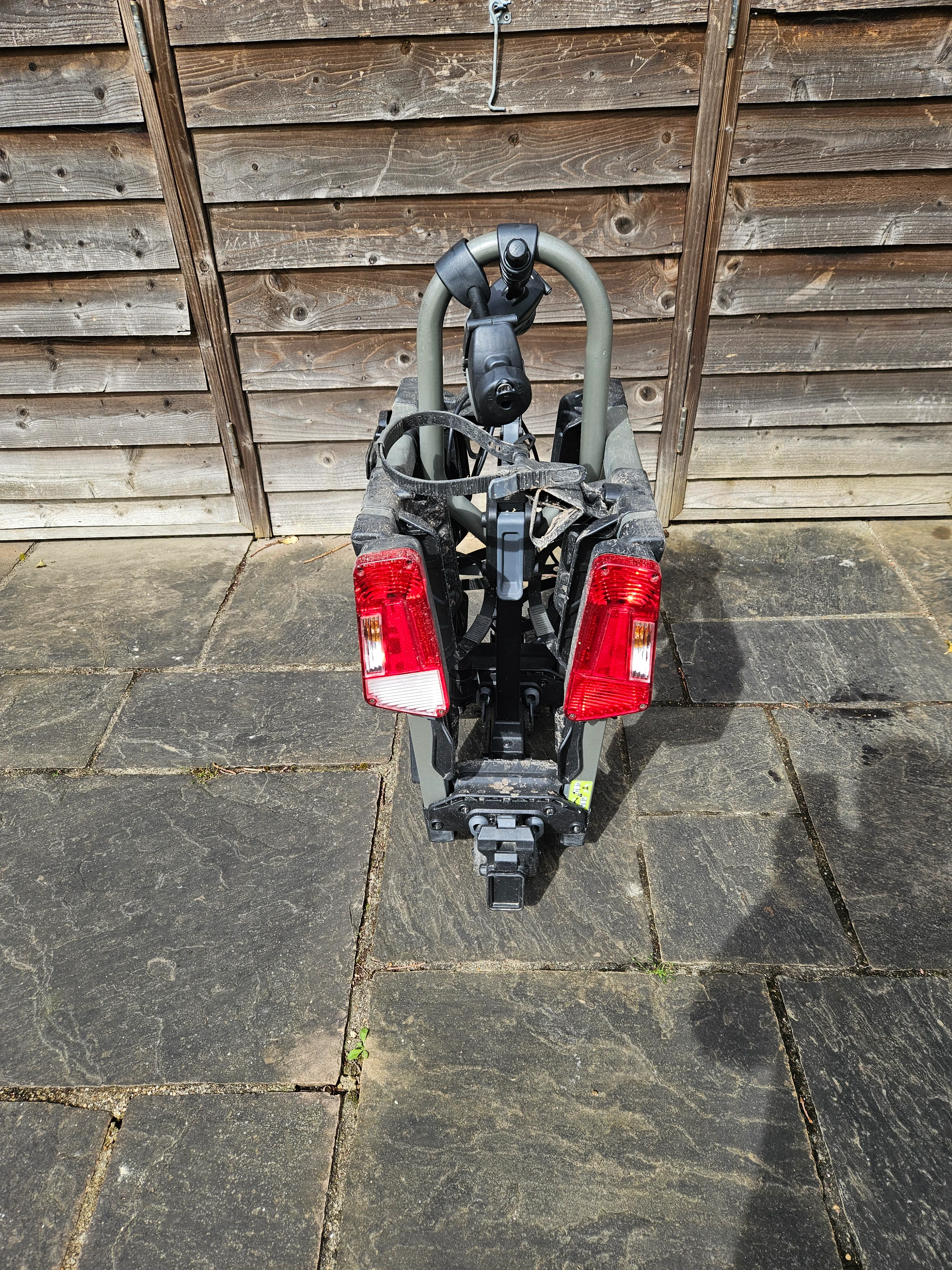

Yes, it does, using mine this afternoon to take two Trek Rails to the ebike Motor Centre in Fordingbridge for motor service.
Just got it out with winter mud on it!
Had Thule before, now rocking Yakima (emtb foldable model) highly recommend it.
Does this fold up nice and easy?
Yes takes seconds to fold up and has wheels so you can push it along if you have a nice paved driveway/garden. Also the number plate can be stored on the side of the rack when folded to allow easier storage. A van is definitely the end goal for transporting an ebike in the UK.

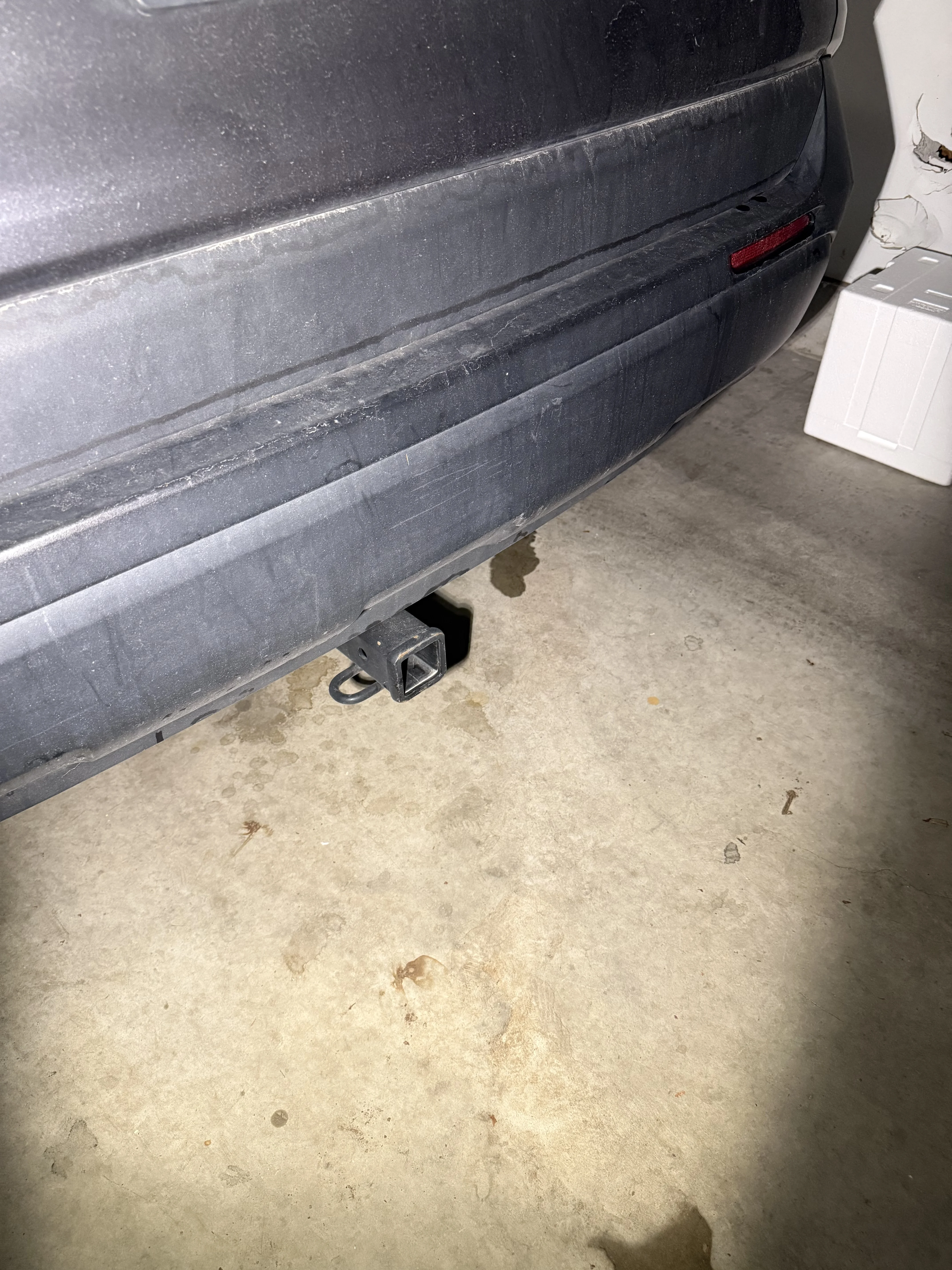

Not sure if this helps but the 2” hitch to bumper clearance is 5cm on a RAV4 Toyota. The ground to hitch clearance is 24.5 cm.
I wonder if a hitch extension is available? Our hatch easily opens when the rack is tilted.
