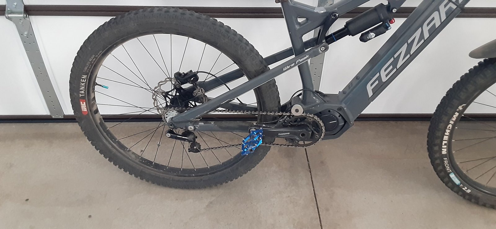

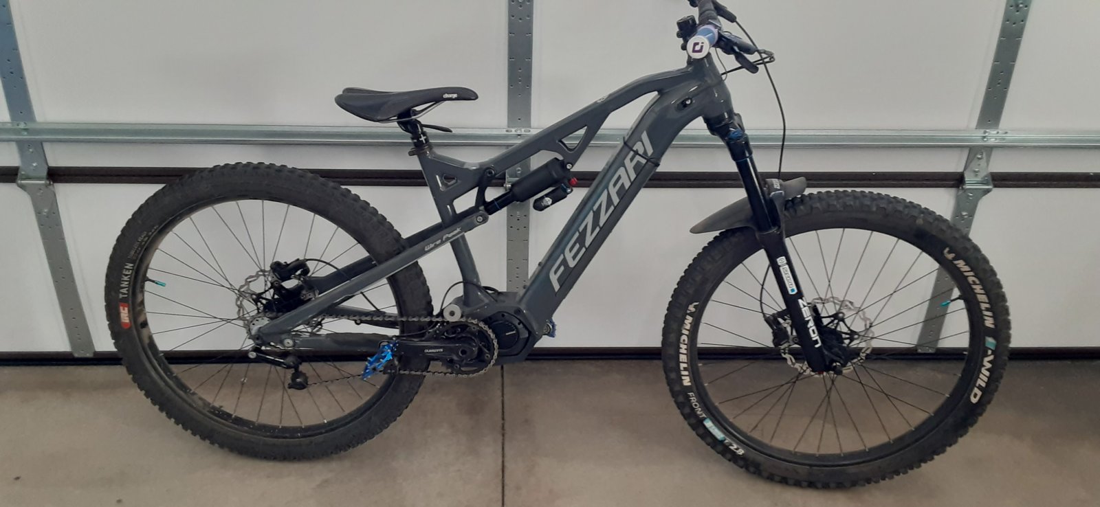

With all this whimpering going on, you'd think that at least one rider would convert their awful old twelve-speed into a single-speed.
I'm not accusing you of that I'm just saying that if you want to have 10 speeds with at the end 50 teeth, you're going to end up giving up that 10 toother. If I had a 12-speed micro spline drivetrain of quality I'm pretty sure that I would try to get a hold of that ebike specific Shimano stuff and try that before I went to 10 speed even if it's considerably more expensive because the whole sebang needs to be changed. I mean if you cant afford to replace the parts and you have to step down that's a whole different story. but usually people describe bikes that they're riding to be considerably valuable and costly I mean if we're talking about a DIY deal well yeah definitely you should definitely do it budget if that's your necessity. I'm just realizing that the cost of these cassettes if you really take good care of them is manageable.
Funny that you would mention eMTB single-speed. Yes I convert my Wire Peak Comp to a single speed for the bike park season, when I don't need all of the gears to climb. :)
