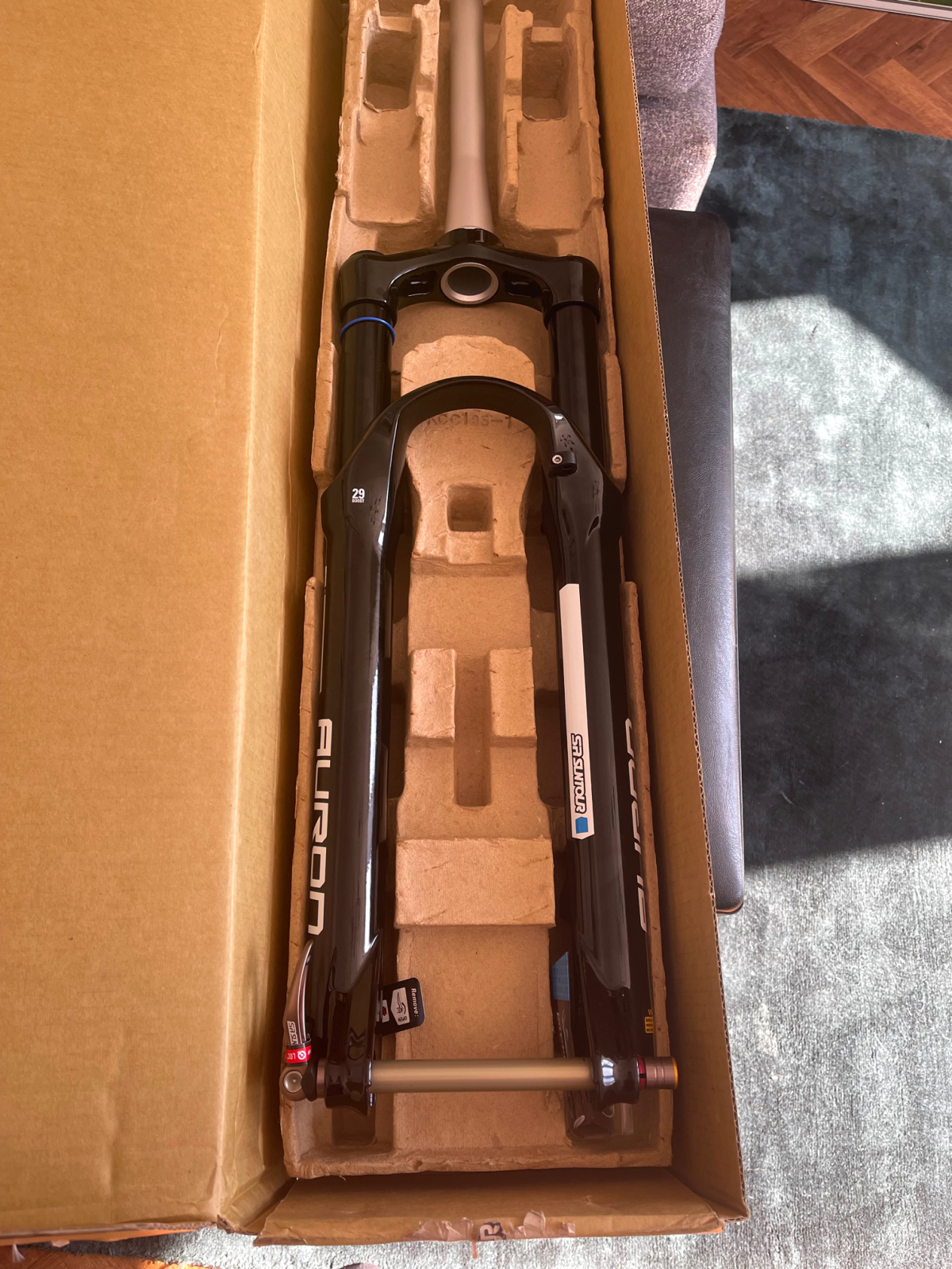

New fork arrived this morning, hopefullly have it fitted before the weekend.
I’ve gone with a small increase of 140mm, see how it feels. With the auron fork it’s reasonably quick to adjust the travel from 130mm to 160mm in increments of 10mm using the spacers that are supplied. So if 140mm doesn’t work I can change back to 130mm.

Looks like it only take around 30 minutes to adjust the travel, so hopefully it will give me plenty of options for trial and error.

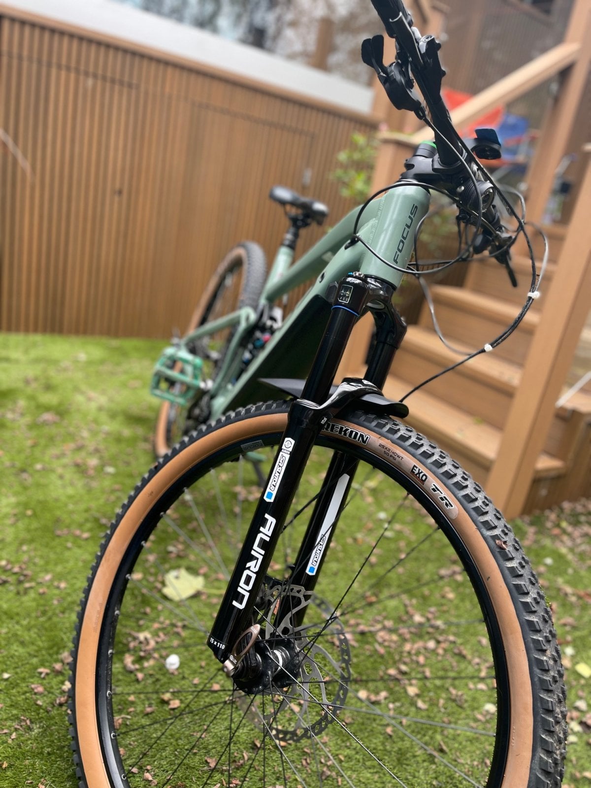

Got the bike back from my local bike shop with the Auron35 fitted.
I haven't had a chance to ride it yet just do a quick setup during my lunch break.
One thing I noticed when putting the bike into its storage, there is more clearance above the handlebars, it appears to sit lower than before which would indicate (assuming the fork was set up properly at 140mm from the factory) that there could be room to increase the travel to 150mm without having an impact on the geometry.

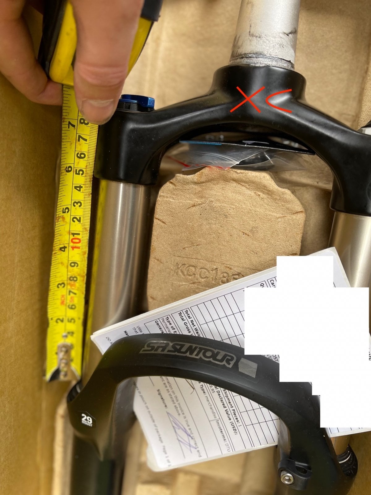

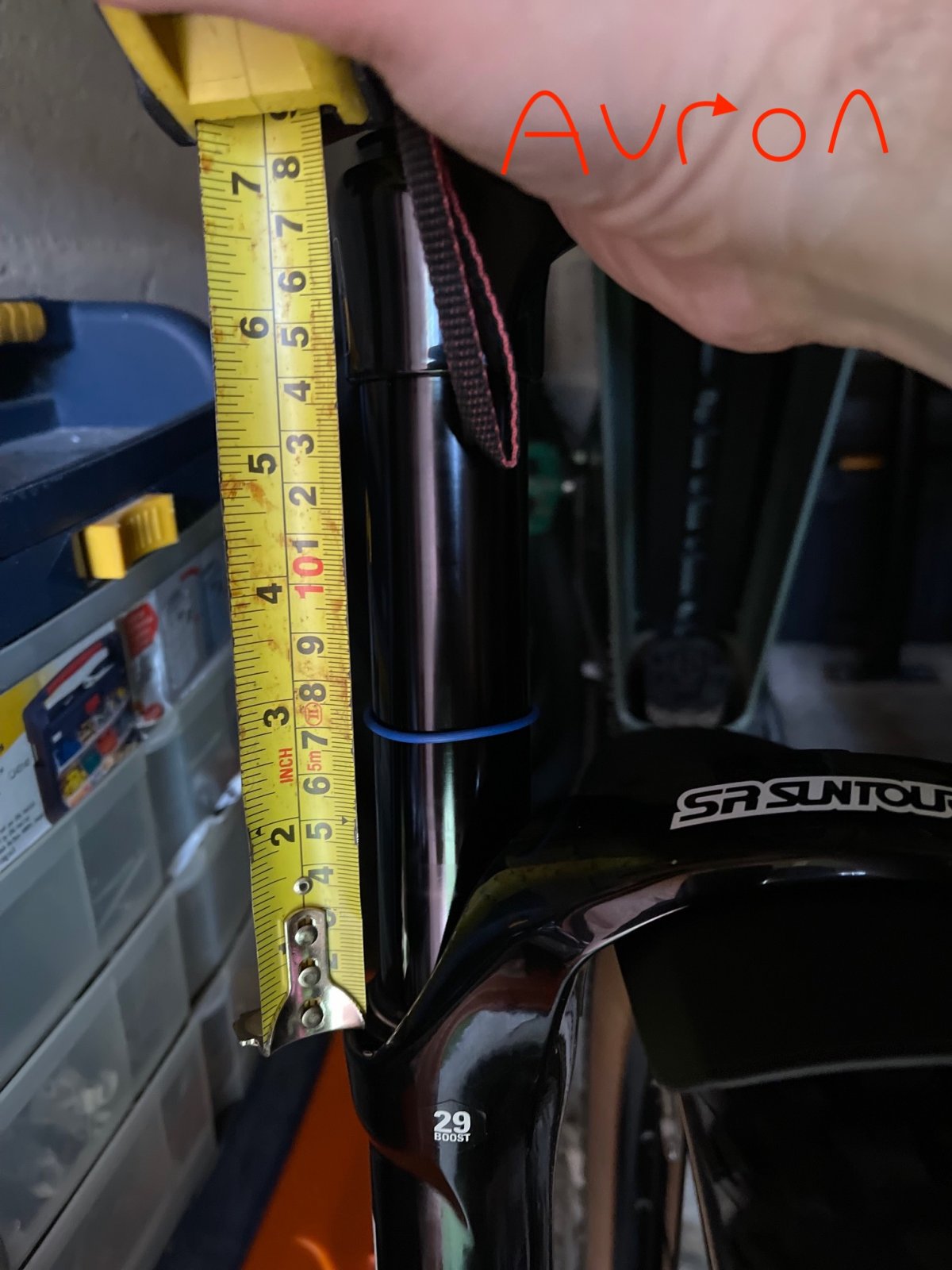

As a quick comparison I measured both the Auron and the XC to see if this was the case. I know there are many more variables and I will take some better measurements from the axel later when I get time. But hopefully the travel can be pushed further.
View attachment 72127View attachment 72143

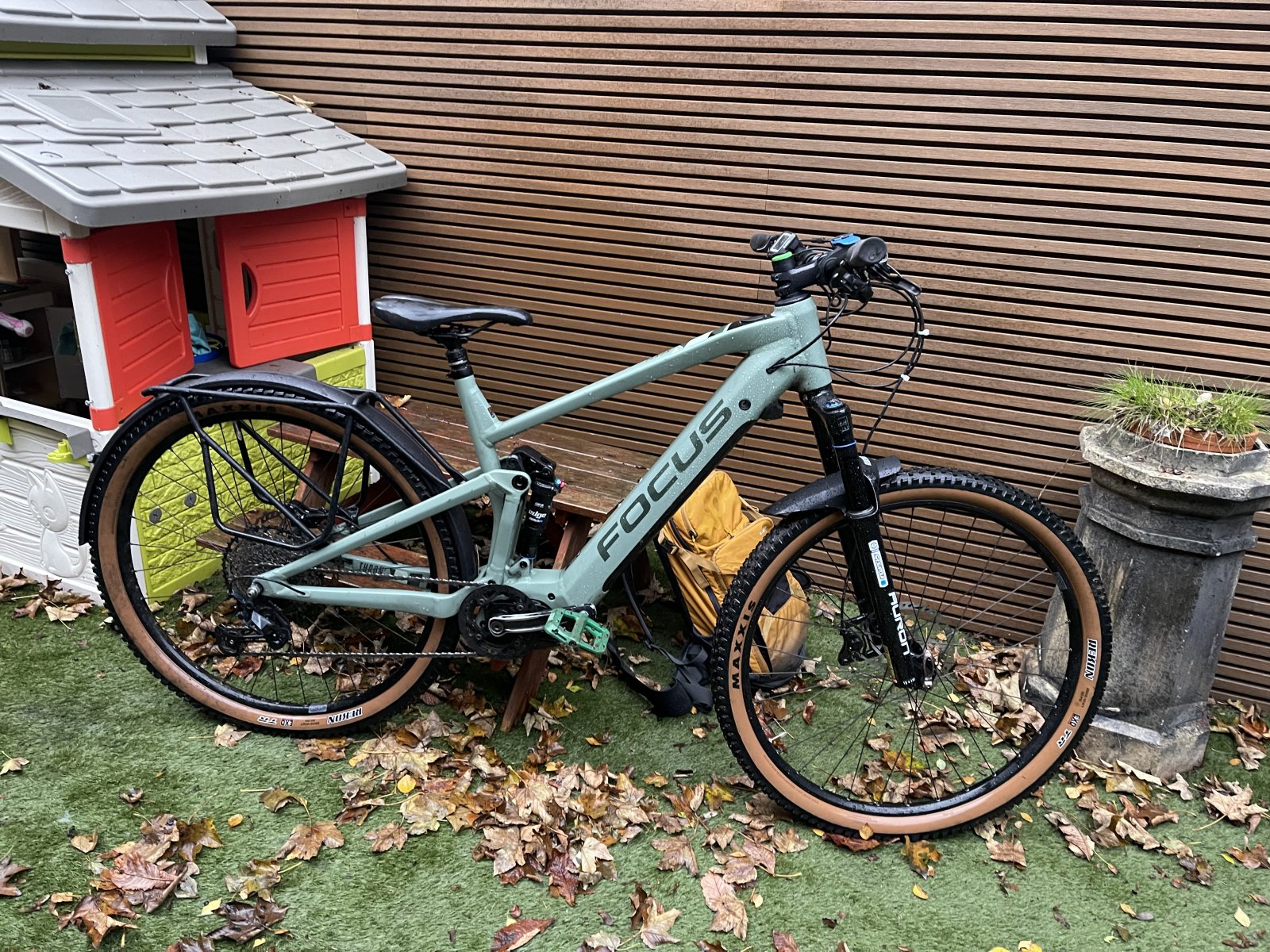

Awesome, thanks for posting, was thinking of doing the same thing, as you can keep the mudguards fitted if desired.

I put the rear mudguard back on a couple of weeks back now that the weather has changed, and kept the smaller front guard that came with the fork.
So this is how it's currently looking, not as 'cool' but so worth it not to have to wash my jacket after every ride.
