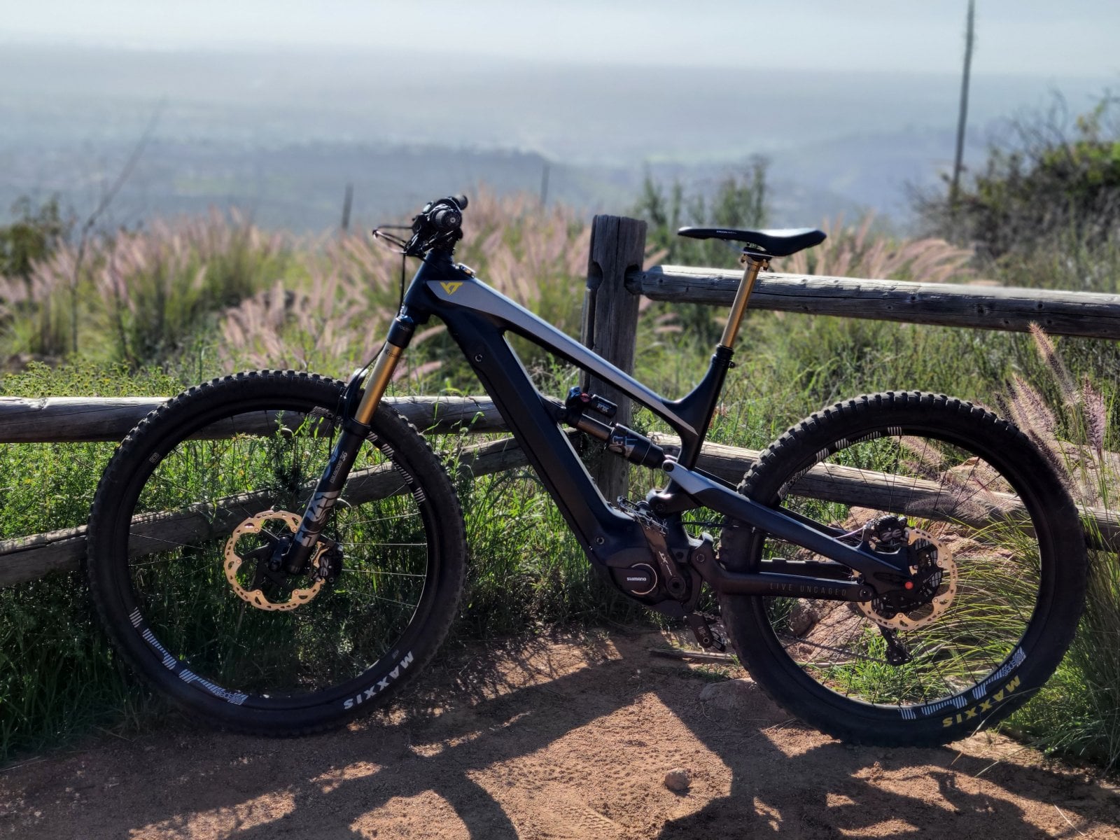

I swapped out the SRAM brakes for Zee's and Ice tech rotors and wow what a difference! Love the feel and they work much better for me. You do need new adapters for the 203 mm rotors but they are pretty straight forward to find. View attachment 27351

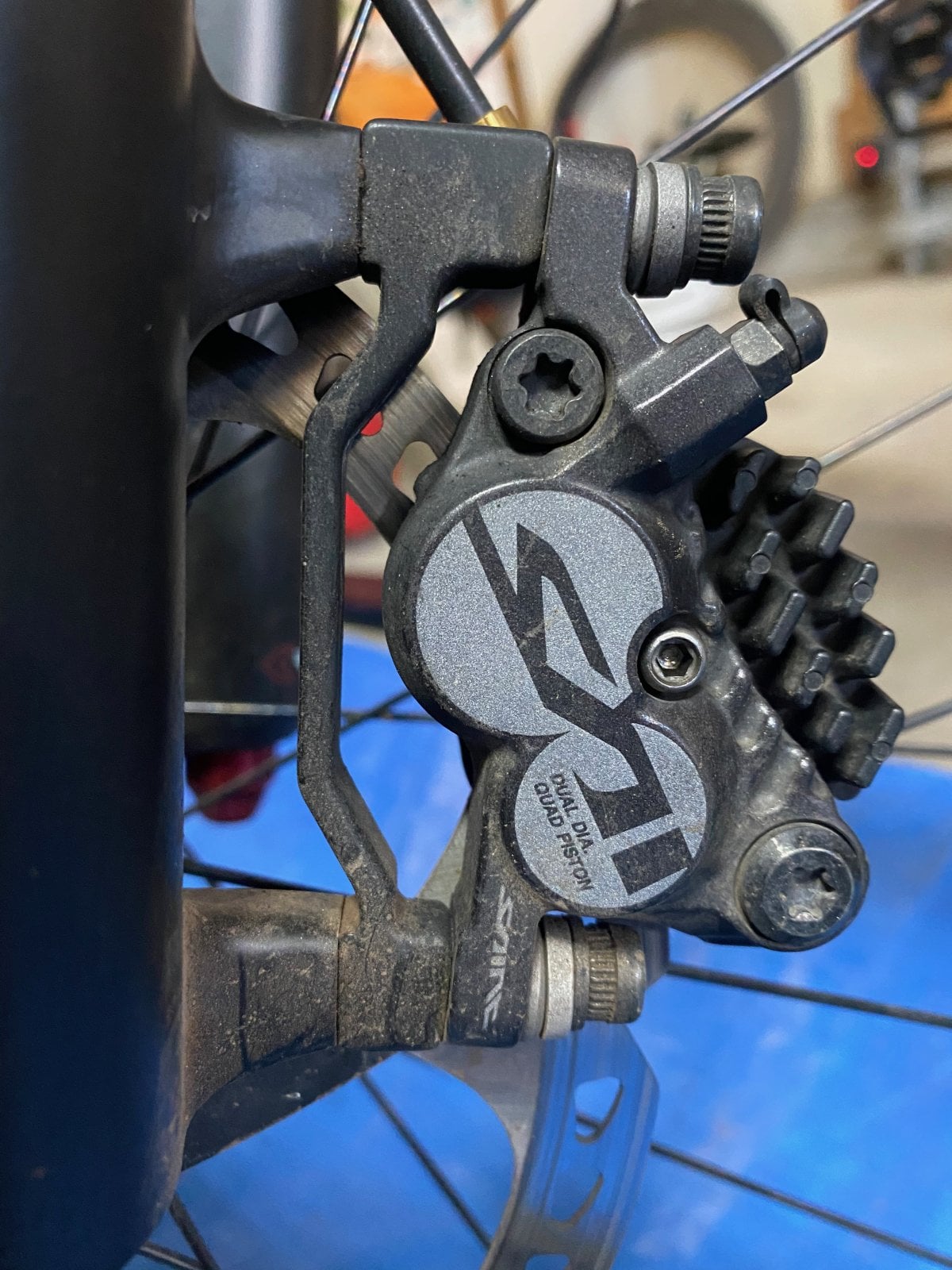

Hey There,
I just ordered some Saints with 203 ice rotors for my Decoy and have 2 questions for you?
1) You say you needed new adapters? Could you just add an extra spacer on the bolt to make up the extra 3mm?
2) How difficult was it to install the rear brake? Any steps/tips would help.
Thanks
Barty
1. This is the proper adapter. Yes, you could easily fudge it with adapters
2. For the rear, drop the battery. Pay attention to how the existing brake line is routed and be sure to follow the same pattern. You'll need to install it without a fitting so make sure you have an insert and an olive
