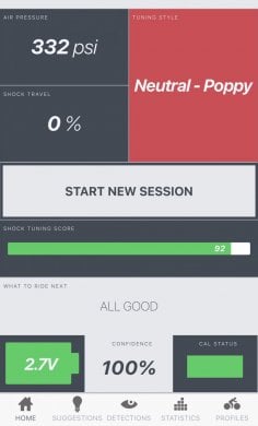

I borrowed my (generous) friend's Shockwiz and went down a tuning rabbit hole for the past 2 weeks and have uncovered that I'm likely too heavy for this bike frame to be running an air shock. I'm on Decoy29 Pro w/ Fox DPX2 rear shock.
I'm 270 lbs with hydration/gear, and used ~ kitted weight PSI for several months before I had access to the Wiz. Had initial pedal strikes, learned how to ride a bit better, but also put flip-chip in 'high' and bought some volume spacers. Ended up using the light-blue and thought I had things "dialed".
Along comes Shockwiz. The 36E fork was pretty easily nailed and just ended up with wide-open HSC/LSC and reduced some PSI from Fox's manual recommendations. The DPX2...not so much. After proper calibration and 100% confidence in suggestions, the Wiz recommends: Add air, reduce vol. spacers, soften LSC and HSC. Dynamic sag was near 50%. Next ride was @ 300psi/smaller spacer...same recommendations. Then 314psi/smaller spacer...same recommendations. Yesterday 330psi (!) and the smallest 0.20in^3 Purple spacer - FINALLY - Wiz stopped saying "Add air / remove spacer". But LSC and HSC are still too hard. These are the same suggestions by the way in Neutral+Poppy and Neutral+Planted, which is where I want to be.
At 330psi, there is little suppleness left. It's totally ridable and still a fun bike but the ride is very busy with lots of chatter. I'm also now sitting up pretty tall (still at ~ 38% dynamic sag though according to the Wiz), and feel like I need to flip my chip back to "low". Fox says "Shockwiz data aren't accurate for Fox products". I don't really buy that. The Wiz still collects repeatable objective data, whether or not the data are accurate, they are repeatable and it's better than the human butt-dyno. But when pushed, Fox says a custom re-valve would be required to get LSC/HSC any softer. I'm simply at the limits of adjustment on both rebound and compression. At least rebound is nailed within 2-3 clicks from closed.

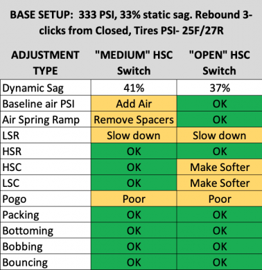

@HOMIE5000 - I originally rode the Decoy using ~ 270psi and would regularly go through full-travel with stock setup (no spacers).
I bought spacers and used the 2nd largest spacer (0.86 cu.in., largest recommended by Fox for 230x60mm) and 2 clicks from closed on Rebound Damping (per Fox's manual for my weight/PSI). I wasn't getting anywhere close to final 1/3 of shock travel with the dark blue spacer (largest recommended by Fox). Went down to the light blue 0.6 cu.in., but that's when my buddy loaned me his ShockWiz tuner and I realized my sag was more like 45-50% (Dynamic). Nowhere near 33% recommended. I opened up Rebound to 3-clicks from closed to get a bit more rebound speed, but it's on the cusp of being underdamped.
ShockWiz kept recommending:
1) Add air - went from 280 > 300 > 314 > 330 psi....finally Shockwiz said it was OK.
2) reduce vol. spacers - I'm currently down to the smallest 0.20in^3 Purple spacer
3) soften LSC and HSC - I always run the blue 3-way in "open". I've already opened up wide the LSC open-mode adjustment. But still, according to ShockWiz, it's not soft enough. This is due to stock valving which is inaccessible without rebuild.
I'm finding just the opposite about using volume spacers, they seem unnecessary with the proper 330psi and sag. I find I'm not bottoming out, even with the smallest spacer. I could probably go back to stock (no spacer) and not bottom out. Again, I think the Decoy leverage progression rules here. I was using spacers as a band-aid fix for incorrect sag and too-little PSI.
I'll try running harder tires and >25psi. That will reduce the undamped 'bounce' from the tire flex and put the forces up through the shock where it can be damped. Good suggestion to try. I personally felt like it made the rear very 'chattery' with higher pressures, but it's worth a revisit.
RE: Rebound damping. I'm just too heavy and 330psi too high to go below 3 clicks from closed. Rebound is easy to nail and very obvious when it's wrong. Fox's manual was spot-on here, maybe a little over damped. But I'm confident either 2 or 3 from closed is right (and makes ShockWiz happy as well). 1 from closed is a bit 'dead'. But I've got 2 usable clicks of adjustment for different terrain.

"ShockWiz kept recommending:"
What shock wiz is telling you is ,
!/ at 330psi your sag is right
2/ bottom out resistance is too firm reduce air volume spacer .
3/ the currant air volume spacer is dampening the LSC and HSC effecting small bump sensitivity and traction.
As you can see spacers effect bottom out resistance , spacers also add dampening to LSC HSC and rebound.
max psi is 350 for the shock , so I feel you should be able to get it right . Perceiver they are very good shocks
Are you blowing you feet off you'r pedals ?

#1) Why would you recommend raising HSC damping when ShockWiz recommends making it softer and I'm already running into compliance issues? The only thing the middle compression knob helped with was reducing bottom out and g-out issues when I was over-sagged (260 psi), but that shouldn't be a fix for incorrect PSI from what I've read everywhere.
#2) I should clarify that ShocWiz was finally all 'good' / green (no suggestion) with the current smallest purple volume spacer. It did not say to remove it. That said, I may remove it anyway due to the progression of the frame - it's probably redundant. YT ships DPX2 empty...so spacers just exacerbate the issue.
#3) I can only imagine the smallest spacer influencing LSC/HSC if I were well into the ramp-up of the pressure curve (60-75+% travel). My suspicion is that a baseline high-PSI is causing the lack of sensitivity (rather than the minimal spacer), and I think removing the spacer may end up with the same situation at 330psi. I'll test to find out.

@HOMIE5000 - in the name of Science...I just had to go collect some more data this morning. ;)
I rode the same 4 mile loop that has a good mix of my 'average' ride terrain using "MIDDLE" and then "OPEN" on the blue 3-pos HSC adjustment. Per your instructions, I removed the last purple spacer. I also inflated tires to 25F/27R (they were just 2 psi lower). Rebound was at 3 clicks from closed based on my experience. 33% static sag @ about 333 psi. This was a true A/B test (except for order effect) - nothing else was changed between comparisons. ShockWiz had start new session before each and was at 99% confidence in their suggestions for "Neutral-Poppy". They didn't change much if I selected "Neutral-Planted".
I find the data surprising...and definitely not what I'd assume.
COMPRESSION: Using "MIDDLE", I would have expected HSC/LSC to be in the yellow or maybe even red based on how the bike felt. In "OPEN" setting, curiously, the HSC/LSC went yellow again to "make softer". Very contrary to my subjective observations.
REBOUND: "Slow Down" for both....I should probably run 2 clicks from closed Rebound damping on that trail. Others with playful rollers, I'd run 3 clicks from closed.
POGO: "Poor" for both. Ditto on Rebound fix.
Other Surprises:
  • Baseline Pressure: "MEDIUM" says "add air". "OPEN" says "OK". Huh? Should be the same. Or maybe "add air" for the "OPEN" setting if anything. Seems contrary to my assumptions.
  • Air Spring Ramp: "Medium" says "Remove Spacers", but "Open" does not. Not what I'd expect again.
  • Dynamic Sag: Medium-setting @ 41%; "Open" was 37%. Also contrary to intuition. I take this metric with a grain of salt because I don't think it's calculated over the whole data collection period, but rather the most recent 20 pedal inputs.
SUBJECTIVE:
Running in "Medium" isn't for me on my trails. In the past, I've ridden the Medium setting before as a temporary fix for improperly set sag @ 260psi. It was harsh, busy, noisier, and lots of carbon frame 'ticking' sounds. Supportive as heck (I literally felt like I was riding higher). It felt like a perfect setting for a pump track. But it was scary going my typical speeds down some gnarly stretches. If anything, my feet left the pedals more-often in this setting than in Open-setting. Usually from a larger square-edge hit, my body gets pushed up on compression, but the bike comes back down and I'm still in the air. Need more knee flexion a-la hardtail style.​
"Open" - still had some small-impact harshness that I originally bitched about, but way, way better than "Medium". I felt much more settled over progressive hits. My body motion was more stable. I found no deficits in climbing due to the more supple planted rear. I didn't really notice the Pogo issue either. I suspect 2-3 clicks from closed rebound damping is the right place for me.​
LEARNINGS?:
  • I like HSC "Open" mode better than "Medium" for my trails/style
  • I really do need 325-330 PSI for 30-33% sag
  • I don't need spacers, but removing the Purple spacer had no measurable (5%) effect on HSC/LSC
  • +/- 2-3 PSI tire pressure yields the same ShockWiz data with no measurable effect on HSC/LSC
  • A heavy rider on high-PSI sag point doesn't allow the suppleness I'm looking for with stock shock valving but completely ridable.

View attachment 61582.View attachment 61585
