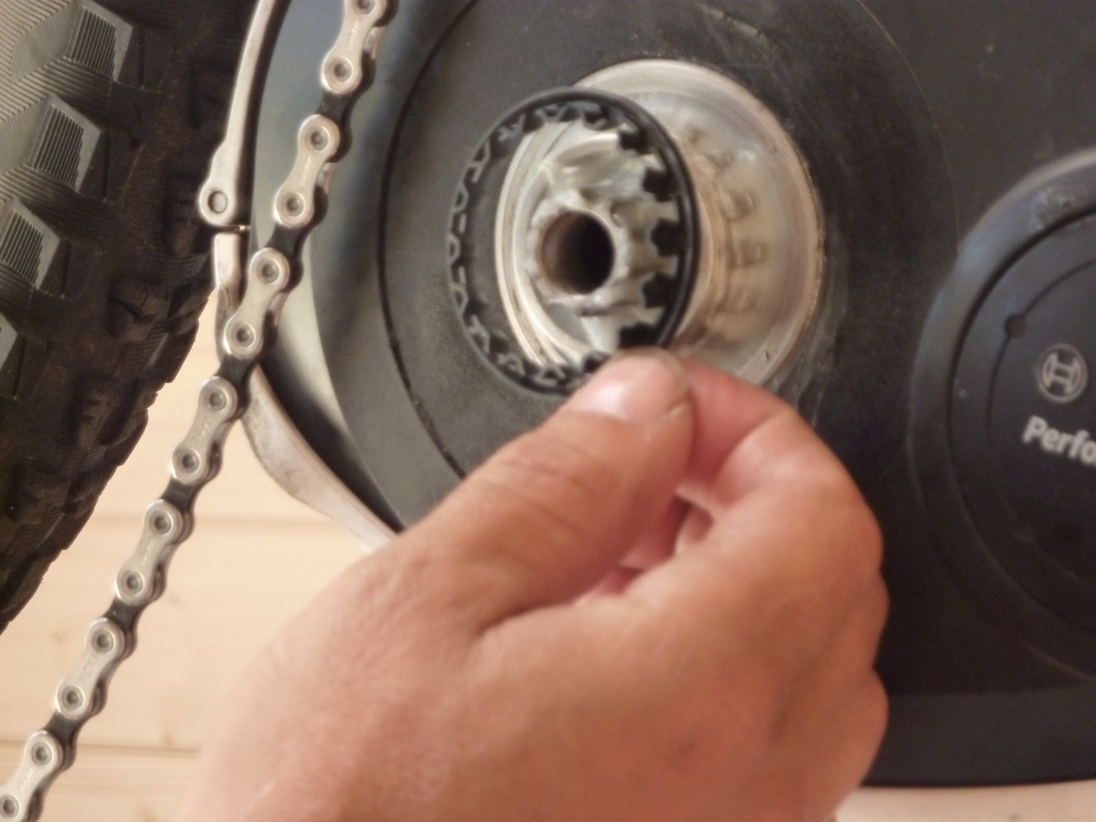

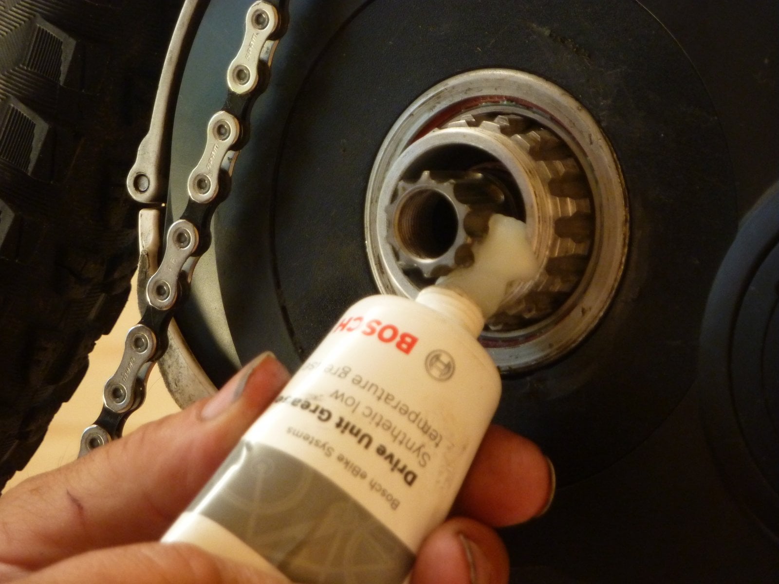

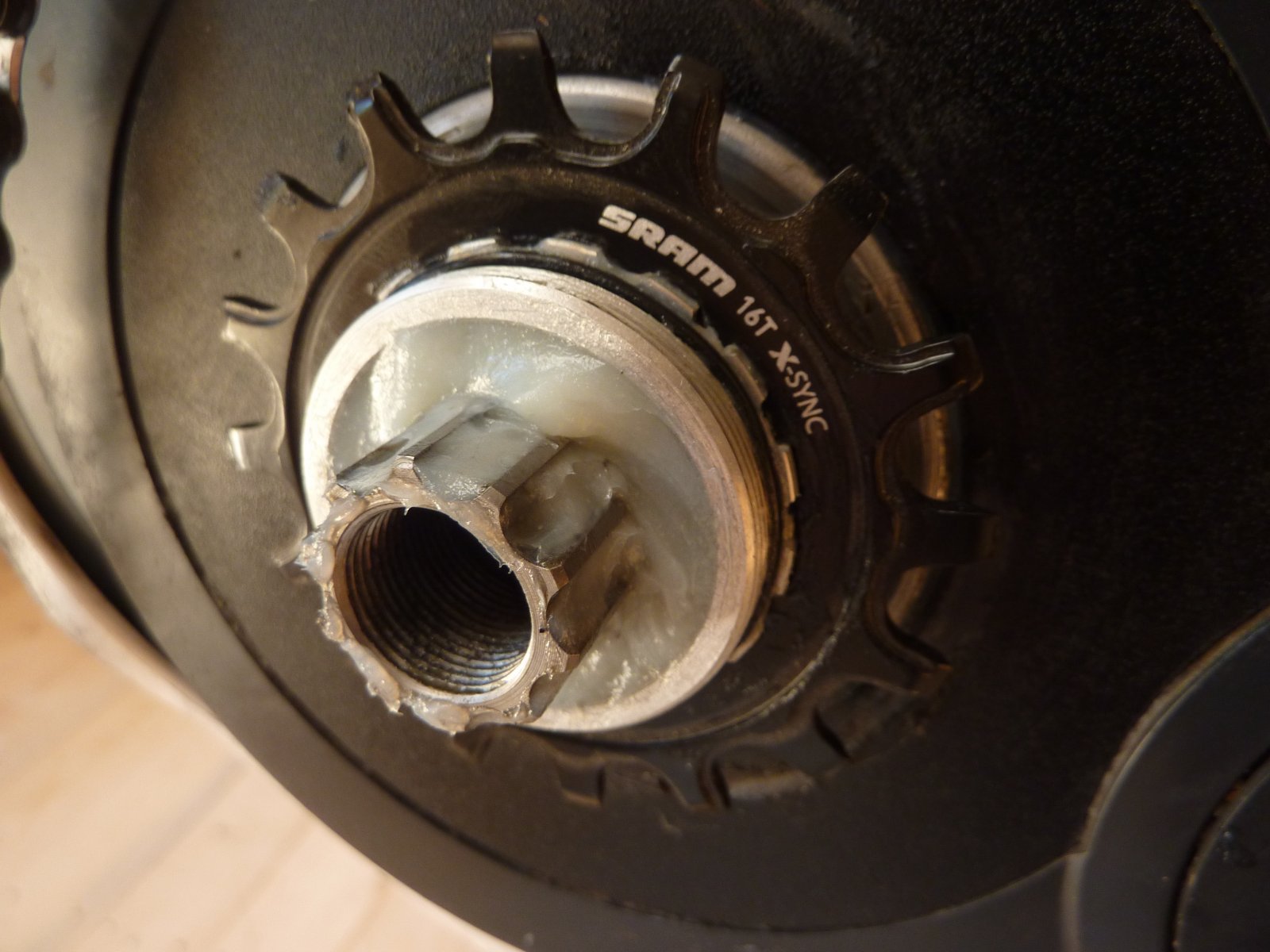

Once you put silicone grease behind the Bosch bearing seal, it will usually last about a month if you are riding in proper nasty conditions. But, if you are riding in nasty stuff, pack the left and right crank bearings too! Don't pressure wash or direct a powerful hose directly at the bearings and you should be ok.
I ride through a LOT of deep water and large puddles and floods with no issues, I do hose my motor off with the rest of my bike but I use a hook and compressed air to clean out all the twigs, leaves and crap around my sprocket.
