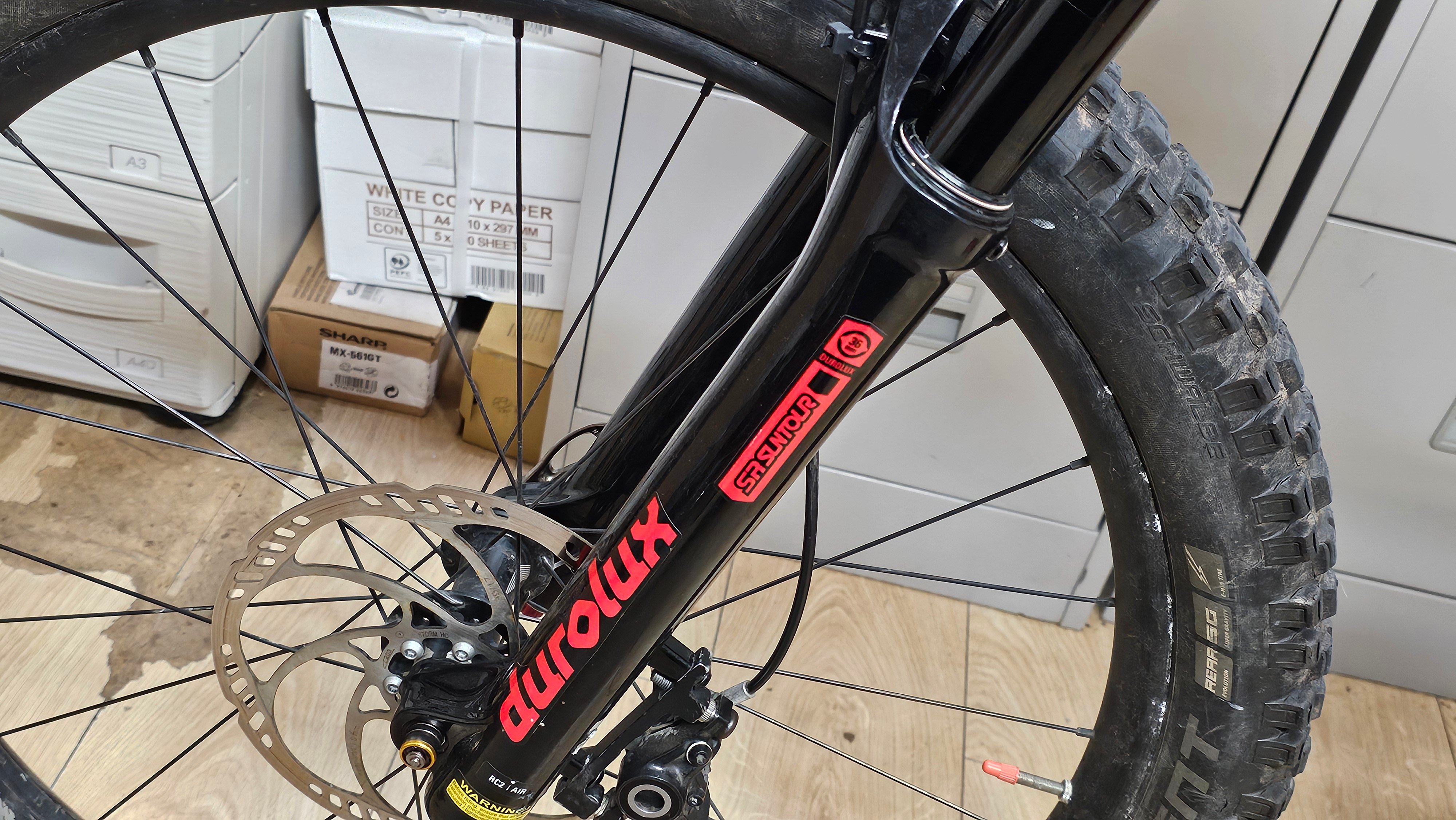

Suntour Durolux forks are pretty decent. They are on the heavier side compared to other brands. But on a full-fat emtb, I don't think it matters as much.
I've got no experience with the Zenon, Auron or Aion Forks or the Triair shocks.
But the Suntour Durolux and RUX forks are decent.
One of the easiest and quickest forks to service👍🏿
