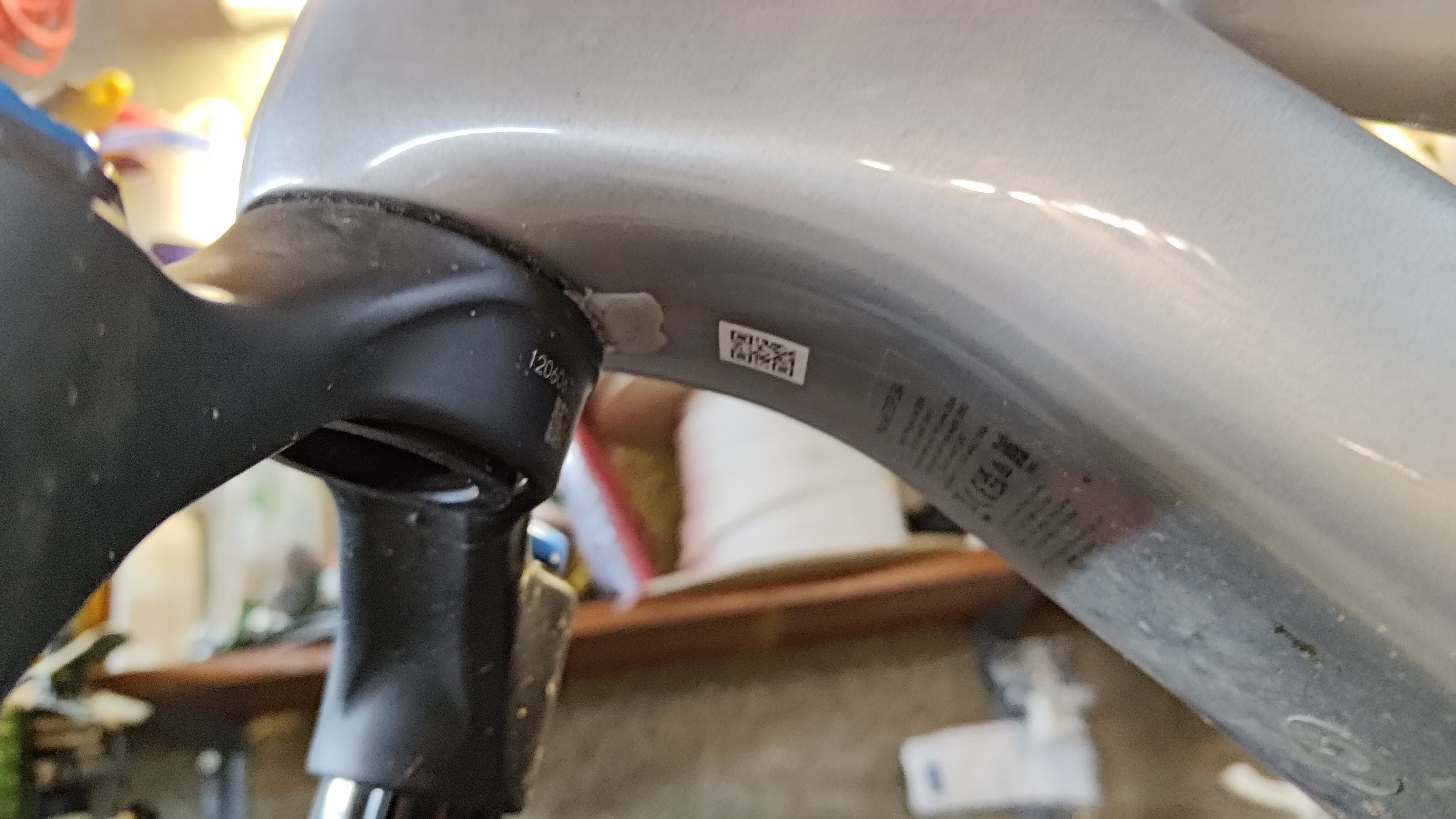

Steering Limiter/Knock Block hole in frame
Pentti
Aug 28, 2025
112
73
Chesterfield UK
The Amflow frame was designed with a knock block under the headset, however when it came to market it's not fitted. This means there is a nice hole under the headset allowing dirt & mud from the front wheel straight into the bearing. Just a heads-up it's simple to block this up with "sugru" or similar, it's hard to see in normal usage.
Or 3D print a tight fitting plug. I was going to bolt mine in place but now thinking of removing the bolt holes and gluing it in place, maybe with silicon.
