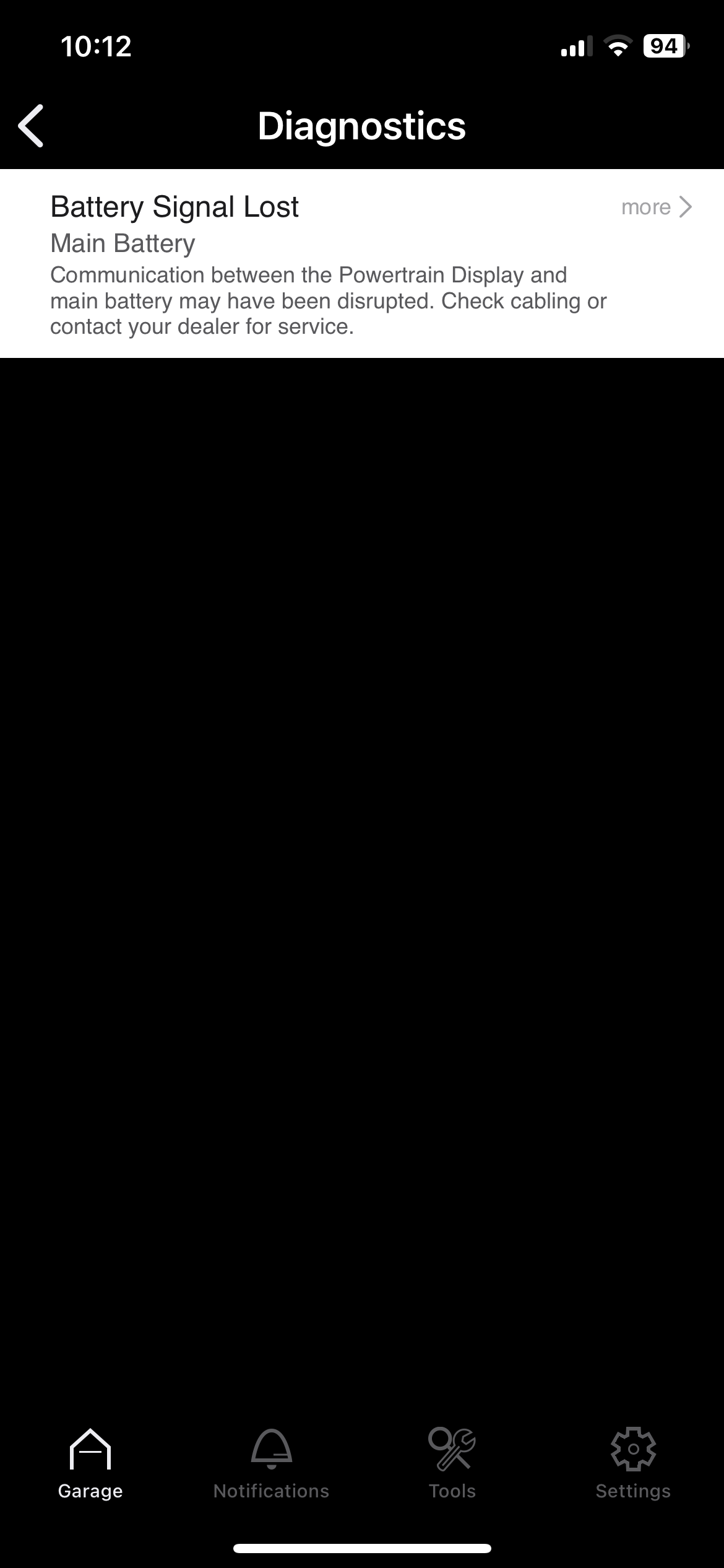

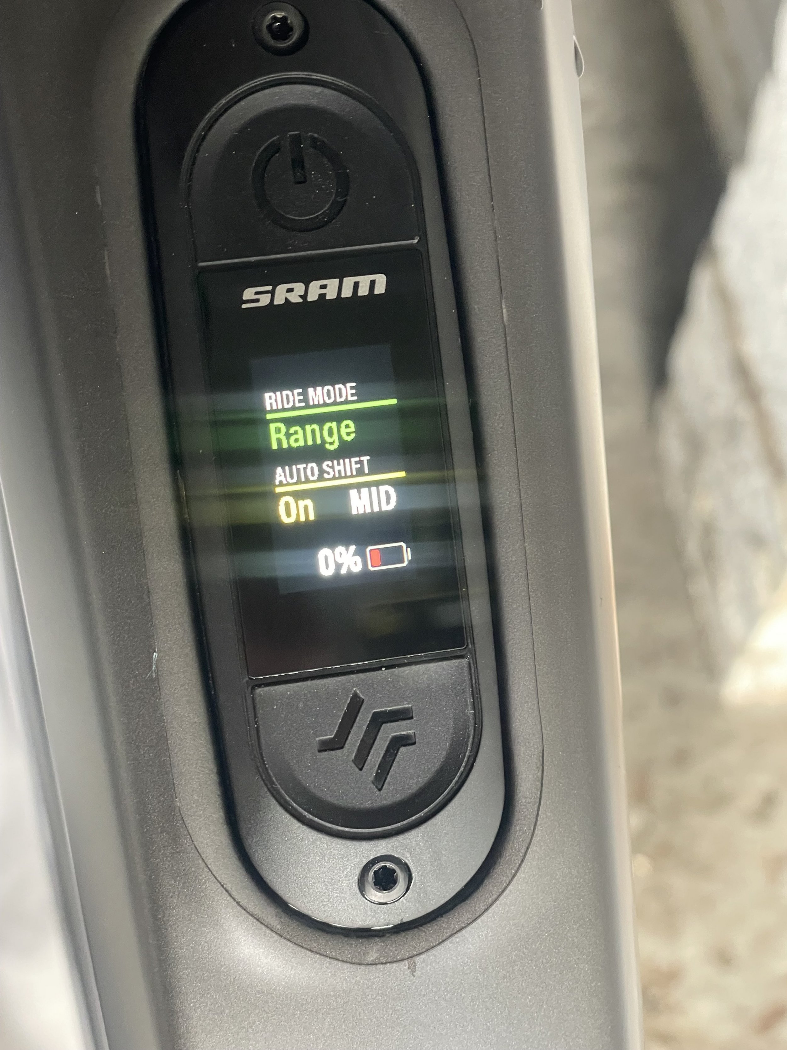

I’ve got the same problem with mine. Fitted a new motor @100 miles. Now it won’t turn on. Great bike when it works. But this will be the 3rd time it’s gone back and only done 300 miles total. Not good enough for a ten grander.

I continue to have intermittent issues with battery signal loss errors. Power up sometimes just flashes logo and turns off. SRAM has another wire harness they want to try. The last harness lasted 500 miles and started crapping out just like the first. I love the bike when it’s working properly but my patience has been tested and if they can’t get it sorted out soon I’m going to have to do some buyback with them as it’s too iffy whether or not I’ll get a good ride in. I don’t think they tested production units adequately before release. I’ll keep ya posted of any updates in this thread.

They sent the SRAMbulance this time. On the first harness replacement, the local shop monkey did not apply dielectric grease on the connector to the battery and according to the engineers in Germany, the dry connector is prone to fretting on the pins and sockets after 500 miles or so. This time the expert changed the harness and lubed it properly. It’s been agreed with SRAM, should this issue arise again in the future, they will facilitate a return / refund with Transition. They (SRAM) have been very responsive and helpful but understand that a bike this expensive should not be giving this much trouble. When the drive system is working properly, it’s amazing and I would hate to give it up but there comes a time where ya have to cut bait and run. Hoping it does not come to that but only time will tell now….
