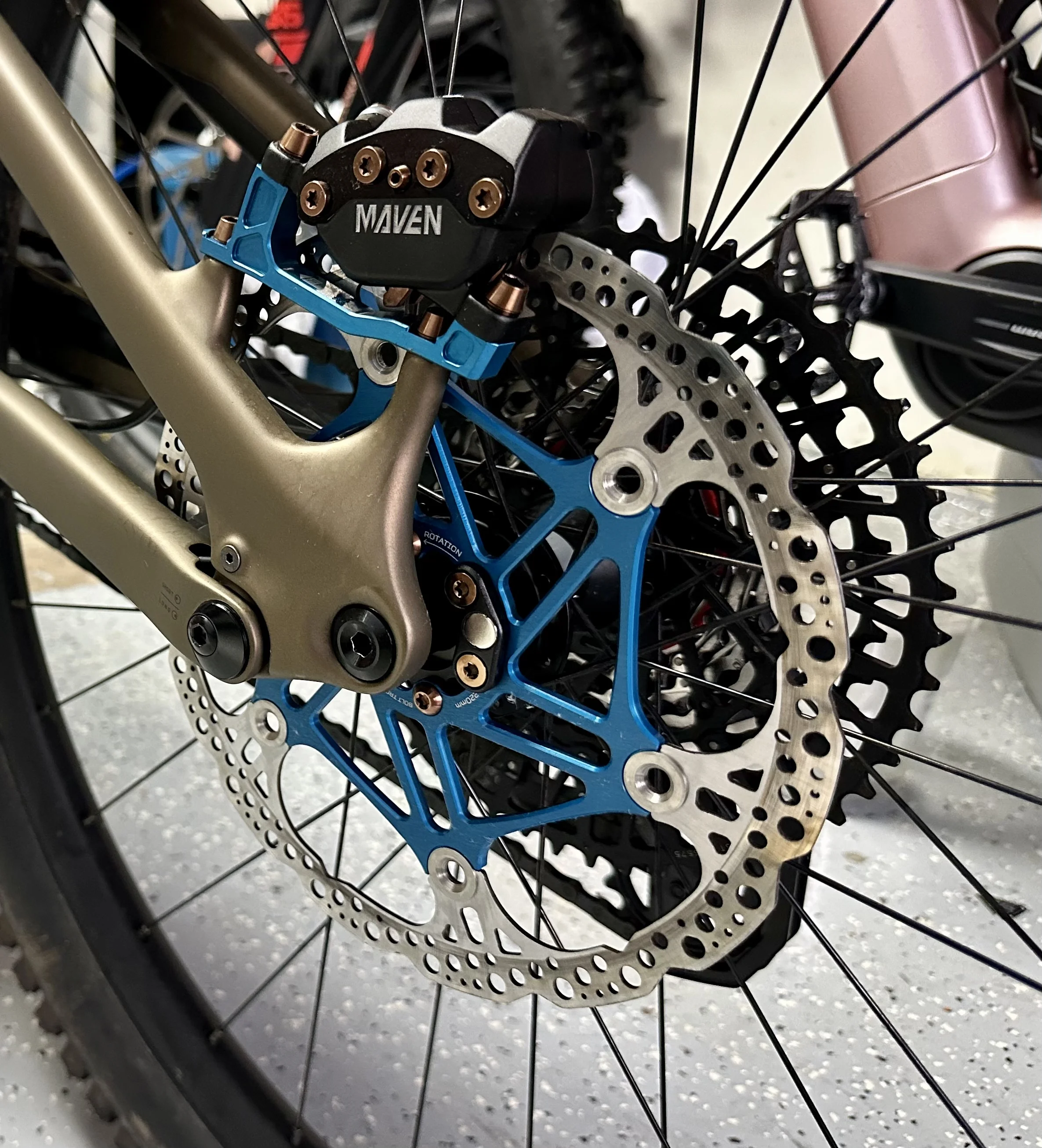

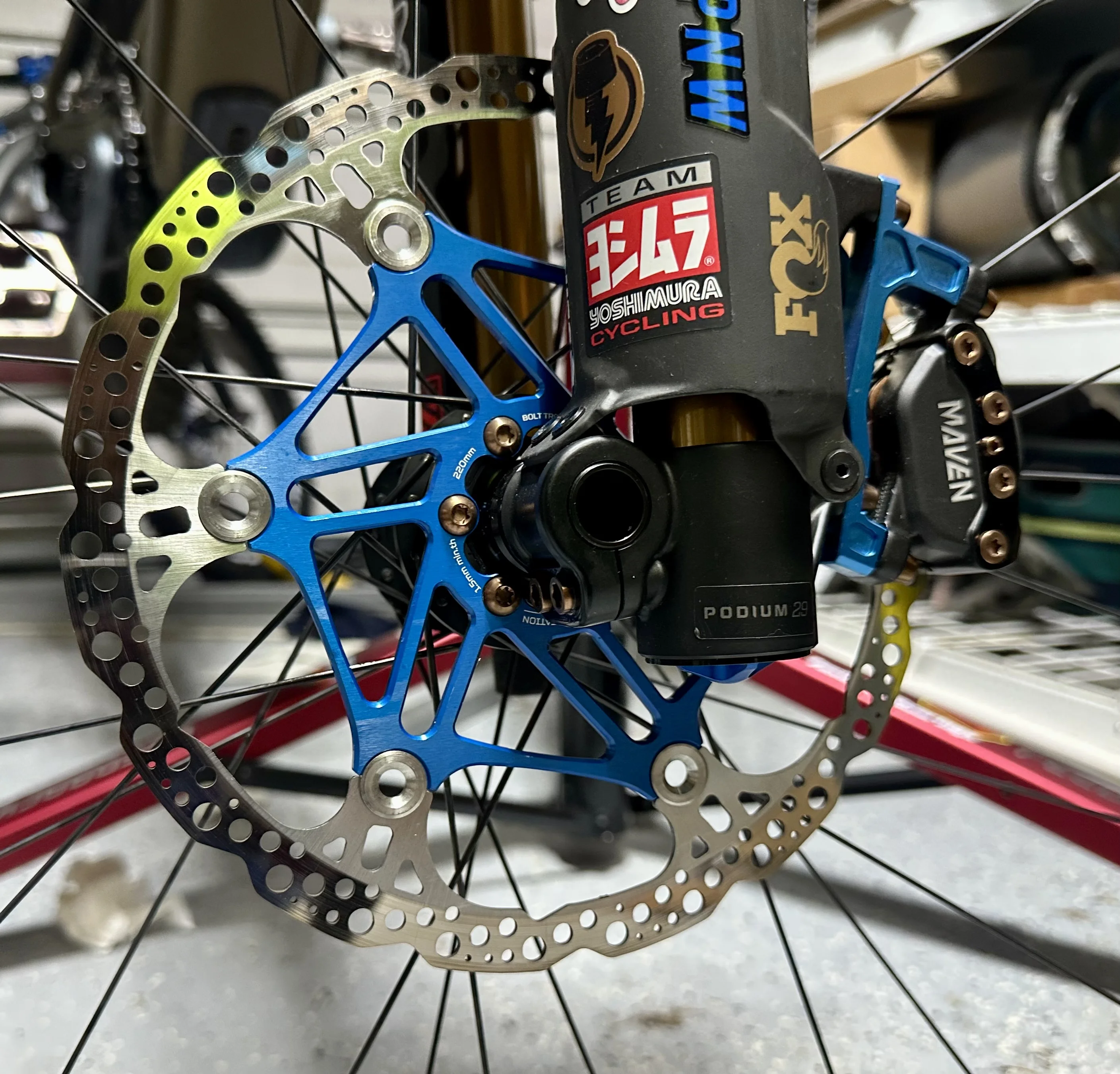

220 F/R
The wind resistance on my levers will stop me. Overkill on rear. Maybe.
Using thin hope rotors I had in stock now. Switch to the V4 when I wear/bend/destroy these.
220 F/R The wind resistance on my levers will stop me. Overkill on rear. Maybe. Using thin hope rotors I had in stock now. Switch to the V4 when I wear/bend/destroy these. 182443182444
220/220 on a Levo in the PNW - honestly, not overkill. Seattle's descents are long and wet enough to justify it, and you're already on the right side of the argument.
The Hope thin rotors will do the job in the meantime. The main thing to watch is heat warping - thinner rotors on a heavier eMTB on longer descents can develop a wobble faster than you'd like, especially if you're doing any bike park days at Stevens Pass or similar.
The community data consistently points to 2.3mm rotors as better for aggressive descending on eMTBs, with 2mm being the trade-off point for most riders. You're clearly aware of the limitation given you're already planning the V4 switch.
@B-man notes the Maven brakes with 220mm HS2 thick rotors front and rear are even more grabby than the standard setup on a Gen 4 Levo
- so when you do make the move to V4 rotors, expect the already-savage Maven feel to go up another notch. Which, given Seattle winters, is probably exactly what you want.
Wind resistance on the levers is genuinely the correct stopping force for your conditions. Carry on.
