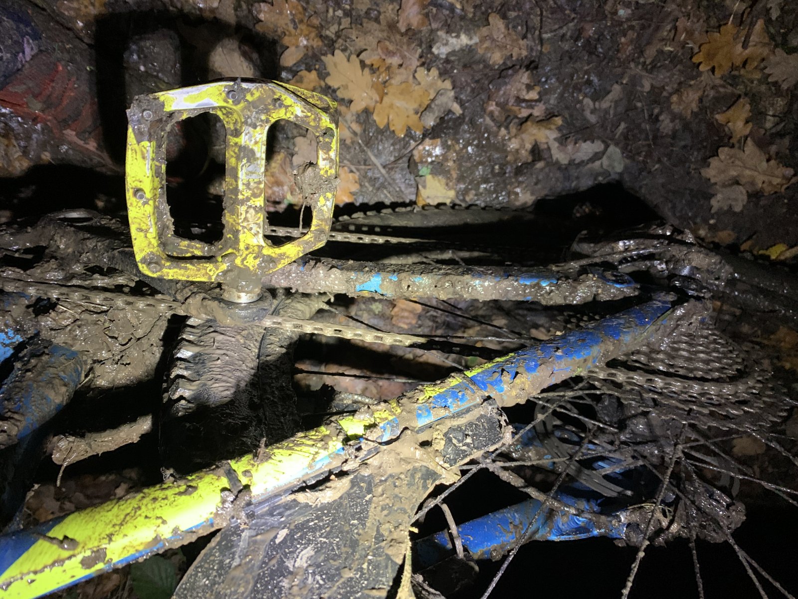

I always wash my bike down with garden hose (with head on it) after each ride, then store in warm garage, and oil up before each ride. I don’t user power washer.
This time of year, through the forests the mud is thick, see picture which I took when my gearing was making some terrible noises.
Given the cost of that ride, I might stick to gravel tracks for a bit.

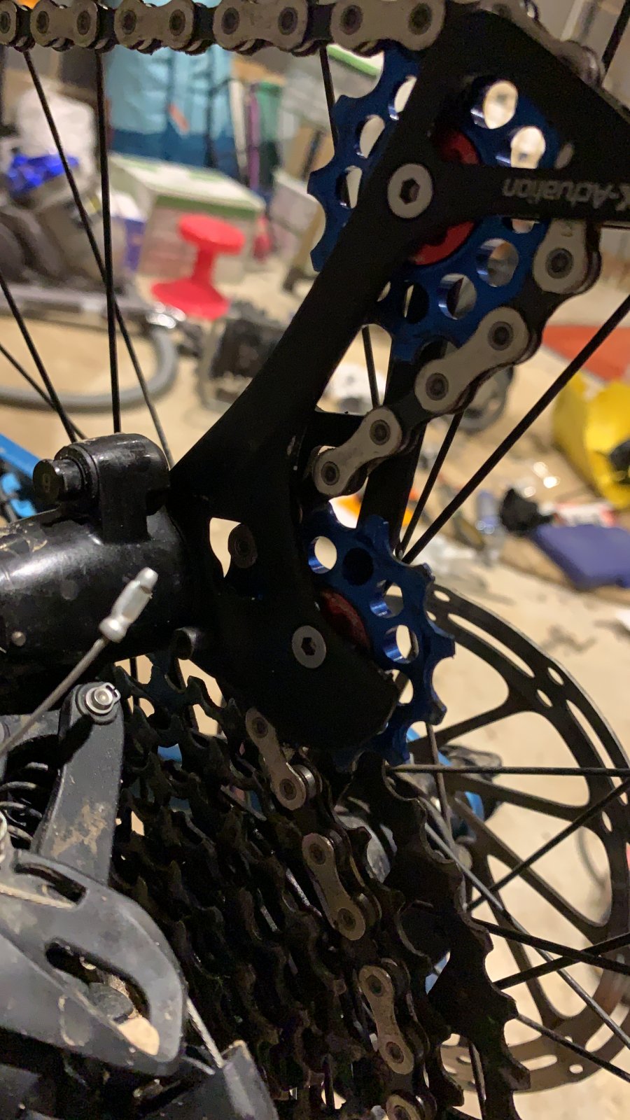

I received the jockey wheels and fitted now, so far so good. They look great and put the original SRAM ones to shame - attached picture.
Realised chain was stretched so put on a new chain. Went for a ride and the chain was riding up over the cassette and slipping. Towards the end of the ride this improved and wasn’t slipping as much. But I assume this could be a sign I need a new cassette too?
What did you choose SLX and not SRAM ?
Cost and quality. I saw a good deal from Tweeks, and a perception that SLX was higher up the chain than NX, so thought I'd give it a try.
My current cassette is SRAM 11spd, I assumed I had to buy compatible. Did not realise that Shimano was compatible. It is cheaper, the SRAM XG1150 I currently have is £100 vs the SLX at half that price. And they are a direct replacement and fit hub etc?
SLX and NX fit Shimano splined freehub. XG1150 fits SRAM XD freehub, I'm afraid.
