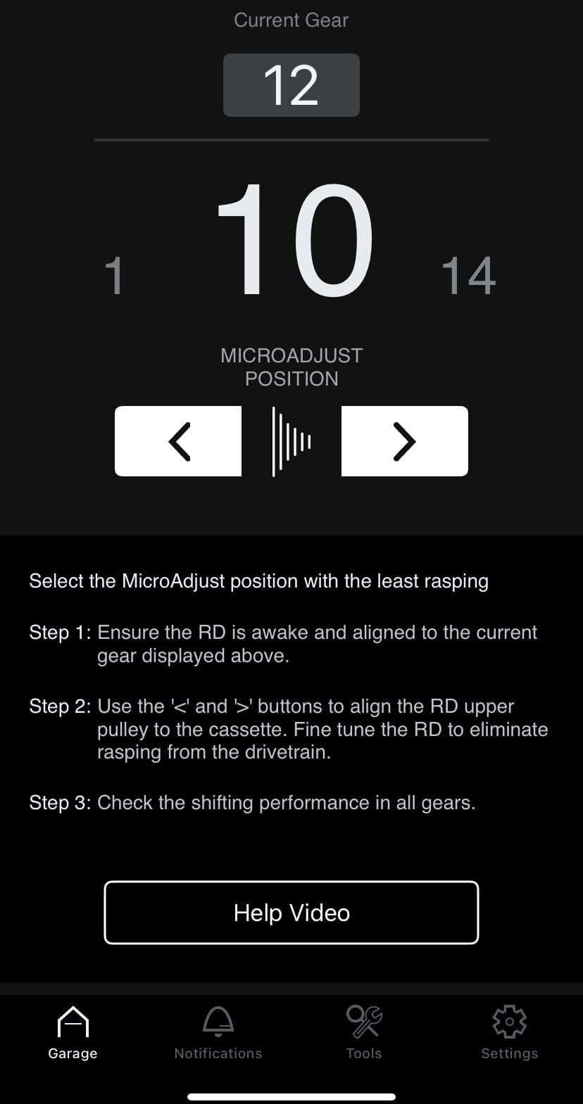

Can anyone provide any assistance here? Never seen this happen and can't find any help online anywhere. I had a light bump against a rock yesterday and now my derailleur thinks it's in 12th gear, when it's actually in 2nd. This means that I can't shift any higher than 2nd gear, because the system thinks I am already in the highest gear.
I've tried re-pairing the system and a few other manual things, to no avail. Even the app says it's in 12th gear. There doesn't appear to be any physical damage to the system, it's just a mapping issue between the pod and the derailleur or something? Been working fine since I got it, then this suddenly happened yesterday. Pics below.

So I just tried this and it went berserk, lol. If I upshift, it goes about 3 shifts and then stops. If I downshift, it went 1 shift then back up 4, then 2 down then just sat there wiggling back and forth. Then it jumped about 6 gears and settled on 9.
