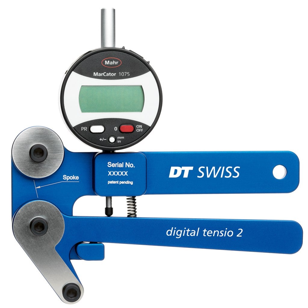

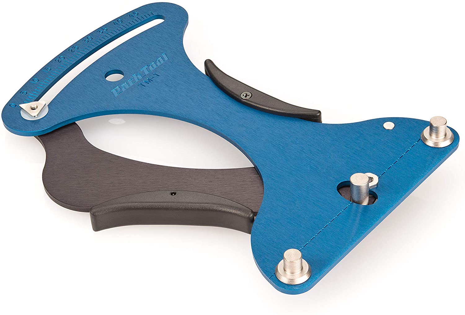

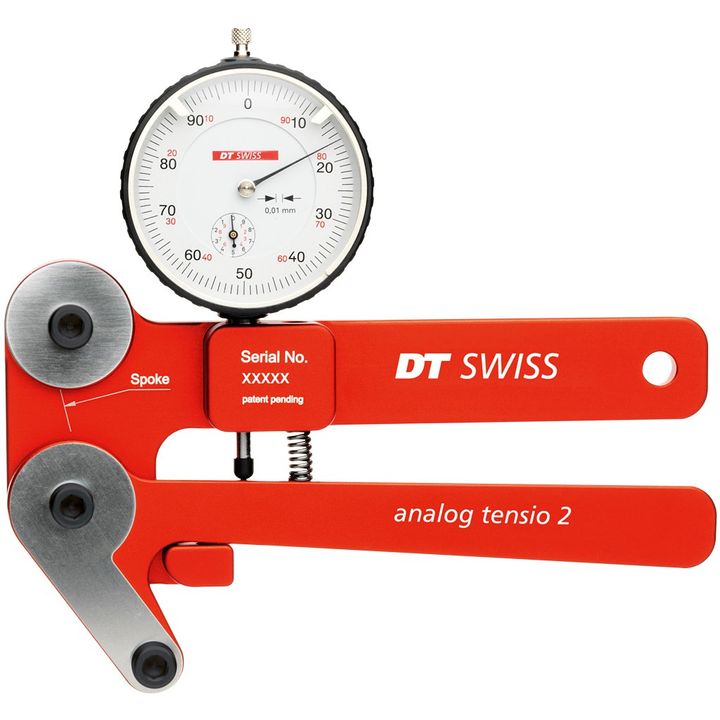

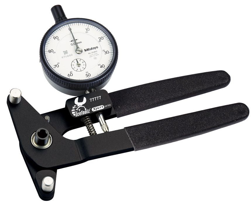

Any experiences/thoughts/comments on spoke tension meters?
I know that some people with golden ears can hear the correct sound but I'm interested in more practical way of measuring at least the correct relative tension.
Quick look from internet:
  1. PARK TOOL TM-1 spoke tension meter 94 EUR
  2. ICETOOLZ Spoke Tension Meter 415 EUR
  3. DT Swiss Spoke Tension Meter Tensio Digital 1042 EUR
  4. ZTTO spoke tension meter digital 50 EUR
Park Tool
DT Swiss analog
DT Swiss digital
ICETOOLZ
ZTTO digital
