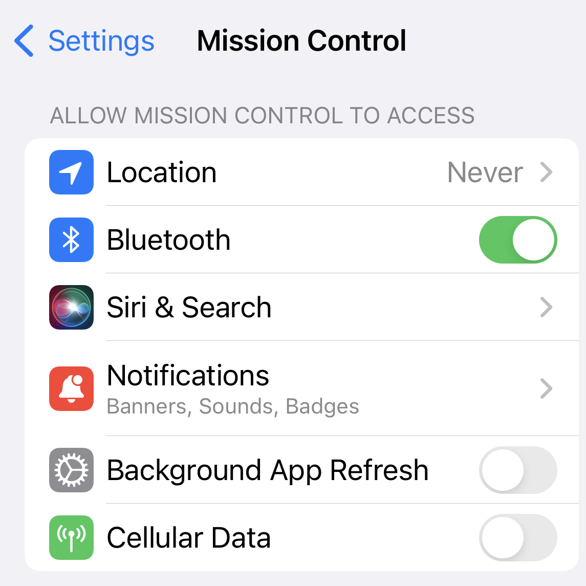

@tubylas Speed, distance were all displayed correctly on the TCU display and in the Mission Control app. Stop the Mission Control app from sharing your information with specialized. Set Location services for Mission Control to Never. If you need to service the bike or update the firmware. First remove the speedbox as recommended, reset the TCU. TCU holds alot of data. This should work to limit the app from sharing your data. I hope I answered your question. Maybe your UK Specialized bike firmware may accept the speed limit setting. Other than the speed limit it does everything else as advertised.

@IOUZIP how did you stop the Mission Control app from sharing your information with Specialized ? I'm looking for the parameter on my iPhone but I don't find the setting...

I'm guessing it's the permission setting in your phone, not in the Specialized app. The app needs your phone to tell it your location - deny it permission. On my phone (Android), I also couldn't find anvwhere to stop it sharing it's logs with Specialized. Maybe it's only when the bike shop plugs the TCU into their laptop?
