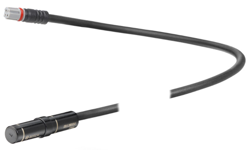

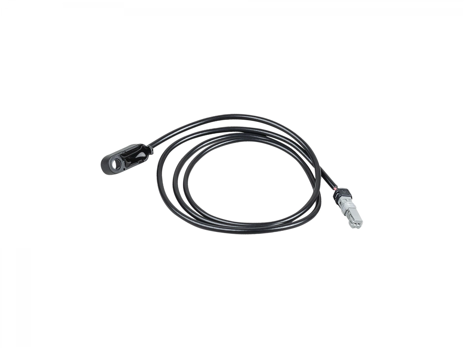

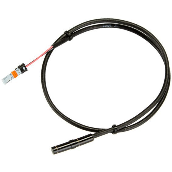

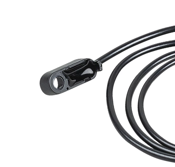

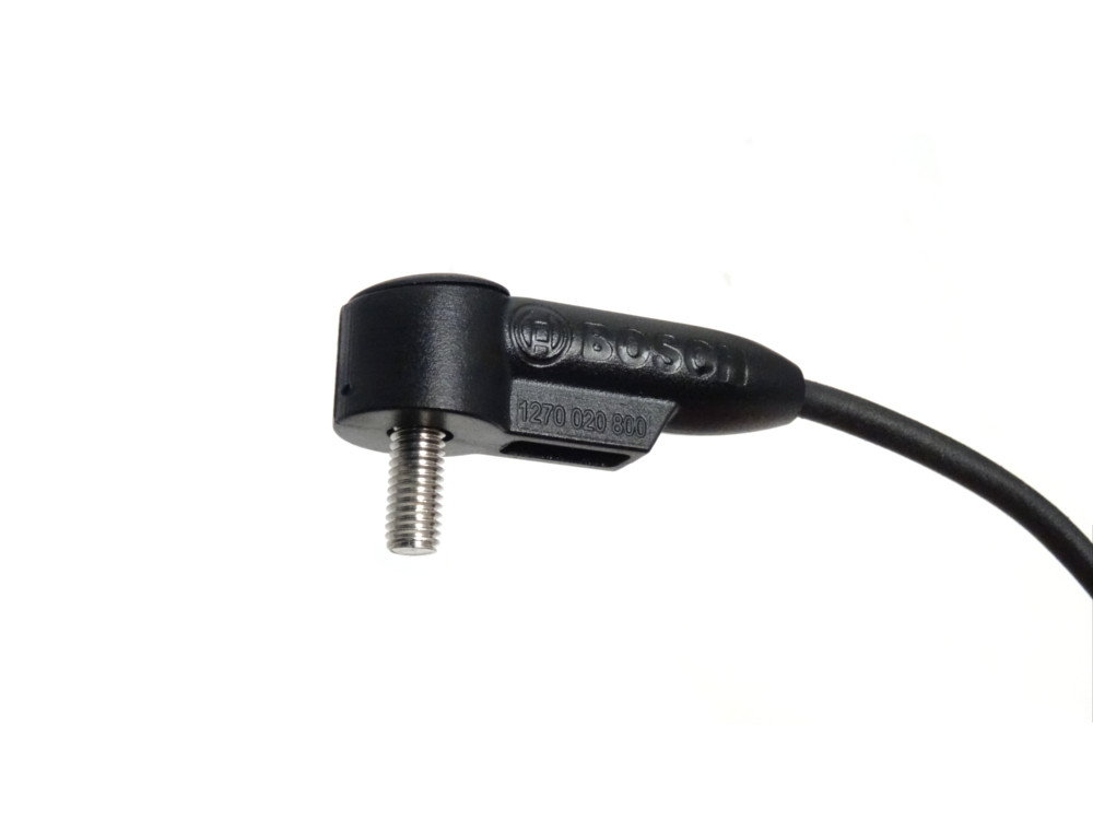

I think my speed sensor might be coming to it's end. LBS didn't have the Trek's own speed sensor. I wonder would it be possible to modify Bosch OEM sensor to replace Trek's own sensor. What do you think?
Trek W582244 sensor:
The 600mm Bosch sensor 1270 020 800
Bosc slim which seem to be for the BES3 M22 system I guess?

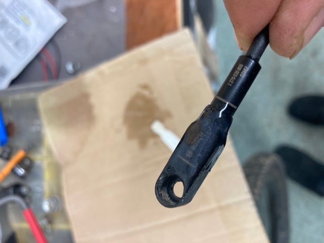

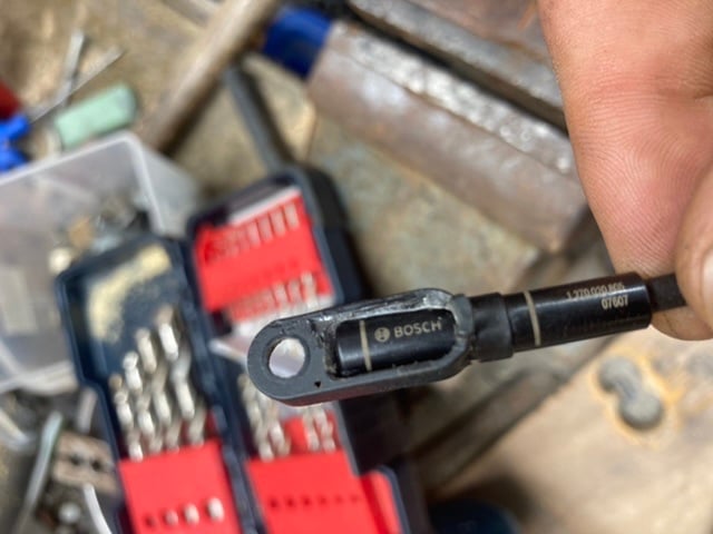

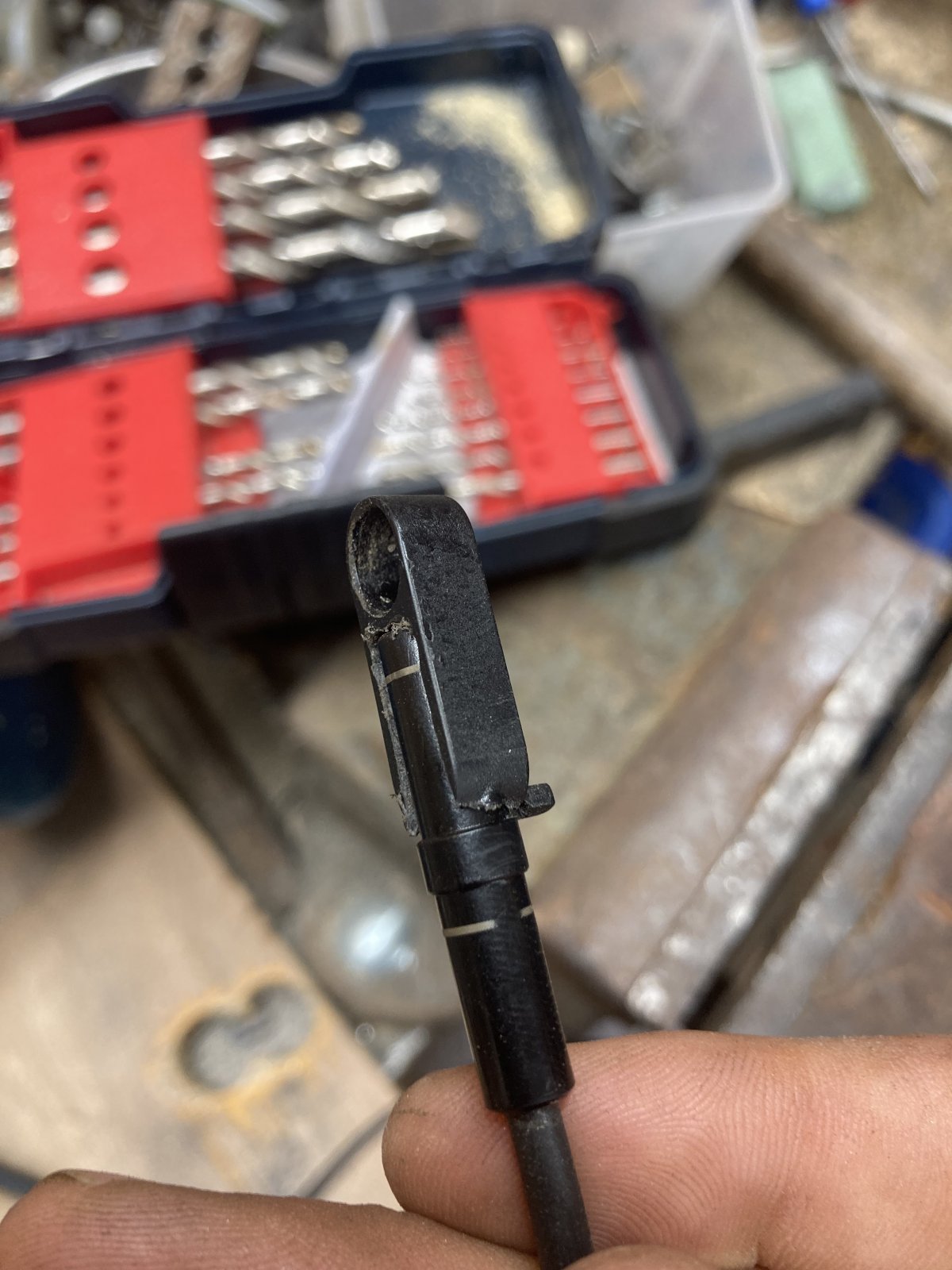

I did this with mine. Using the Bosch slimline sensor. No problems since
I’m assuming that the actuator is a simple reed-switch which is activated by the magnet on the rotor. Over time, or kms, this is likely to fail. This looks like a good option, especially for a spare, if the LBS doesn’t have one in stock.
