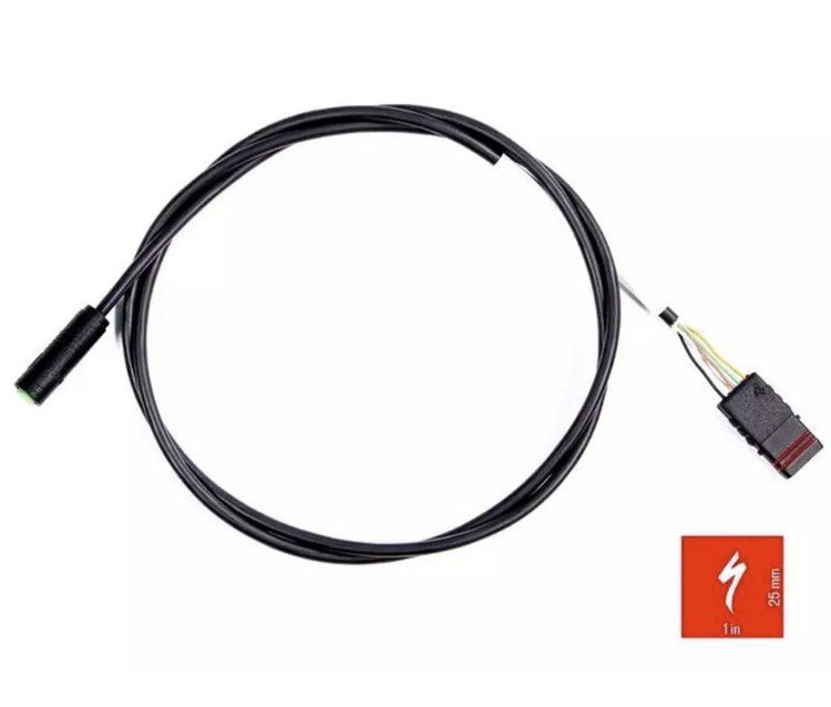

The same thing as you have, after a few hours it won't turn on. I need to plug off the motor to the battery cable, plug it on again, and then all good, the bike switches on.
After long research I discovered my TCU to motor cable has a little kink at the TCU end just before the connector.
The kink was the result of stacking the cable in a small area into the frame, it was just pushed in with many twists, so it got damaged wire(s).
So when I kink it a little, wire(s) must get connected again, and then the bike starts just fine after pushing the button.
Replace TCU to motor cable, it's cheap, it may resolve your problem also.

I've just repaired a problem with my 2020 gen 2.
After not riding for month, I connected the battery cable, and the TCU powered up on its own. It then powered down after a few seconds, and wouldn't switch on from the button, but did on re-plugging in the battery. Lots of erratic behaviour later, and unable to ride it, I removed and tested the battery cable as this was the no.1 suspect. Continuity and insulation resistance was fine, apart from one pin, (which is the brown wire) is not connected, and shouldn't be.
So I then disconnected the motor to TCU cable, and tested - continuity was fine, but insulation resistance was very poor between all combinations of pins. After half hour with hair drier on the plug, the readings were no better, but if I wiggled the wires, the readings changed. So water had been trapped inside, with no escape even with extreme heat.
New cable posted from Berkshire Cycles, and it's fixed! 😀😀

I suppose for 29.99 it’s worth changing - it looks a straight forward change
