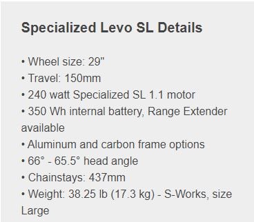

16.95kg for S-Works. 17.7kg for Expert Carbon. (I expect this is with tubes in).
Expert Carbon source: Specialized Levo SL Expert Carbon on test – mountain biking will never be the same! | ENDURO Mountainbike Magazine the S-Works is here: Exclusive review: New sub 17 kg Specialized S-Works Levo SL 2020 with a brand new motor concept – a new way of riding bikes? | E-MOUNTAINBIKE Magazine
Rob’s thread on his XL Comp Carbon is something like 18.5kg with pedals and tubeless.

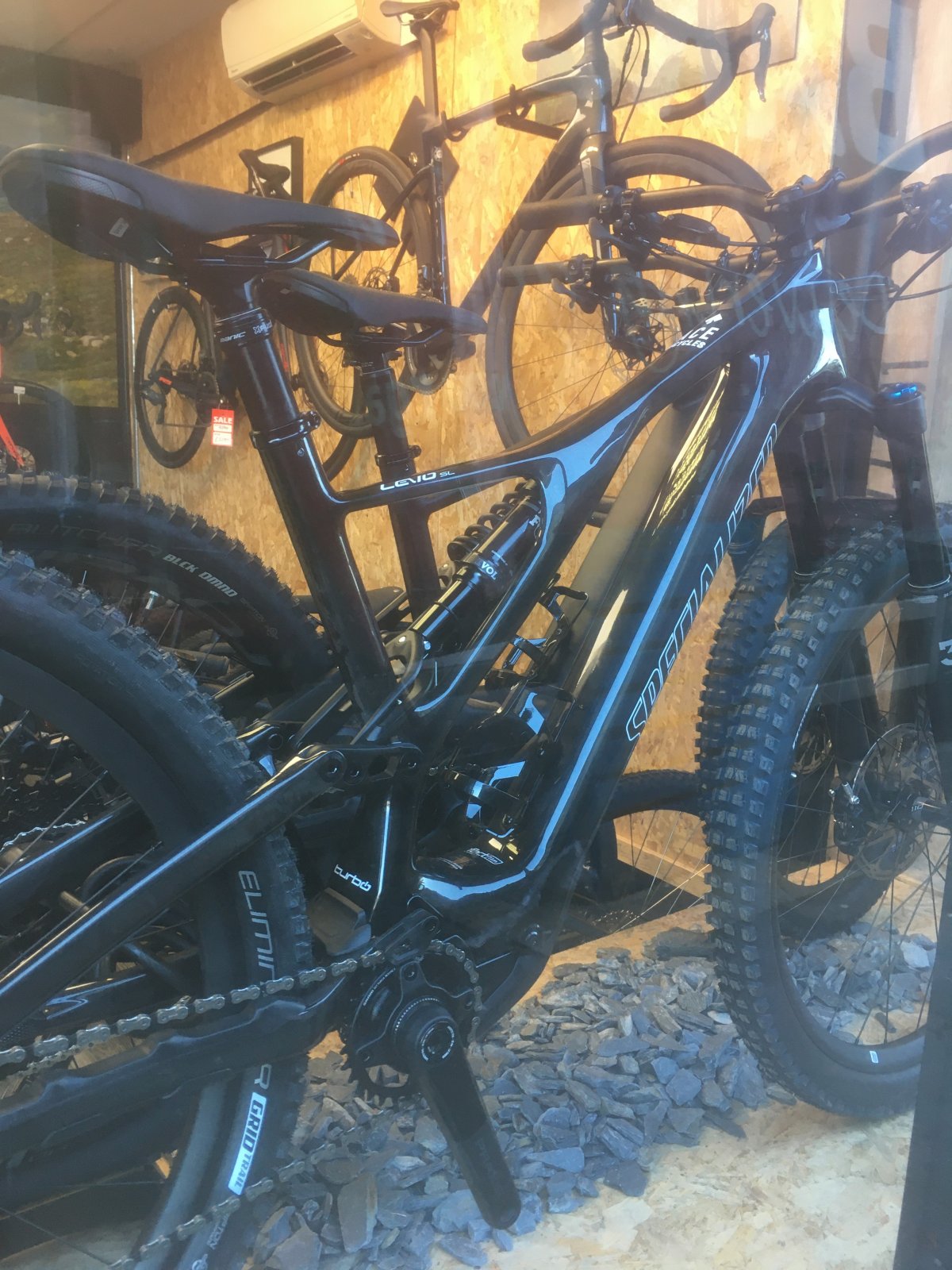

Black SL Expert in the window of Ace Cycles, Merrow. Lush. (Not the best photo).
I'm currently researching second hand values for my 6 month old Carbon Comp. I could be in trouble here.
