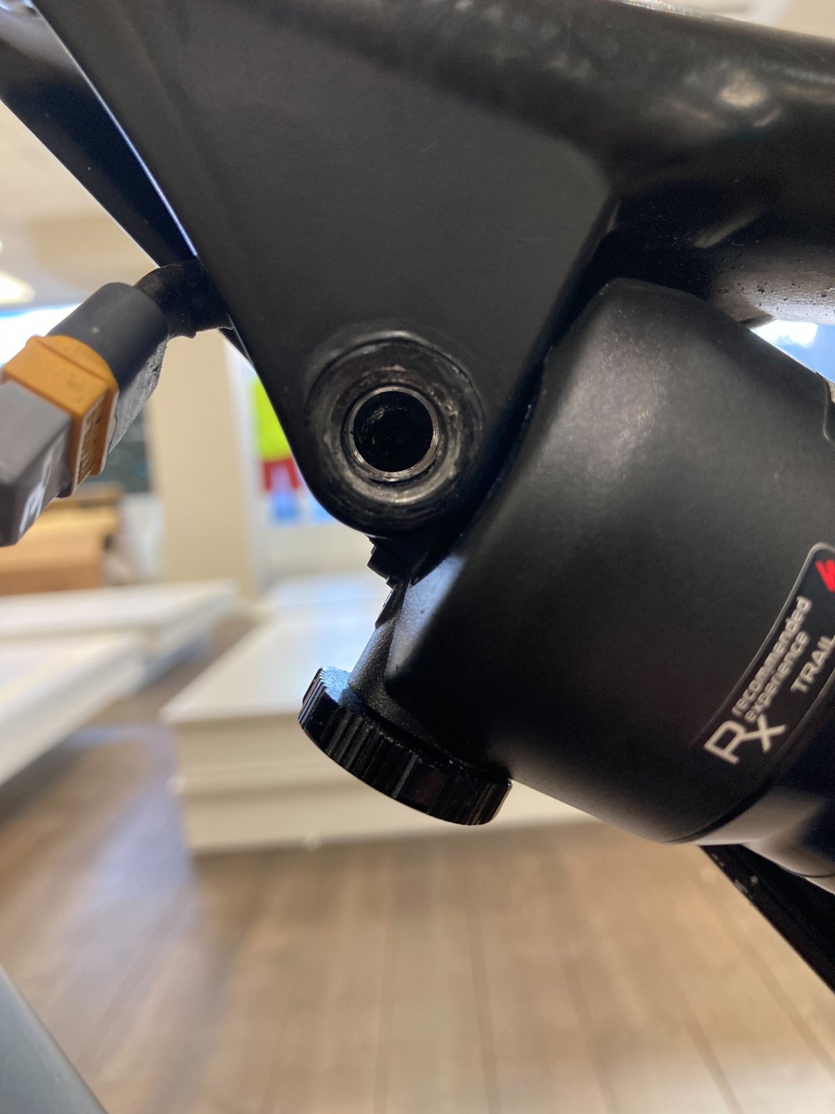

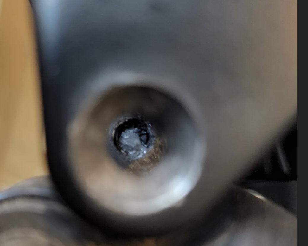

Levo Gen 2 Snapped upper rear shock bolt
Not yet, I haven't removed it from the bike yet and it is in the shop. I can remove this tho, will they know once its removed?
I called spesh rider care and some guy called Luke basically laughed at me and explained it happens and its probably down to the fact the thread was damaged.
I then explained this has been warrantied in other threads and he said its not a warranty issue and this had never been warrantied before, I have seen this on other threads and they have replaced frames under warranty but he explained people lie on the Internet and take it with "a pinch of salt" I can't lie he was really patronising so I just ended the convo there.
I've just spoken to the LBS and they have told me specialized have instructed them to leave it as they haven't done anything wrong. They also offered me 35% off a S works frame that costs around 7k.
I can't believe how poor the customer service has been and I also can't believe they think they've not done anything wrong. I guess now I know how it works.
so they have baisicly destroyed your frame with a mod you did not even ask for and say they have not done anything wrong and offer a 35% discount on a new frame to fix there fuck up says it all take them to court and cost them a fortune the morons.
They where brought a messed up frame and made it worse. Not quite the same as having a perfectly good frame to start with.
why not just get it helicoiled by someone who is confident doing it. Its dont think its realistic to expect a new frame.
This is a weak point, I've often thought what if the thread strips there. There is hardly anything holding the rear suspension on and the bike is useless without it!
They had to drill to get out the hardened bolt that was broken. Unless you are very skilled it's easy to get off center, or the threads could have be destroyed when they got it.
In that case you need to drill and install a coil or tap new threads.
Frame was compromised on arrival. The bolt they used should be tapered and as long as new threads where cut correctly it is a viable fix. Get a better bolt and have a machine shop cheek the the threads. Frame is not toast.
For the OP to sue, he would need to prove that the frame was not compromised when it was delivered for the work. It's a crappy situation for both parties.

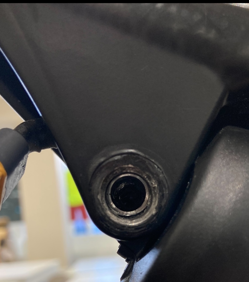

Hi all,
I called the LBS today to ask what's happening as they haven't been in touch and they explained they have spoken to specialized who agree they need to use a steel bolt.
I asked if they had ordered one and they said no, a colleague has a spare bolt at home and will be bringing it in to try.
I'm really annoyed now as they've had the bike ages and are not doing anything about it, I thought to myself im going to pick the bike up and just sort it myself.
I then asked the mechanic for a picture of my bike with bolt removed and he sent me this! (see picture attached)
My frame is well and truly fucked, they've completely damaged it and specialized are not taking responsibility! What do i do now? I wish I never took it to them and just got an engineer to sort it out or Berkshire cycles!
I didn't ask them for this, I never even asked for all this work to be done. I still feel like they've f***ed me over and specialized are just laughing at me. My bike looked so much better and now im left with something that looks like sh**
I genuinely believe I now am in a good legal position. This part of the frame was perfect before I sent it to them and I have image proof. They completely damaged it and I should be in a position to get a new frame!
Getting the new hole round and square to the axis of the bolt is more important then what system is used. 99/100 in the bicycle world, some poor sap is using a hand drill.
Yep. And it is almost impossible to get a round/square hole with a hand drill. Difficult to get a tap started square by hand too.
That's the difference from before I sent it to the shop and now.
