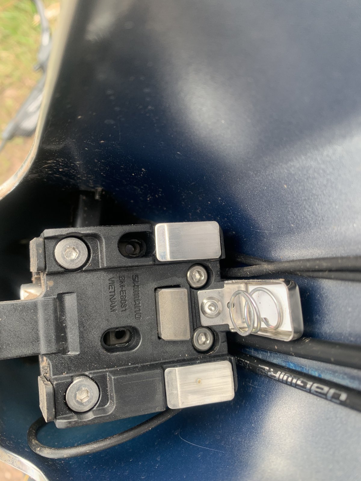

on the trails and noticed a rattle at front end,battery seems safe ?

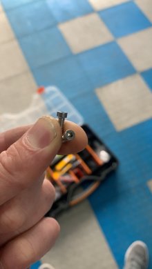

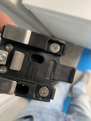

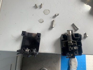

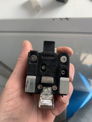

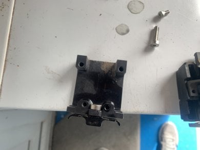

I found the screws in the frame,stripped the unit down and found them all to be loose,used loctite and refitted,rattle gone

Top tip dude! ?? Just checked mine and both of the small 2mm screws were loose, another ride and they’d have been gone ?
No worries buddy?I always find the hard way?looking at it I think it’s quite safe the way it’s designed just rattled like crazy (the mechanism not the battery) I still rapped electrical tape round the battery just in case till I got back to the car?
